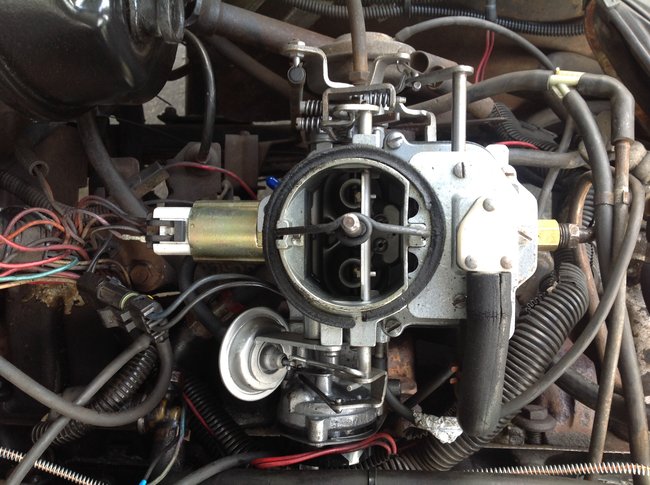

I don't know what you spent on your carb.
I asked you earlier a few questions, you kinda responded back with eliminating stuff is no problem.
Your rig is over 30 years old (mine are older). Things just don't work as they used to, if they work at all!

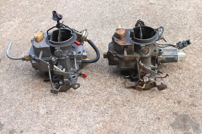

The Carb/ engine set up you have was used from '83-'86 on CJs.
In my opinion, the better CJs were made from '79-'81. They finally got everything right and Everything was really simple (or EZily made simpler).
My present daily driver is a '77 CJ-5, I have pretty much upgraded it to like a '79 (and made even other modifications without straying too far from a basic stock Jeep.

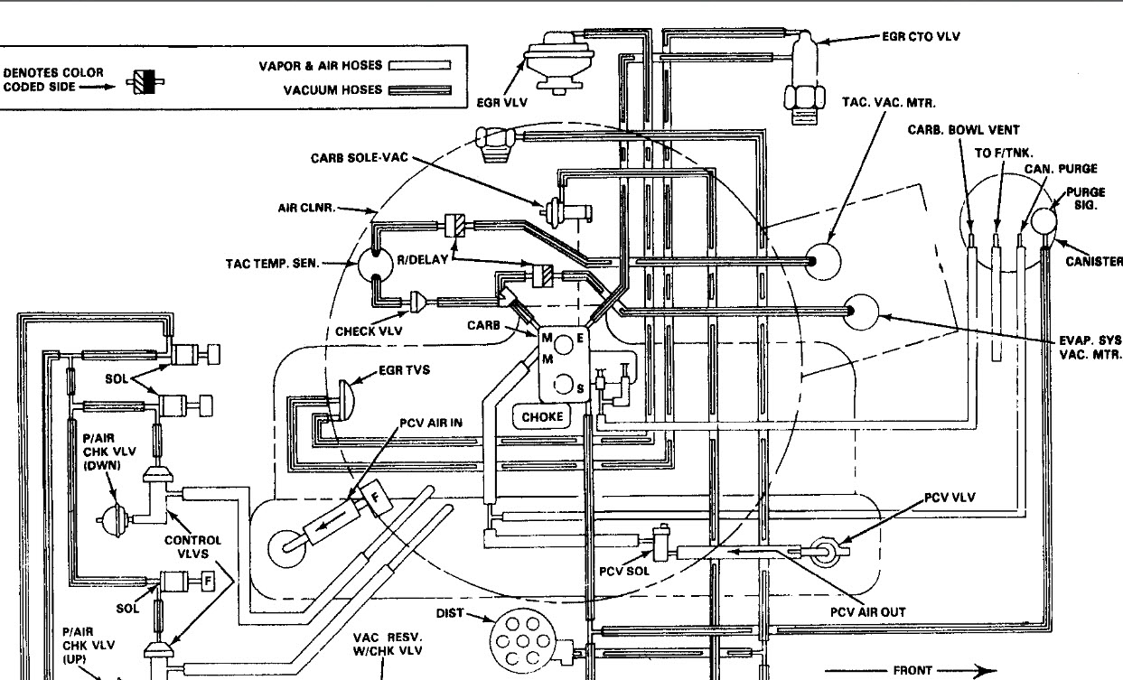

The '79 carb has no stepper/ no primitive computer control (which won't work correctly if all of the input stuff ain't connected/ working, thus rendering it's purpose useless and even what's left as "Default" lacks in proper operation.
Most folks that come to me with terrible running Jeep are sorta roped into doing most of the (EZ) work, and tuning with me explaining/ showing/ using my tools to get theirs all fixed up. I kinda do this to them so they can maybe diagnose and repair their on problems in the future. 99% of them are very grateful and I come out good myself!
Most of the time this may take a couple or three visits, most leave with a new carb (THEY INSTALLED), a lot less vacuum lines, all new tune-up parts, Maintenance on stuff neglected forever and confidence that the job was done well, the ability to diagnose and even make simple repairs. Usually they obtain a manual and learn how to use it!
I'm not selling parts, they go obtain them. I sorta learned this form of repairing and camaraderie down at the Automotive Rec Service Center where I worked on my 1st two Jeeps during my limited spare time as a U.S. Army Airborne Ranger.
Do what you gotta do, but a '79 BBD will run your Jeep just fine and it has no stepper. This link below is a NEW (not rebuilt w/ worn parts) Carb. These are found here and there on the site, Of the dozen or so that were ordered in the past couple of years have been identical. Other than tightening some of the body screws to my liking, I have had no problems with 'em even though they are copy cats.
The price is right and this one has free shipping. What a Deal!
http://www.ebay.com/itm/New-2-Barrel-Jeep-Carburetor-BBD-6-CYL-4-2L-258CU-Engine-AMC-Carb-Carter-Type-US-/182061362581?hash=item2a63b3ed95:g:YQ8AAOSwMORW7xZa&vxp=mtr

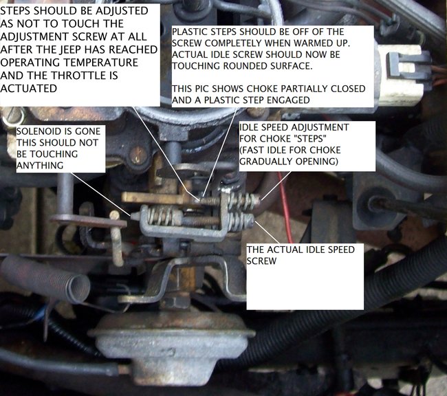

Now, if you wanna play with yours some more.

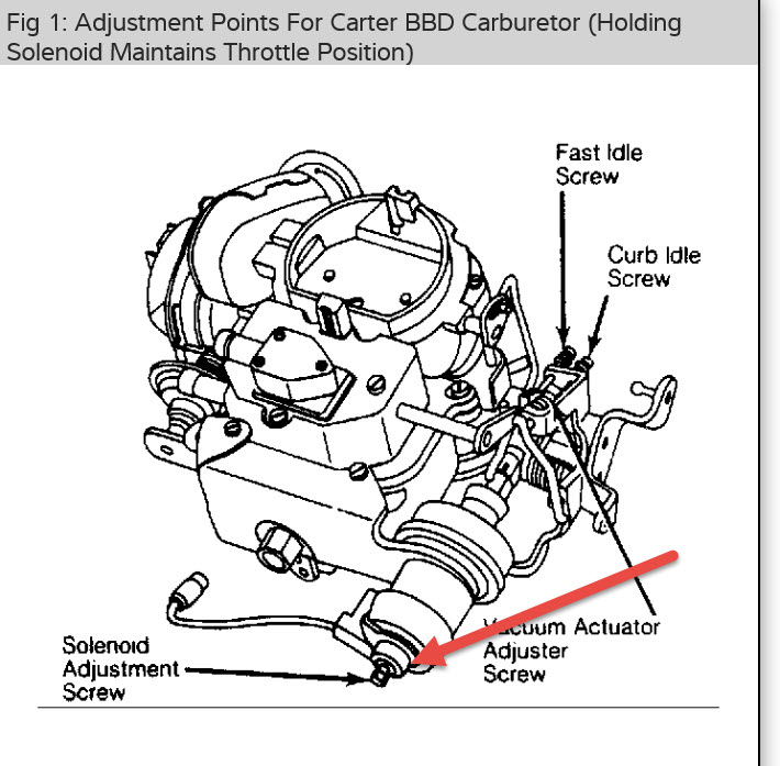

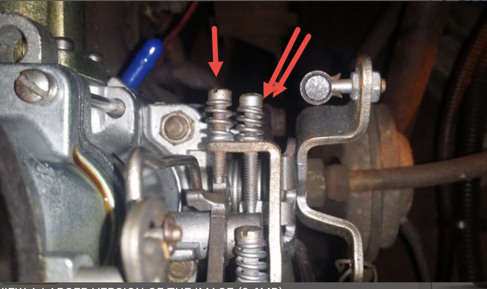

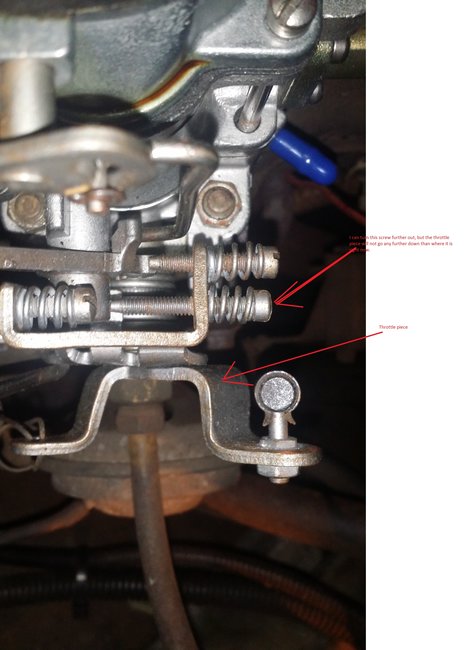

The Mix screws are not for IDLE speed per say, They get the air/ fuel mix right. The idle screw is for idle speed. Getting mad and forcing them in, kinda ruins the carb!
This was from a good while back.
It may could be re-written better.
I'm aiding a feller with a 304, I'm using my 258 as a demonstrator. Cool thing here is that all you have to do is rule out the 304 portions! Pretty much an old school 1 cylinder- a 12 cylinder sorta tunes the same. Here's the link.
https://www.2carpros.com/questions/jeep-cj7-1985-jeep-cj7-stalls-when-hot
