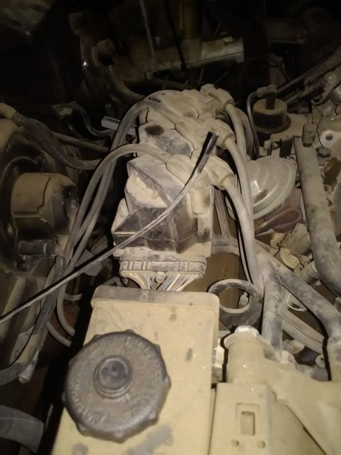

There is vacuum to the valve,but no hose goes to the firewall. So I need to find that vacuum. I'm going to keep looking. The valve does work.

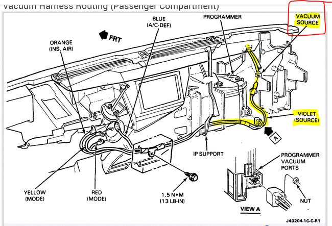

Yes, if you follow the supply hose from behind the controller, it should lead you to where it is coming into the vehicle. All you need to do is run a new line to it if needed. Take vacuum right from the intake manifold.
Let me know if I can help.

How can I find out which line is the supply hose?
Mar 22, 2021 at 2:17 PM (Merged)

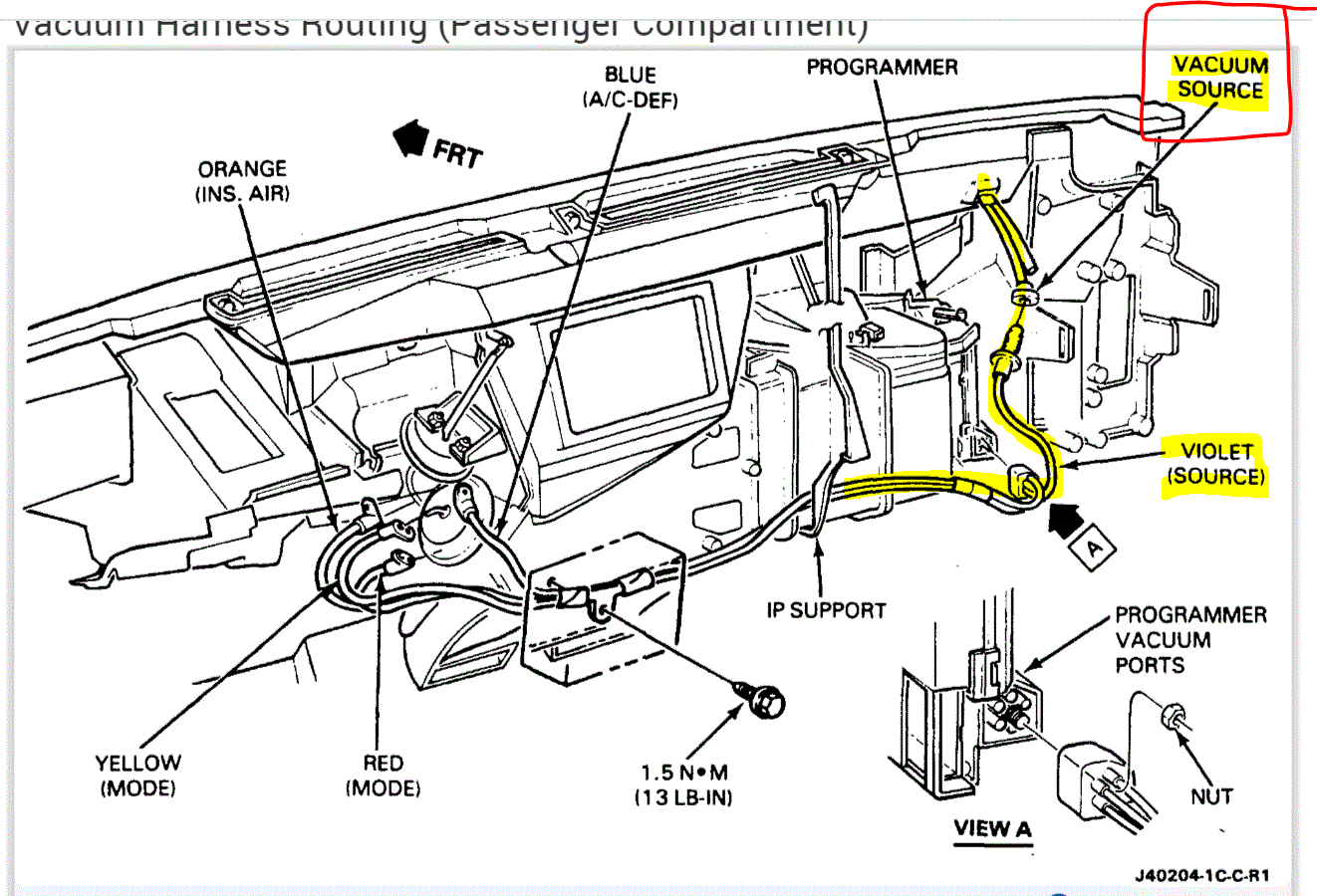

Take a look at the attached pic. Let me know if that is what you needed.
BUICK_DUDE
  • 91 POSTS
Turns out the engine vacuum line was plugged into the vacuum box port and the second port did not connect to the violet line. Bypassed the airbox (for now) and connected the engine vacuum directly to the violet vacuum line and the A/C blew from the dash vents!
