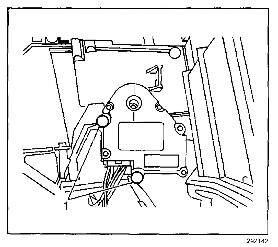

This happens when the right or left temperature blend door actuator goes out. This guide can show you how a typical system works and where the actuators are located. I have included diagrams for your car below.
Yes, it is an easy replacement. It is under the dash, left side.
I attached a picture and the procedure for you to view.
1. Remove the left side sound insulator.
2. Remove the knee bolster.
3. Remove the Instrument Panel Module (IPM).
4. Disconnect the electrical connector from the air temperature actuator.
5. Remove the air temperature actuator retaining screws (1).
Check out the diagrams (Below). Let us know what happens and please upload pictures or videos of the problem.

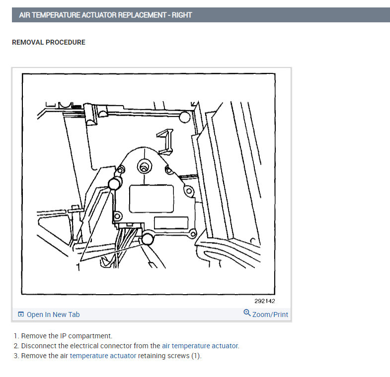

The code s for the actuator. I attached the description below as well as the instructions for replacing the actuator.
It is behind the glove box.
REMOVAL PROCEDURE
1. Remove the IP compartment.
2. Disconnect the electrical connector from the air temperature actuator.
3. Remove the air temperature actuator retaining screws (1).
4. Remove the air temperature actuator.

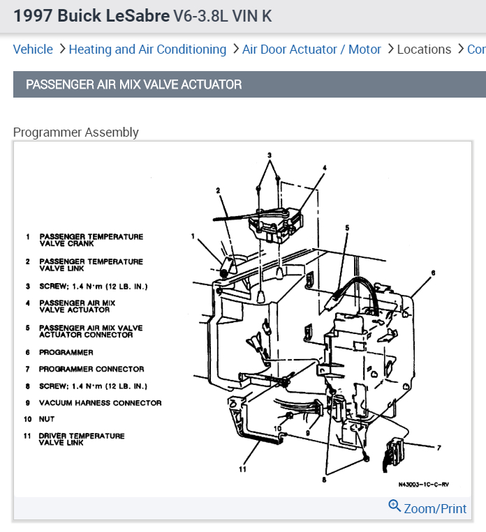

JEFF SCOTT WOOLEY

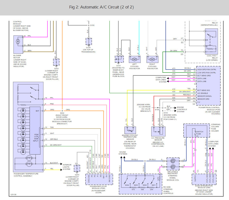

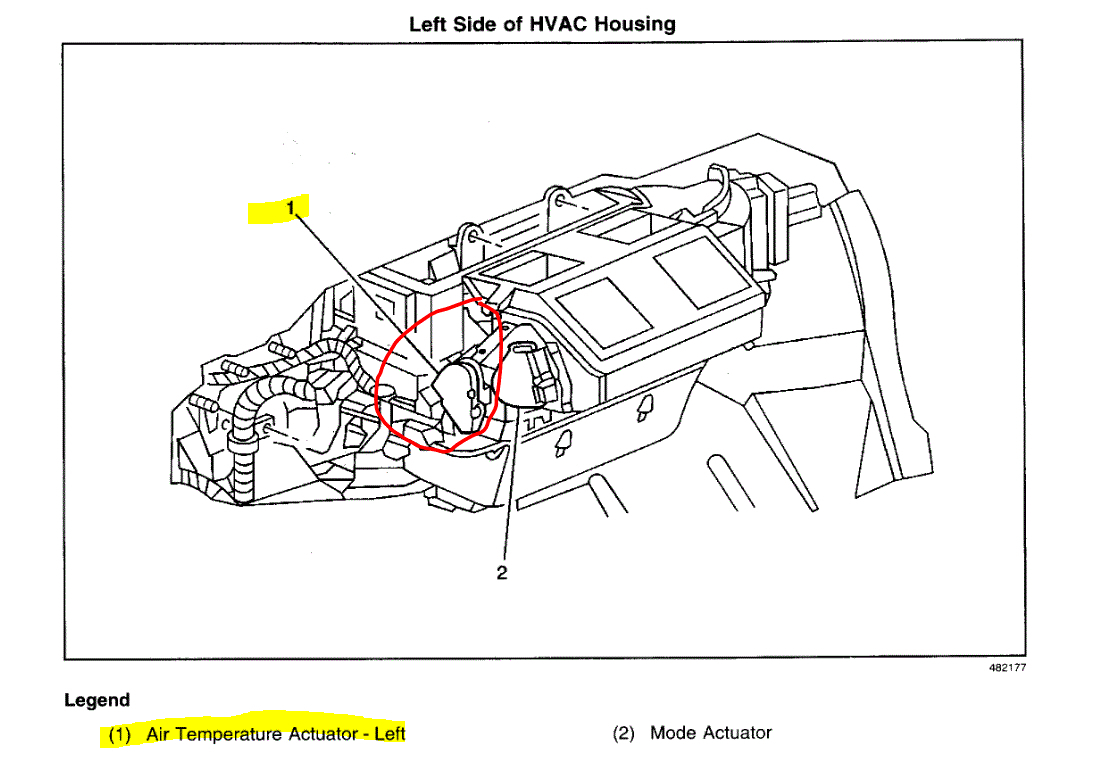

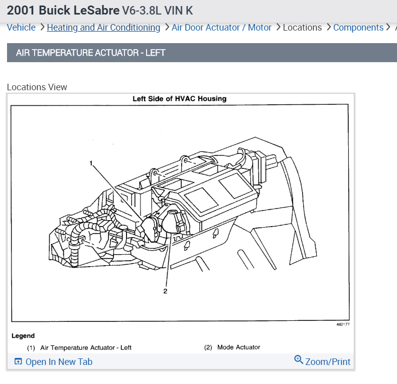

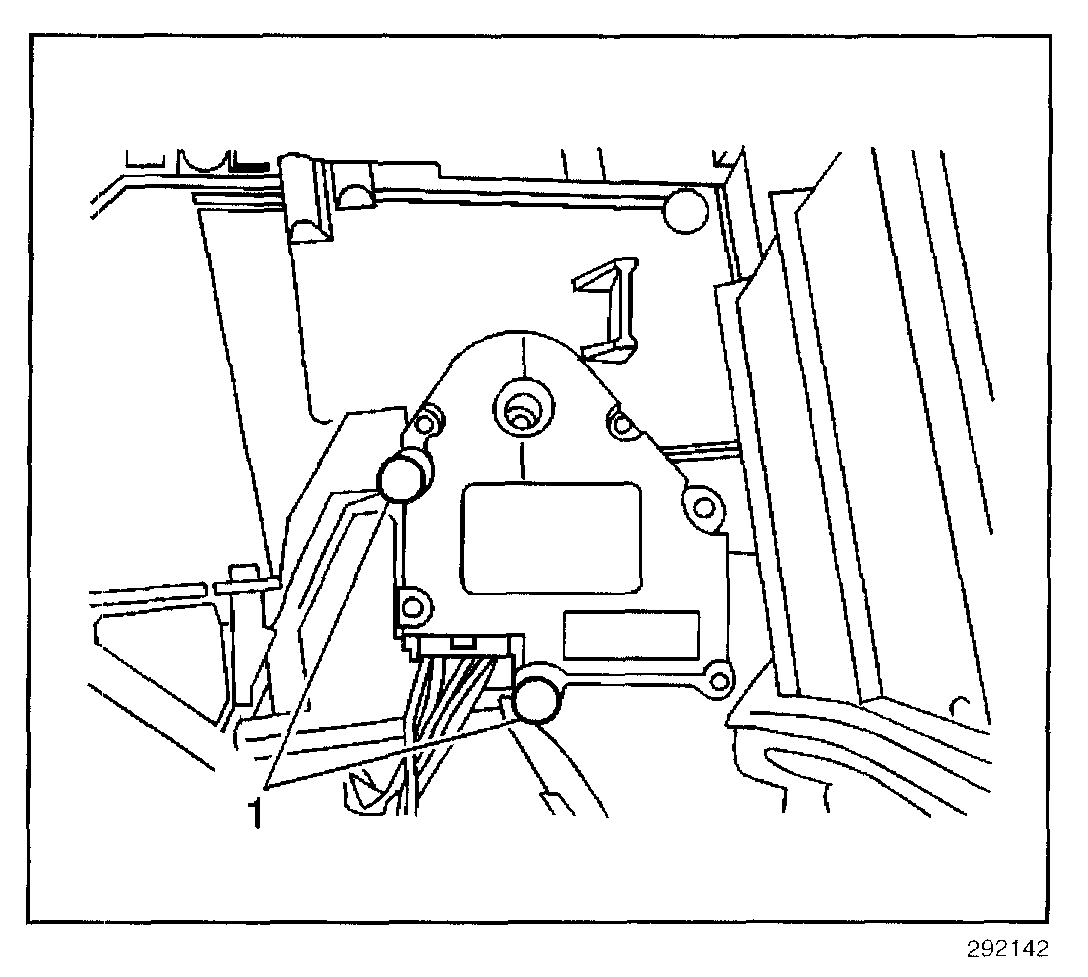

Heat blows fine on passenger side but cold on driver's side. I have located the blend door actuator behind the glove box, but I don't know if there is another one for the driver's side. It is the car listed above Limited model with digital temperature control.
Mar 22, 2021 at 2:15 PM (Merged)

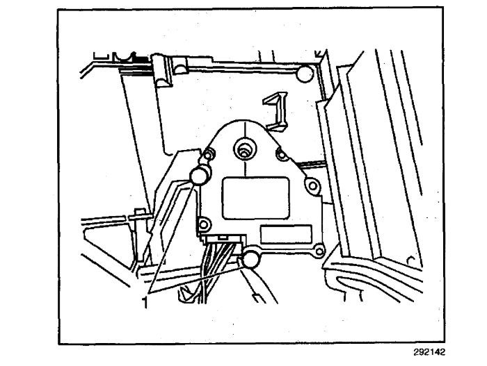

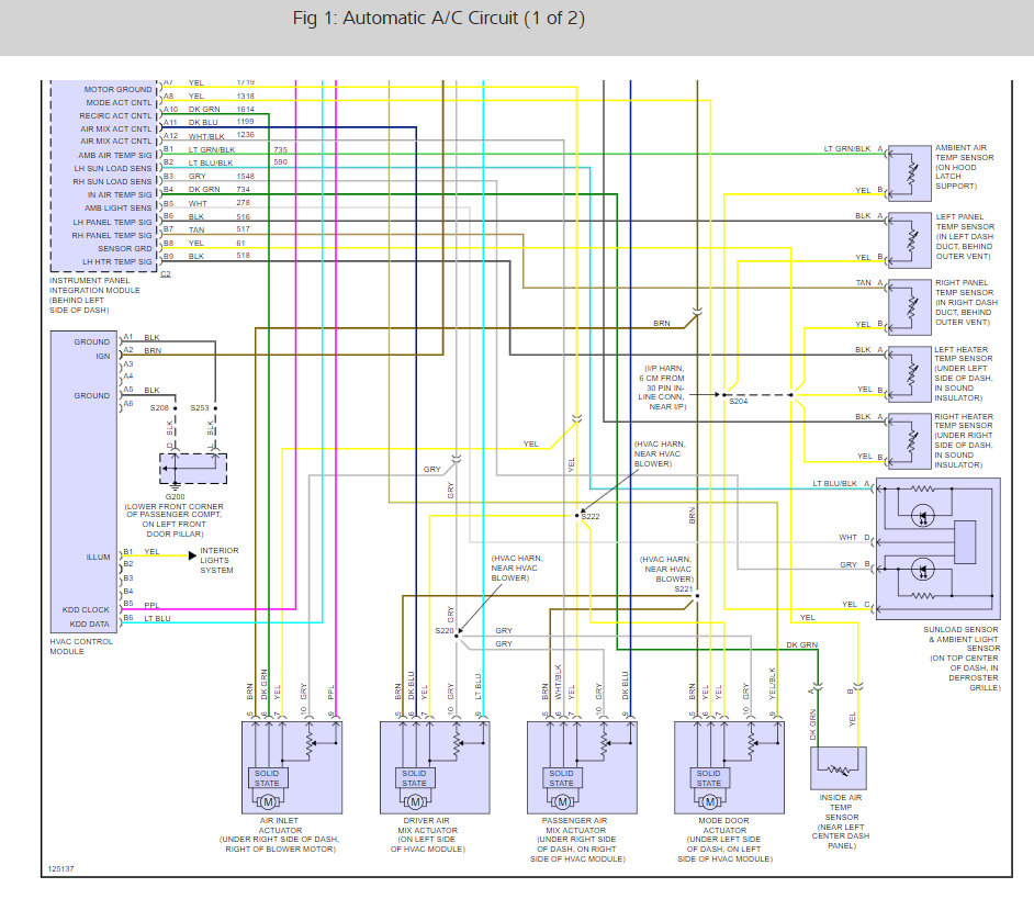

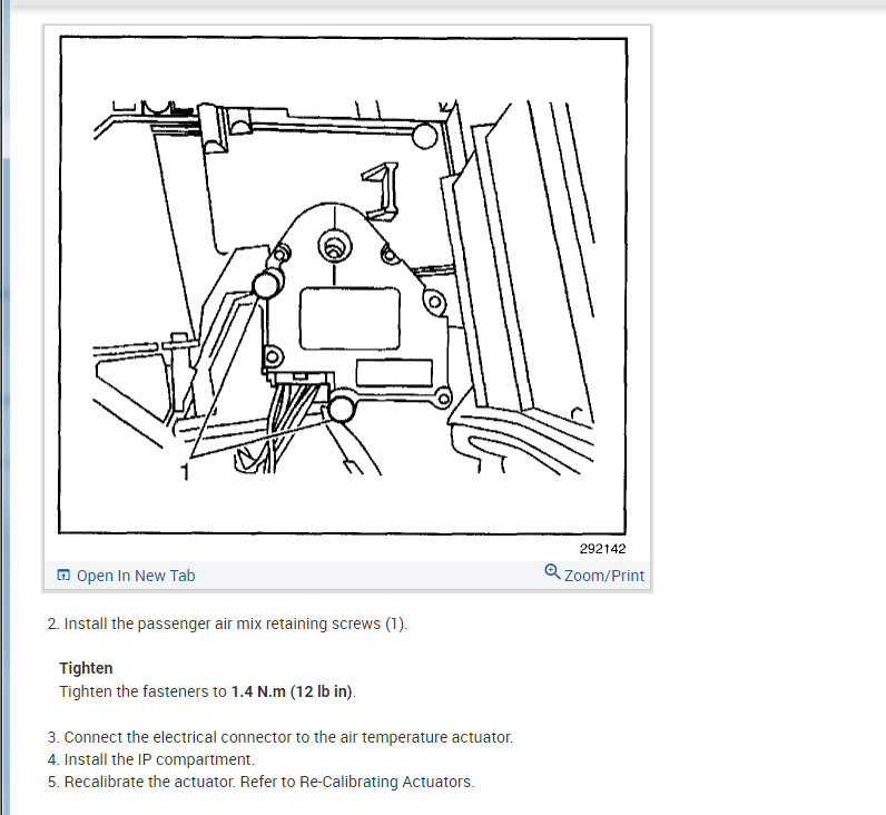

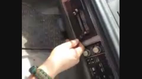

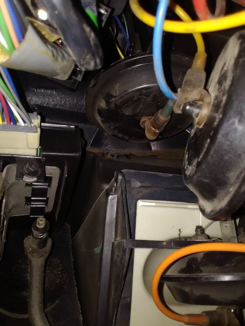

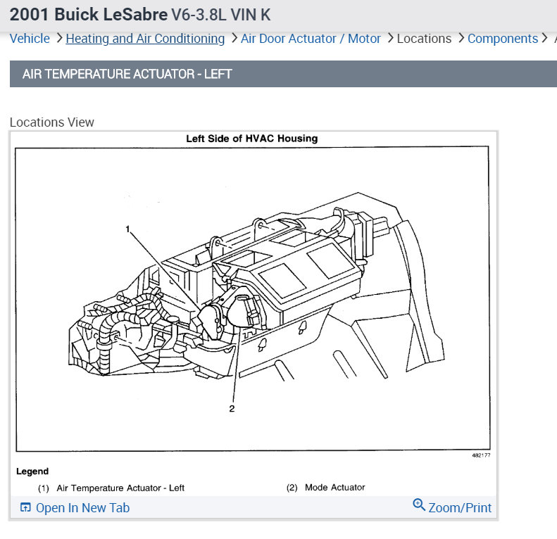

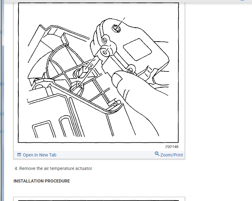

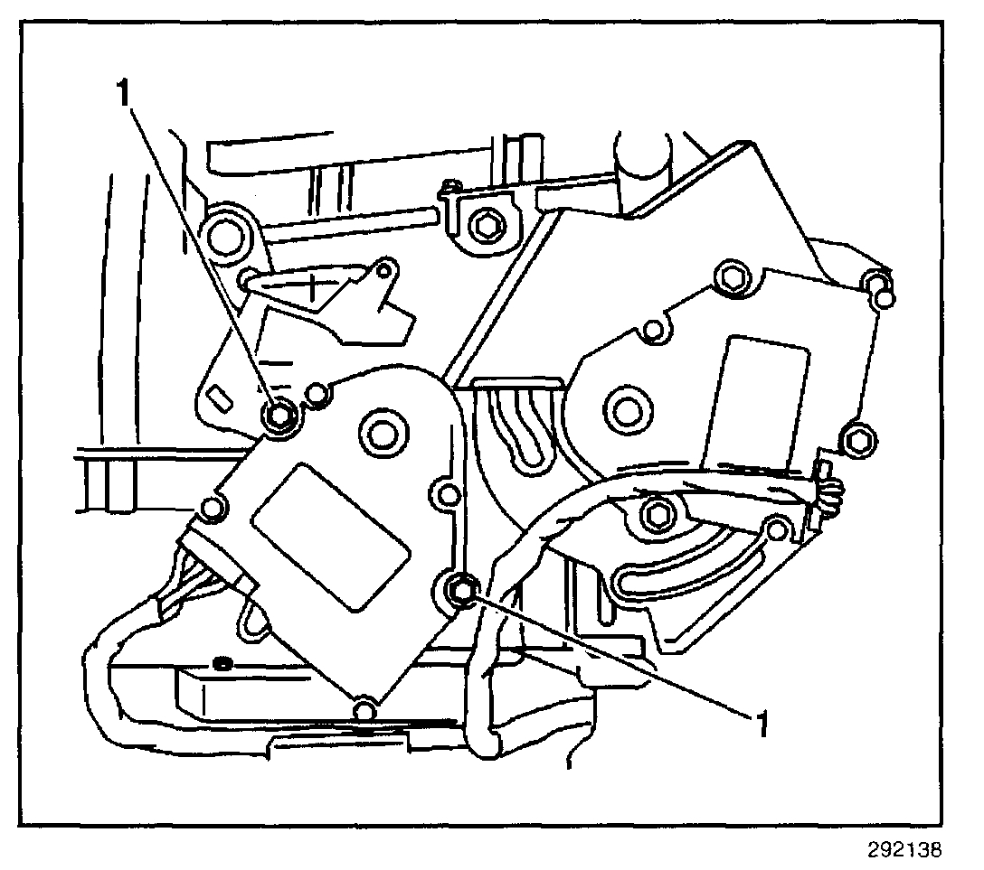

You will have a separate one for the left side (driver's side). See picture 1
Now, there are two different systems, automatic temp control and manual. I will provide the directions for both. I will start with the automatic system. The attached pics correlate with the directions.
____________
2001 Buick LeSabre V6-3.8L VIN K
Air Temperature Actuator Replacement - Left
Vehicle Heating and Air Conditioning Air Door Actuator / Motor Service and Repair Procedures HVAC System - Automatic Air Temperature Actuator Replacement - Left

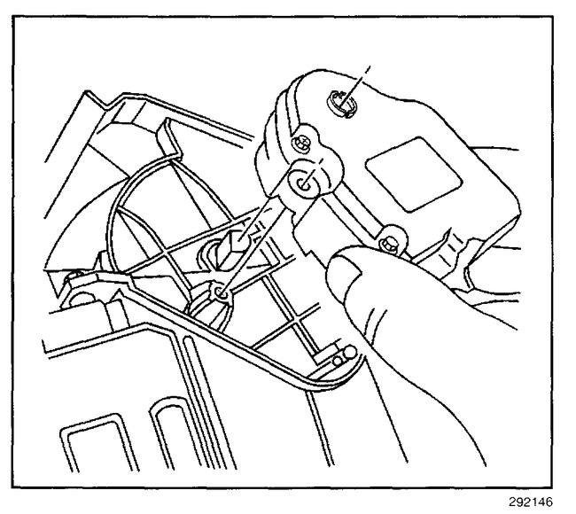

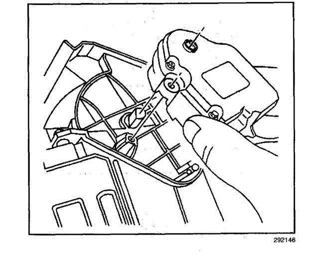

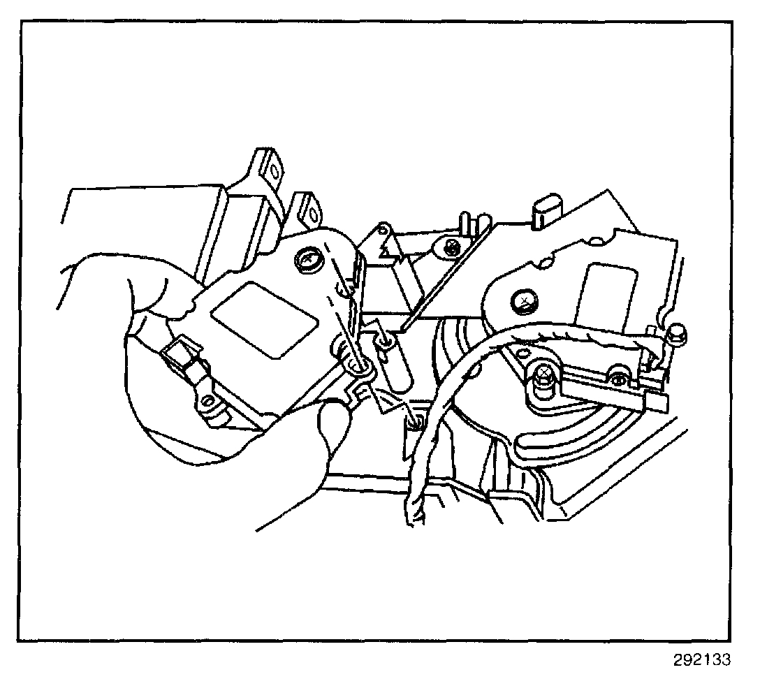

AIR TEMPERATURE ACTUATOR REPLACEMENT - LEFT
REMOVAL PROCEDURE
pic 2
1. Remove the left side sound insulator. Refer to Closeout/Insulator Panel Replacement - Left in Instrument Panel, Gauges and Warning Indicators.

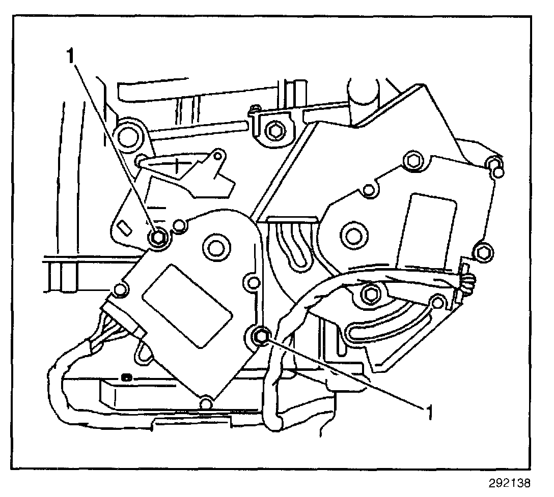

pic 3
6. Remove the air temperature actuator.

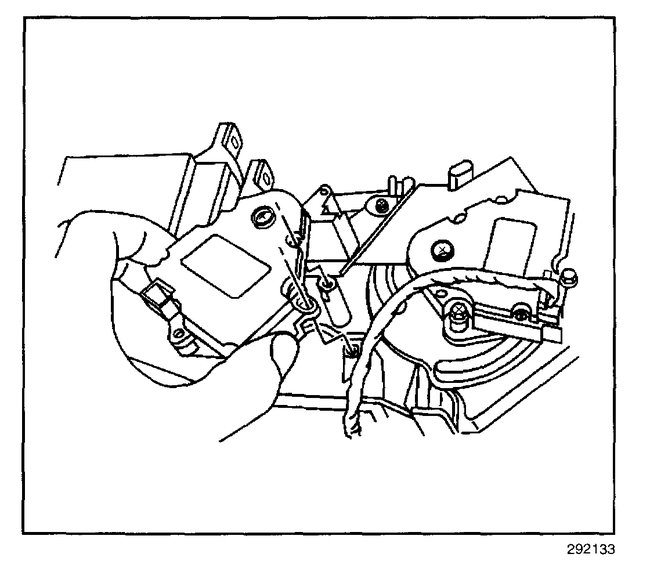

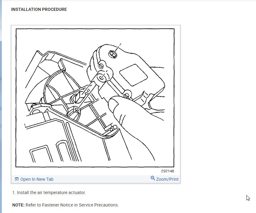

INSTALLATION PROCEDURE
pic 4
1. Install the air temperature actuator.
NOTE: Refer to Fastener Notice in Service Precautions.

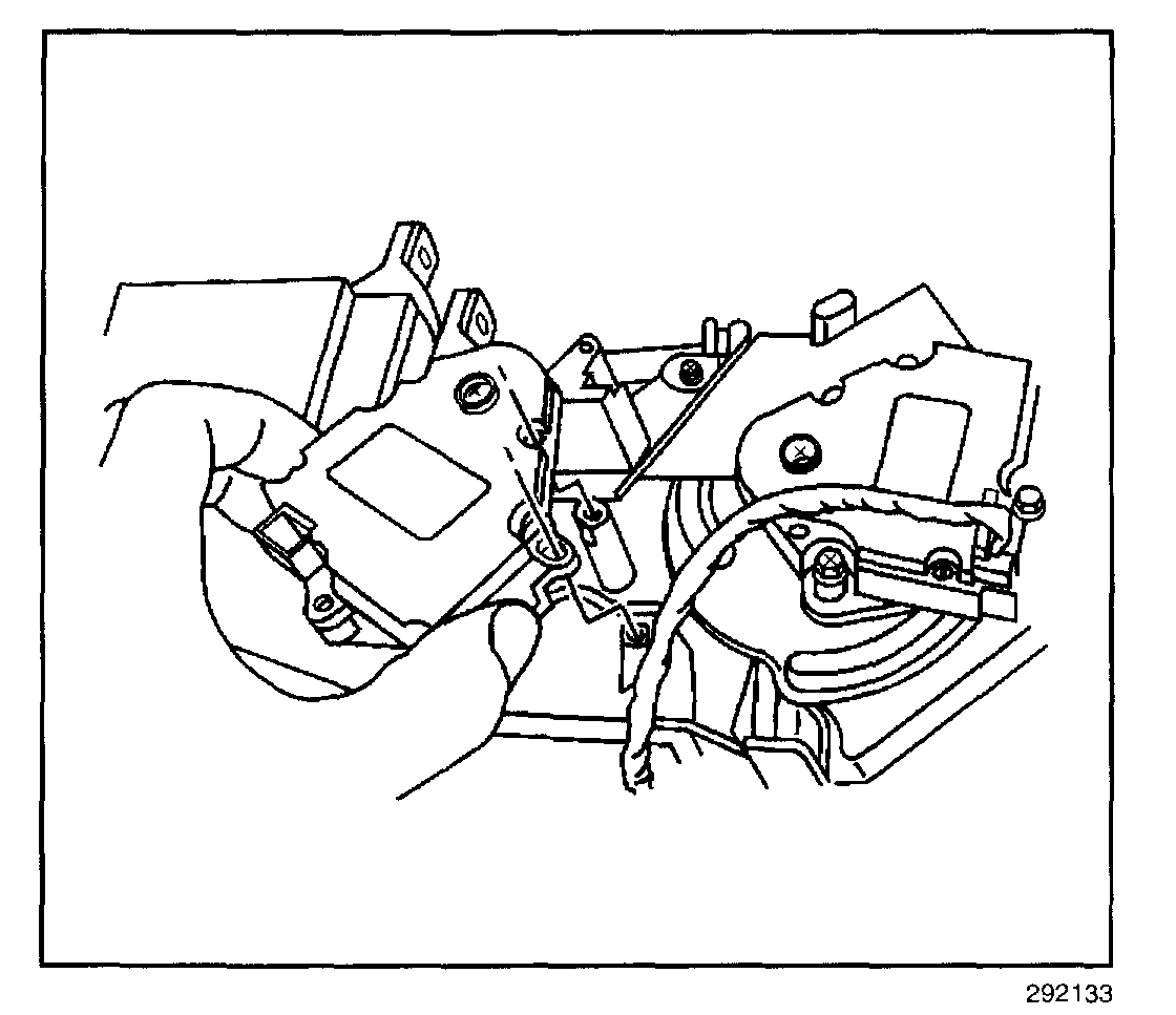

pic 5
2. Install the driver air mix retaining screws (1).
Tighten
Tighten the fasteners to 1.4 N.m (12 lb in).
3. Connect the electrical connector to the air temperature actuator.
4. Install the IPM.
5. Install the knee bolster.
6. Install the left side sound insulator. Refer to Closeout/Insulator Panel Replacement - Left in Instrument Panel, Gauges and Warning Indicators.
7. Recalibrate the actuator. Refer to Re-Calibrating Actuators.

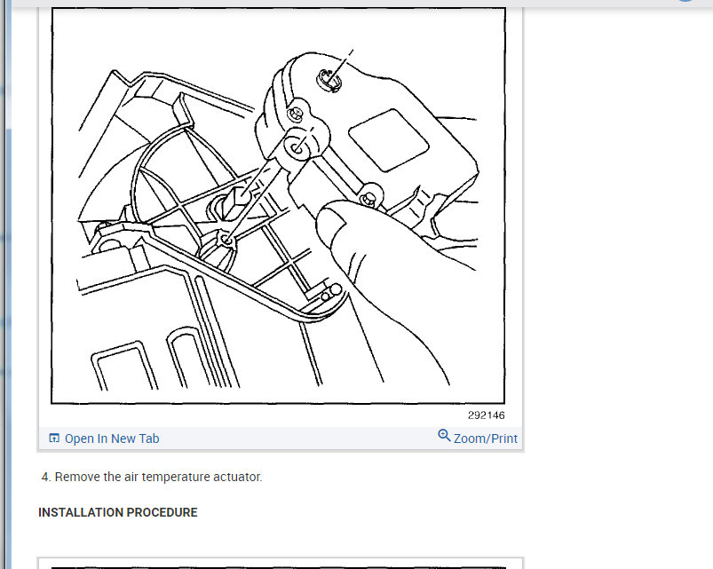

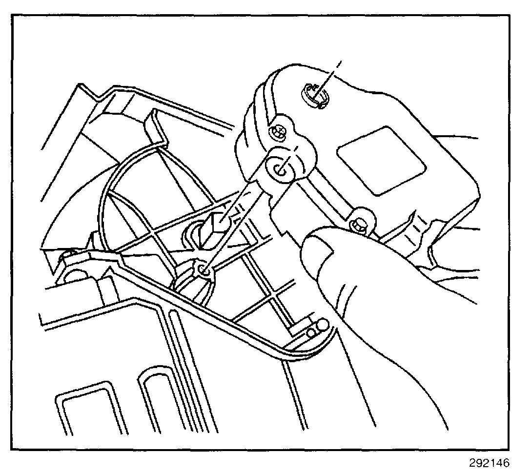

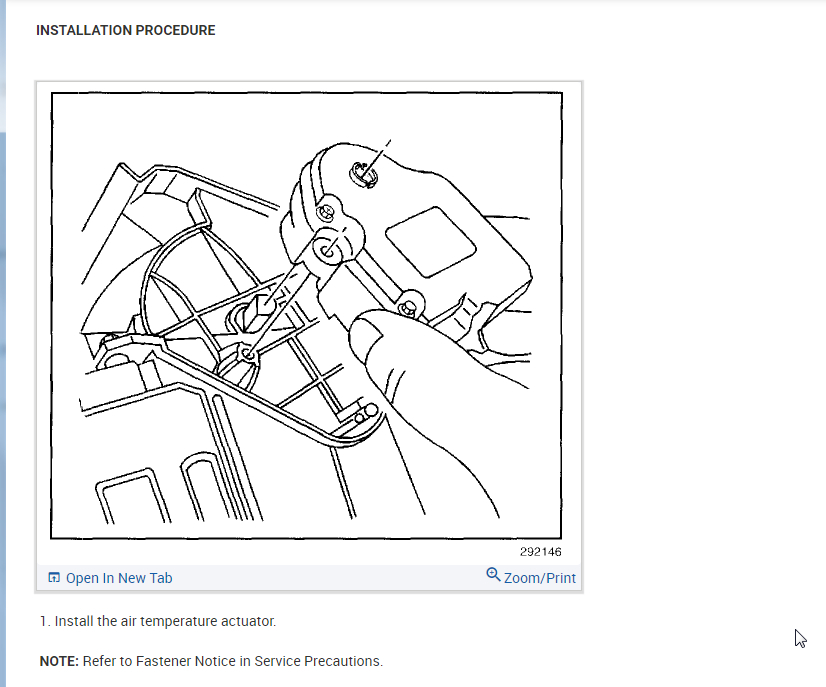

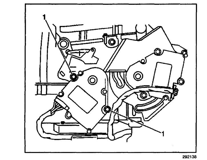

If you have manual temp control, it should only have one actuator. Here are the directions for that.
Vehicle Heating and Air Conditioning Air Door Actuator / Motor Service and Repair Procedures HVAC System - Manual Air Temperature Actuator Replacement

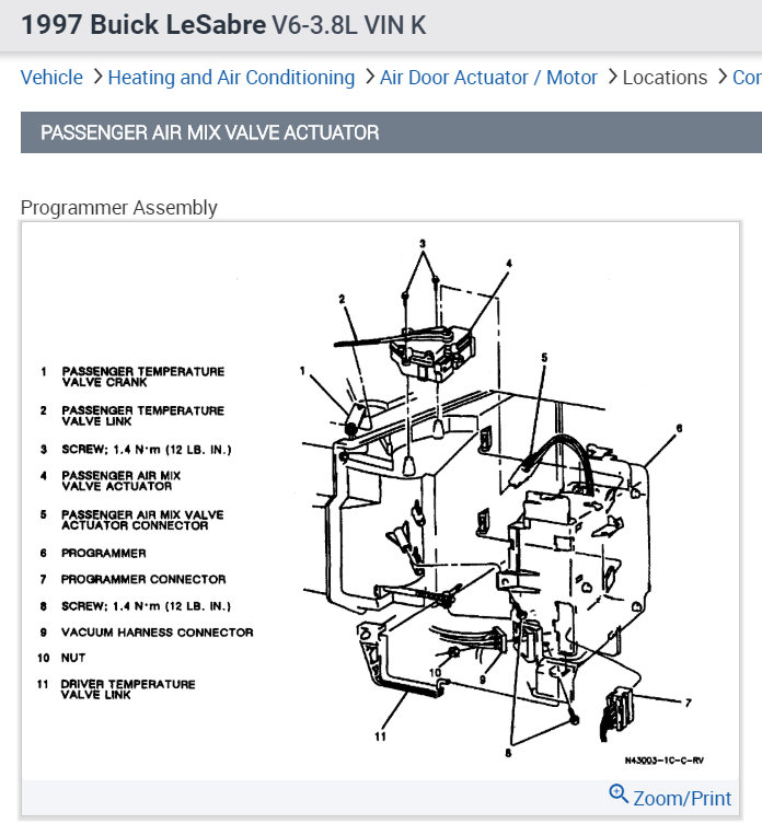

REMOVAL PROCEDURE
pic 6
1. Remove the IP compartment. Refer to Storage Compartment Replacement - IP in instrument Panel, Gauges and Warning Indicators.
pic 7
pic 8
pic 9
2. Install the air temperature retaining screws (1).
Tighten
4. Install the IP compartment. Refer to Storage Compartment Replacement - IP in Instrument Panel, Gauges and Warning Indicators.
5. Recalibrate the actuator. Refer to Re-Calibrating Actuators.

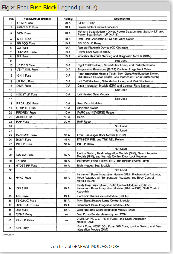

  • 48,601 POSTS

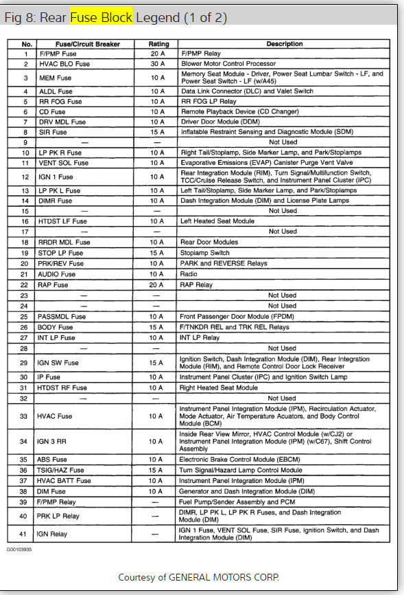

There are five fuses that run the system lets check them all for power and if okay you must have a shorted wiring causing the issue here are two guides to help us get started with the HVAC wiring and fuse diagrams below. The diagram show which fuses to test.
and
Check out the diagrams (Below). Please let us know what happens.

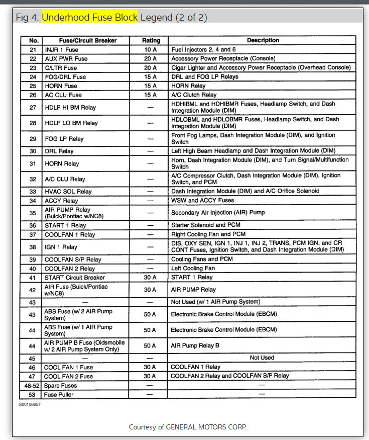

First I recommend a scan with GM scantool to retrieve fault codes, but you can try this if you want. AIR MIX VALVE 1. Remove glove box. Start engine. Set temperature control to 90 °F (32 °C). Set passenger control panel to full WARM position. If ambient temperature is greater than 90 °F (32 °C), disconnect in-vehicle temperature sensor. Allow at least 45 seconds for programmer output cranks to reach full heating position. 2. Gently pull driver air mix valve crank toward programmer until valve contacts stop. Insert threaded portion of link into slot on plastic pin on driver air mix valve crank. 3. Gently pull passenger air mix valve crank toward actuator until valve contacts stop. Insert threaded portion of link into slot on plastic pin on passenger air mix valve crank. See Fig. 1 .
https://www.2carpros.com/forum/automotive_pictures/62217_aca_2.jpg
https://www.2carpros.com/forum/automotive_pictures/62217_acb_1.jpg

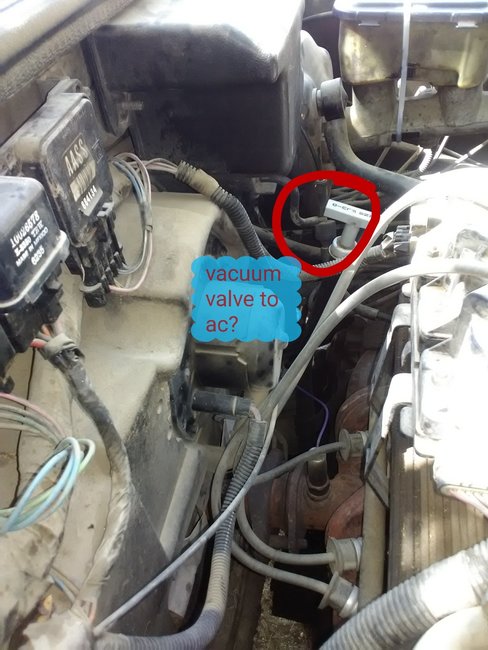

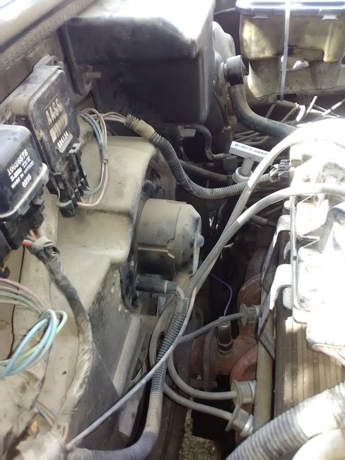

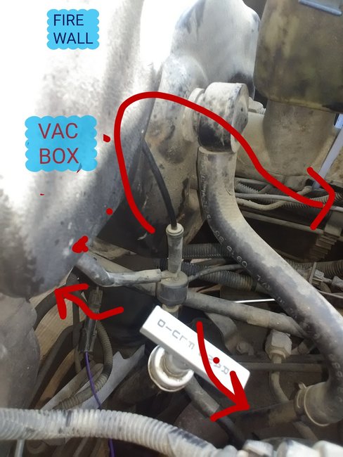

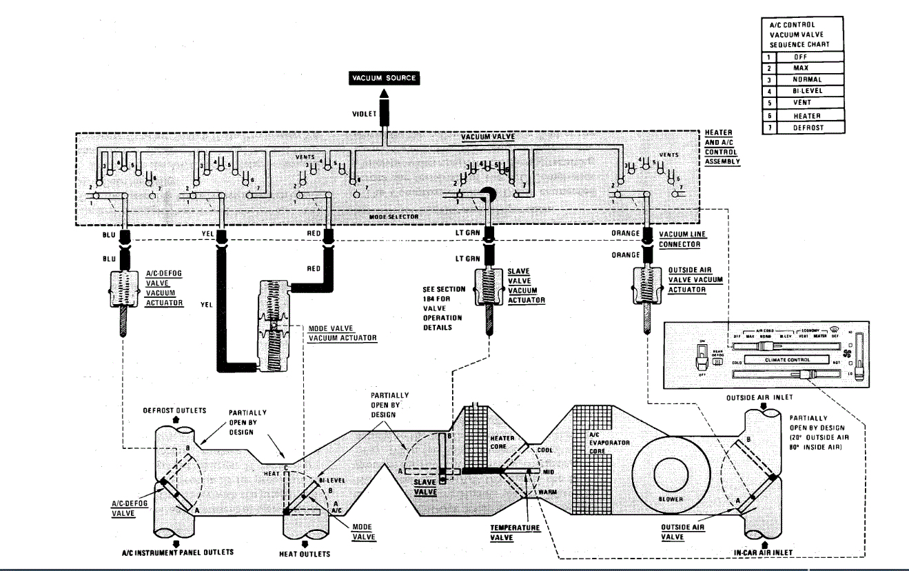

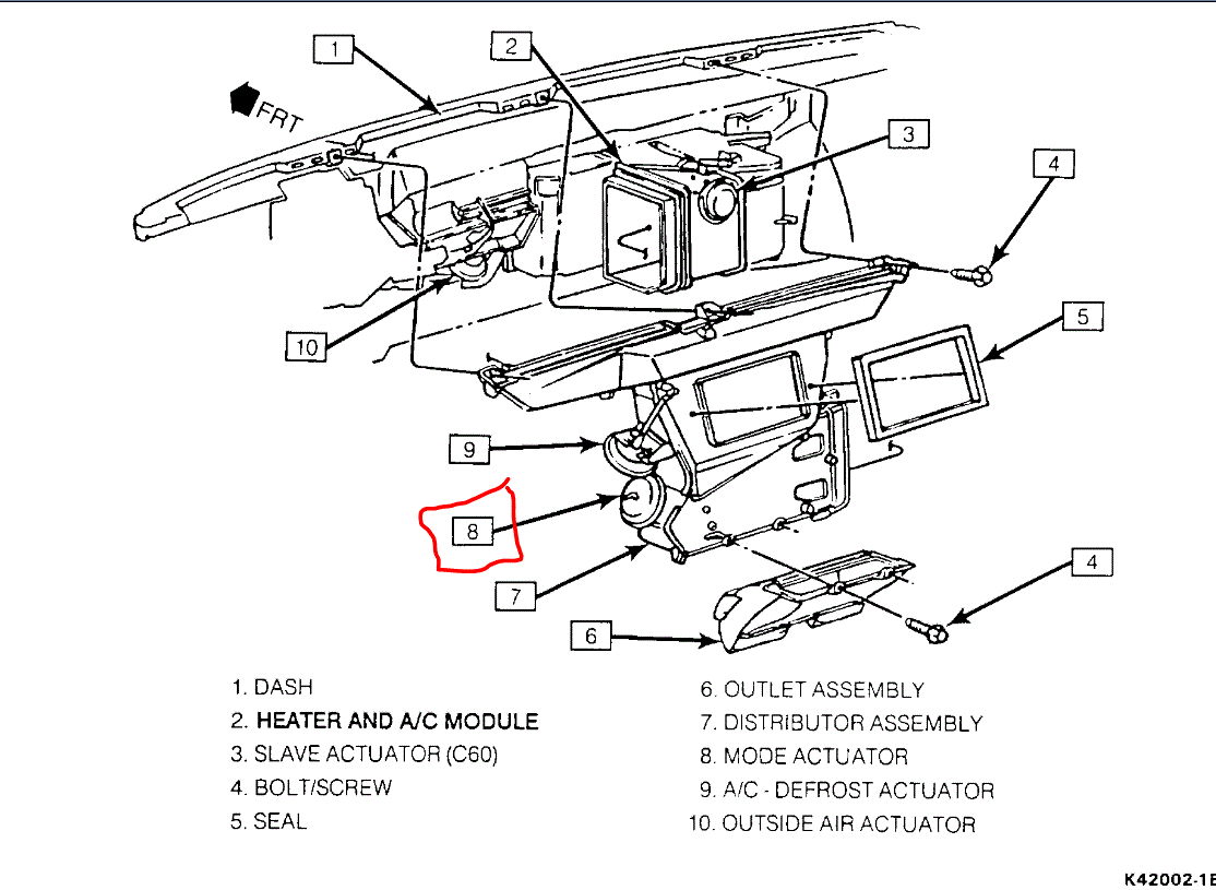

No air blows from the dash. It's a manual A/C switch with vacuum lines attached to some diaphragm looking part. All lines look to be in good shape. How can I get this blowing through the dash vents?
Mar 22, 2021 at 2:17 PM (Merged)
Does it change from floor to defroster? I attached a pic below. There are two mode door actuators. One is for the AC/defrost. It is number 9 in the pic. Number 8 is the mode door actuator. Let me know if you are able to change air flow directions to any of the other locations. If it is only A/C and the panels, check for a vacuum supply to actuator #9.
BUICK_DUDE
  • 91 POSTS
I am not able to change air flow to any other position. Air comes out from #6 assembly.

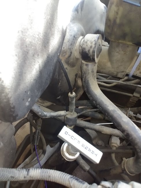

Okay, everything is at the floor. I need you to check for vacuum to the two actuators in the above pic. Do this with the engine running and let me know what you find.
BUICK_DUDE
  • 91 POSTS
There's no vacuum.
BUICK_DUDE
  • 91 POSTS
Only one nipple is connected to that vacuum box in the engine compartment.
The lack of engine vacuum is the cause. Confirm there is vacuum at the supply (the pic above). If there is, then you have a leak between the two locations. Often times with the engine at an idle, you can hear a hissing sound. Also, the plastic vacuum hose they used is commonly known to break.
So, behind the dash on the selector control head, check for vacuum from the engine and make sure nothing is cracked or damaged there. I attached a pic of the vacuum schematic on the rear of that unit.
Let me know what you find.

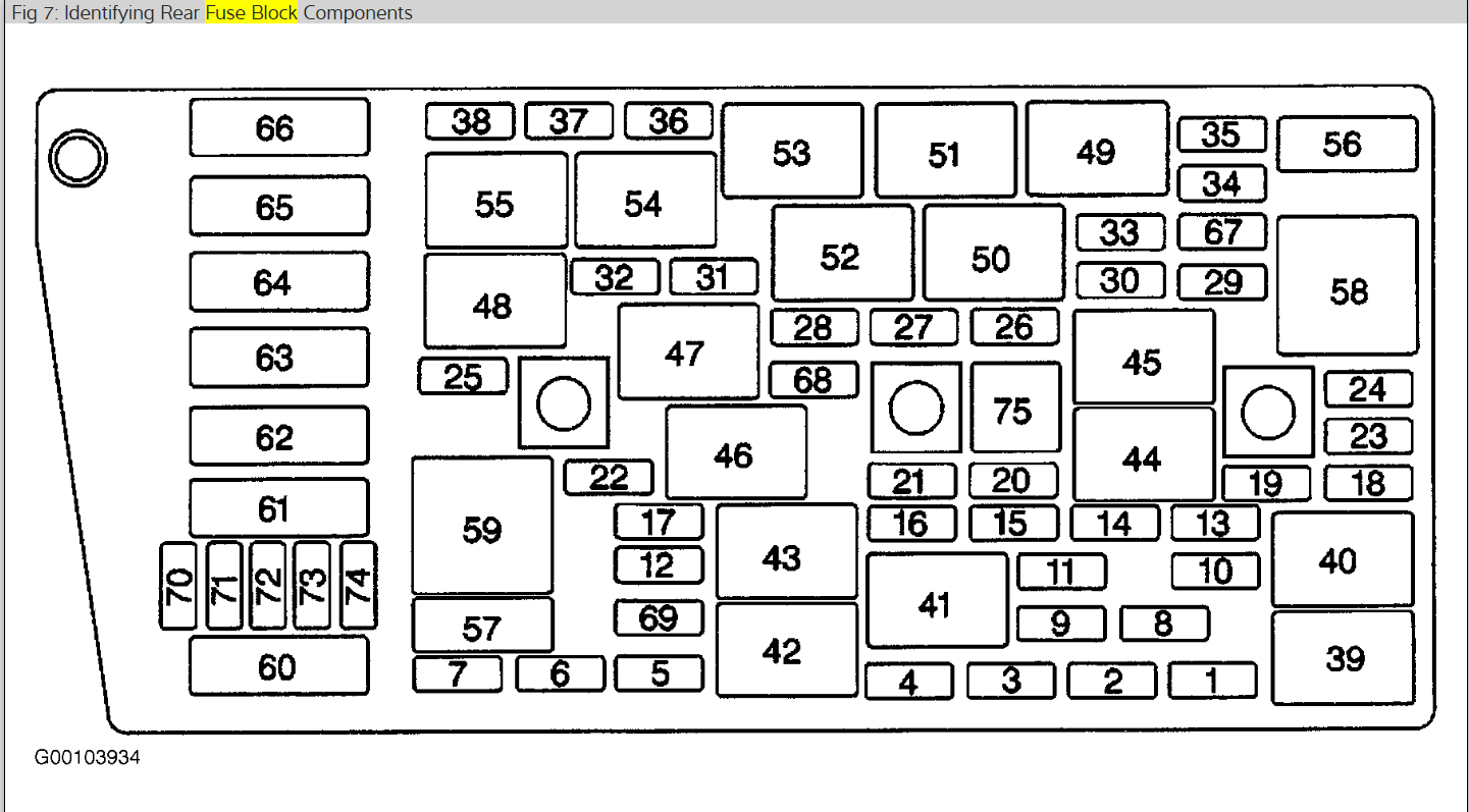

Checked behind the temperature control and all seems good. Can't seem to find the vacuum coming from the firewall. There is no vacuum at all to the switch or the junction lines where the hoses connect.
BUICK_DUDE
  • 91 POSTS
Oh, so that is the vacuum valve for the A/C?
BUICK_DUDE
  • 91 POSTS
If so, then I do not know where it's missing a hose because that thin black line coming from the valve goes to some EGR looking thing on the engine the other to a metal vacuum line from the engine and the vacuum hose to one of the connectors on the vacuum box.

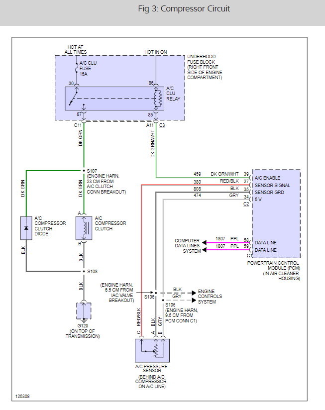

I believe that's it. Is there vacuum to the lines in pic 3? If there isn't, follow it to the engine intake manifold and see if there is a break.
