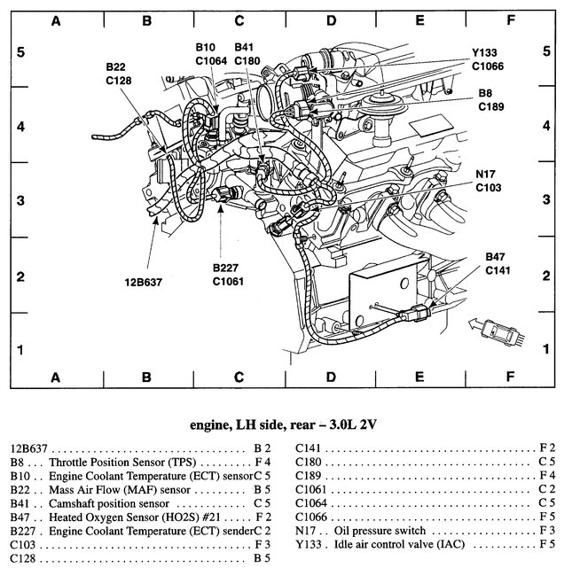

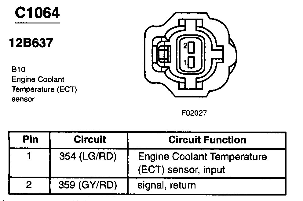

My check engine light is on. How many wires do the coolant sensor have?
Dec 10, 2018 at 4:22 PM
There are two for the coolant temperature sensor. I attached two pictures. First shows location, and the second the connector. THis guide can help find out why the check engine light is on.
Let me know if this is what you needed or if you have other questions. Check out the diagrams (Below). Please let us know what you find. We are interested to see what it is.

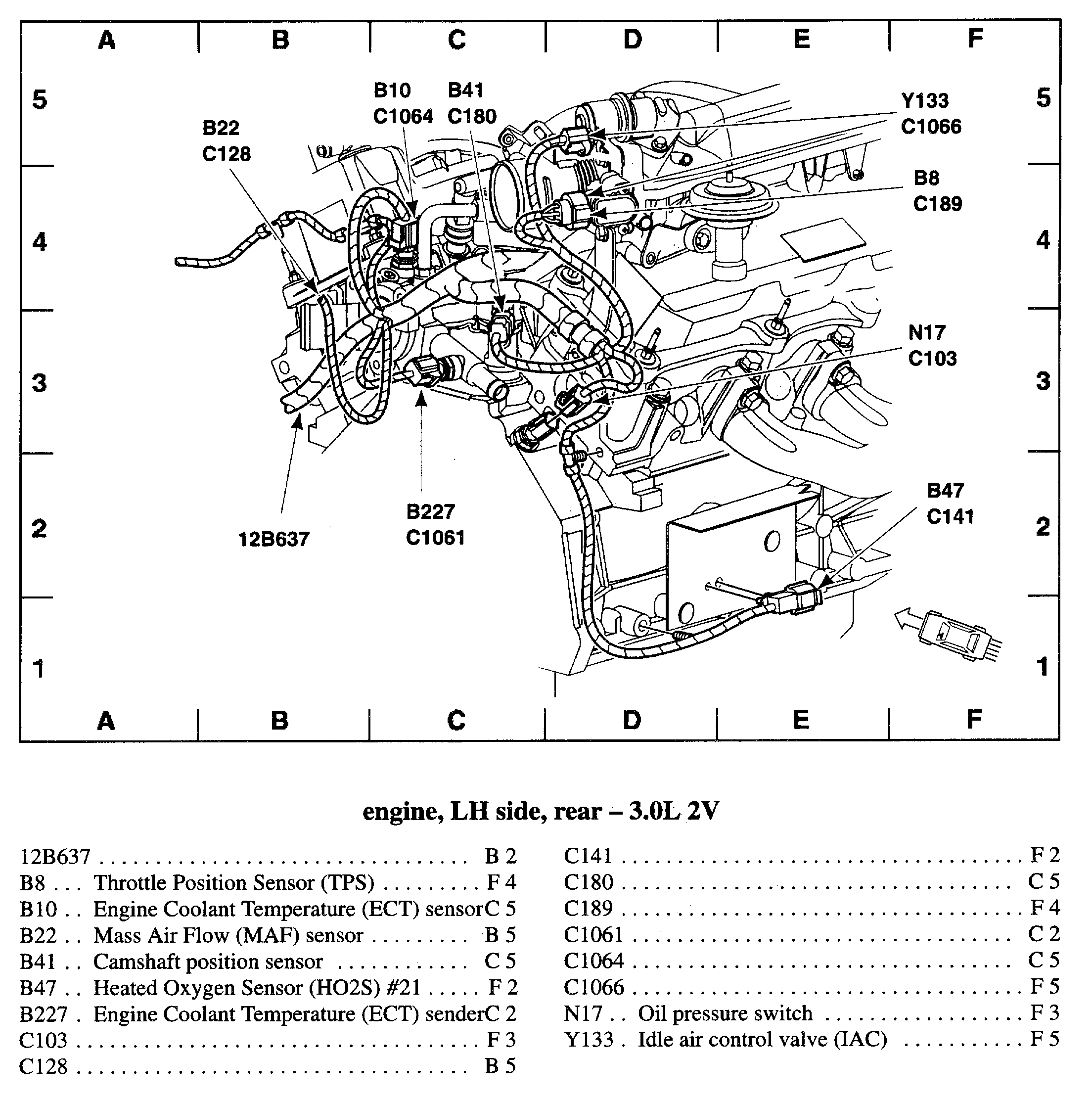

Most common cause for both codes at same time is vacuum leak, pluged hoses or pinched, cracked hose. see diagram make sure all hoses are good and flow.
