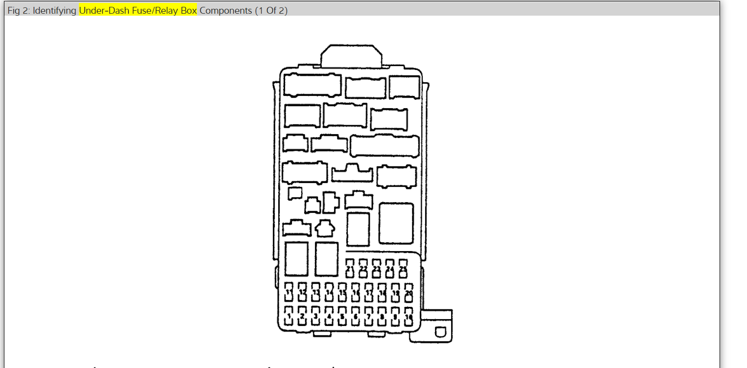

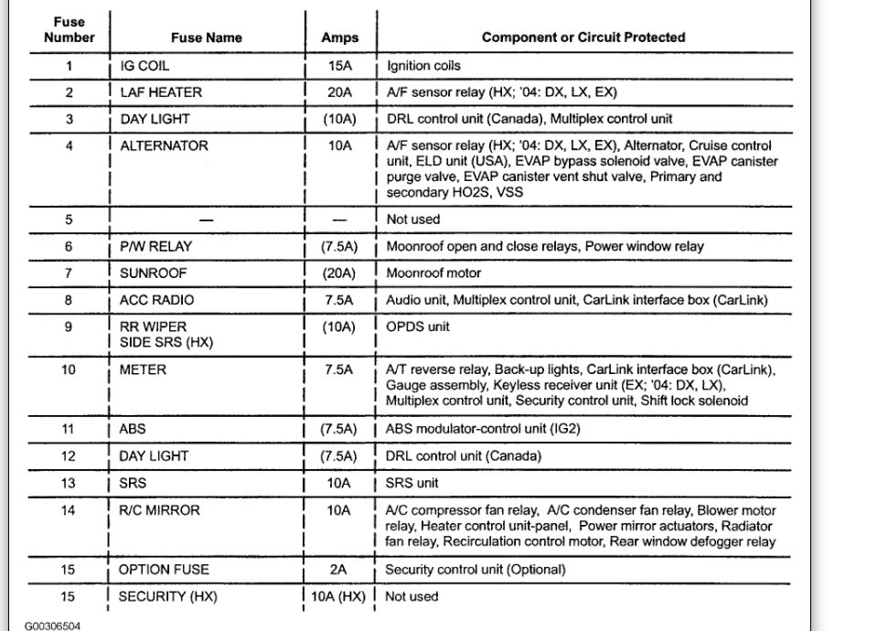

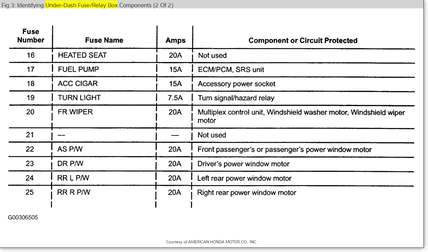

Yes it could be the flasher/hazard relay. Or it could be fuse #2 or #5 in the under hood fuse box. Here is a guide to help test the fuse and the fuse and flasher location below.
Check out the diagrams (Below). Please let us know what you find.

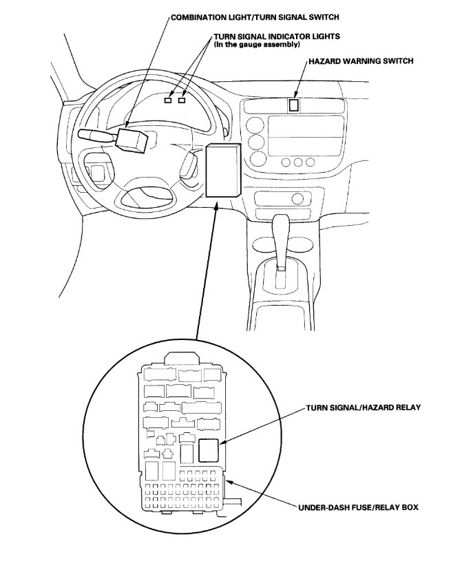

I would suspect a faulty turn signal / hazard relay. The hazards and turn signals both run off of the same relay. It is located behind the left side of the dash, on front of the underdash fuse/relay box.
https://www.2carpros.com/forum/automotive_pictures/261618_Graphic_34.jpg
May 26, 2020 at 11:58 AM (Merged)
MARKGIL15
  • 5 POSTS
so what should i change?.. can u tell me what u think that i would have to change to fix it?..what do u think the broken specifically??..thanks
BLUELIGHTNIN6
  • 16,542 POSTS
The relay...replace the faulty flasher relay
