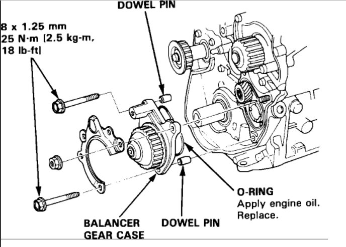

Well, we got around to fixing it now that the weather is tolerable. It wasn't the front crankshaft seal and it wasn't the oil pump housing seal gasket either, so both your guesses were wrong.
It was the seal on front counterbalance shaft that caused the massive leaking. The seal had popped out from the oil pressure behind it and was riding on the shaft. There was no seal retaining fork installed, which I now understand was a recall on later model Accords. We replaced the front counterbalance shaft seal along with a seal retainer fork, the crankshaft seal, the timing belt, the countershaft belt and put in a new water pump just in case.

Hi alaskajimd,
At the front of the engine, there are :

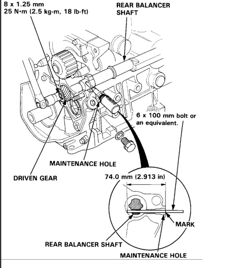

1. Camshaft oil seal.
2. Crankshaft oil seal
3. Front balancer oil seal.
4. Rear balancer oil seal and O ring.
5. Valve cover gasket.
Any of the above can cause the leaking and the most likely condition is that one of the seals has popped itself from its seat.
You would need to remove the timing belt cover to check the source and the job would depend on what needs to be replaced. With so much oil being dispensed, I believe the timng belt and related parts needs to be replaced as well.
Wihout understanding the extend of the damage, it would not be possible to provide any estimated repairs and prices ranges region to region so it is bets to get some local quotes.

These vehicles had a tendancy to pop their balancer shaft seals.This is under the timing belt cover.
There are countless other places where they could leak but without more information its hard to be more specific.

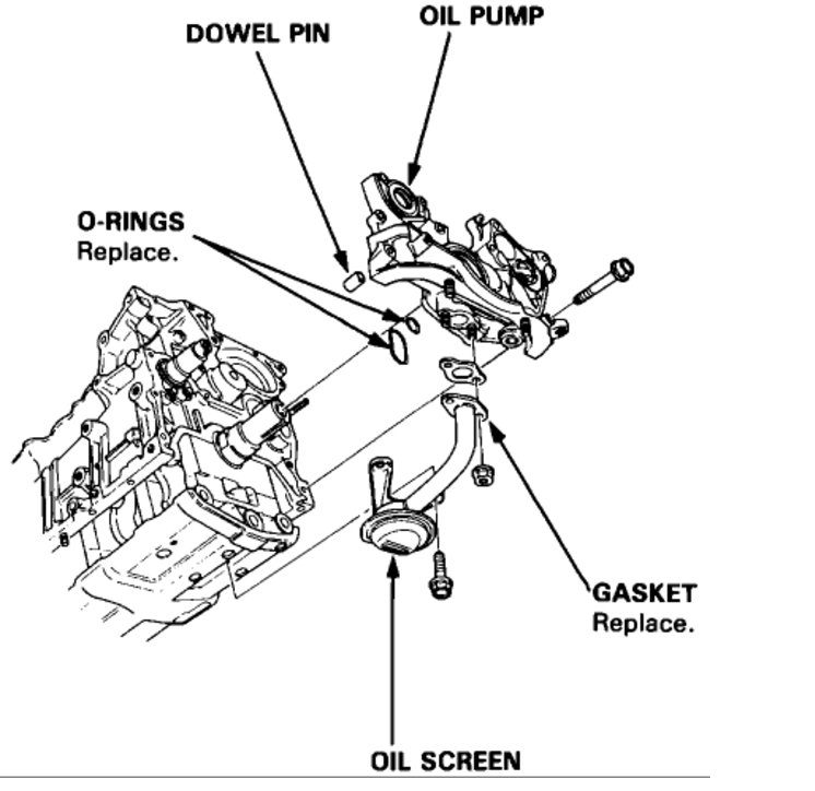

There is an oil pump o ring seal that sits in the front of the engine just behind the timing belt. We see them leak from there all the time.
Here is a guide and some diagrams to help you get the problem fixed.
https://www.2carpros.com/articles/engine-is-leaking-oil
Please let us know what happens and upload pictures or videos of the problem.
