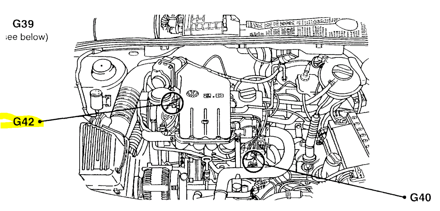

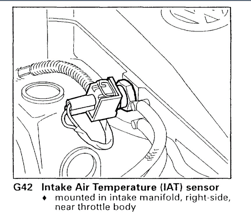

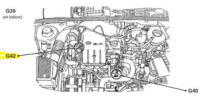

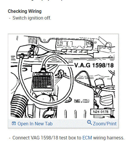

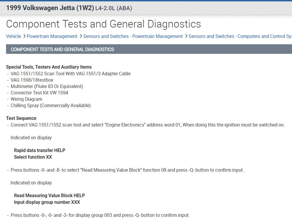

It's on the intake. Take a look at the two pics I attached below and let me know if you are able to find it.

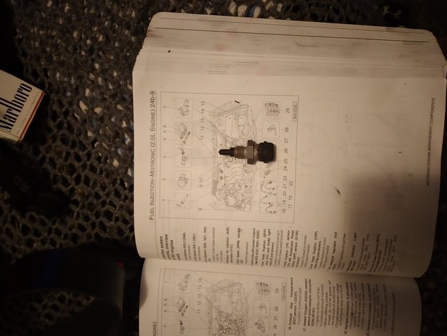

Okay, where is this intake air temperature sensor? i ordered one and this is the one they sent me.

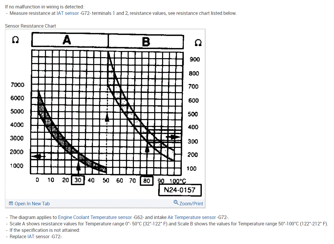

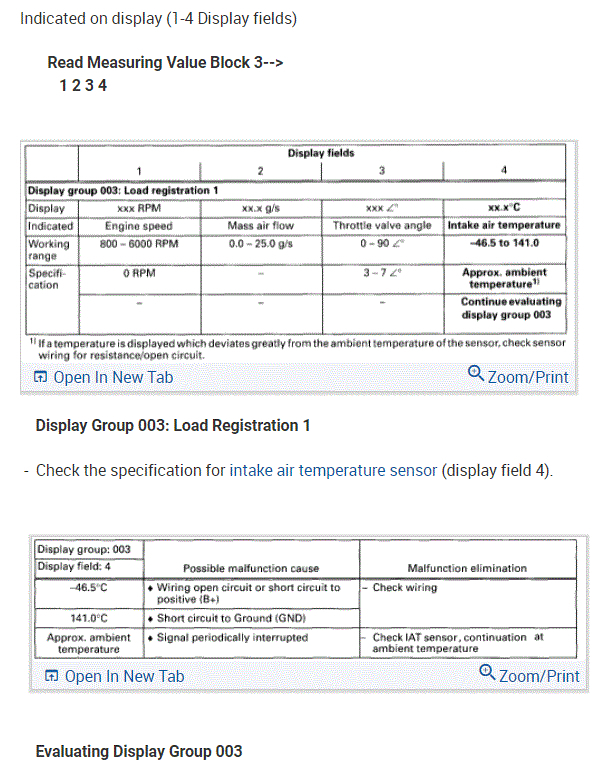

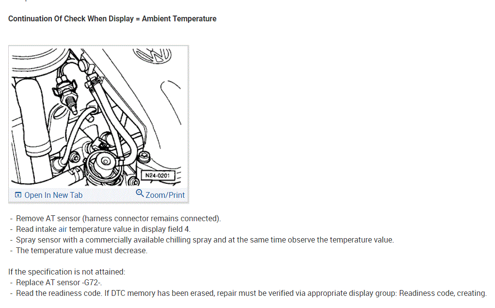

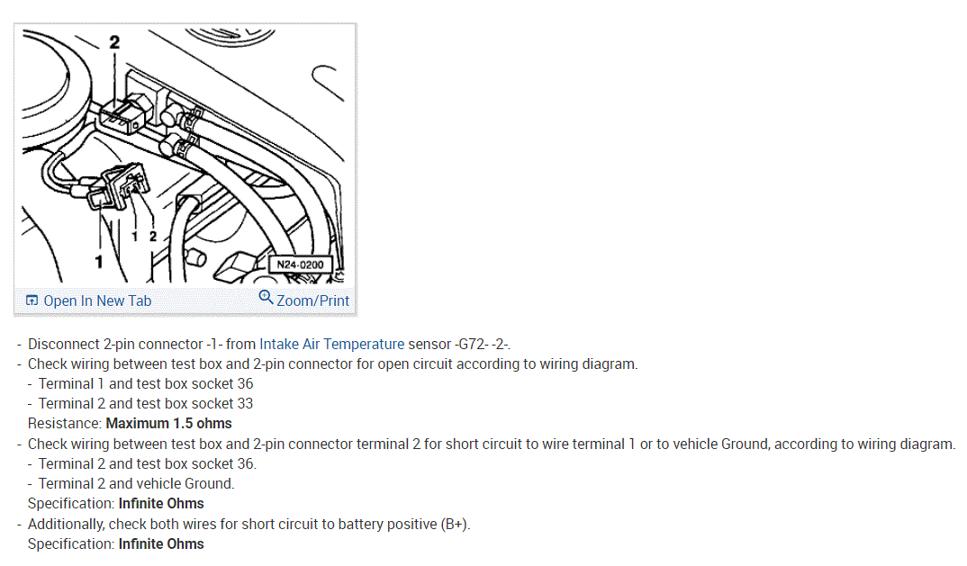

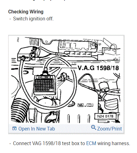

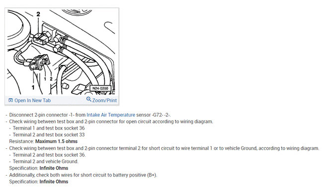

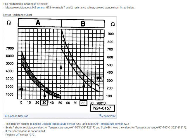

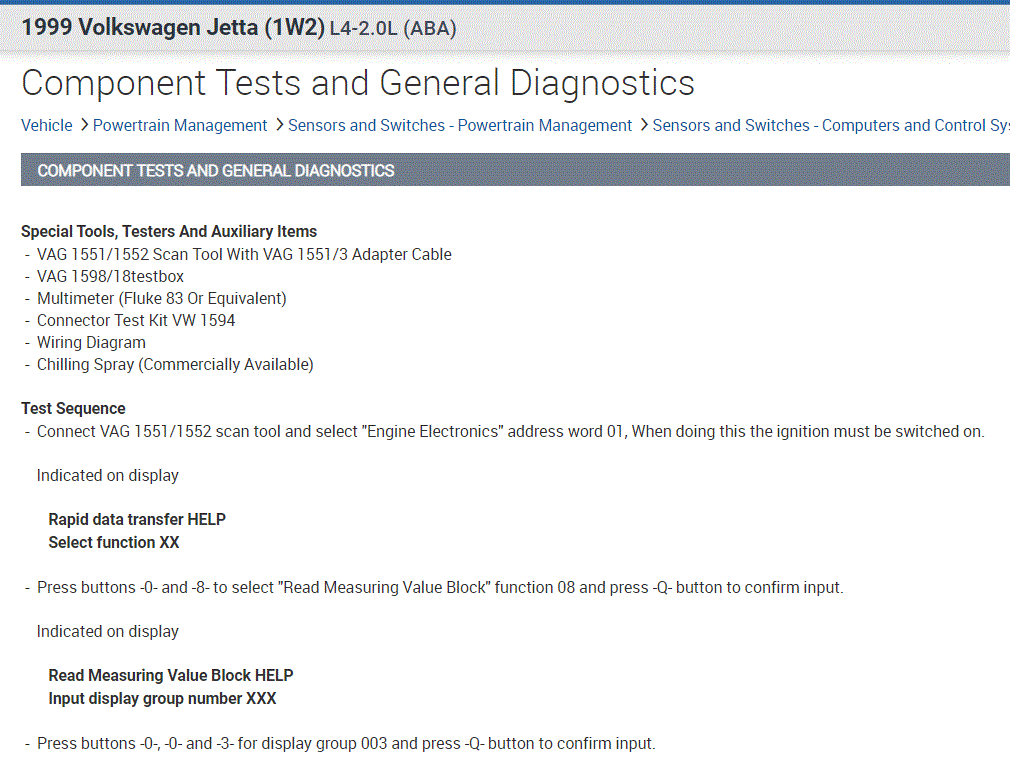

That is correct. The two are combined.
The problem is likely in the wiring. Clear the code and try a wiggle test to see if the code resets right away.
Other than that, you need to perform the diagnostics located below. It requires specific VAG tooling to complete. If you look at pic 1 below, it lists the things needed.
Let me know if this helps.
