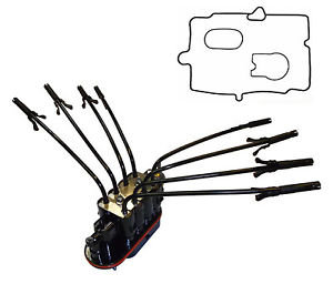

Sorry to bother you Roy, I cannot seem to find any way to test a CSFI system with a noid light.
Could you send me some reference or guides?
Sep 11, 2018 at 3:37 PM
Does this have eight injectors or just two on the throttle body?
Sep 11, 2018 at 3:41 PM
KEITH LOTHROP
  • 46 POSTS
8 poppet valves in a CSFI.
Sep 11, 2018 at 11:41 PM
Okay, that system you cannot check with a noid.

Good morning Roy,
I went to NAPA and borrowed their OBD II reader and fuel pressure test kit on Sunday, I hooked up the reader, and got some old memory codes and erased them, went to turn the key to get new "live codes" and she started right up, let her run for an hour or so with no issues other than black smoke and a funky turpentine/lacquer smell, took her out for a "test drive" and everything seemed to work ok, with only a couple of minor backfires.
I let the truck rest for a half an hour, for the fuel and vacuum pressure to relax, it started right back up. Let it rest again for three hours and it started back up again but with some choking out after five minutes, touched the throttle and it came out of it. I checked the codes again and only got one for a bad O2 sensor which is broken.
Back when the no starts began I poured a bottle of Lucas fuel system cleaner into the tank (about half full, fifteen gallons) with all the cranking over and allowing her to sit afterward, maybe it loosened something up. From what I have read, black smoke, some uneven idle, a few backfires, and no start are all signs of a bad fuel pressure regulator. What is your opinion?
Sep 17, 2018 at 12:36 AM
Good morning.
First of all never, never ignore inactive codes. They could be a clue. Erasing them was a big mistake because they contained vital freeze frame information.
What O2 code? O2 codes do not mean the sensor is bad at all.
What was the fuel pressure?
Yes, it could be the regulator but it is part of the spider.

KEITH LOTHROP
  • 46 POSTS
Well Roy, she is starting right up just like always, but she is showing all of the tell-tale signs of a bad fuel pressure regulator.
I am going to start driving it into work again today, praying it gets me home again.
NAPA wants $65.00 for a new fuel pressure regulator. I have found some online for as low as $15.00, but it is going to be a pain in the backside to replace. I am going to stick with the ACDelco when I do it I will let you know what happens, so you may help others later on.
