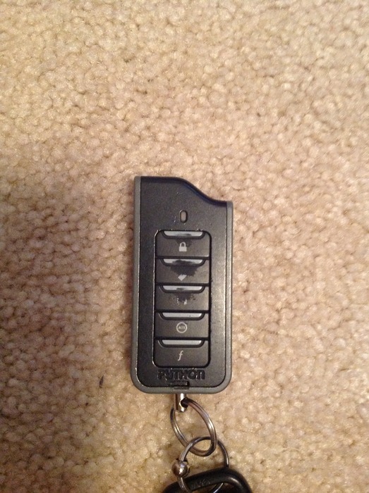

SLOPEZ551980
My truck has two alarms on it and it wont crank and it is flashing and, battery,and the security light is flashing.

My car starter quit working. It was installed after we purchased the vehicle ( which was about 4 years ago). The brand is Python. I checked to make sure the switch by my knees on the drivers side is "on" and it is. I also changed the battery in the remote and it still doesn't work. Any ideas what else it could be???
May 1, 2017 at 10:12 PM (Merged)
WRENCHTECH
  • 20,761 POSTS
You will have to contact the aftermarket manufacturer on that issue..
