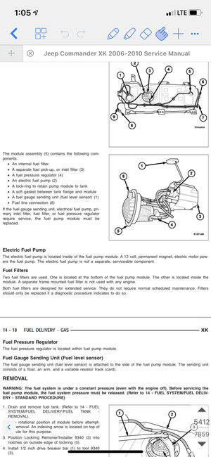

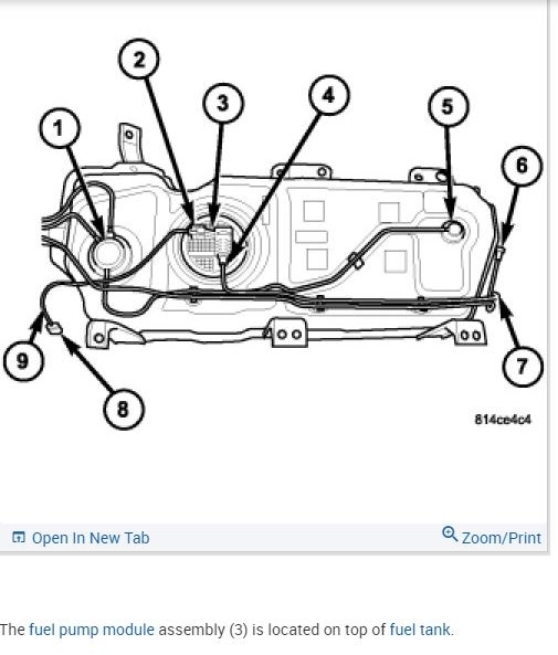

Okay, so there is a fuel pump module located on the top of the fuel tank not part of the pump. The module controls the pressure. It's number 3 on this diagram.
Jul 10, 2020 at 9:53 AM
4DRTOM
  • 467 POSTS
I think we should do a leak down test again now that the pump has been replaced. Did you get the pump alone or the whole assembly? I'm leaning towards the module if it wasn't part of the new pump.
Jul 10, 2020 at 10:00 AM

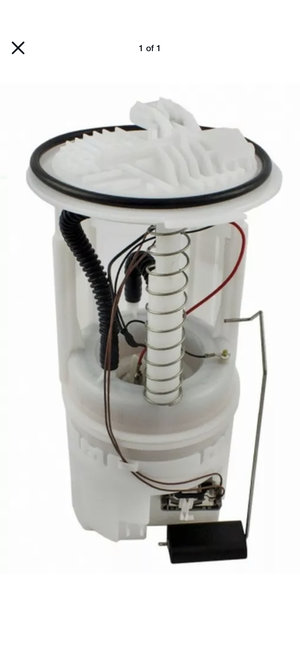

I replaced the entire assembly. I’ll see if I can post the part.
Jul 10, 2020 at 10:01 AM
  • 96 POSTS
That’s a picture of the part. Looks like everything is together in one unit. Filters, pump, regulator and fuel level.
Jul 10, 2020 at 10:07 AM

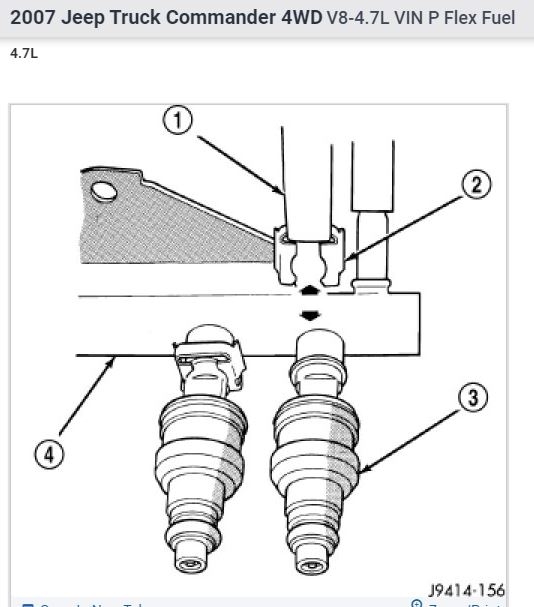

I still think a leak down test should be done again. If it does leak it's the injectors.
Jul 10, 2020 at 10:14 AM
4DRTOM
  • 467 POSTS
Here is a pic of the injector.
1. Remove fuel rail.
2. Disconnect clip(s) that retain fuel injector(s) to fuel rail (2).
Jul 10, 2020 at 10:18 AM

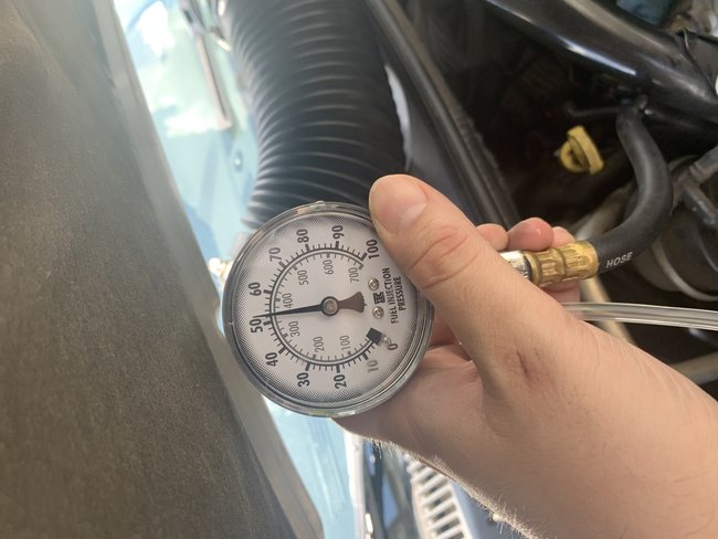

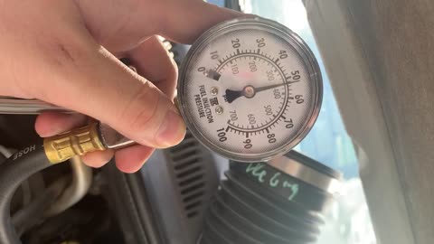

So just hooked up the fuel gauge and everything seemed to hold steady.
Jul 10, 2020 at 10:55 AM
  • 96 POSTS
Key on engine off.
Jul 10, 2020 at 10:56 AM
  • 96 POSTS
Engine started up and idling, needle shook as rpm was dropping but stayed steady.
Jul 10, 2020 at 10:57 AM
  • 96 POSTS
After shutting down the engine. And it’s still holding the same pressure a few minutes later.

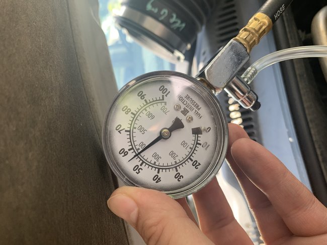

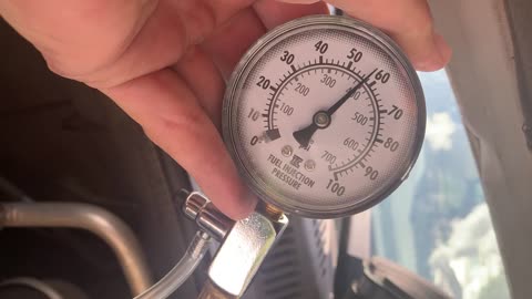

I have seen video online of and injector failing after it gets hot. Think maybe situation happening here? Seems to always start or get progressively worse with heat.
Jul 10, 2020 at 10:59 AM
  • 96 POSTS
Just restarted and the fuel pressure went back to right at 58. Although this time when I turned off the fuel pressure is higher than the first time. And holding there now.
It did smell a little rich to me when it was running. Not like raw fuel but definitely can smell something.
Jul 10, 2020 at 11:03 AM

The pressure from being off should go no lower that 35psi.
Jul 10, 2020 at 11:52 AM
  • 96 POSTS
The pressure held perfect this time. Is the receipt paper getting sucked into the exhaust a valve issue?
