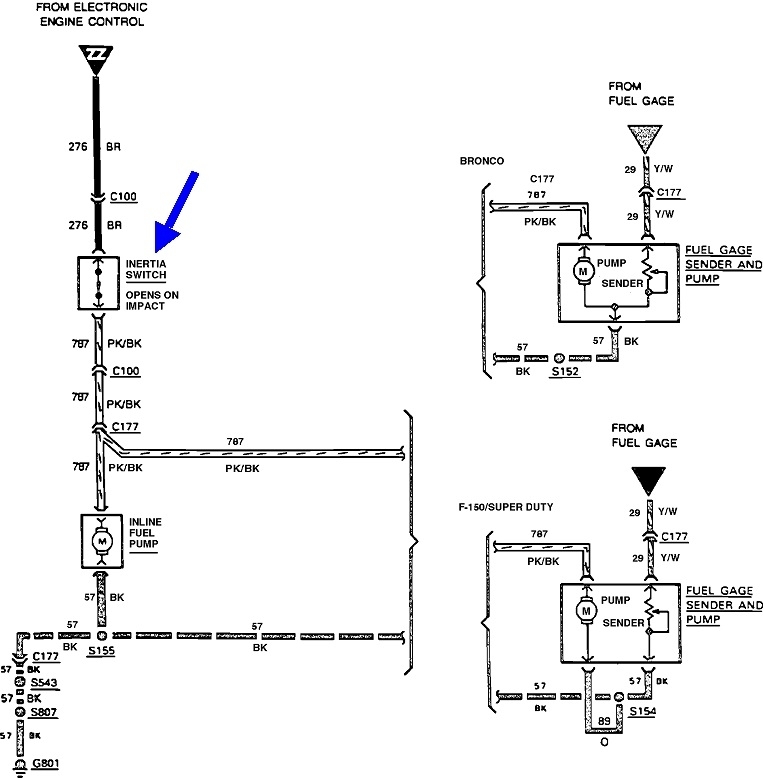

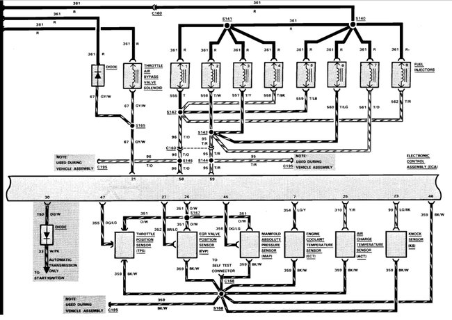

Have you tried starting the engine? The fuel pump must not run unless the engine is rotating, (cranking or running). That's for safety on all vehicles with electric fuel pumps. On most models it will still run for about one second when you turn on the ignition switch. If you don't have 12 volts at the pump at that time, check the inertia switch. Use a test light to check for that one-second pulse. Digital voltmeters don't respond fast enough.

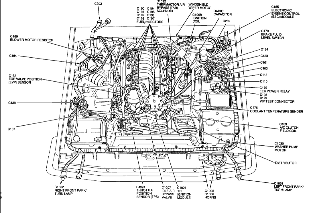

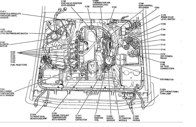

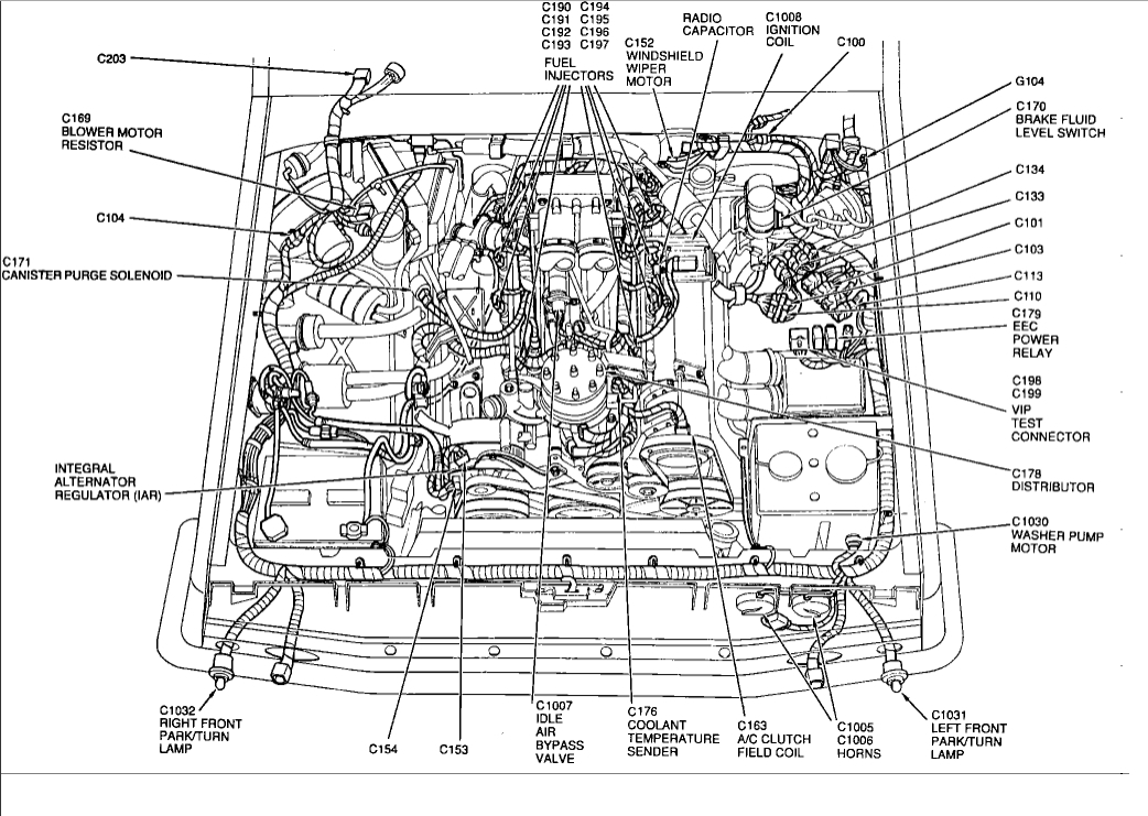

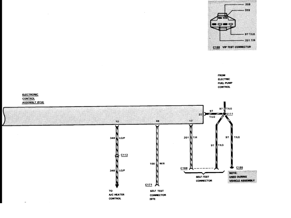

I cut off part of the second diagram so it could be expanded for easier reading. It's just missing the injectors. Let me know if you need the entire diagram.
There's no drawing showing the location of the inertia switch. This is from the service manual: "On F-series, the Inertia Switch is located at the far Left part of the toe-board, near the parking brake assembly. On E-series, the switch is on the passenger side cowl panel, just forward of the right front door".

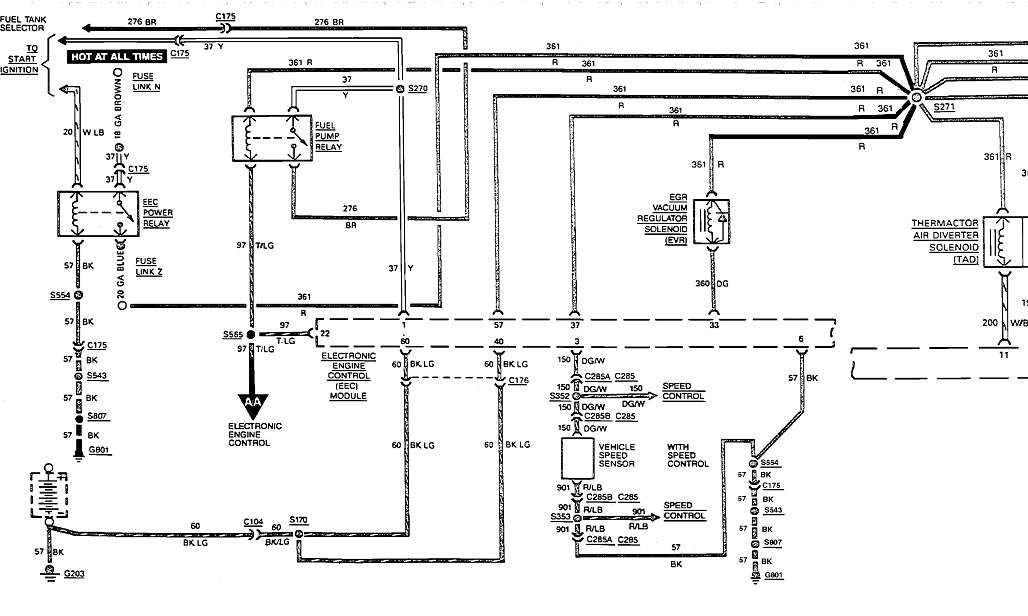

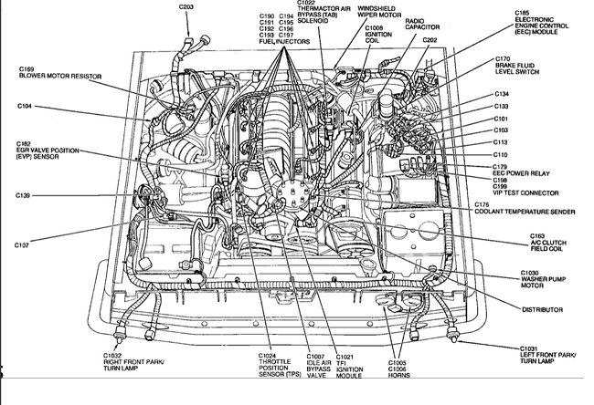

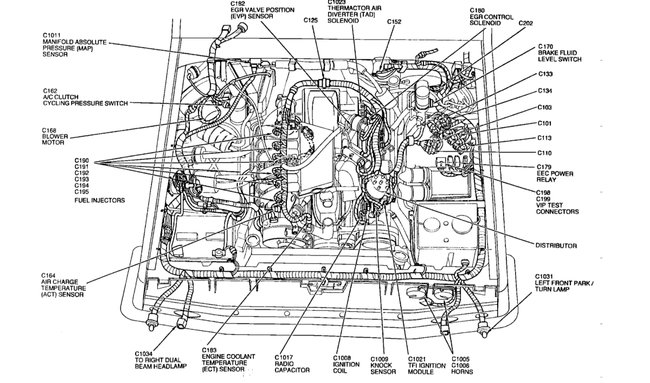

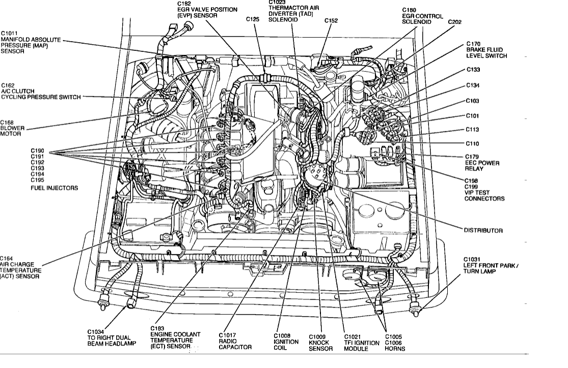

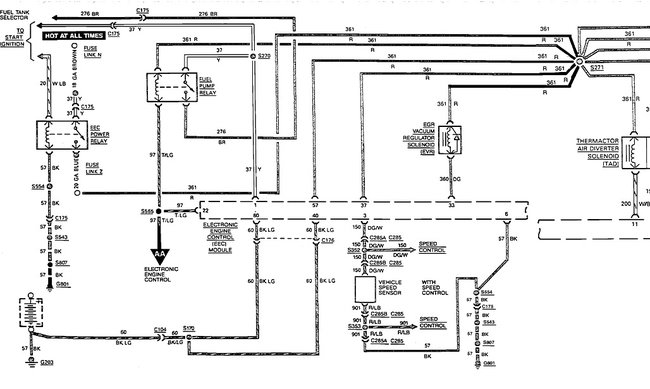

the pump is grounded near the pump (black wire) to chassis .. (pink/black) wire goes to inertia switch then carries on (brown wire)to fuel pump relay .. relay is grounded from EEC module (electronic engine control) which gets it's signal's from ECU/PCM check wiring from EEC module (tan/light green) wire from relay to EEC module.... (red) wire from relay goes to fuel injectors.
LH Side Of Engine Compartment, On Relay Bracket. Fuel pump relay is next to the EEC Relay.

It sounds like the EEC relay is not working here is a guide to help you test the relay and how to test for power
OK are you sure that the main fuel pump is not working? How old is the fuel filter? Do you have a digital multi meter to do some testing with? Have you checked the fuel pump relay? See this truck has 3 fuel pumps a lift pump in each tank and then the main pump on the inside of the frame on the left (drivers) side about under the drivers seat. Then there should be a fuel filter just in front of the pump.
There is a black can back by the tank this is the switch valve sediment bowl. There may be filter in that but we will get to that later. Lets first determine that the main fuel pump isn't working ok. Let me know if when you turn the key on that pump hums, it may be that you will have to put you hand on the pump and have someone turn the key on should run for about 3 sec. Let me know what you find here and we will go from there.

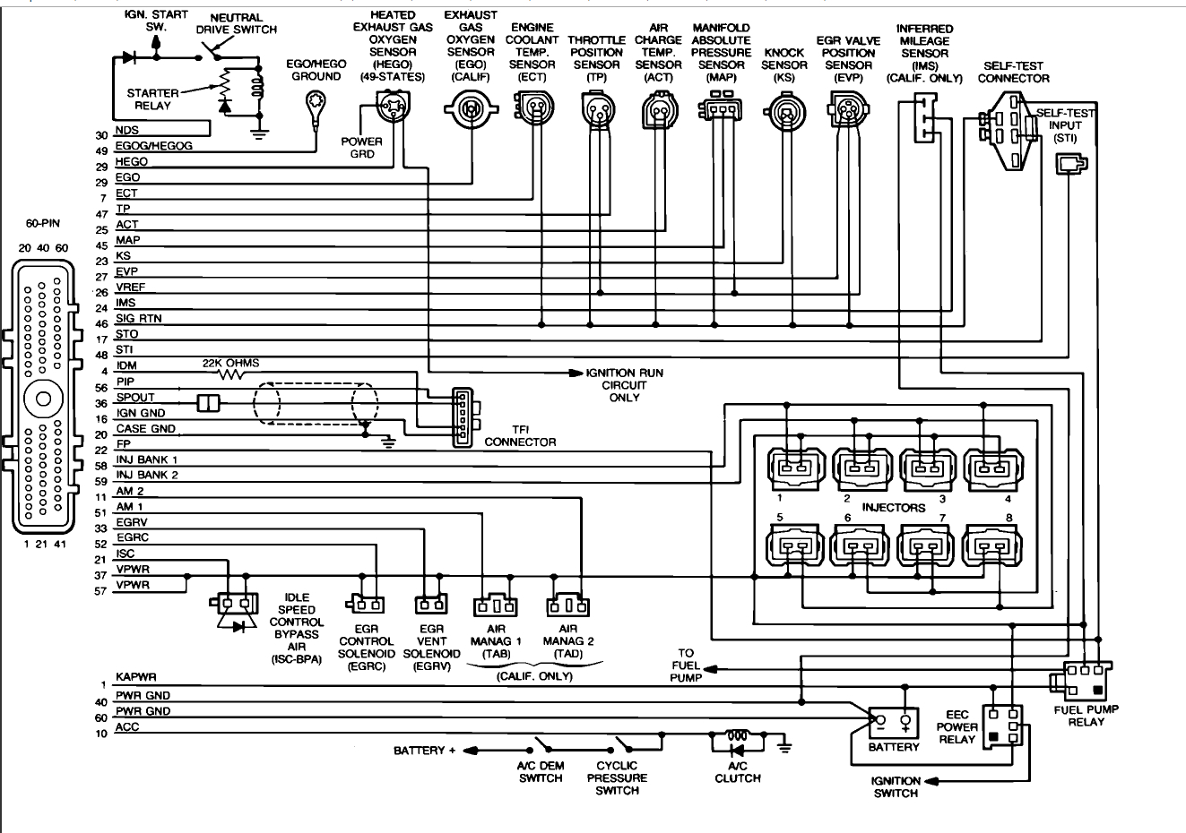

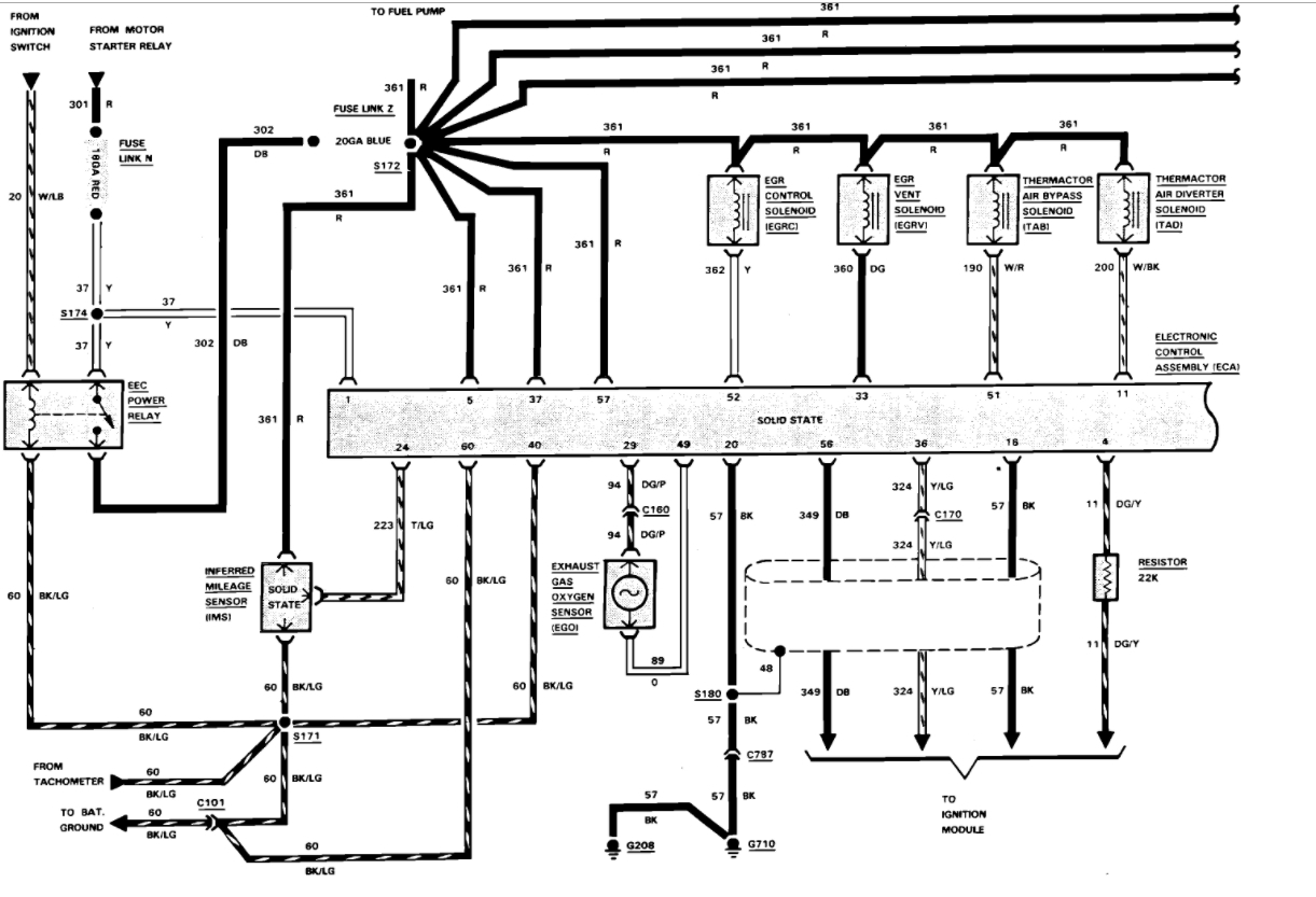

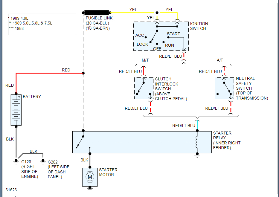

Check out the fuel pump wiring diagrams below. Please run this test and get back to us.

The pumps get power for 3 seconds when you turn the key on. Then when you go to crank they get power again and the relay keeps power to the proper pumps till turned off. The switch on the dash powers the correct in tank pump and nothing more. The relay keeps the correct intake pump running and the high pressure pump on the frame working once you go to crank. So what is you want to do? Are you wanting to fix it and make it work as it should or ? I am not trying to be difficult just trying to understand what you are wanting to do. Once I know I understand what you are after then we will go from there. Thanks.

Ok great then everything should work fine once we have power to he fuel pump. Now did you check wires to the tank selector switch? Now the pink wire with the black stripe comes from the relay to the inertia switch and then to the fuel pump. Now the power comes from the yellow wire to the fuel pump relay, which is provided from the starter relay on the fender near the battery. sorry I was reading the wiring diagram incorrectly. So it is like so yellow wire from the starter relay to the fuel pump relay then out the pink wire with the black stripe to the inertia switch then from the inertia switch to the fuel pump. The tank selector switch determines which pump gets the power.
