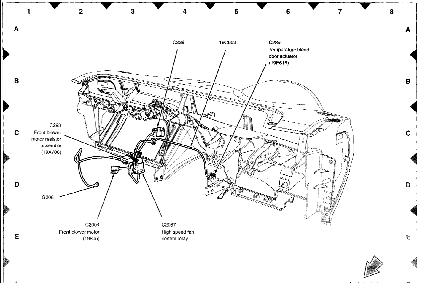

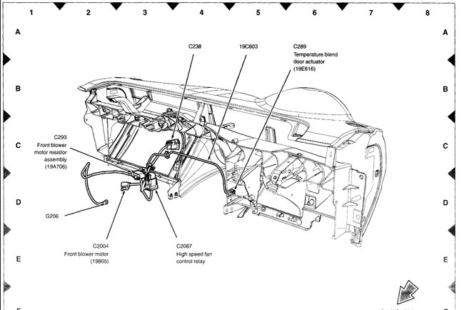

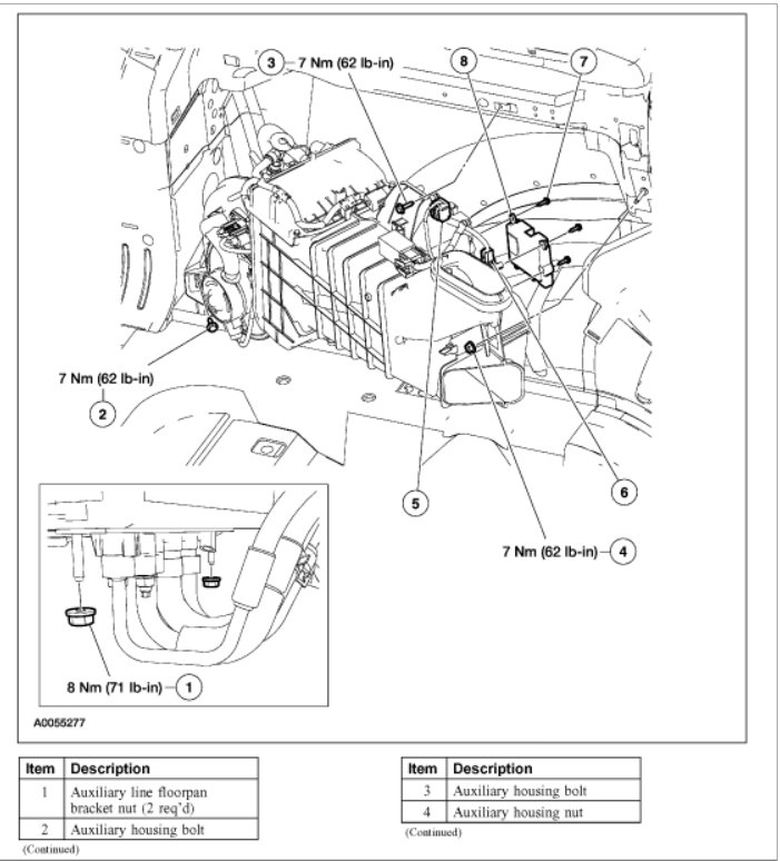

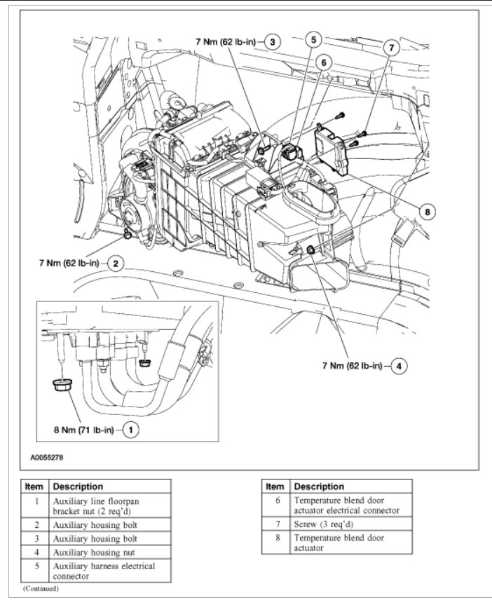

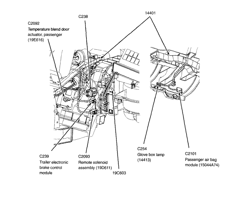

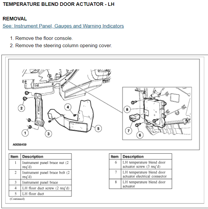

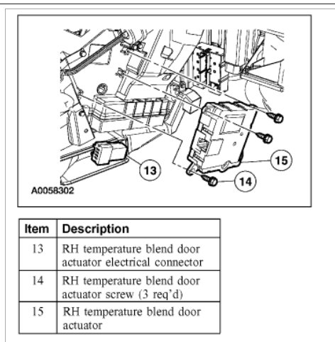

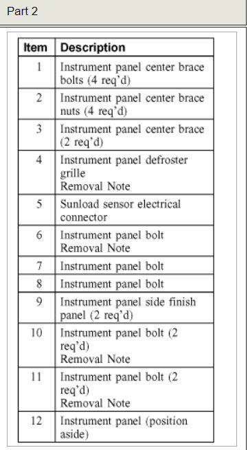

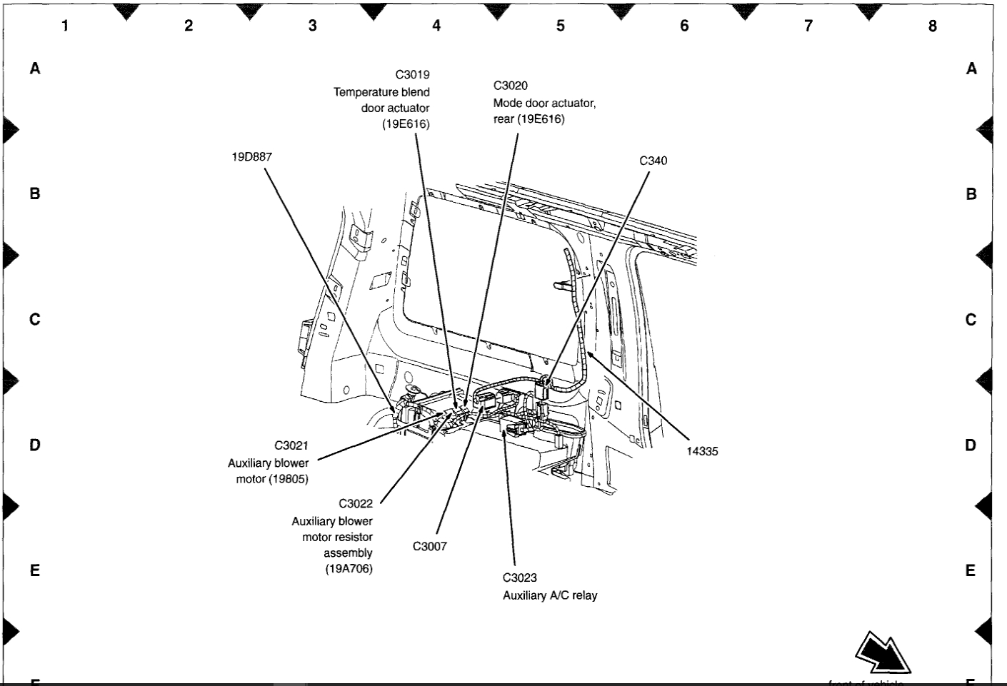

It sounds like you have a blend door actuator that is not working. Here is a guide to help you see what you are in for when changing the actuator out.
Check out the diagrams (Below) of all blend door actuator locations

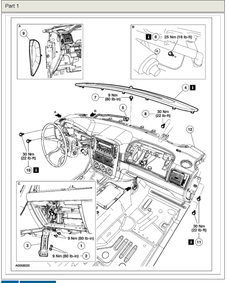

i have a2003 exploer i turn the heat on and the fan i hear a flapping noise in the heater box (manual control) is it possible to remove the dashboard to get to the heater assy to repair the door flap
Sep 27, 2020 at 12:00 PM (Merged)
Actually, you should be able to access the vent door from under the dash. You may have to remove the glove box.
NOTE: Because your vehicle has an airbag, I would recommend disconnecting the battery for at least 30 minutes prior to starting any repairs. Air bags can deploy if not handled correctly.
