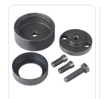

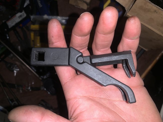

You lost me on that question. LOL There is a valve spring compressor that is used to remove or replace a valve spring or when you need to remove a valve. Is that what you're referring to? Could you send me a pic of the tool you're referring to?
Oct 15, 2021 at 5:16 PM
ARIANADANIELLE5345
  • 393 POSTS
I figured it out, but this is the tool. Any idea why all of a sudden, my engine won’t turn by hand? Timing is not off. I can’t figure it out. It turns easily counterclockwise but I don't know how far because I don’t know if I can turn it that way too much but clockwise it just stops at a certain spot.

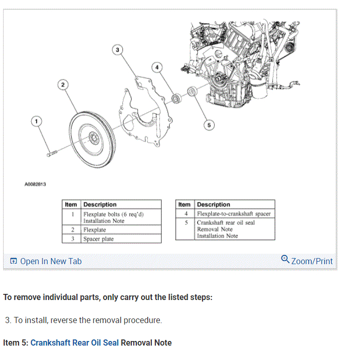

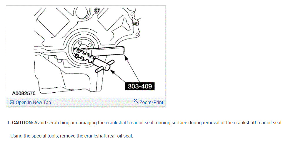

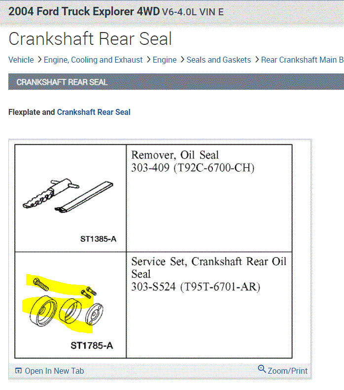

I guess all I needed was a socket, lol. I was turning it by hand when it stopped. The second I put a socket on it moved. Do I need this tool to install the rear main seal or is there another way?
Oct 19, 2021 at 6:17 AM

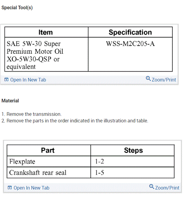

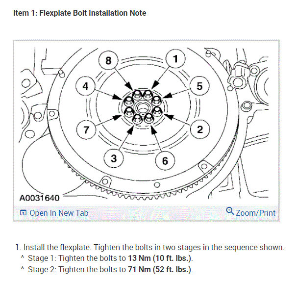

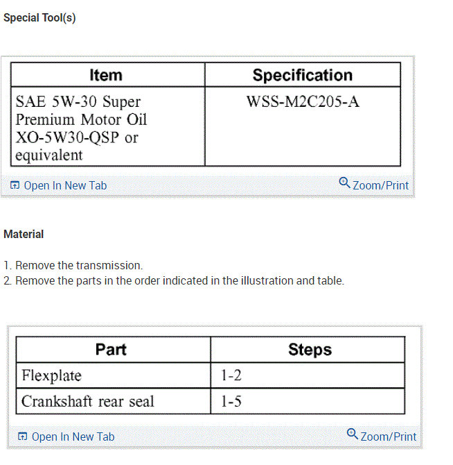

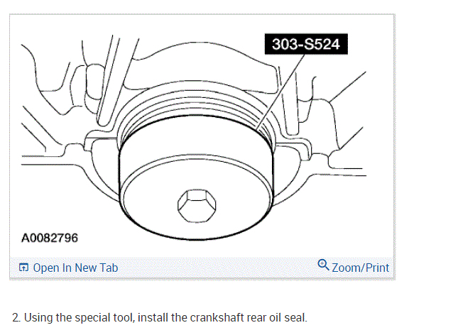

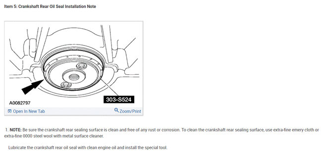

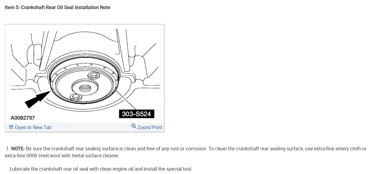

Using that tool will ensure it will be properly installed. I've seen people try to tap the seal into place with a nylon tip hammer, but they usually leak shortly thereafter. I would think a parts store would lend you the tool. I recommend using it.
I attached directions below specific to replacing that seal. I hope they help.
See pics below.
Oct 19, 2021 at 7:08 PM
