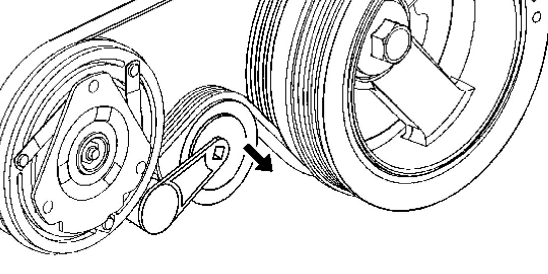

OK, the tool is only available when you buy the kit. you do not need this.
Attached is a picture of the tensioner. you need a 3/8 ratchet to release the tension.
Sep 24, 2020 at 10:32 AM (Merged)
MRMGREENE
  • 14 POSTS
My set up does not have the tensioner so I have to work the belt on with zip ties I think. I was just curious if this tool helped get the belt on somehow when there was not a tensioner present.
