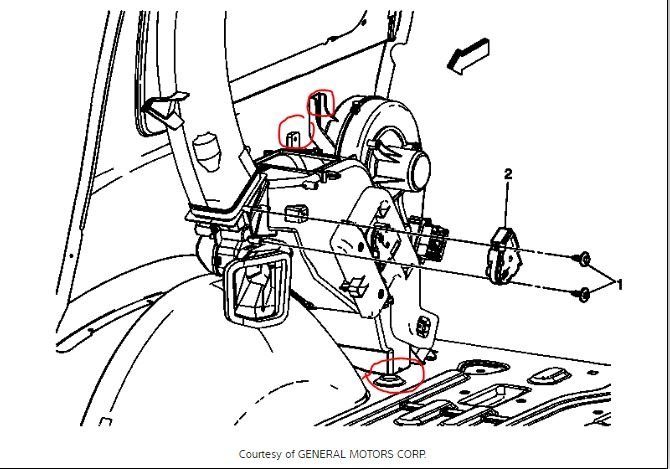

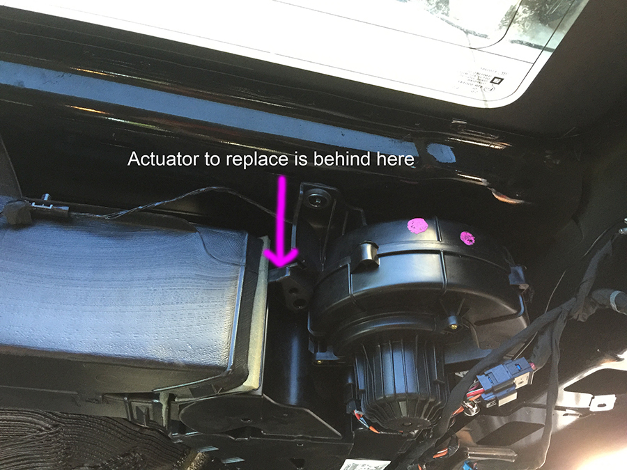

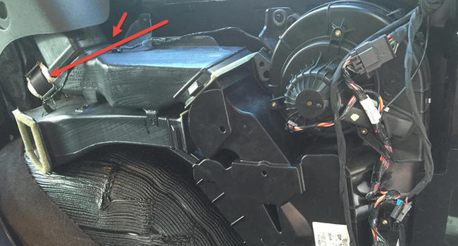

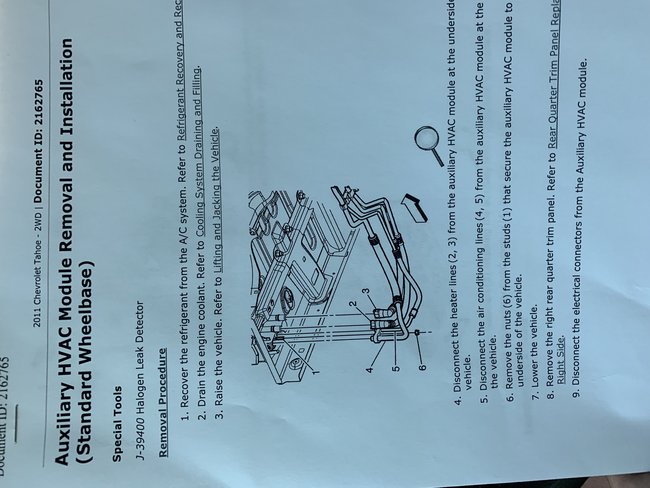

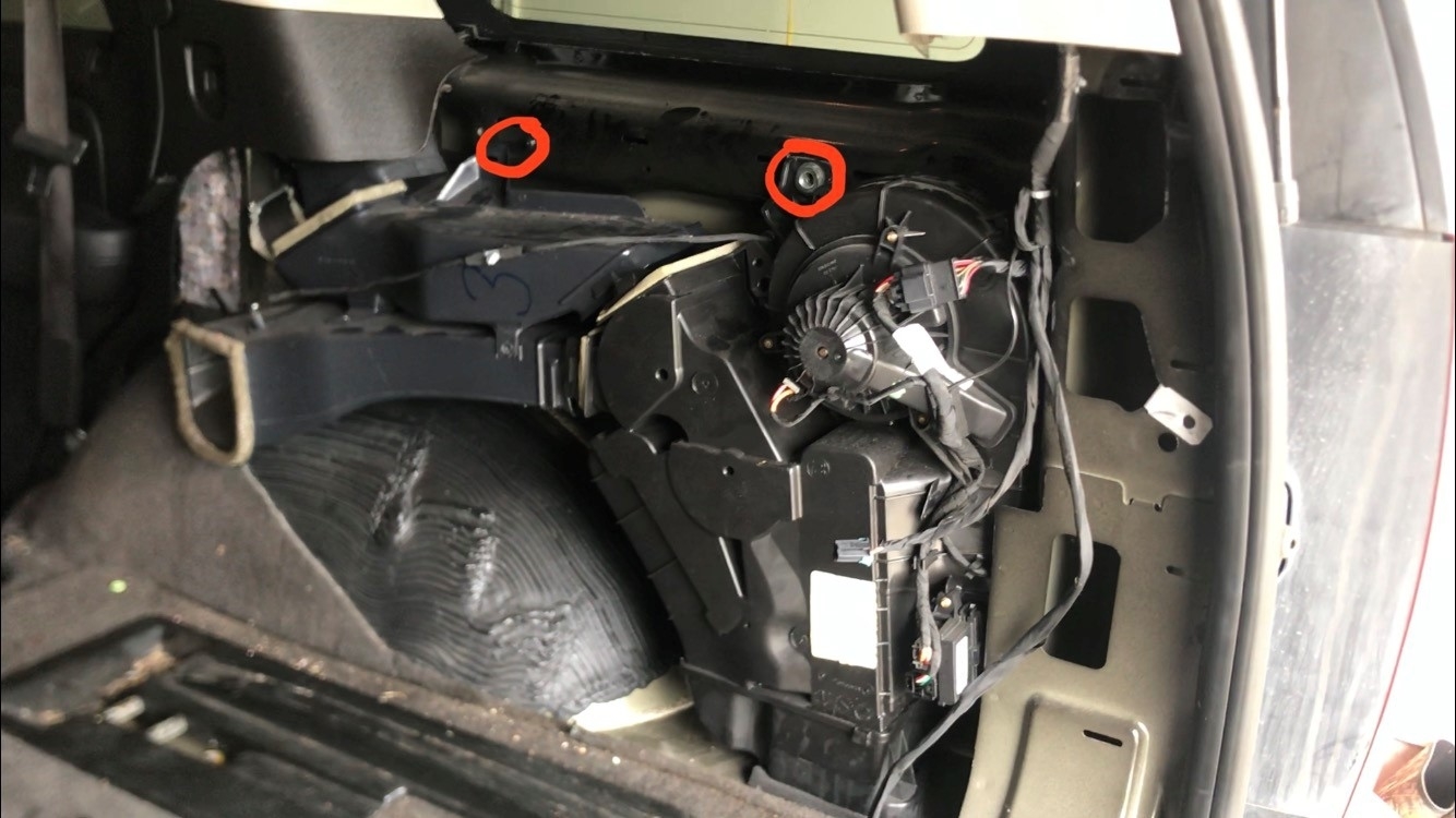

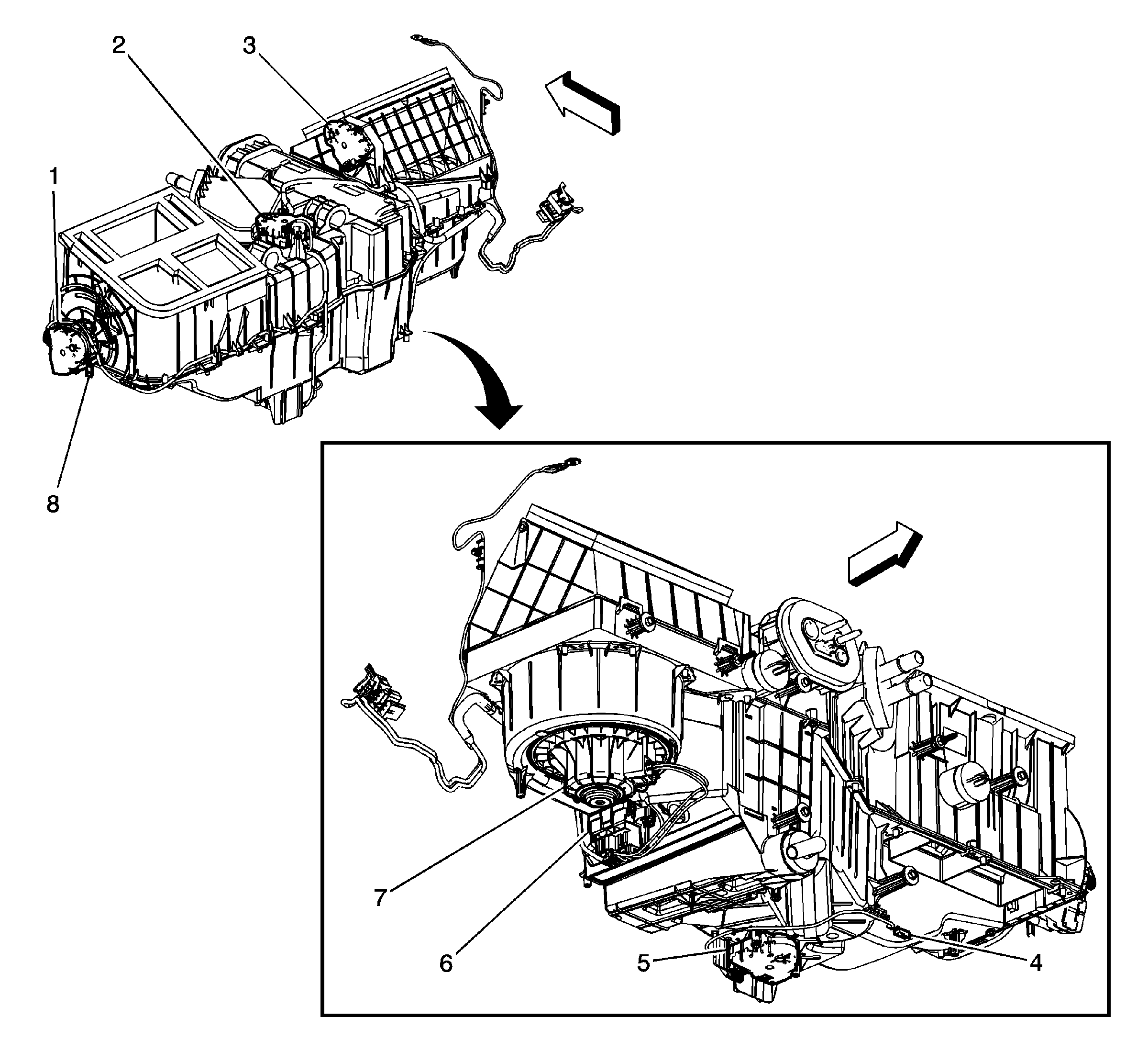

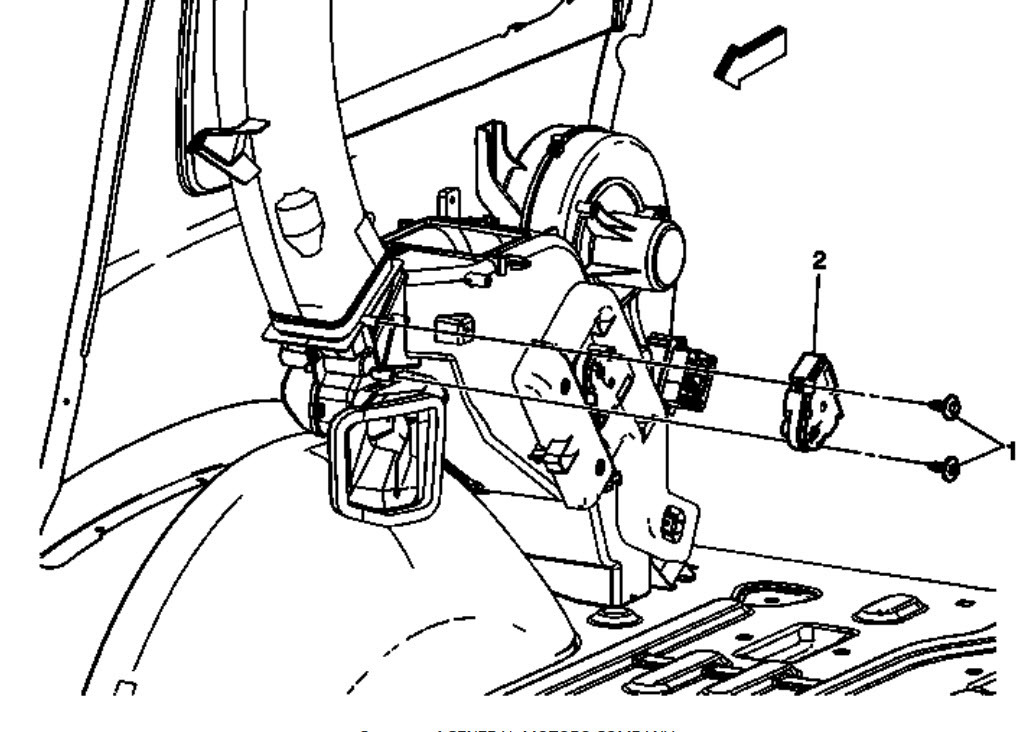

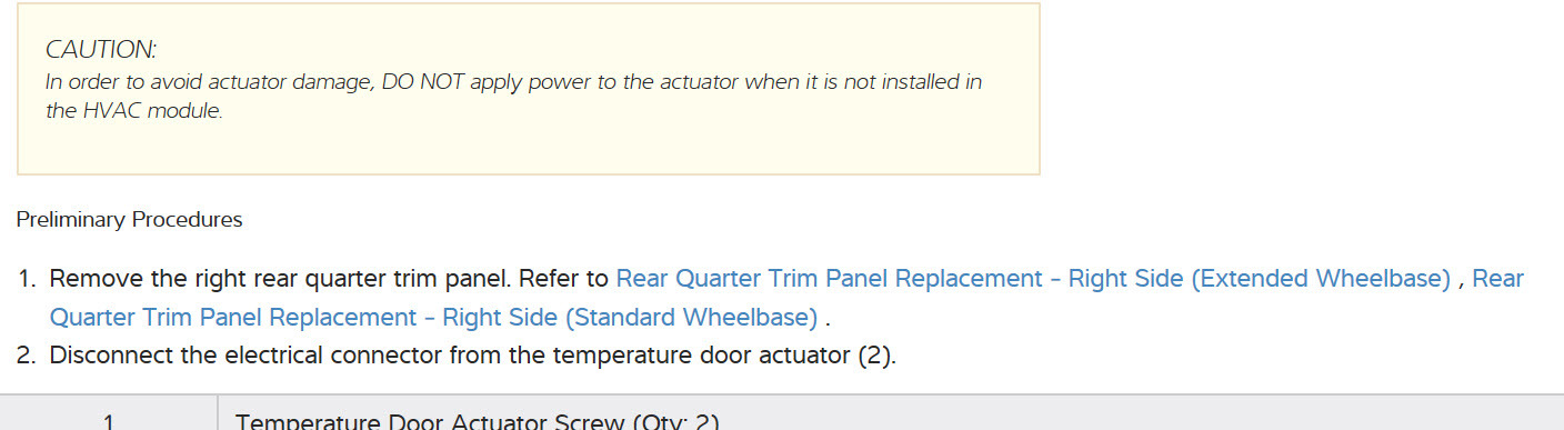

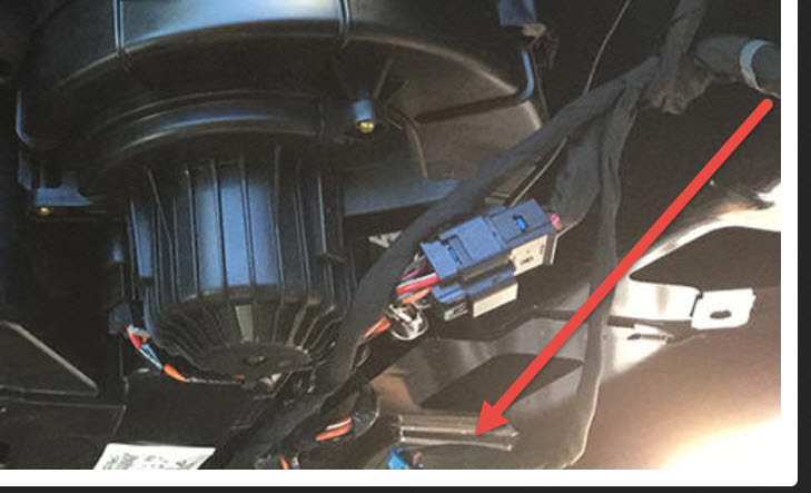

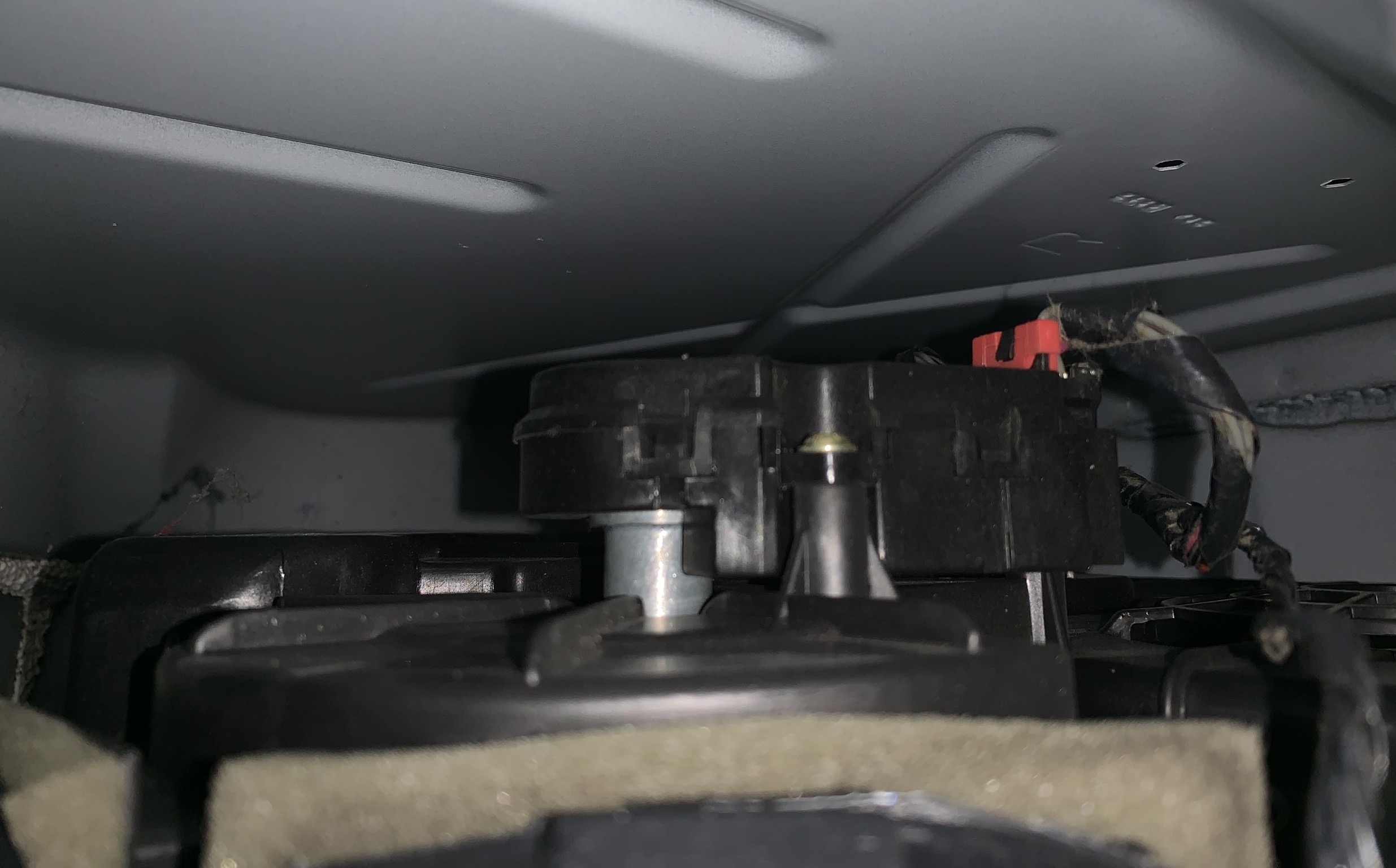

Actually, the blend actuator is to determine temperature which enters the vehicle. I believe you have a problem with what is called a mode door actuator. That is what determines where the air flow exits.

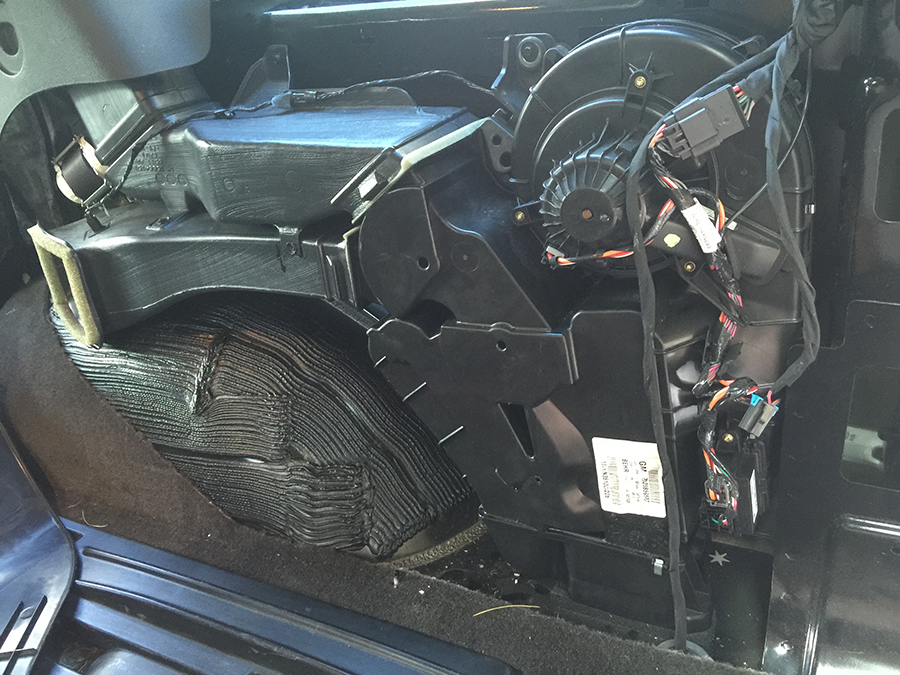

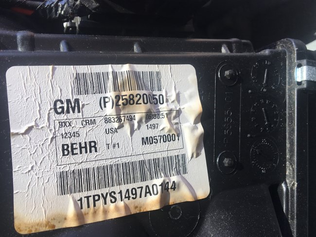

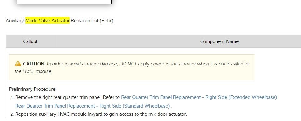

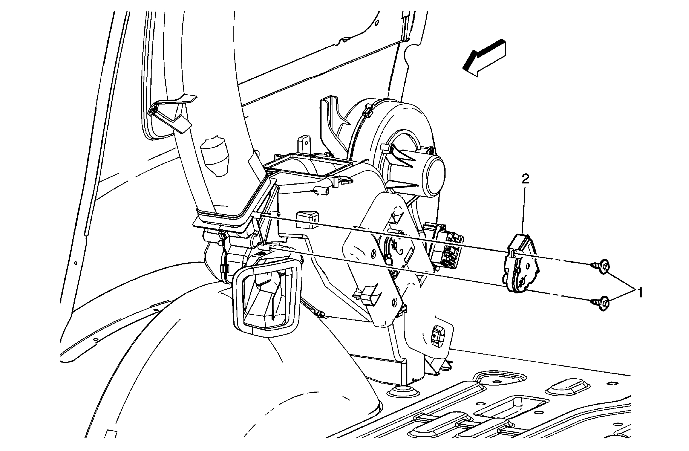

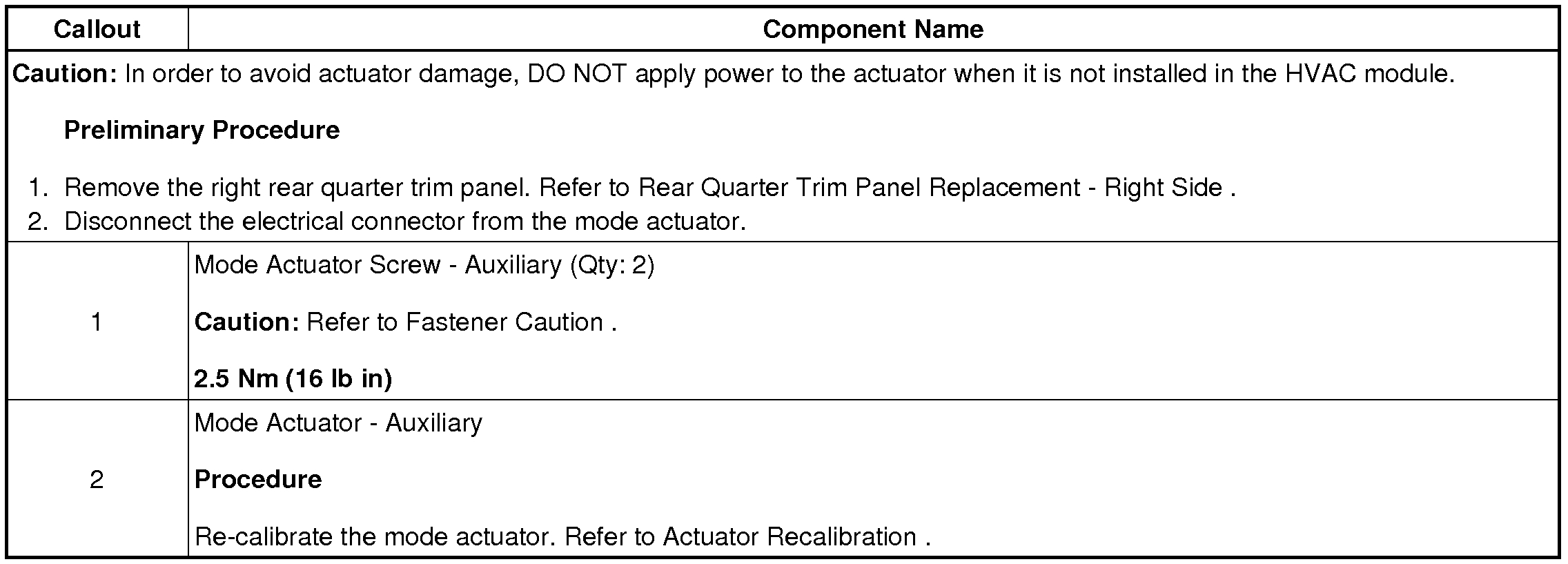

Now, I don't know if you have automatic climate control or manual, so I am going to include directions for the mode valve actuator replacement for both. All attached pictures correlate with the directions.
_____________________________

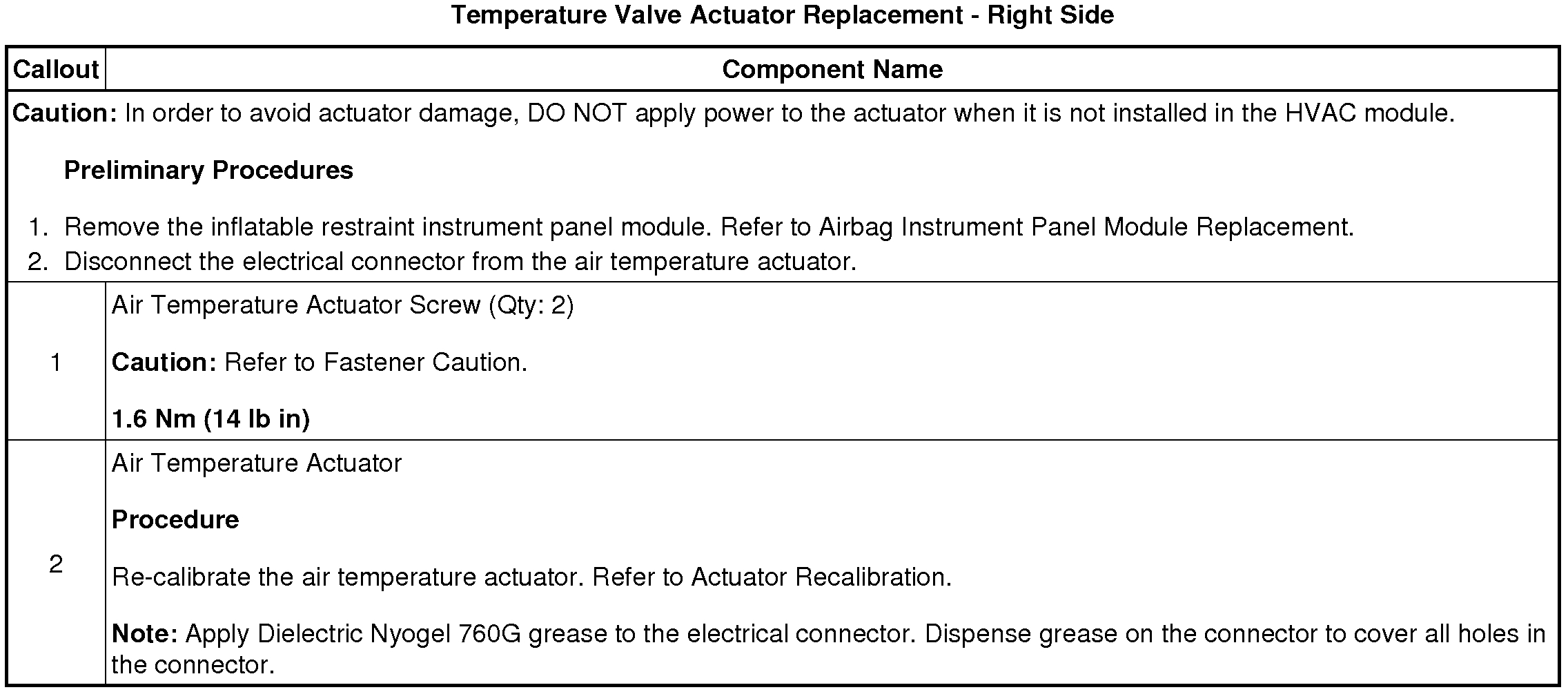

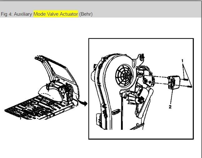

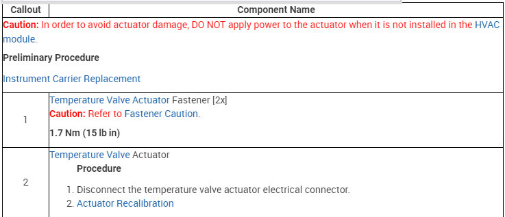

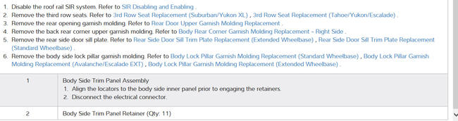

Manual HVAC
See pics 1 and 2 for location and directions.

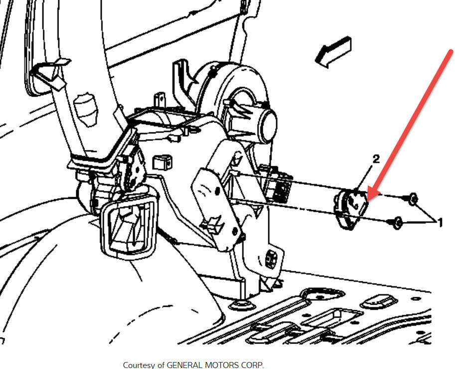

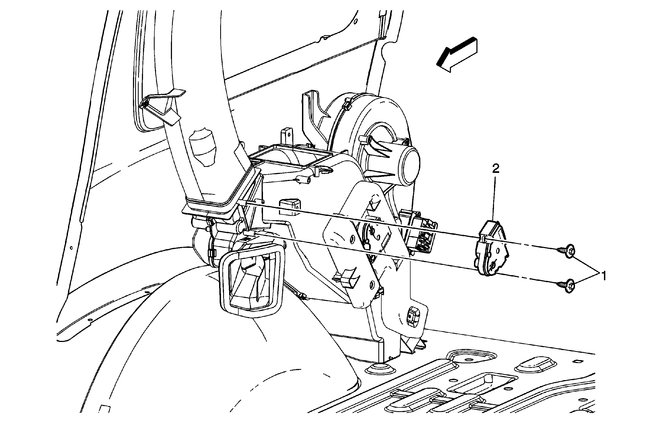

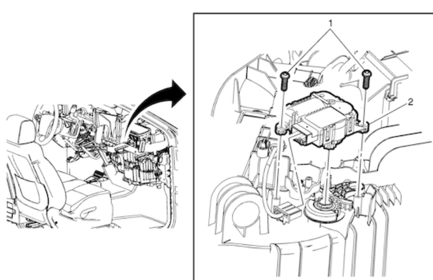

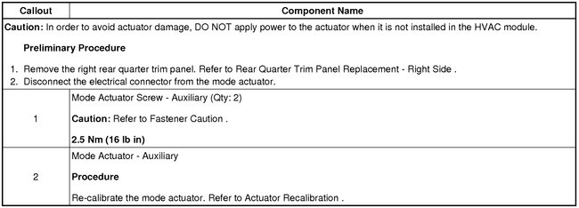

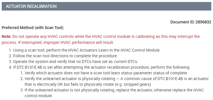

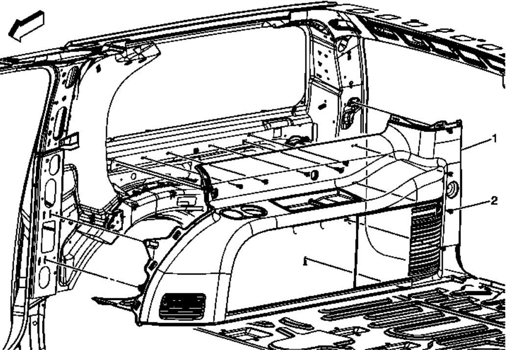

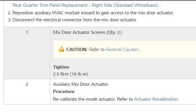

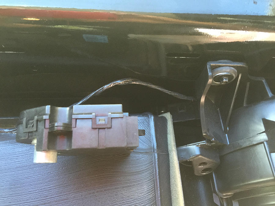

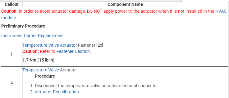

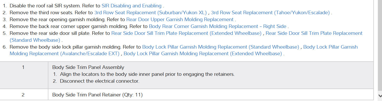

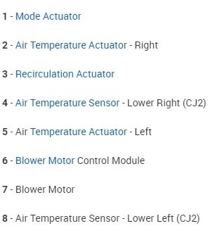

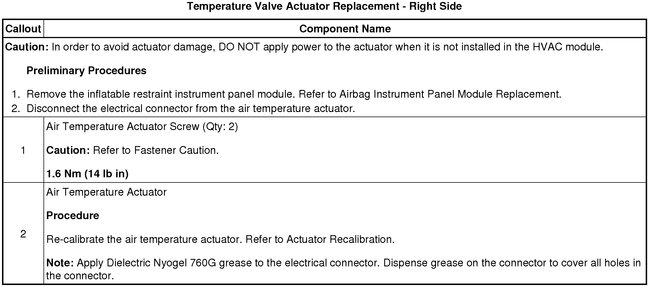

Auto HVAC
See Pics 3 and 4 for location and directions.

Here are the directions for recalibration of the automatic HVAC. You can do it with a scanner or without.
HVAC - AUTOMATIC
Actuator Recalibration
When replacing the HVAC control module it will be necessary to allow the HVAC control module to perform a calibration process. When installing the HVAC control module be sure to perform the following:
Important: Do not adjust any controls on the HVAC control module while the HVAC control module is self-calibrating. If interrupted, improper HVAC performance will result.
1. Place the ignition switch to the OFF position.
2. Disconnect the scan tool.
3. Install the HVAC control module.
4. Connect all previously disconnected components.
5. Start the vehicle.
6. Wait 40 seconds for the HVAC control module to self-calibrate.
7. Verify that no DTCs have set as current DTCs.
When replacing the HVAC actuator it will be necessary to allow the HVAC control module to perform a calibration process. When installing the HVAC actuator be sure to perform one of the following:
Preferred Method (w/Scan Tool)
1. Clear all DTCs.
2. Place the ignition switch in the OFF position.
3. Install the HVAC actuator.
6. With the scan tool, initiate the Motor Re-calibration feature of the Heating and Air Conditioning Special Functions menu.

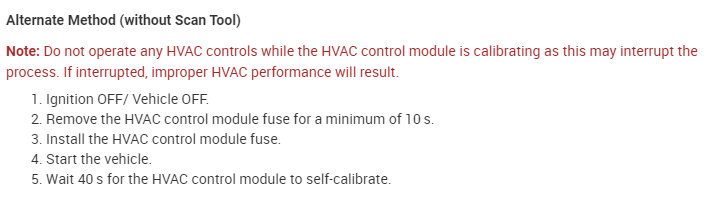

Alternate Method (w/o Scan Tool)
1. Clear all DTCs.
2. Place the ignition switch to the OFF position.
5. Remove the HVAC/ECAS fuse for a minimum of 10 seconds.
6. Install the HVAC/ECAS fuse.
7. Start the vehicle.
8. Wait 40 seconds for the HVAC control module to self-calibrate.
9. Verify that no DTCs have set as current DTCs.
