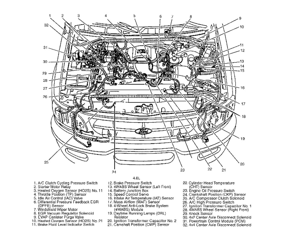

see pic for location

do what I said in the very first reply the pic I sent should point out the coils reset your anti theft like I said as well if no manual look online check all fuses underhood as well as fuel pump relay. you can switch another realy that has the same configuration as the fuel pump one.

It is located on the lower front of the engine. Post specific engine size (i.e 5.4L , 4.6L etc..) and I can post a diagram of the location.

Crankshaft position sensor: Note: Engine design precisely locates Crankshaft Position (CKP) sensor. No CKP sensor adjustment is necessary. Removal and Installation: Disconnect negative battery cable. Raise and support vehicle. Remove A/C compressor to gain access. Disconnect crankshaft position (CKP) sensor wire connector from engine harness. See figure 5 . Remove CKP sensor mounting screws. Remove CKP sensor. To install, reverse removal procedure. Tighten fasteners to specification. See torque specifications.
https://www.2carpros.com/forum/automotive_pictures/266999_ckp_1.jpg
