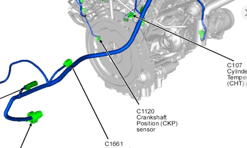

Good evening,

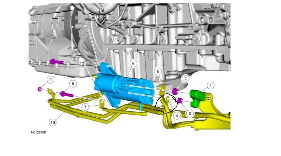

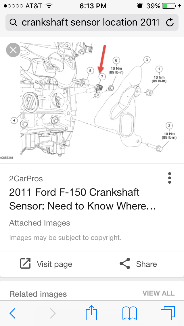

I could not find an exact video for this engine but I attached a picture of the location It is on the driver's side of the engine at the back by the flywheel.

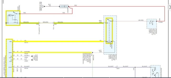

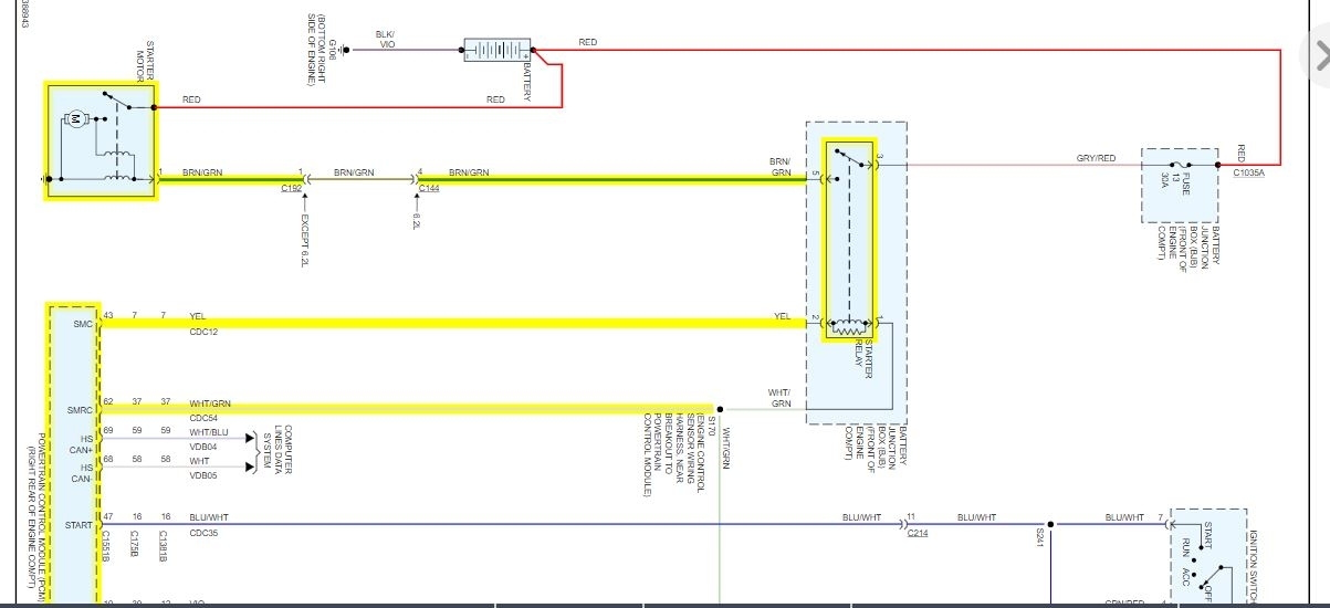

It sounds like the starter solenoid is not releasing and the starter may need to be replaced. You should verify power is not to the solenoid when the key is in the on position.
Can we start with the original issue?

Good evening,
The sensor is at the rear of the engine and works off the teeth of the flywheel.

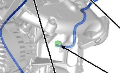

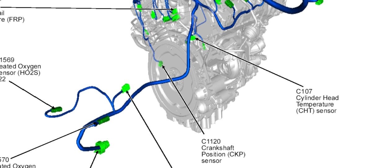

I attache pictures of the location for you to view. It is number 7 in the second picture.
Aug 3, 2020 at 12:09 PM (Merged)
It's on the driver's side rear of the engine block where it goes through to rear from the flywheel. I attached two pictures. The first one shows several different components including the crankshaft position sensor. The second, I cut a section from the picture to get a closer look at the crankshaft position sensor.
Let me know if this helps.

ZACH RAMOS
Do I need to remove anything to get to it? Turbo?
No. It is a straight shot at it from under the truck.

The crankshaft sensor is in different locations depending on which engine you have (#7) Here is a guide to walk you through the steps and diagrams (below) that will show you where the sensors are and how to change them on your car. Disconnect the battery first.
Check out the diagrams (below). Please let us know if you need anything else to get the problem fixed.

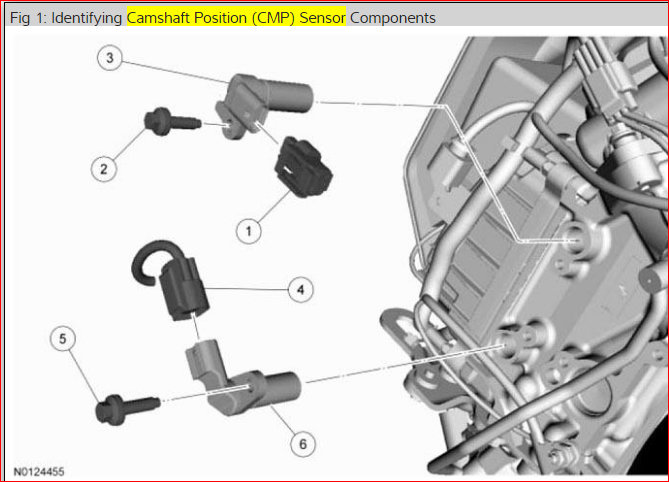

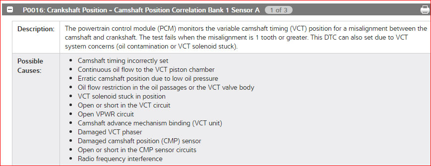

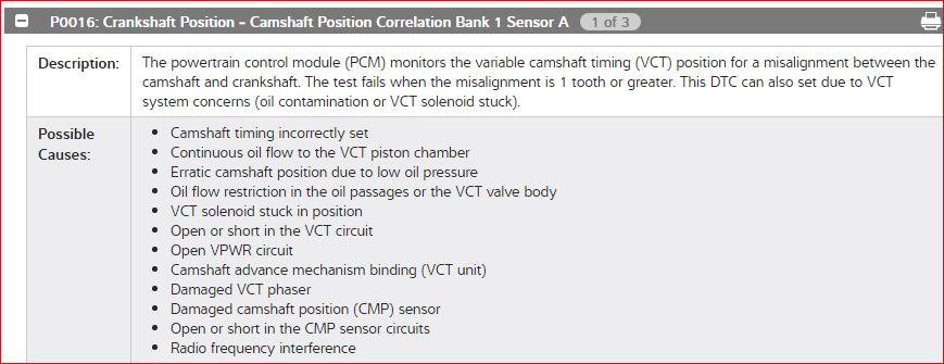

I have a 2011 F-150 ecoboost 3.5 and got a code P0016. Is there cam and crank sensors accessible that can be changed out?
GUAMECOBOOST
Do you know the part number for this? I bought one from AutoZone, looks like a sensor but doesn’t look similar to the one on the back of the motor on the driver side I can see it right above the turbo? Thanks
DANNY L
  • 5,648 POSTS
Hello, I'm Danny.
That code is for the camshaft sensor 'A' which is the intake sensor.That is located at the top of the cylinder head on the right (passenger) side.Here is a tutorial showing what is involved in its replacement.
https://www.2carpros.com/articles/camshaft-angle-sensor-replacement
I've also attached a picture below of what it looks like.Hope this helps and thanks for using 2CarPros.

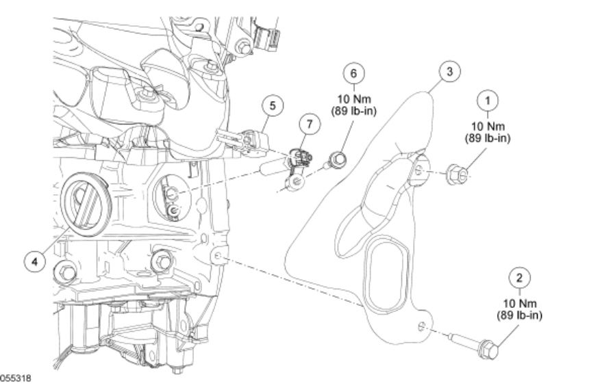

JOEJ88
From the image you sent me, is this picture the back of the engine?
DANNY L
  • 5,648 POSTS
Hello again.
They are located on the front of the engine.Hope this helps and thanks again for using 2Carpros.
Danny-
JOEJ88
No it is not very helpful because the picture you sent me is of the back of the engine...

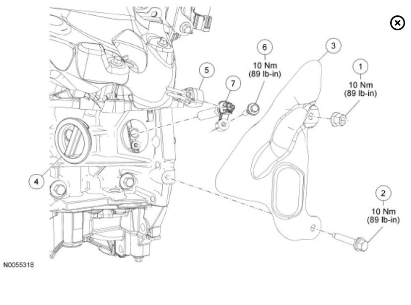

JOEY RICHARD
  • 7 POSTS

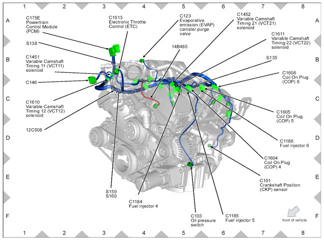

Need to know the location of crankshaft sensor.
CARADIODOC
  • 34,306 POSTS
Lower left side of the engine, way to the rear, under the exhaust manifold.

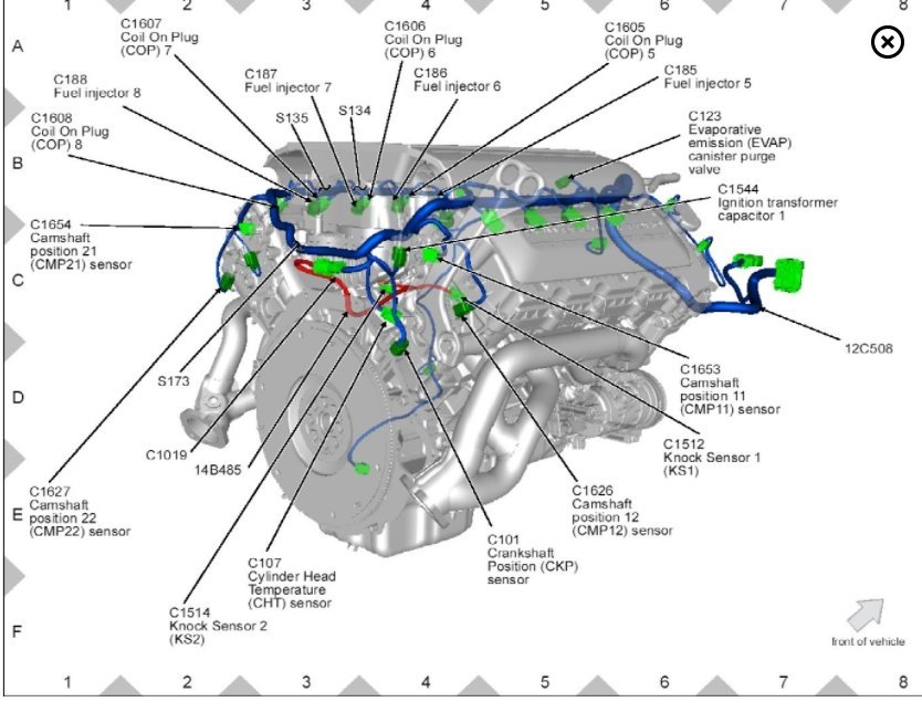

JOEY RICHARD
  • 7 POSTS
So this is wrong? because this is all I can find.
CARADIODOC
  • 34,306 POSTS
That's the same drawing I looked at.
JOEY RICHARD
  • 7 POSTS
So that would be by the starter and not on the front of the block? I have asked everyone and I a being told it is by the timing chain. so I do not want to take stuff off that I do not need to.

CARADIODOC
  • 34,306 POSTS
I think you may have interpreted the drawing incorrectly. Certainly will not be the first time. It shows the sensor in the back, right where you found it. The people you talked with, (who obviously weren't as smart, and handsome, as I am!), were probably thinking about a different engine size.
JOEY RICHARD
  • 7 POSTS
The pic was good it just do not say what side it was on and trying to find it was a lil bet of a pain and come to find out it was the plugs that are all so a pain to change bc I have to take so much off to get to them on the passenger side but thank u to everyone that helped out
