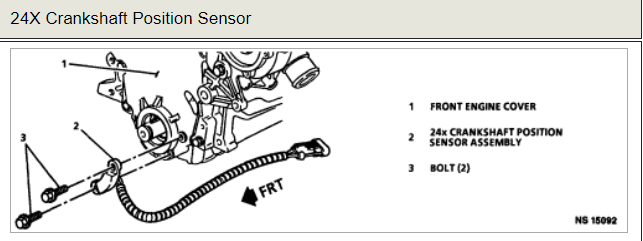

Good afternoon
There are two for this model. I have attached pictures and procedures for both.
Do you have a code for this repair?

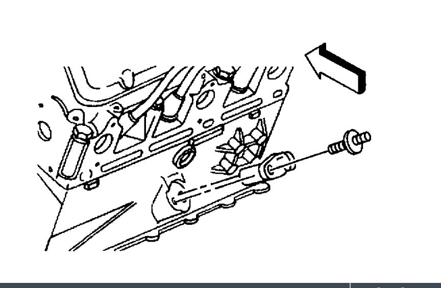

This is the one on the back of the motor
REMOVAL PROCEDURE
1. Turn the steering wheel fully to the left.
CAUTION: Refer to Caution in Service Precautions.
2. Raise vehicle on hoist.
3. Disconnect sensor electrical connector.
4. Remove bolt/screw.
5. Remove sensor from engine.
6. Inspect for the following:
6.1. Inspect the sensor for wear, cracks, or leakage. Replace the O-ring if necessary.
6.2. Lubricate the new O-ring with clean engine oil before installing.

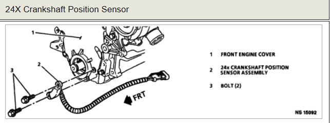

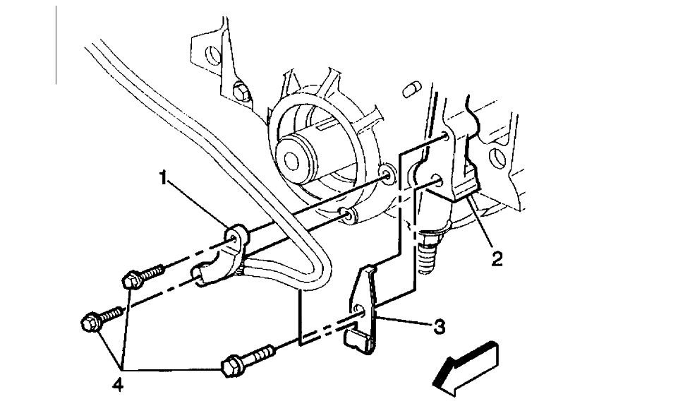

This is the one behind the crankshaft pulley in the front of the motor
REMOVAL PROCEDURE
CAUTION: Refer to Battery Disconnect Caution in Service Precautions.
1. Disconnect the negative battery cable.
2. Remove the serpentine drive belt from crankshaft pulley.
3. Raise the vehicle on hoist.
4. Remove the crankshaft harmonic balancer retaining bolt.
5. Remove the crankshaft harmonic balancer.
6. Note the routing of sensor harness before removal.
7. Remove the harness retaining clip with bolt (1).
8. Remove the sensor electrical connector.
9. Remove the sensor bolts (2).
10. Remove the sensor.

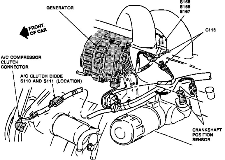

SATURNTECH9
  • 30,869 POSTS
https://www.2carpros.com/forum/automotive_pictures/416332_1997_pontiac_grand_am_crank_postion_sensor_1.jpg
It's letter J in the diagram.

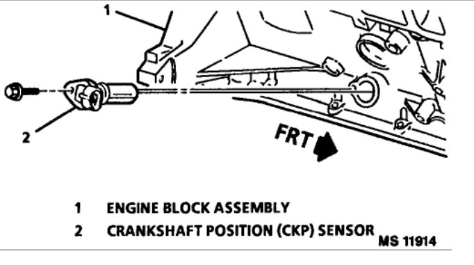

It's on the side of the block next to the oil filter.
https://www.2carpros.com/forum/automotive_pictures/561653_Crank_sensor_96_24_1.jpg
