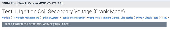

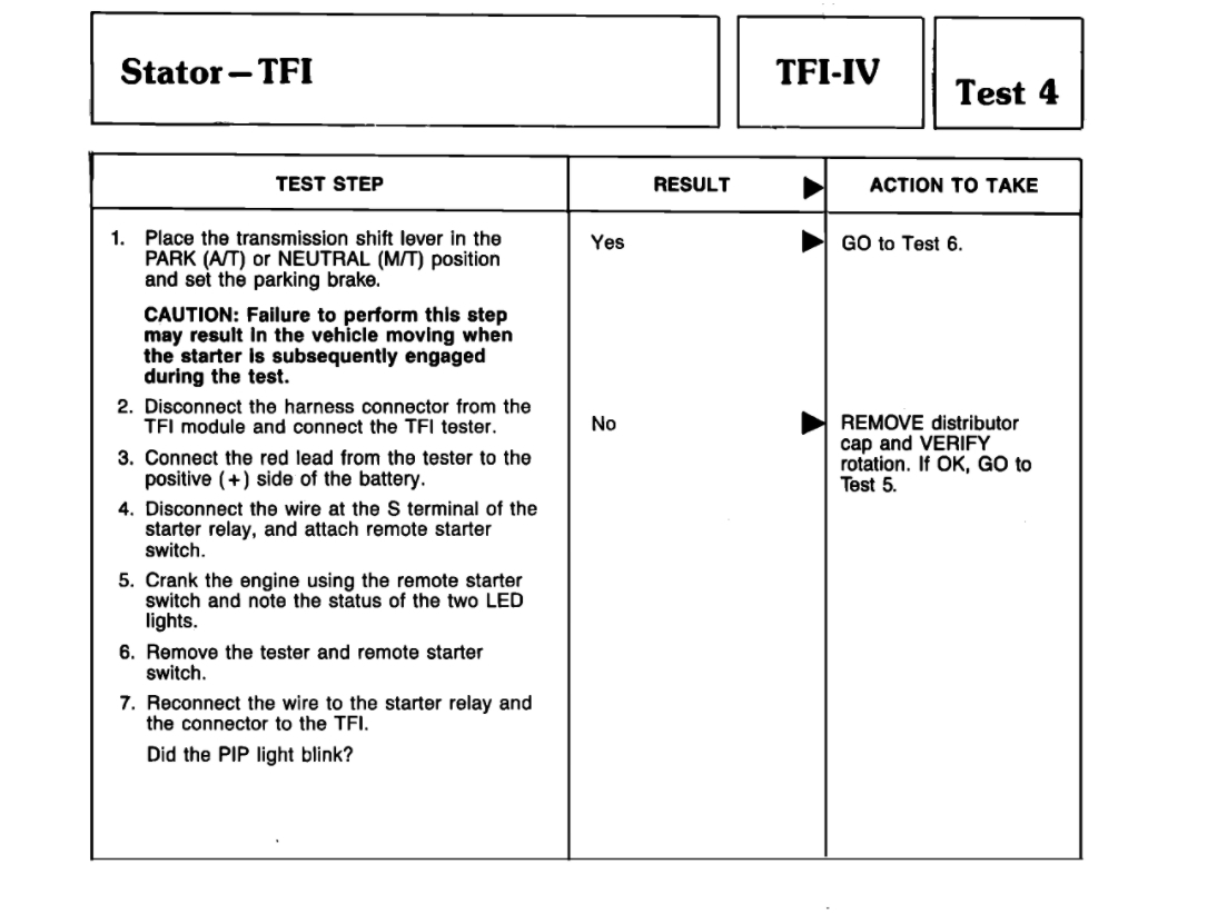

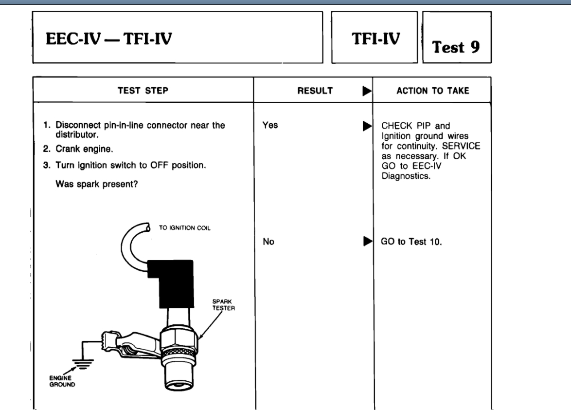

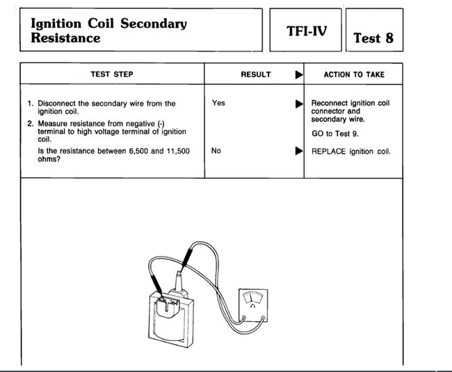

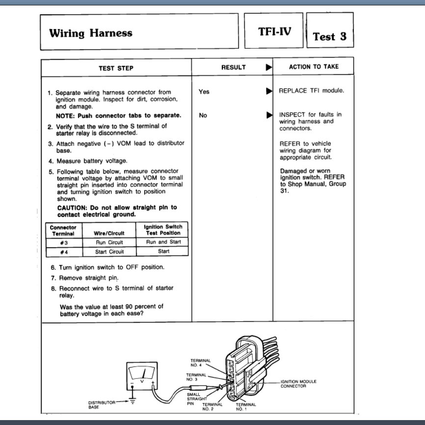

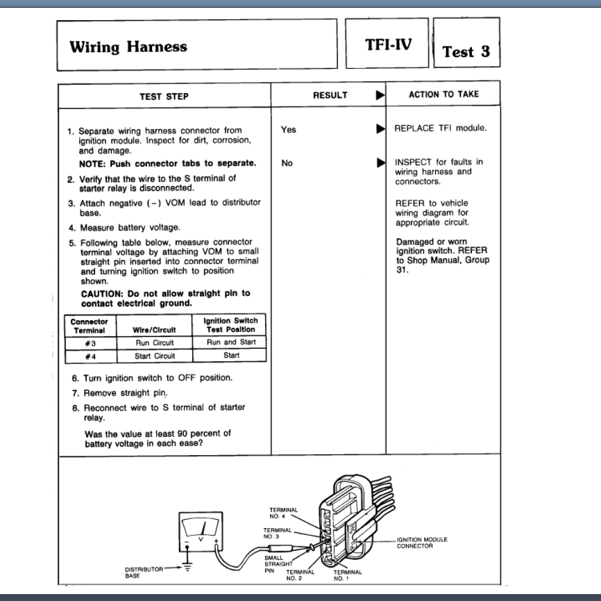

SCGRANTURISMO
  • 4,897 POSTS

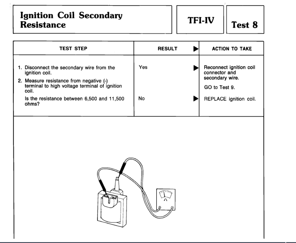

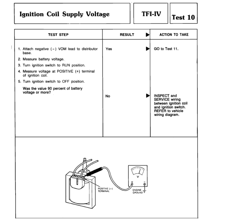

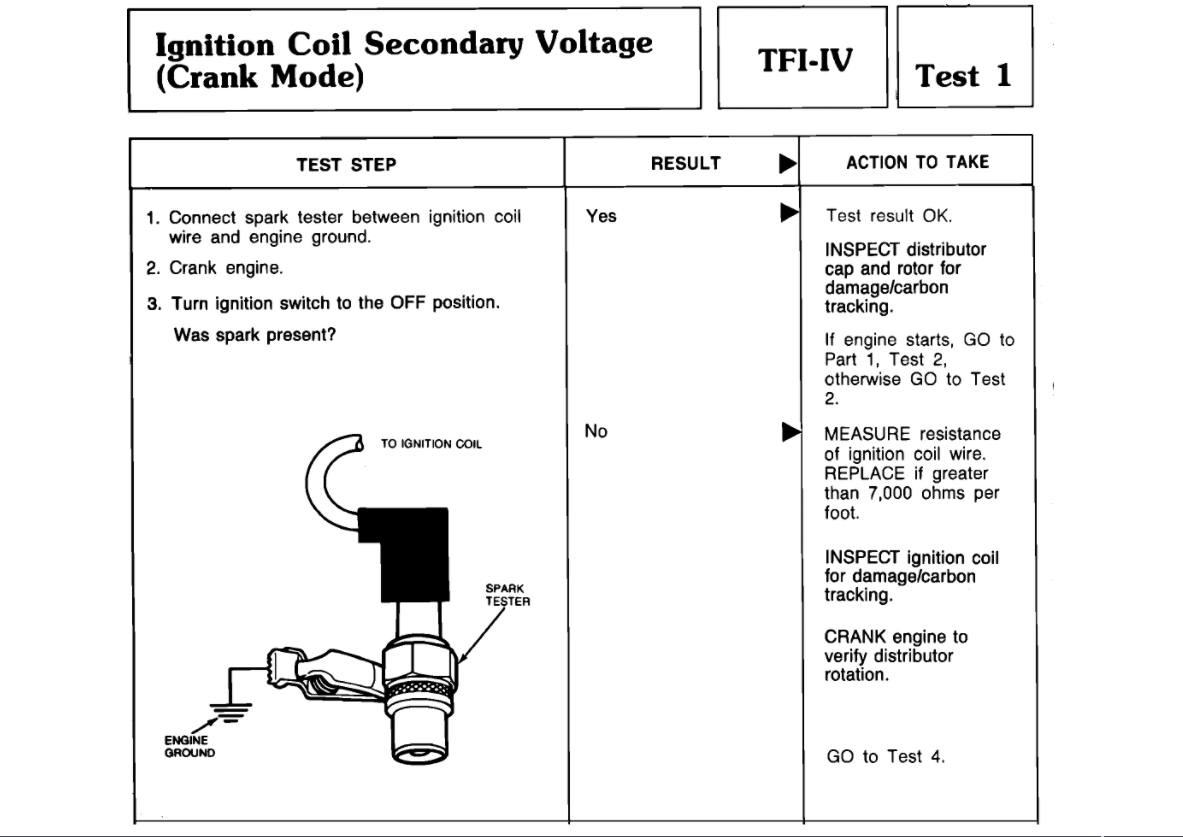

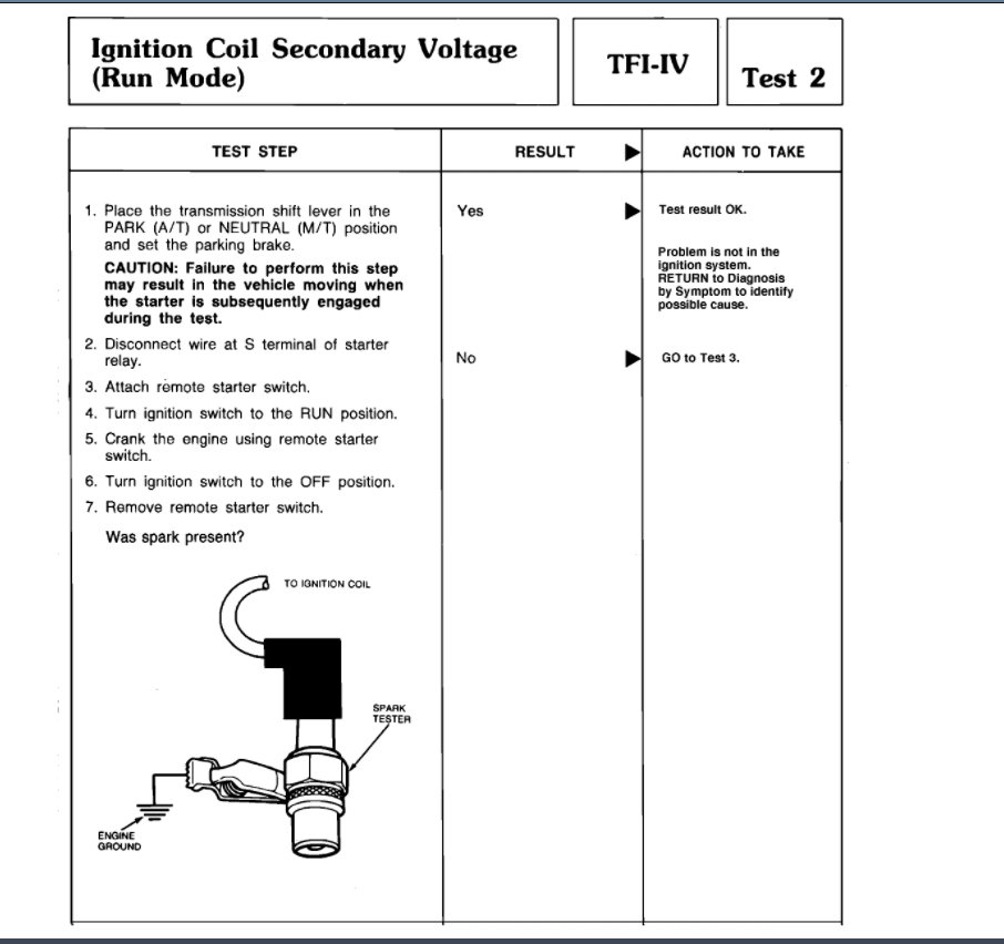

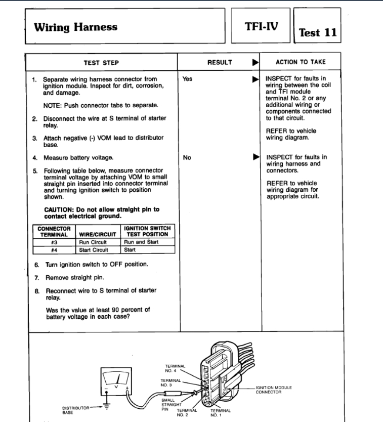

Hello again,

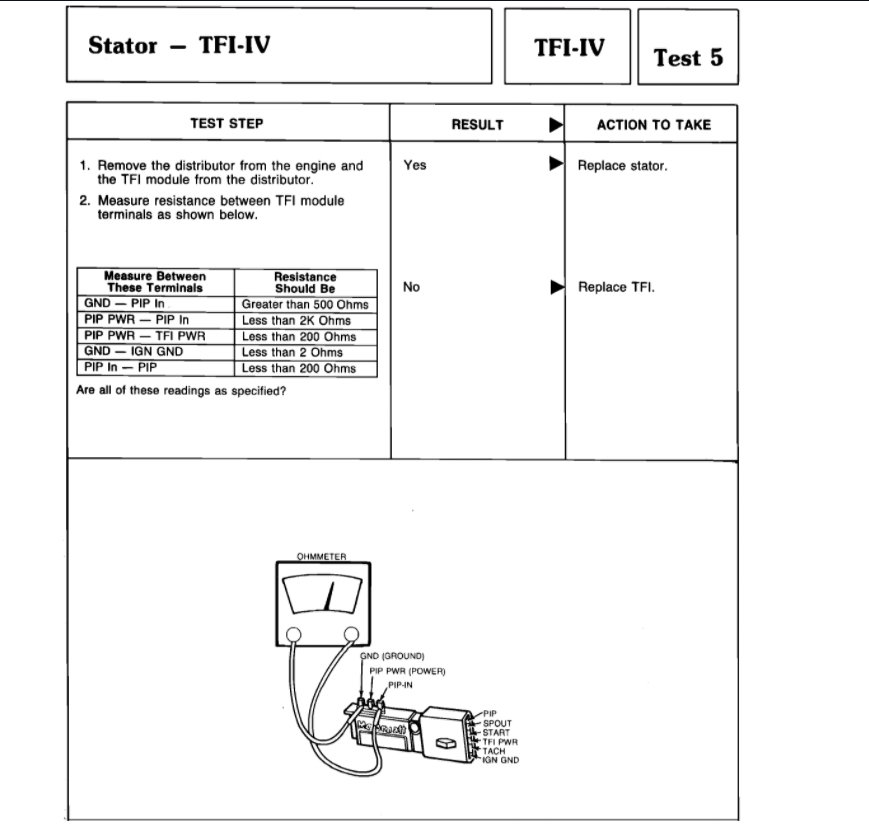

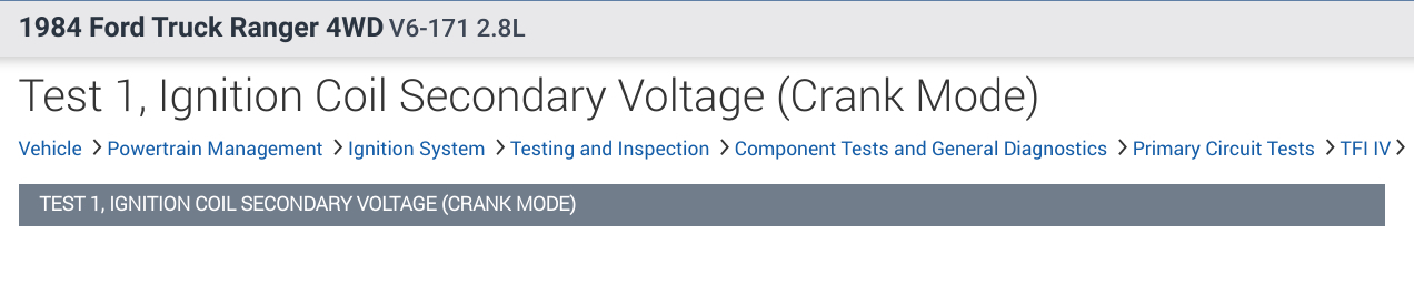

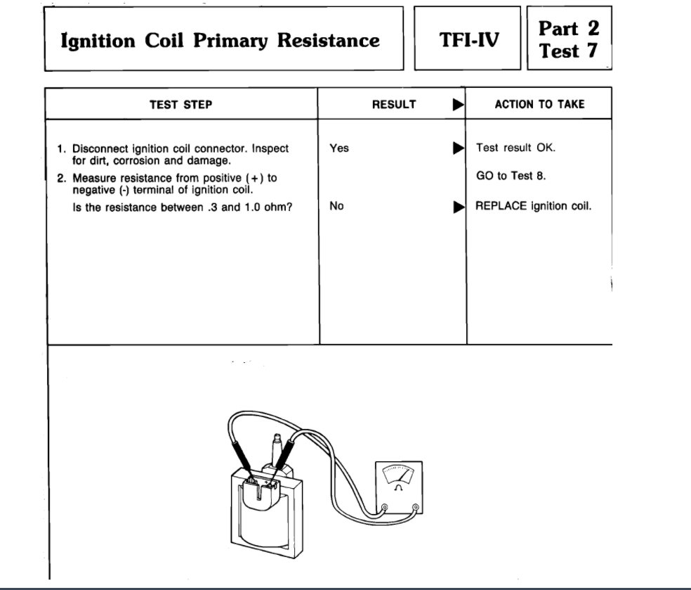

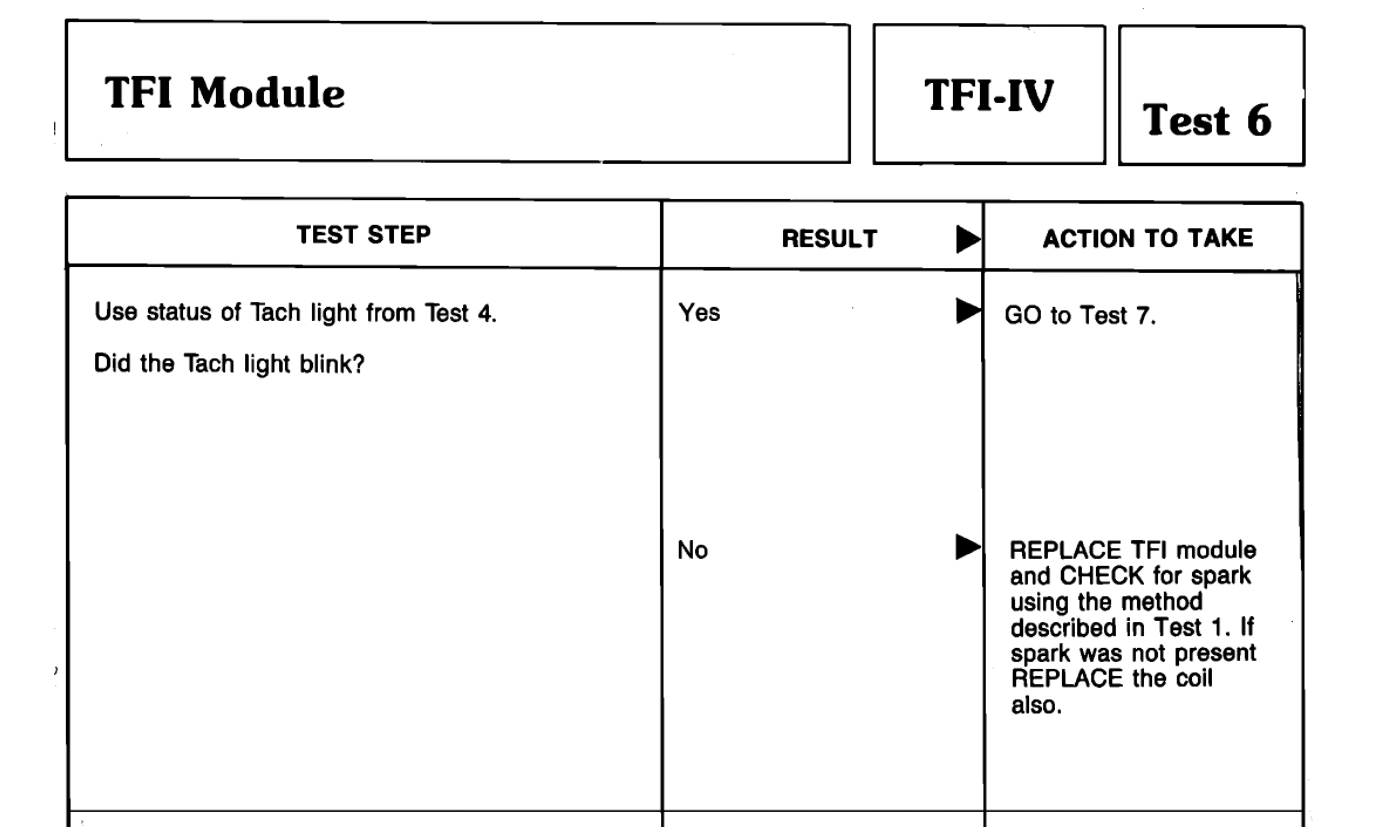

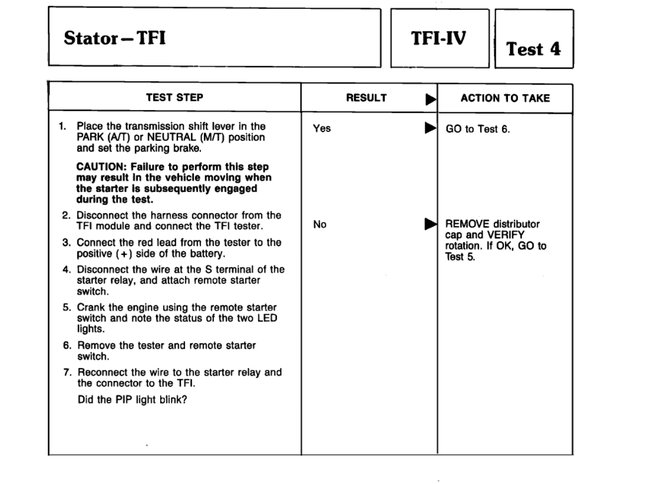

Sounds good. In the diagrams down below I have included the diagnostic troubleshooting guide for your vehicle's ignition system from the vehicle manufacturer. You will need to use a Digital Multi-meter [DMM] to go through this guide, so here is a link below explaining how to, if needed:
Please go through this guide and report back with how everything turns out.
