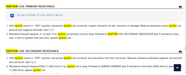

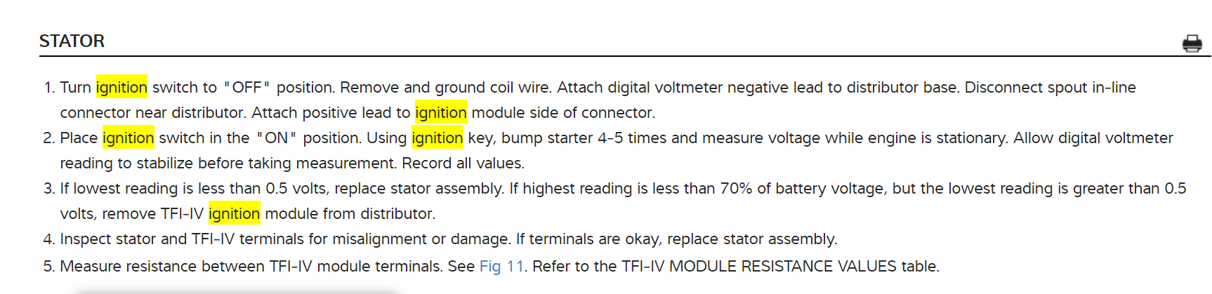

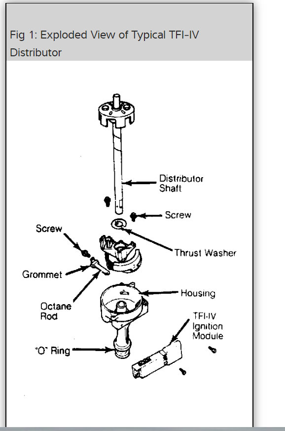

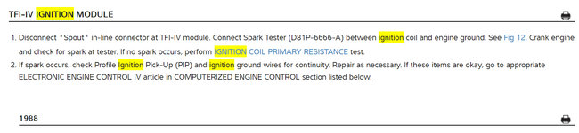

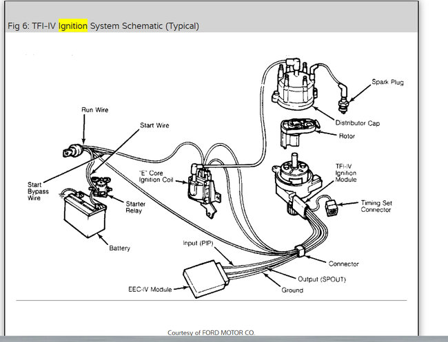

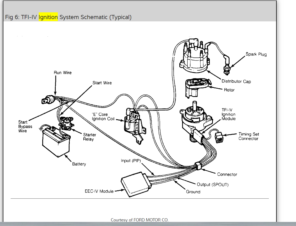

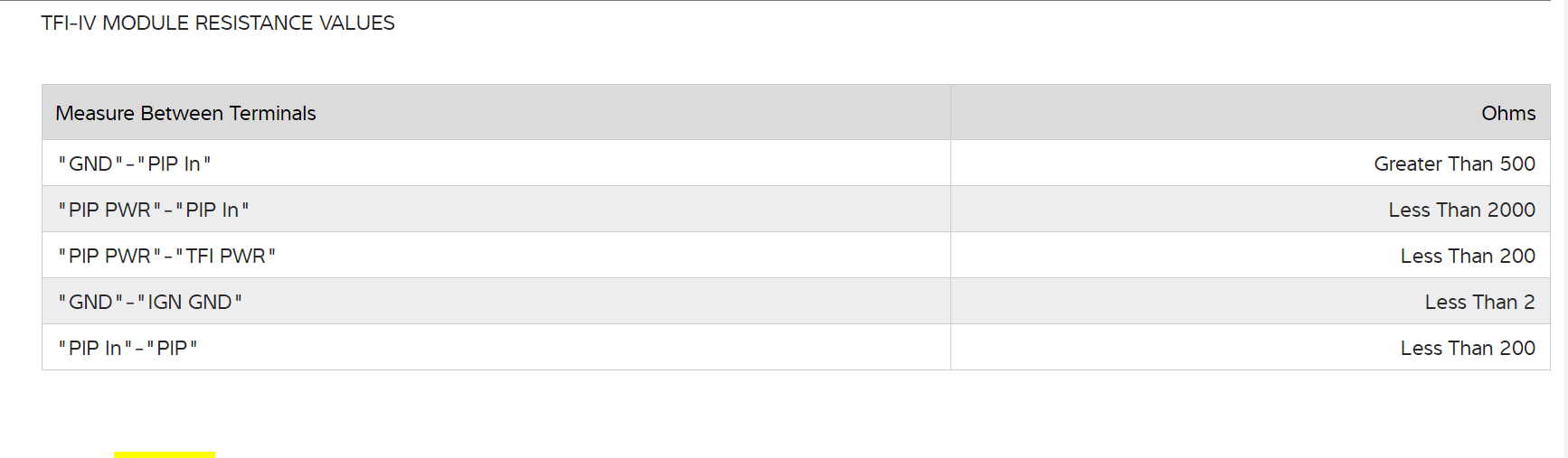

Was driving engine cut out for split second then kept going like nothing happened. Then it totally quit running. so replaced ignition control module got it started then shut hood and it shut off and can’t get it started. I replaced terminals they were beat up, then lost spark. so replaced the entire ignition has new spark plugs, spark plug wires, battery, and starter.
Mar 20, 2019 at 9:04 PM
SCGRANTURISMO
  • 4,897 POSTS

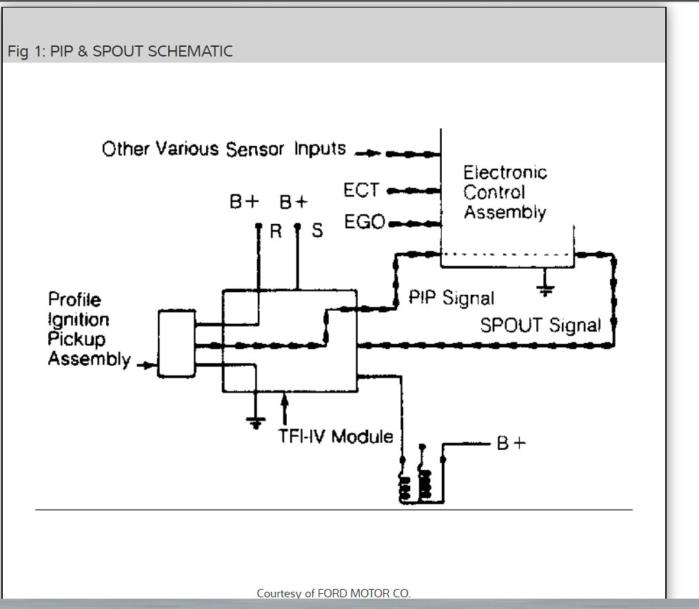

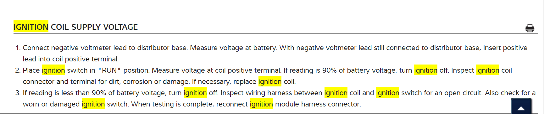

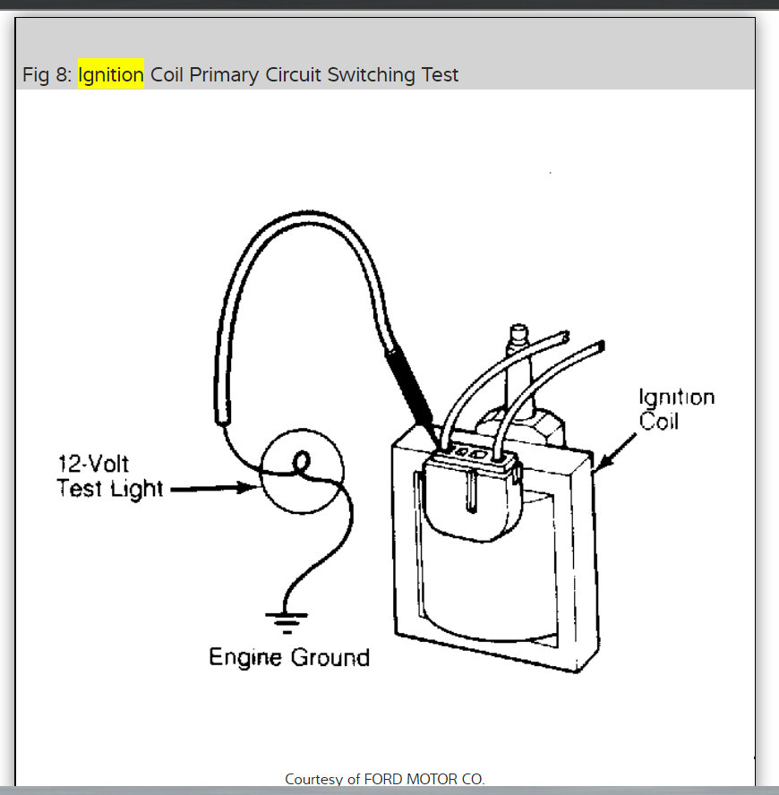

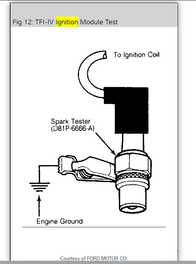

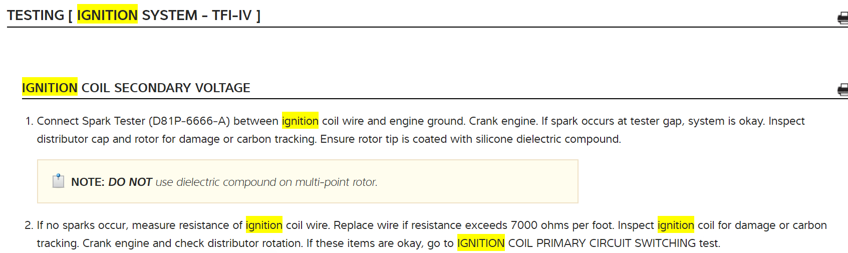

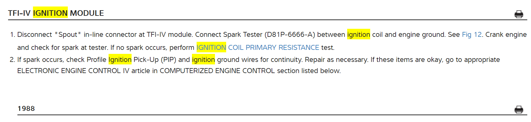

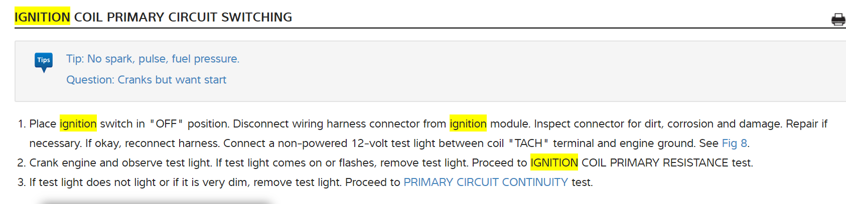

This could be a problem with your ignition control module. In the diagrams down below I have included for you a factory Troubleshooting Flowchart Guide for you to go through. It will take you step by step on what to test and test for to find out what is going on with your ignition system. The tests are straight forward and only require a test light, Multi-meter, and a spark tester. Please go through it and get back to us with what you find out.

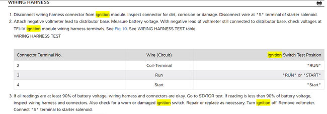

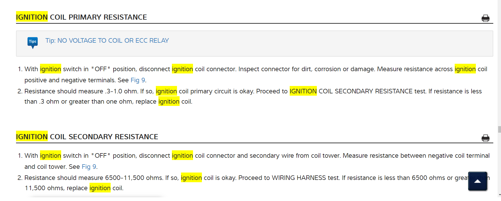

2.47 on ignition module 4.79 on harness on one.

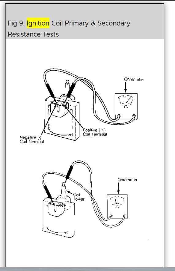

Just replaced primary coil. still nothing.

What did you get for the readings on your tests?
Thanks,
Alex
2CarPros
Aug 14, 2020 at 11:27 AM

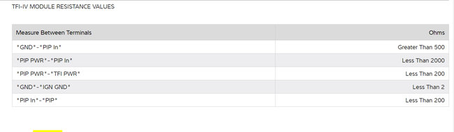

RAYRAY95
  • 8 POSTS

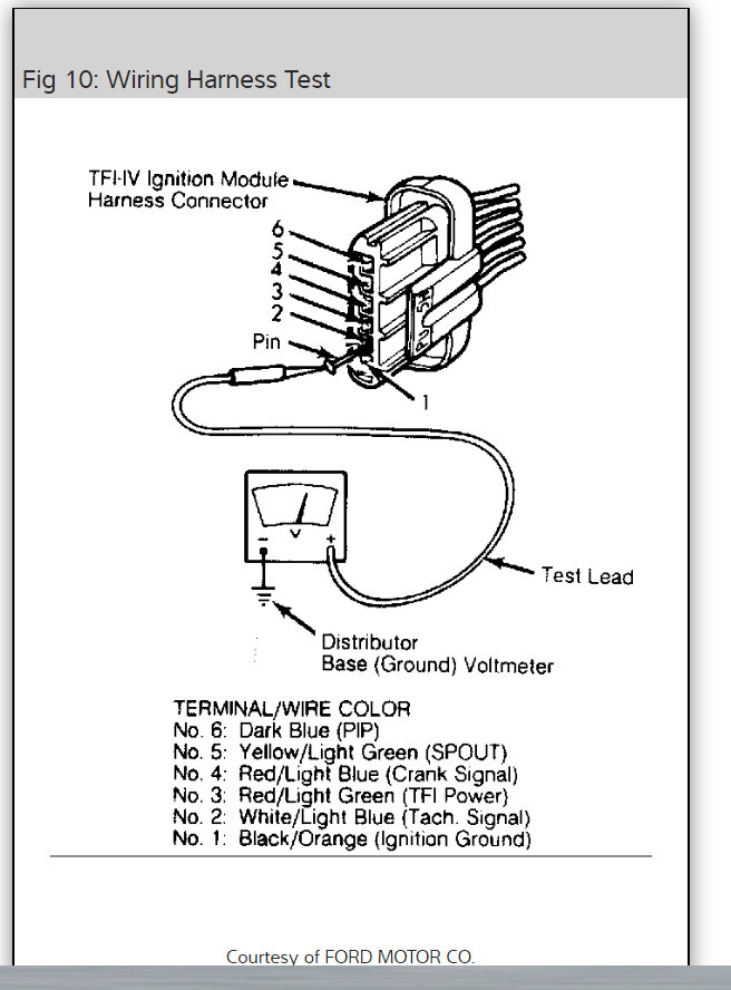

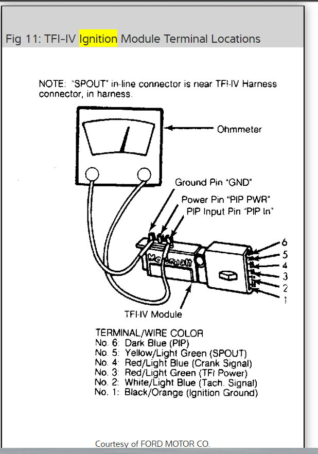

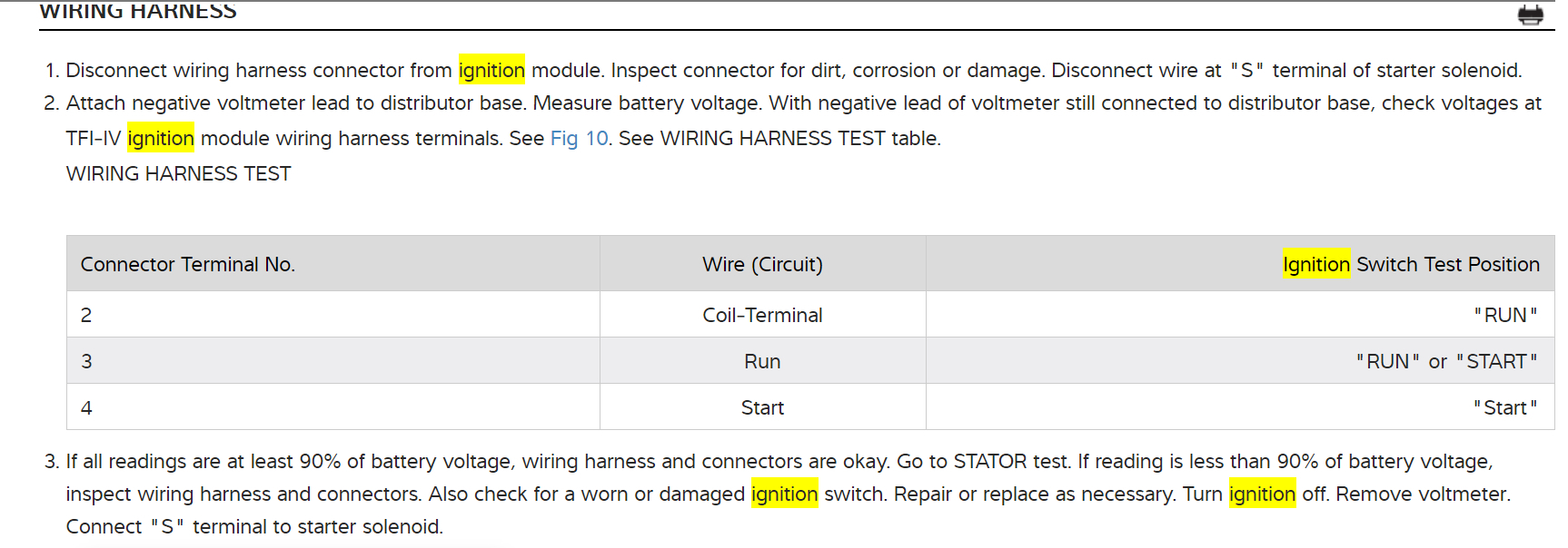

Figure 11 I got 2.47 ohms figure 10 wiring harness I got4.79 ohms.
SCGRANTURISMO
  • 4,897 POSTS
Hello again,
Okay, fig. 10 was wanting you to check for voltage at pins 2,3,and 4 of the ignition control module connector. Have the negative probe(Black) connected to the base of the distributor. Unhook the "S" wire from the starter solenoid. If the voltage at each pin is 11 volts - 12.6 volts then go to next text. If the voltage at any one of the three pins, 2,3,or 4 is less than 11 volts then check for worn connector or wiring. Repair as necessary. Do this test for me and get back to us with what you find out please.
