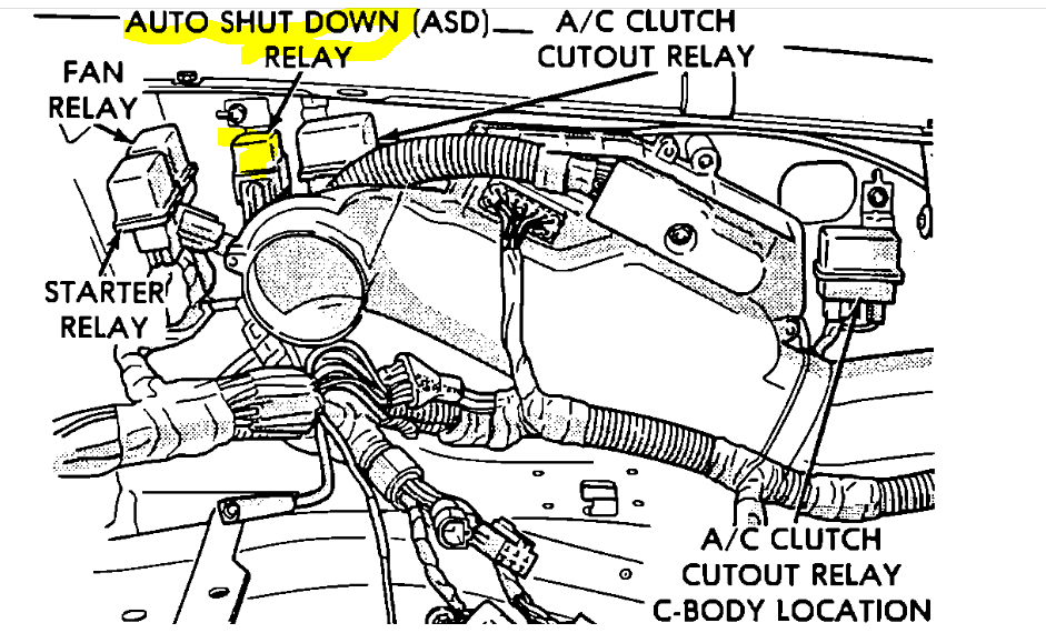

Which relay are you referring to? If the fuel pump is turning on when you touch one of the wires with a tester, it sounds like there is a bad ground and you are providing it with the tester.
Is it the automatic shutdown relay (ASD) you are referring to? Let me know. I'm trying to look through wiring schematics, but they are extremely limited because of the model year. However, based on your description, it sounds like the ASD relay is faulty or the ECM isn't providing a ground path to actuate the relay.

It said it is fuel pump relay in one of the diagrams on this site it's the only black plastic relay the other 3 are metal relay.
Nov 27, 2023 at 9:23 PM
I attached a pic below showing the location. Let me know if that is what you are referring to.
Also, I have the same vehicle. LOL I ordered it in 1987. I wanted a convertible. It now has 9,000 miles on it. LOL
See pic below.
Nov 27, 2023 at 9:35 PM

Yes.

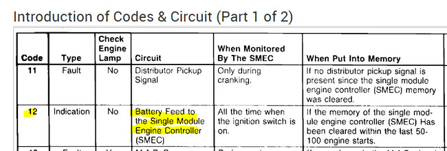

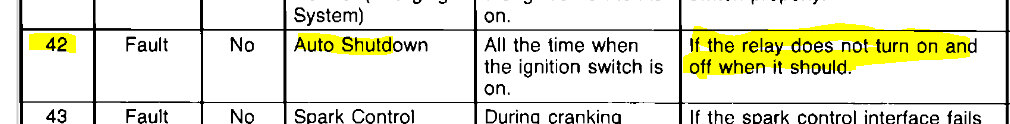

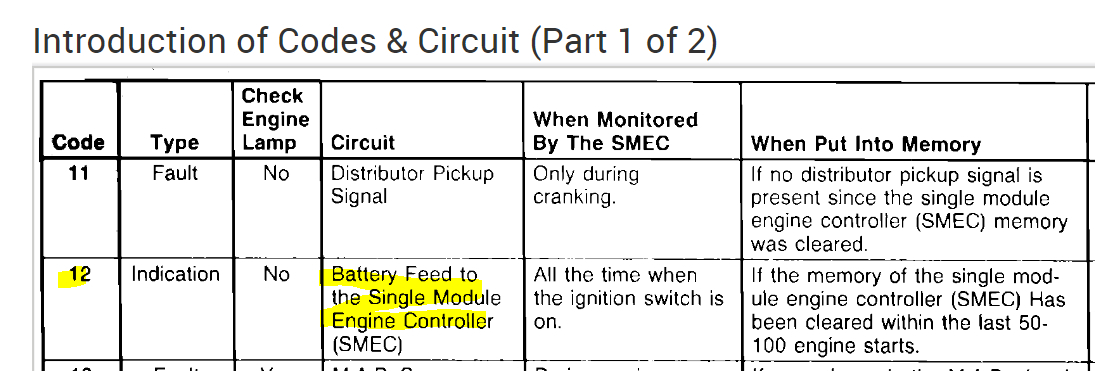

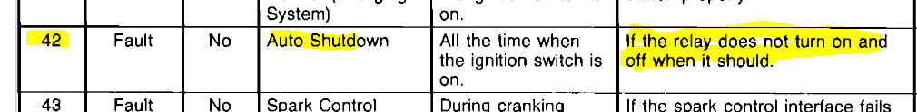

So, I did the diagnostic on my car and came up two codes 12 and 42.
Nov 30, 2023 at 4:06 PM

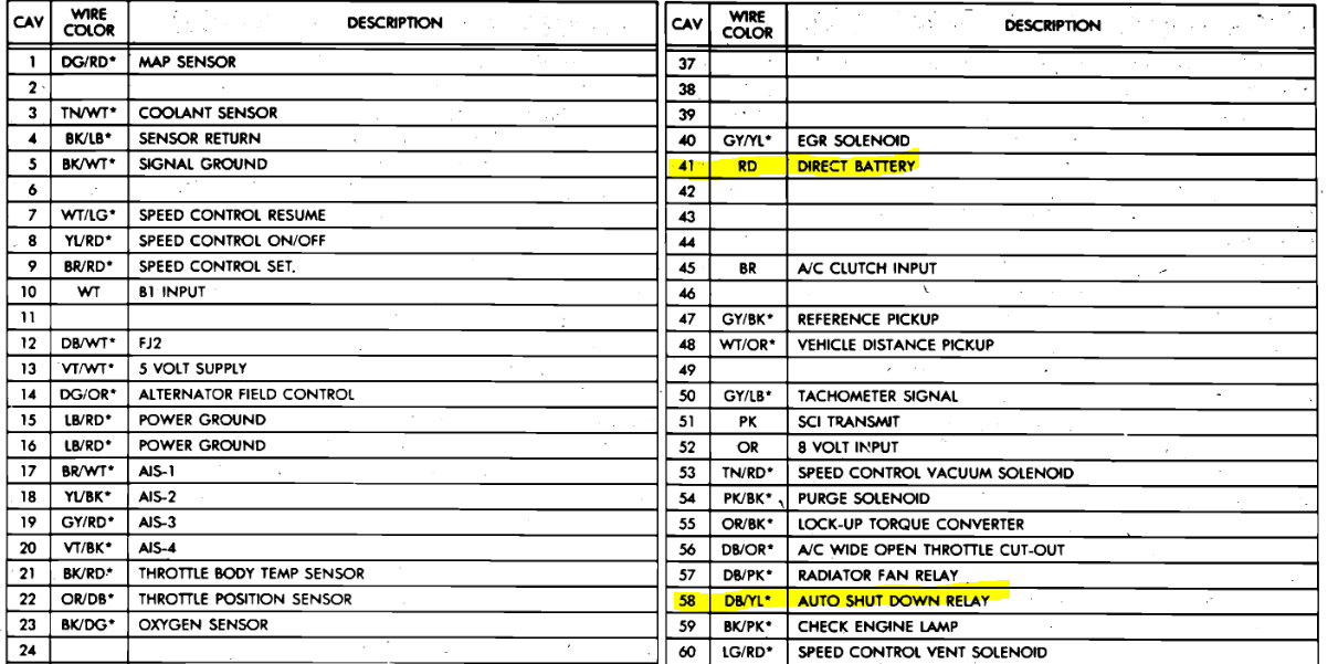

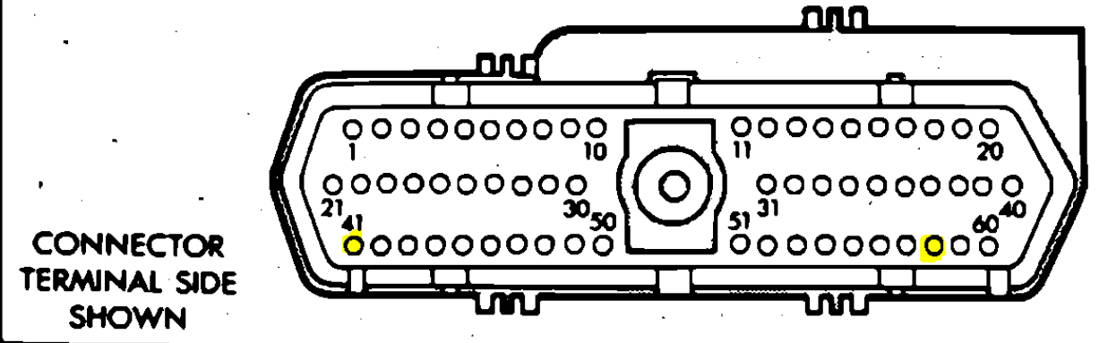

Okay, the two are tied together. Code 12 is related to the single module engine controller (SMEC) and the 42 is related to the automatic shutdown (ASD). (see pics 1 and 2 below).

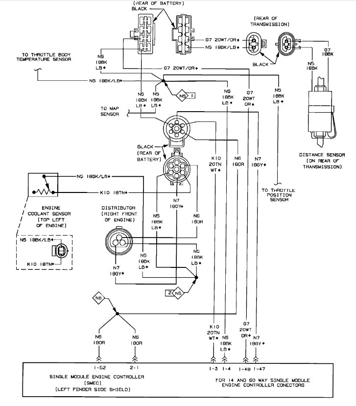

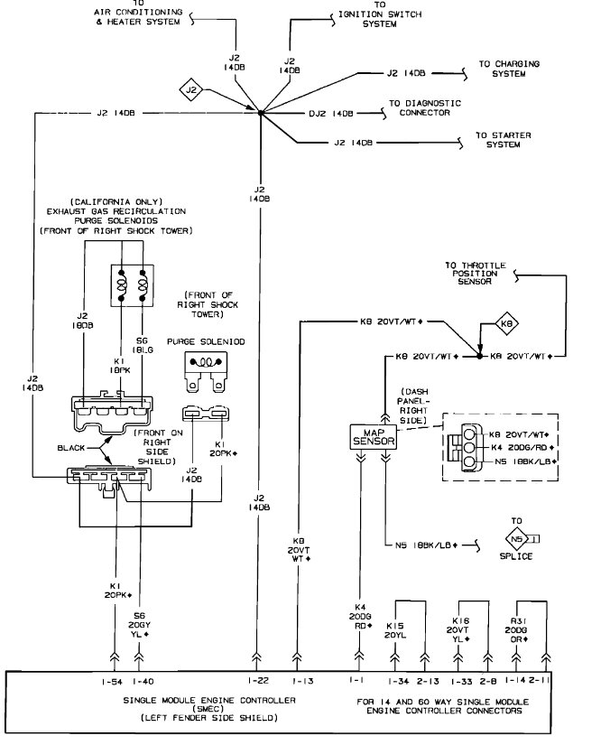

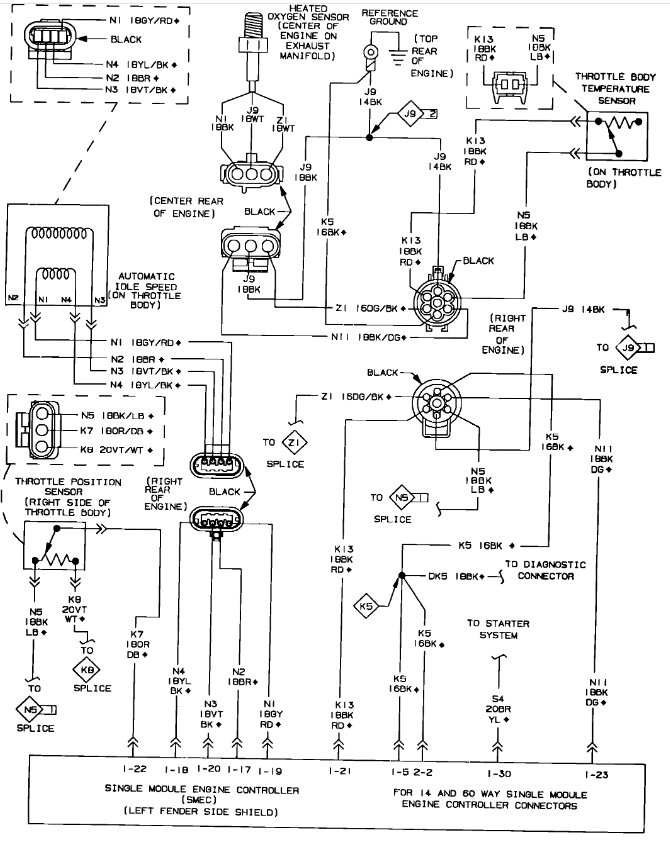

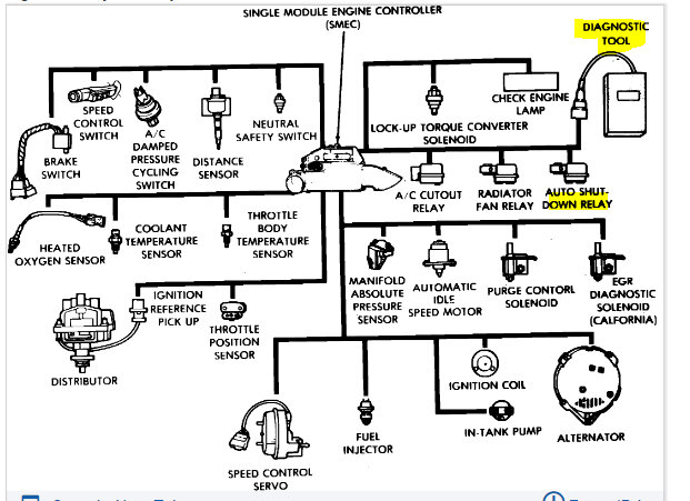

What I need you to do is remove the 60-way engine controller connector, check pin 41 for power, and check if pin 58 provides a ground path when the key is turned on.
Pics 3 and 4 show the pin legend and the connector pinout. I highlighted the pins that need to be checked. Also, make sure they are not damaged, corroded, or bent.
See pics below. Note: The SMEC is behind the battery and has an air cleaner duct connected to it.
Nov 30, 2023 at 7:11 PM
JERRY ULLOA
  • 36 POSTS
So, I tested the pins and there's power in 41but pin 58 comes on when I ground it with test light.

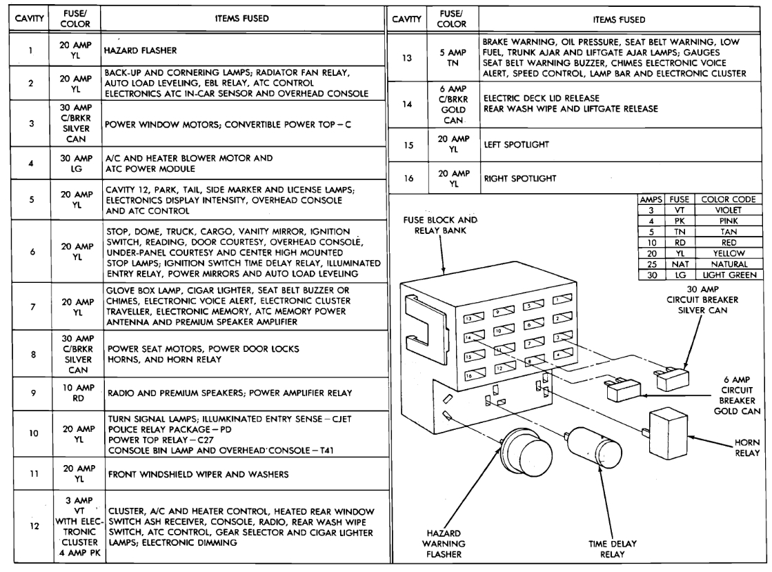

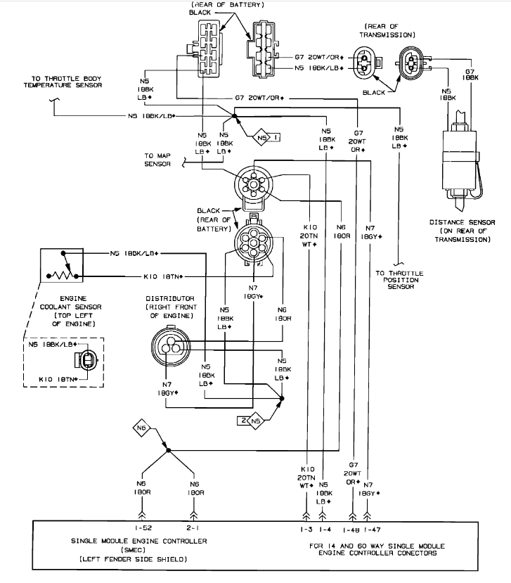

Let's go back to basics, please turn the ignition switch on and check all of the fuses, also while the switch is on check the positive side of the coil for power.
This guide can help:

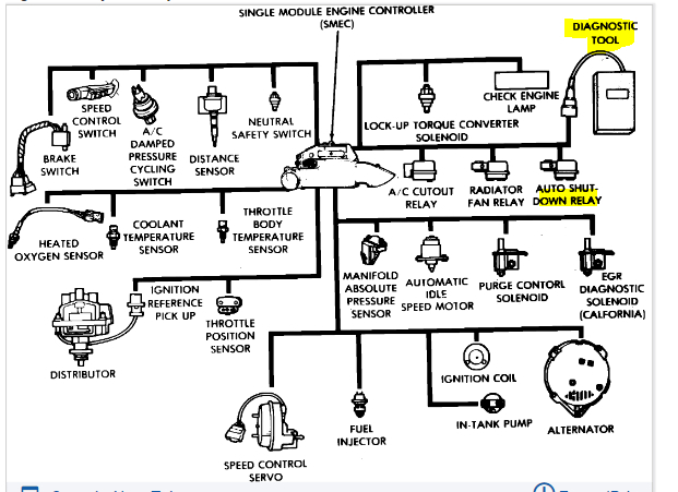

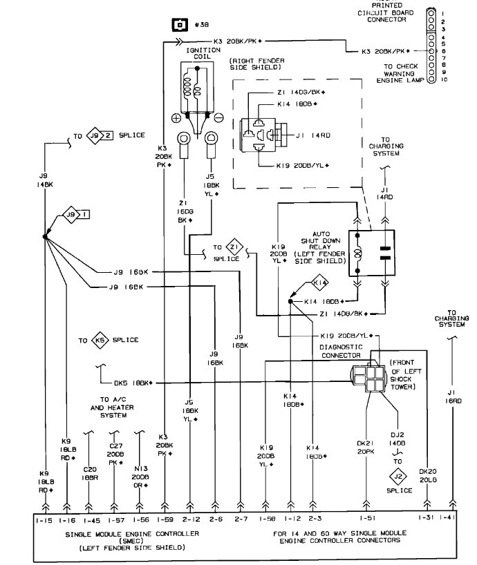

Here are the engine and computer wiring diagrams so we can be on the same page and be able to see how the system works. Check out the images (below). Please upload pictures or videos in your response to the problem so we can see what's going on.
Jan 24, 2024 at 10:00 AM

Did you check the fuses and swap out the ASD relay?
Jan 28, 2024 at 11:03 AM
JERRY ULLOA
  • 36 POSTS
That was the first thing I changed is the ASD relay.
Jan 28, 2024 at 1:47 PM
JERRY ULLOA
  • 36 POSTS
Which fuse do I need to check?

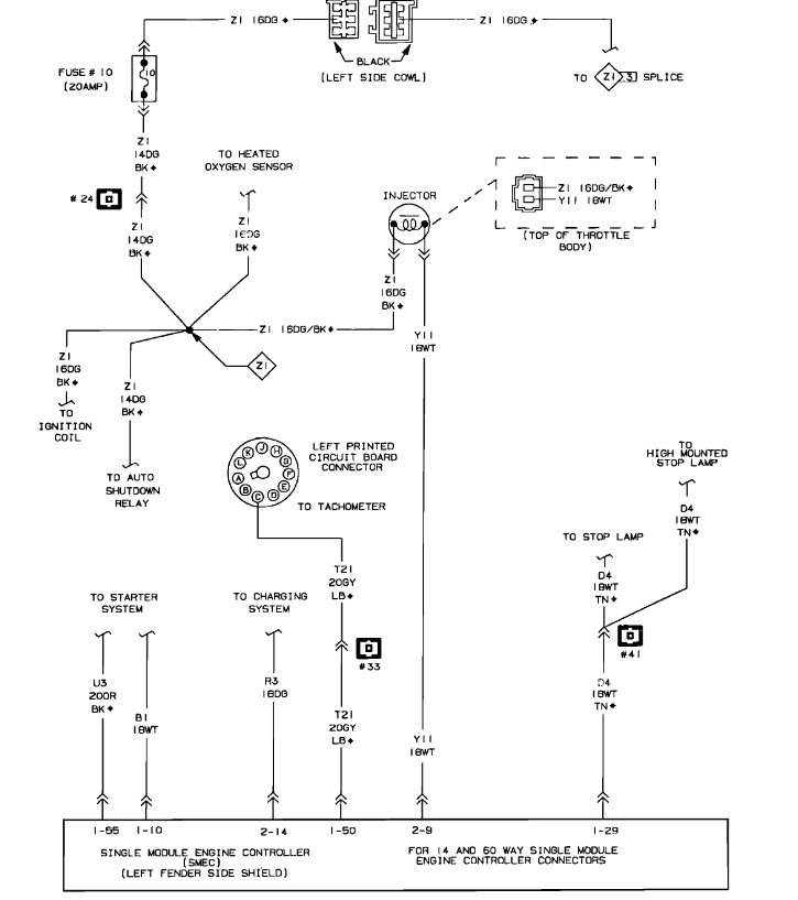

Jan 28, 2024 at 1:48 PM

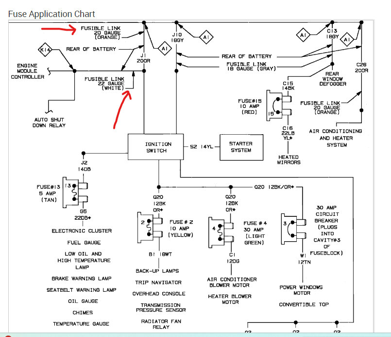

There are fusible links near the battery, pull on them to see if they are connected. These are wires that burn up inside, you will need to replace them. Check out the images (below). Let us know how it goes.
Jan 29, 2024 at 10:06 AM
