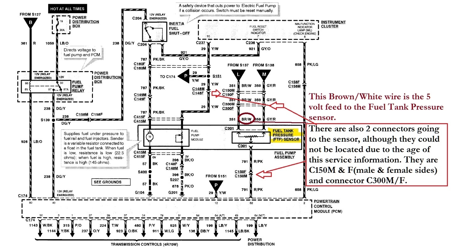

Ok I will recheck on Fuse 20, but which sensor did you check the 5volt reference on and how did you check it? For example if you unplug the throttle position sensor (TPS) on the throttle body, turned the key On and only read 1.2volts (Brown/White wire), I would do the same for the next sensor you can get to which is the EGR position sensor (DPFE). If that sensor reads the same exact voltage reading as the TPS on the Brown/White wire, you are going to have to get to the fuel tank pressure sensor and unplug it as well. Its not easy to get to but you need to be sure this isnt a shorted out sensor pulling the 5volts down. I am kind of surprised you have any voltage on the reference wire.

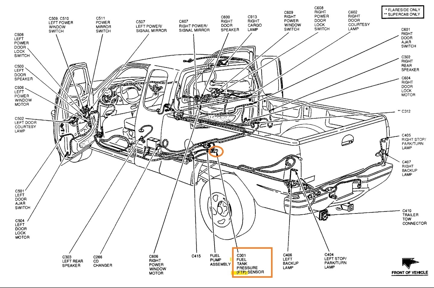

Let me see if there is an easy connector to get to so you can unplug the fuel tank pressure sensor without having to mess around at the top of the gas tank, you can get to the plug but they are difficult. So if we can isolate that circuit by unplugging it somewhere easier that will help with any frustration. That 1.2volts might be the issue, I assume the battery voltage is ok, if its dropped below 12.4volts I would put a charger/maintainer on the battery while testing, or you will get skewed readings. And yes you should get a resistance reading, but checking resistance while a circuit has current running through it will give inaccurate readings, so you need to unplug components and circuits if youre going to do a resistance test on them.

Heres the location of the fuel tank pressure sensor, the 5volt feed to it needs to be disconnected somehow to verify its not the issue. You can slide under the truck and try to find the connector going to the top of the gas tank, it is possible with a mirror and flashlight to find the connector. But get it unplugged and see if the 5volts returns on the other sensors. I know its a pain, on these trucks I take the bed right off when I need to do a fuel pump instead of dropping the tank. But see if you can restore that reference voltage.

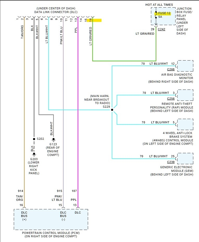

The last diagram is of the data link connector, you should have battery power on pin 16 and grounds on 4 and 5.

The EGR, TPS and Fuel Tank pressure sensors are the ones that share that 5volt reference.
