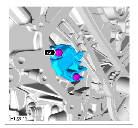

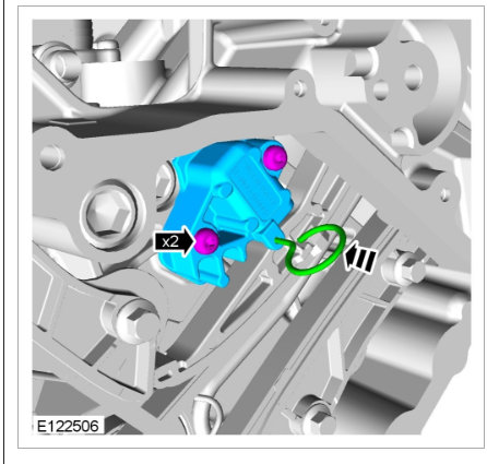

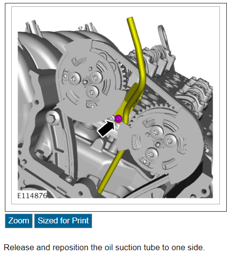

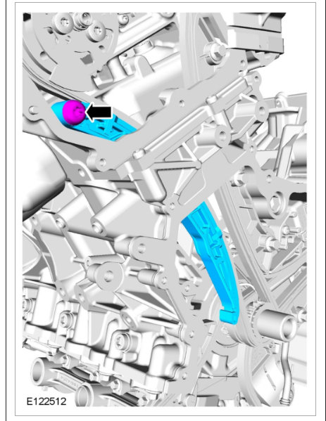

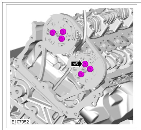

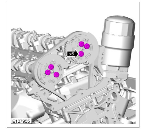

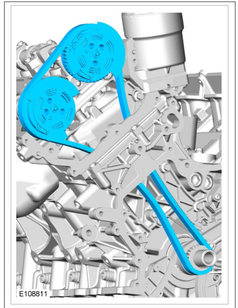

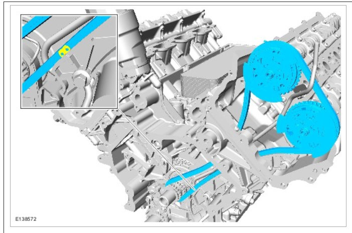

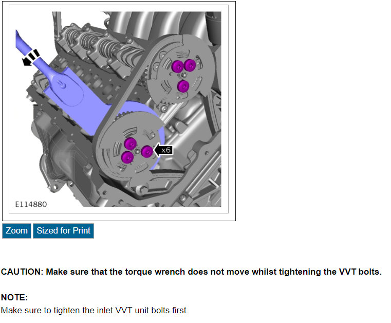

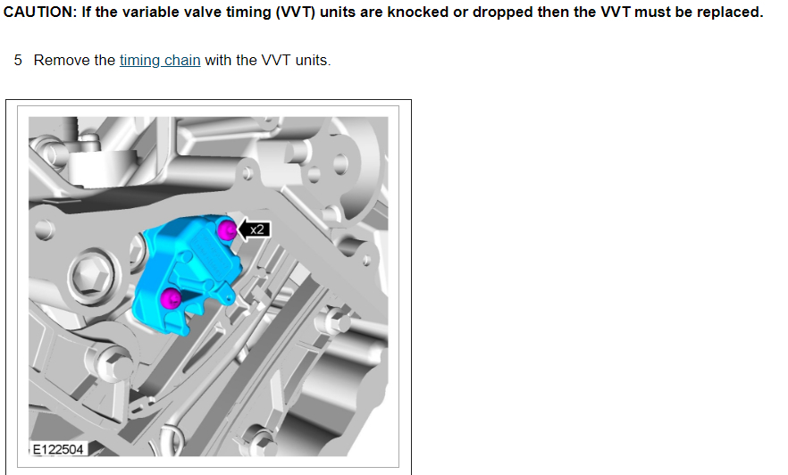

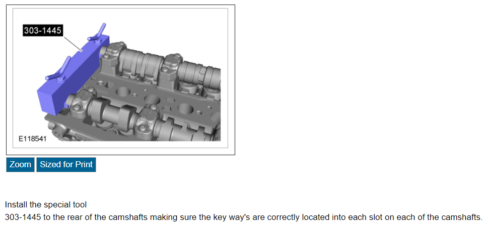

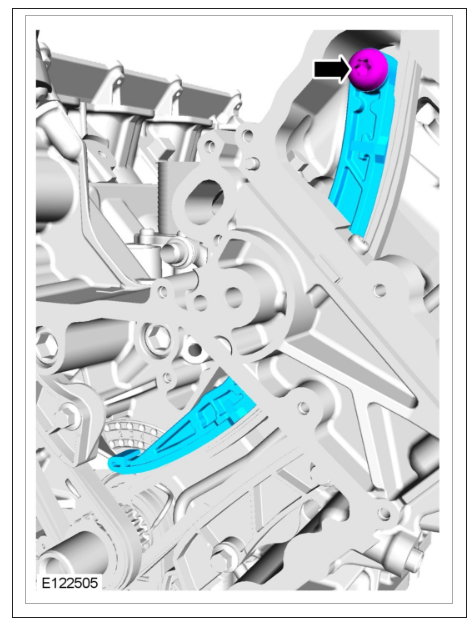

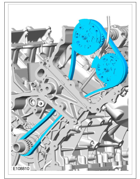

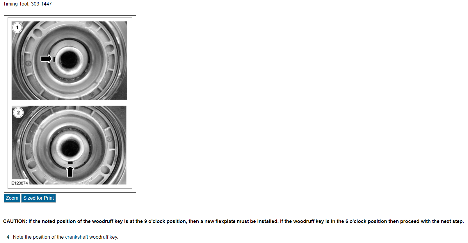

Here are the correct part numbers for the timing chain guides and tension-er's along with diagrams to show you how to do the job:
Parts Information OEM Part # Price
Timing Chain Guide
18 - Tensioner Guide LR051013 $70.98
Chain Guide 19 - Right LR051011 $38.63
19 - Left LR051012 $38.63
17 - Timing Chain LR032048 $98.60
20 - Chain Tensioner LR051008 $129.53
22 - Timing Chain, Intermediate Gear
Includes: Intermediate Gear. LR067417 $381.61
Timing Drive Components
This is a "Trustmark Authoring Standards (TAS) Repair Procedure"
TAS style procedures can be identified by steps that have no accompanying step text and the magenta color of the electrical connectors and fasteners such as nuts, bolts, clamps or clips.
TAS removal and installation procedures use a sequence of color illustrations to indicate the order to be followed when removing/disassembling or installing/assembling a component.
Many of the TAS procedures will have the installation information within the removal steps.
The TAS color illustrations use a variety of symbols to indicate important details of the procedures. It is important to understand these symbols in order to properly used the TAS procedures. Refer to How to Use TAS Procedures and TAS Symbol Glossary at Vehicle | Description and Operation for additional information on these TAS procedures.
For additional information, refer to How to Use TAS Procedures See: Description and OperationHow to Use TAS Procedures
Removal
Caution: Check all timing components for wear and install new components if required.
Note:
Removal steps in this procedure may contain installation details.
Note:
Some variation in the illustrations may occur, but the essential information is always correct.
1 Disconnect the battery ground cable.
For additional information, refer to Specifications
Warning: Make sure to support the vehicle with axle stands.
2 Raise and support the vehicle.

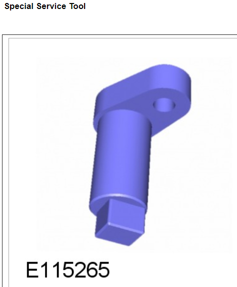

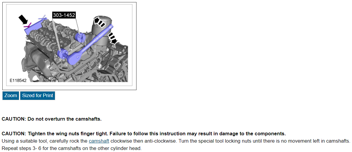

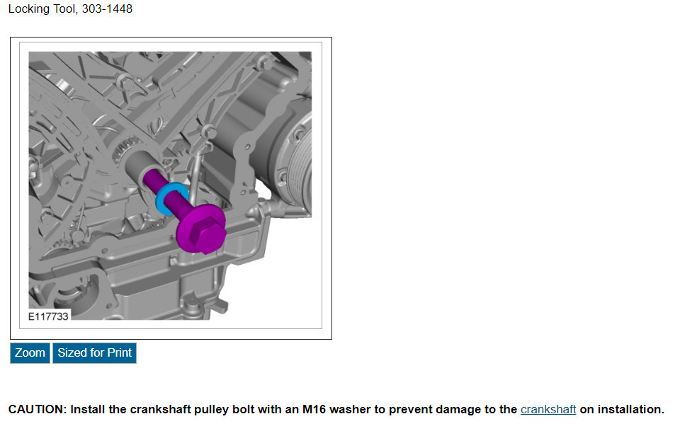

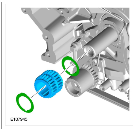

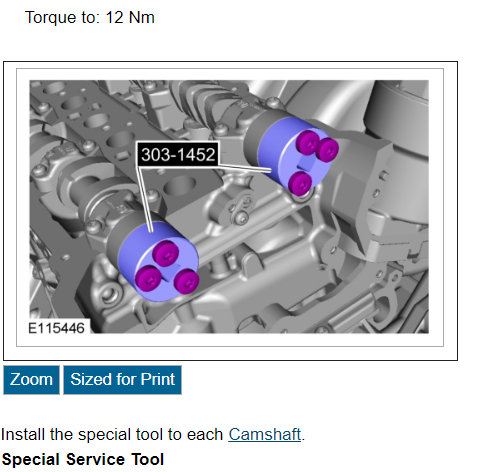

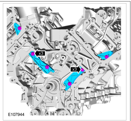

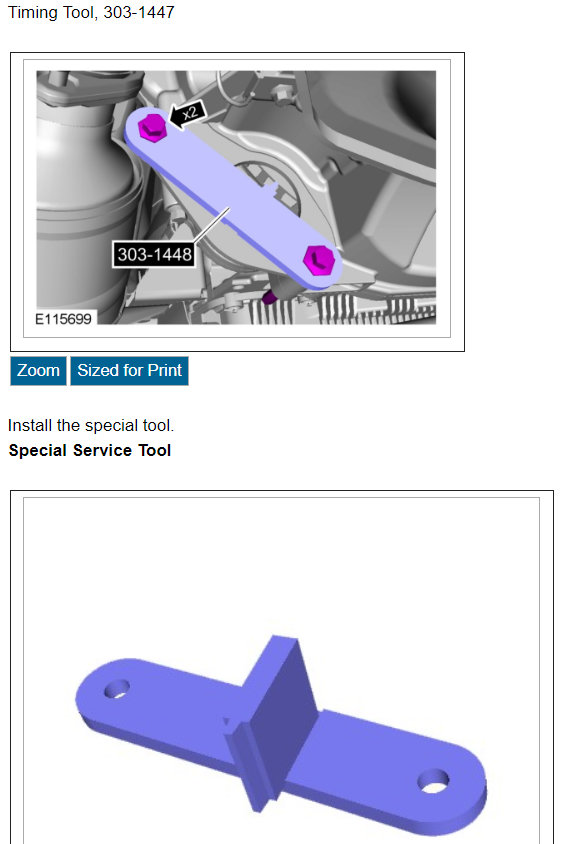

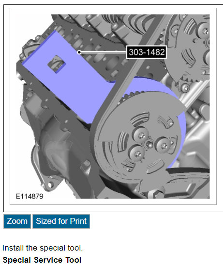

Here are the diagrams you will need to replace the timing chain and guides with the tension-er's. (Below)

My question is, as far as I can tell there is only one way everything lines up? in other words there is no 180 off or anything like that right?
Jul 24, 2018 at 1:33 PM
MARK FRIZZELL
  • 142 POSTS
Actually I mean 360 off.
Jul 24, 2018 at 1:34 PM
MARK FRIZZELL
  • 142 POSTS

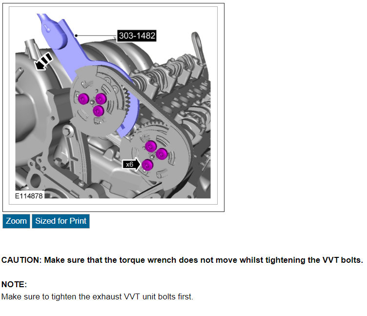

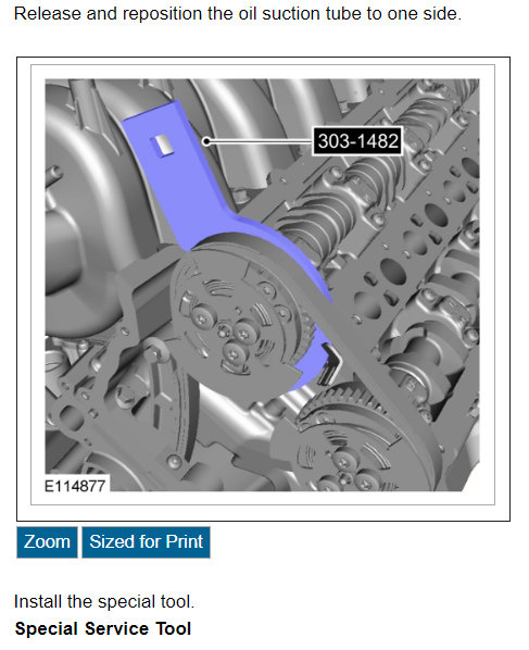

I notice that as I rotate engine the marks on the old factory chain never line up, is this because of the VVT?
Jul 25, 2018 at 8:35 AM

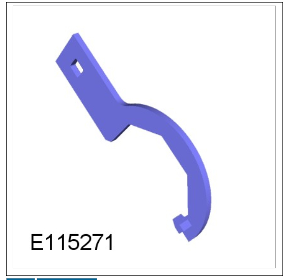

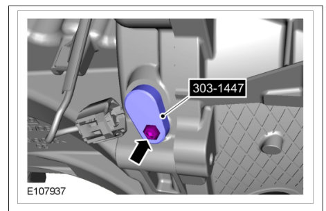

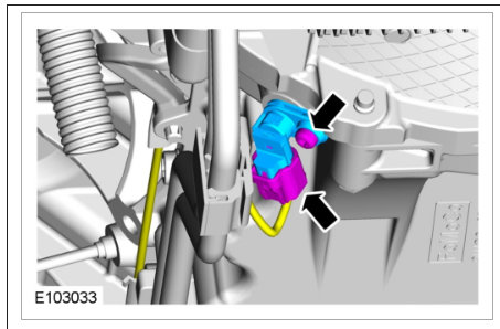

Correct you must bottom out the VVT to set the timing in the guides above they have you remove the camshaft angle sensor but I think you can do it without the special tool. Just make sure the camshaft actuators are all the way back (not advanced).
Jul 25, 2018 at 2:13 PM
MARK FRIZZELL
  • 142 POSTS
Yeah, that is what I thought. I have the tool for VVT's, I assume the engine rotation is clockwise as your looking at the front of crank, and VVT set all the way back would be counter clockwise.
Jul 25, 2018 at 2:38 PM

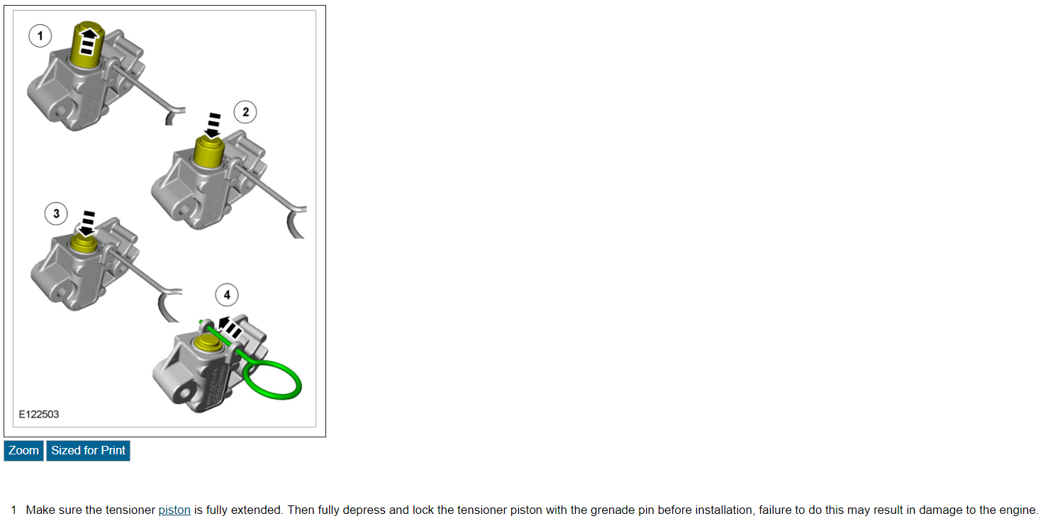

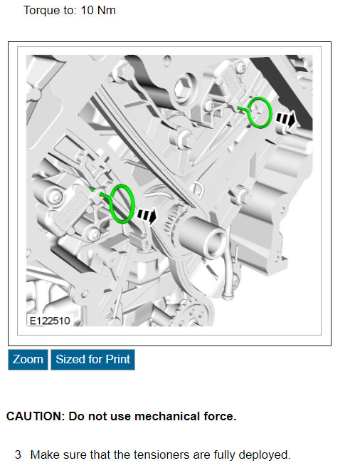

Okay Ken, things are looking good except when I pulled pin on one tension-er then reset it, it will not spring back out? What happened?
Jul 30, 2018 at 12:56 PM
MARK FRIZZELL
  • 142 POSTS
Sorry I got it, was not holding my tongue out. lol

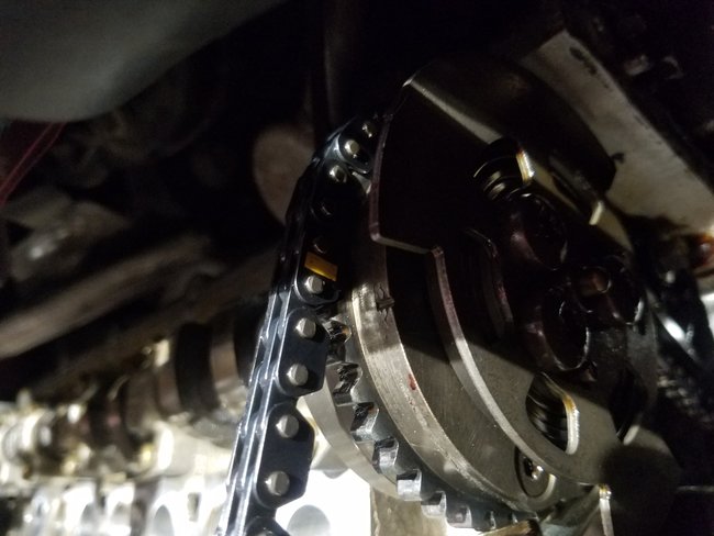

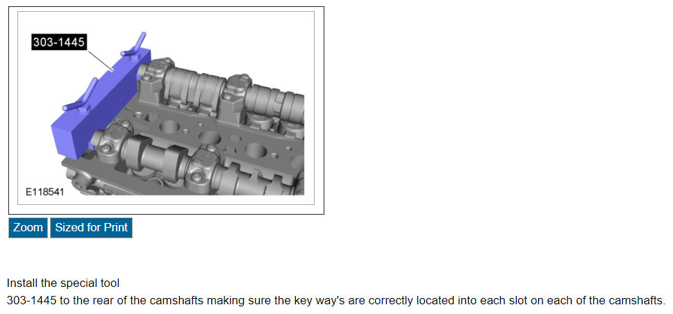

I noticed after get all together, removed the cam holding tool from back of cam on left bank that the cams moved a little bit. Normal?
Jul 30, 2018 at 3:03 PM
STEVE W.
  • 15,113 POSTS
A small amount is okay, like 1/2 a link or less. More than that double check that the marks are okay. If they are still lined up you should be good.
Jul 30, 2018 at 5:08 PM
MARK FRIZZELL
  • 142 POSTS

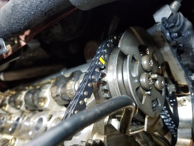

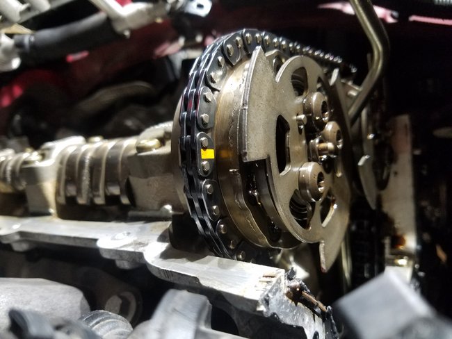

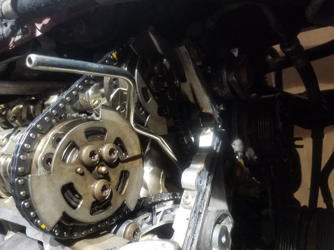

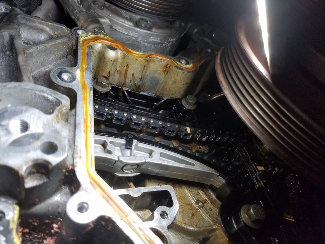

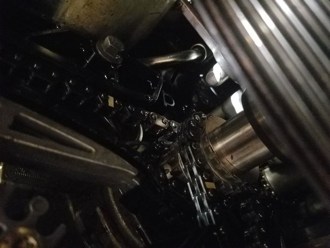

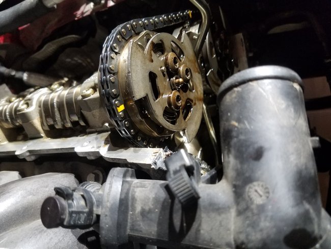

Picture of left bank.
Jul 31, 2018 at 7:23 AM
MARK FRIZZELL
  • 142 POSTS

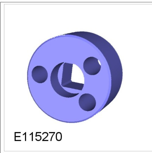

I notice when put the cam tool back on the exhaust cam is just slightly off, not much just a shade enough tool will not go fully in. I really need to get this right real pain to disassemble. lol
Jul 31, 2018 at 7:33 AM
Yes, if the cam tool is on the engine when these images were taking the chain looks like it is off one tooth or the actuator is not fully backed off. Can you send pictures of the cam tool installed?

I could not get cam tool back on the exhaust cam is turned slightly so will not lineup. So guess I should start over.
Jul 31, 2018 at 11:56 AM
MARK FRIZZELL
  • 142 POSTS
The pictures were after I used the actuator tool to tension the chains counter clockwise by the intake cam then removed the cam holding tool went. Back to check and look like the exhaust cam rotated slightly, the cam holder won't got back on. So I should start over?

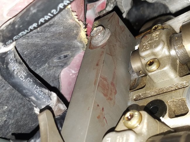

And yes that is my blood on the tool. lol. Is in on the intake side, not on exhaust. No the previous pictures were after the tool was removed.

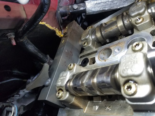

I redid the left bank, this were it is, tool in back fully seated, chain and tension-er on. I have not yet put tension on actuators yet.
Aug 1, 2018 at 9:25 AM
Looks good from here. Are the crankshaft marks lined up you are on TDC? If so it looks good to me. Sorry about the injury.

Yep, crank at 6:00 o'clock, have not put tension on actuators yet.

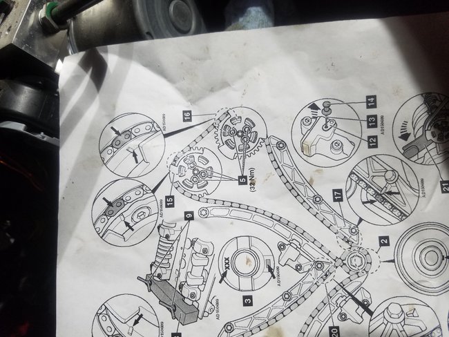

When going to put tension on VVT's they do not budge at all. The bolts are loose on both, just finger tight. Should they not move? To put load on chains? Is it possible to have a bad actuator? Even though the timing marks look right, I noticed the torque bolt do not line up Watson in my picture.
Aug 1, 2018 at 12:43 PM
MARK FRIZZELL
  • 142 POSTS
This is left bank intake cam, all others a correct.
Aug 1, 2018 at 12:46 PM
Actuators go out all the time. It sounds like one is not working right if it will not return to base timing.
Aug 1, 2018 at 4:16 PM
MARK FRIZZELL
  • 142 POSTS
Intake mark on diagram shows mark on other side of the face plate. How much spring movement is there from base timing?
Aug 1, 2018 at 4:24 PM
About 30 degrees.
Aug 1, 2018 at 5:40 PM
MARK FRIZZELL
  • 142 POSTS
Is there a trick to reset them? None of the four returned, surely not all are bad.
Aug 1, 2018 at 6:10 PM
MARK FRIZZELL
  • 142 POSTS
Or it seems they are in the fully advanced lock position, would it be alright to go ahead and assemble ?
Aug 2, 2018 at 7:57 AM
To make sure they are returned to the base position pull them in the opposite way the engine turns, if everything lines up go ahead and reassemble. Let us know what happens. :)
Aug 2, 2018 at 8:52 AM
MARK FRIZZELL
  • 142 POSTS
I assume you mean remove chain and do this?
Aug 2, 2018 at 9:00 AM
No, if the cam tools are in place and the marks line up with the actuators retracted you should be okay.
Aug 2, 2018 at 9:10 AM

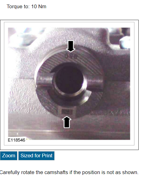

When rotating to setup timing when both tools are on both cams, the square etching on the rear of the cams are down on all four cams at the same time correct? And number one is DTC correct? I never moved anything when chains were off. But just double checking myself.
Aug 3, 2018 at 6:36 AM
Yep, it sounds like you have it all right but to be sure before you put the front back on turn the engine over by hand two revolutions and line up the marks again to triple check if all looks good put the engine back together. Exciting times!
