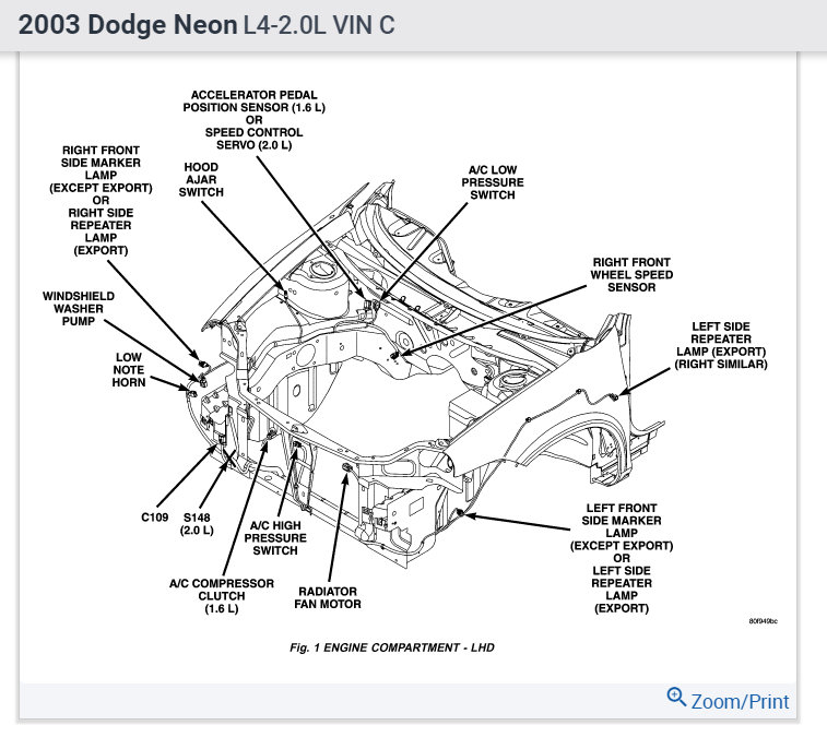

It sounds like the AC system can be overfilled causing the high pressure sensor to kick on the fans. Here is a guide to help us confirm the issue. When you remove the high pressure sensor wiring connector does the fan stop. Here is the location:

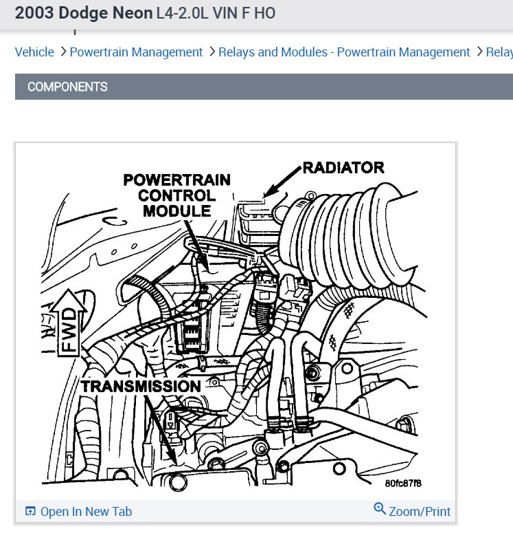

Yep its fun trying to get to the solution. It sounds like the PCM is bad telling the fans to run all the time. I would try a used unit to see what happens. Here is the location. Let me know.

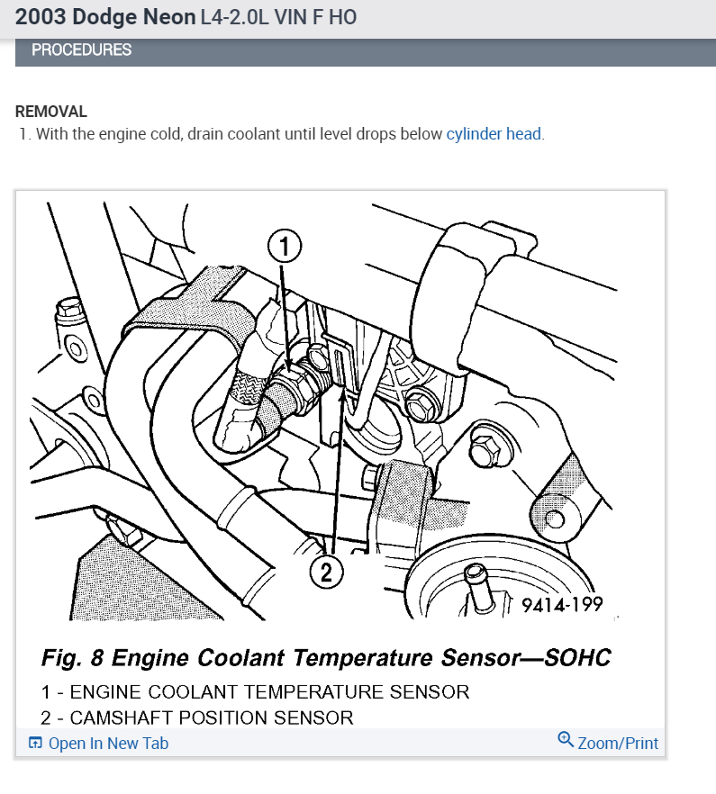

It has got to be the wiring or the coolant sensor then. Here is a guide and the sensor location:
