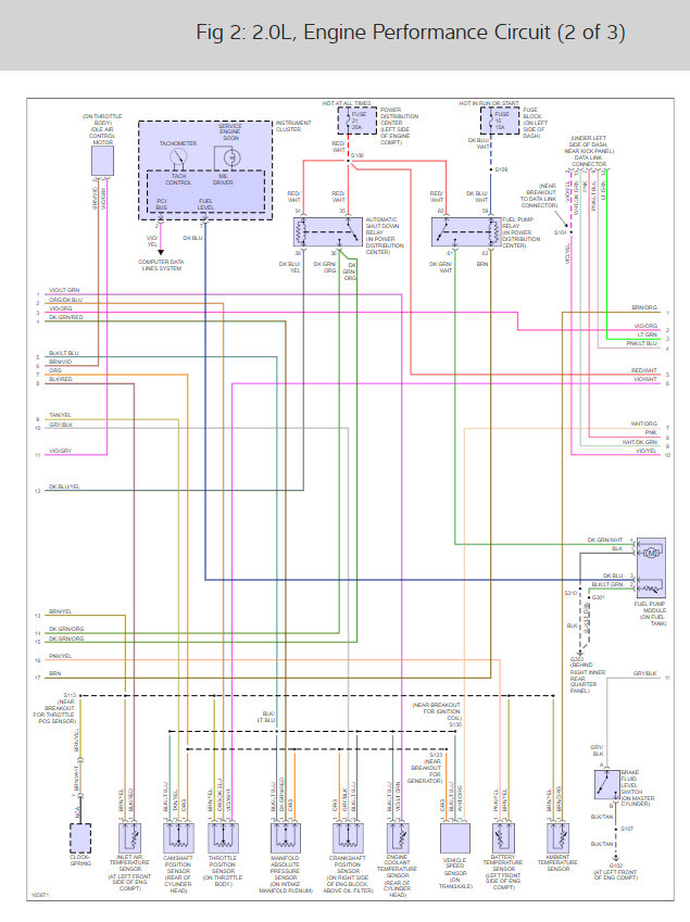

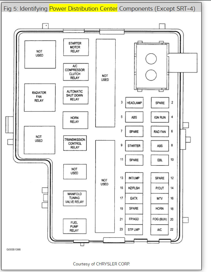

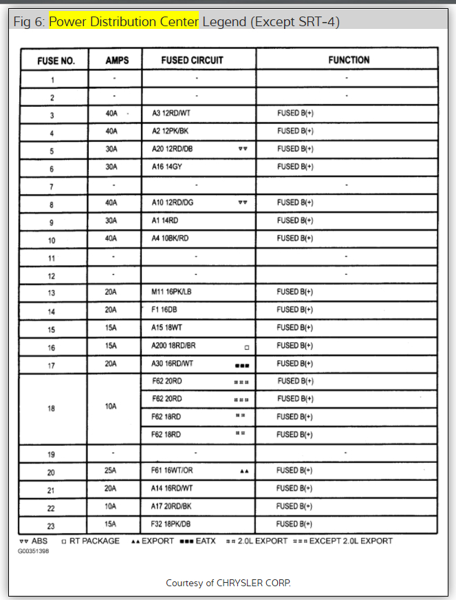

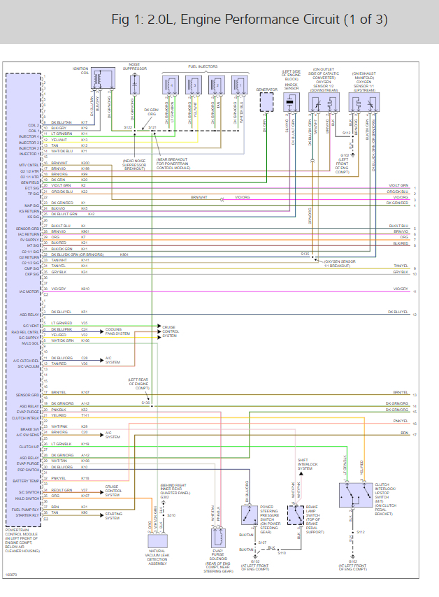

It sounds like you have a fan cooling relay driver stuck on in the PCM and it will need to be replaced. I would try a used one.
Check out the diagrams (below).
Please let us know what you find.

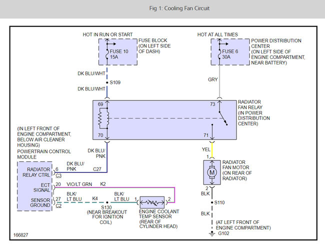

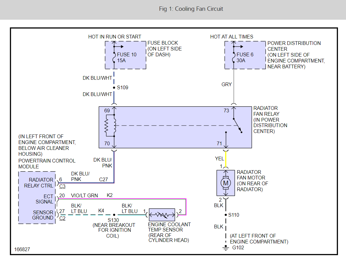

The codes says there is a problem in the circuit. Lets do a pin to pin check on the coolant fan wiring to see what you can find. here is a guide:
Use the wiring diagram above.

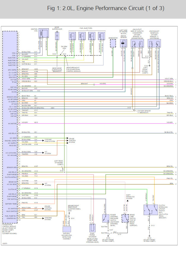

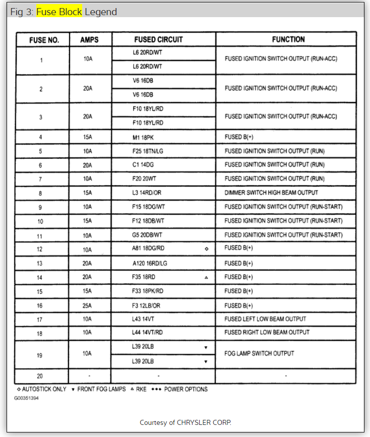

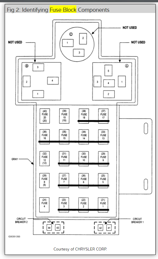

It does sounds like you have a wiring issue. Below are the rest of the wiring diagrams for you.

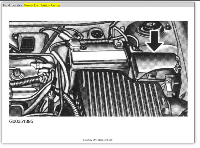

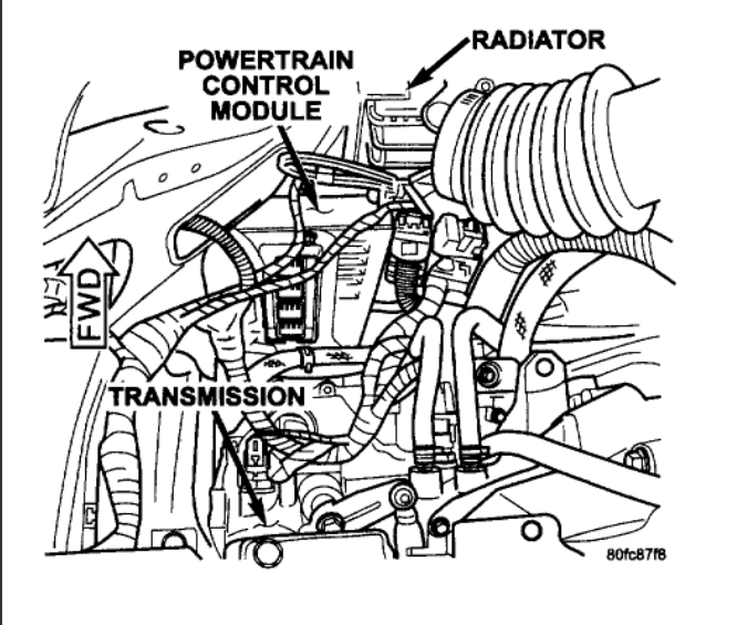

The computer runs the fans, it sounds like its having a problem with the coolant fan control driver inside the PCM. If you checked the wiring I would try swapping the PCM out with a used one to see what happens. Here is the location.
