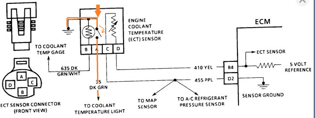

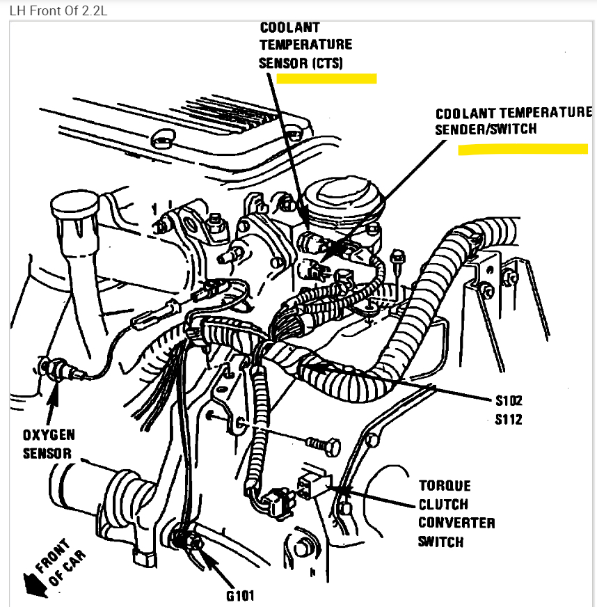

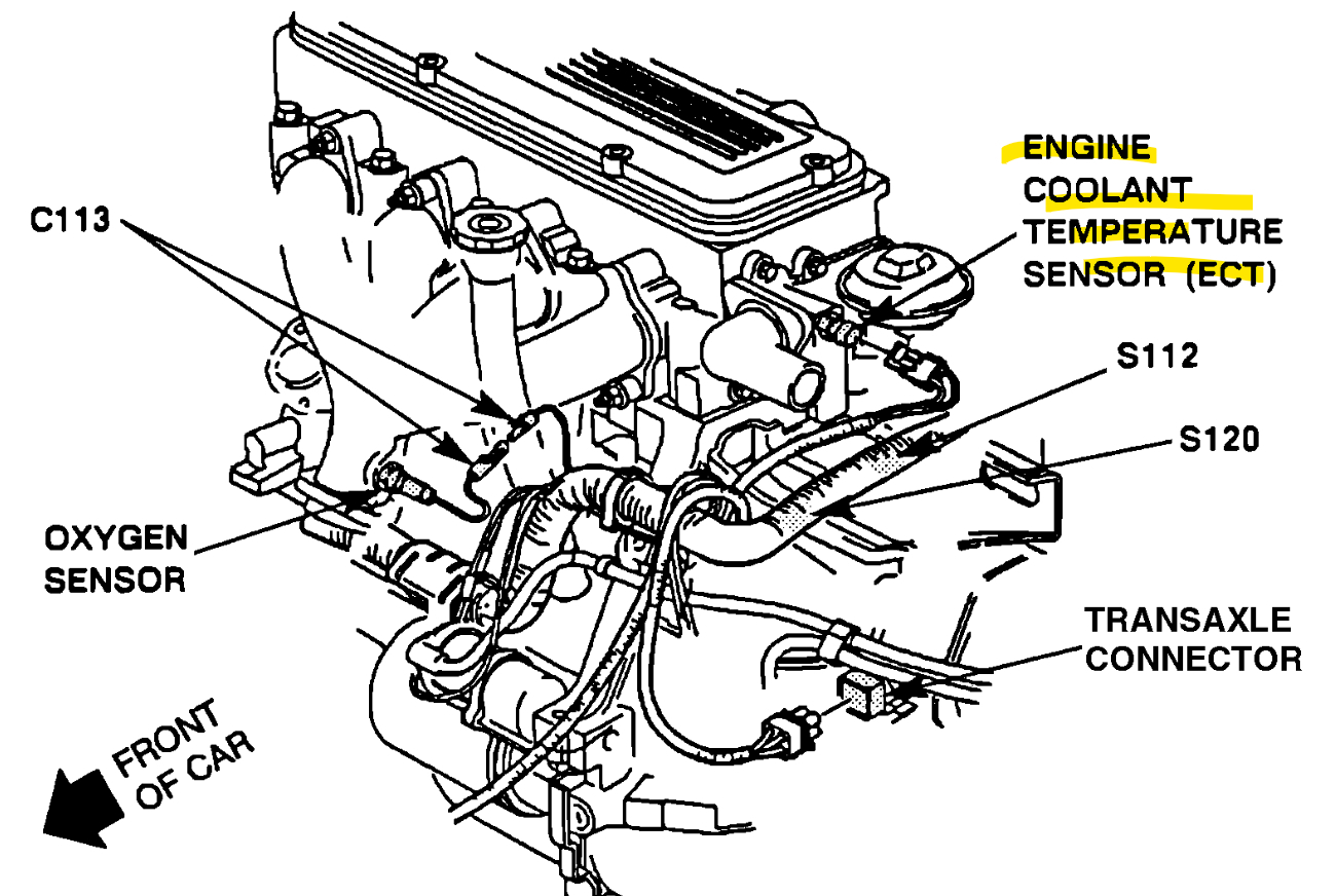

Hello, I see what you mean, going through the wiring diagrams I've found a 2-wire sensor and a 4-wire sensor. I think one is for the computer, and the other type seems to be for the computer and for the gauge with a switch in it as well as a thermistor (sensor). Can you tell me the wire colors for the sensor on your car? The four wire colors on the harness plug. Some will be a solid color with a stripe down the side. I'm trying to find the correct sensor for you. There is either two coolant sensors for different reasons or there are two different designs. You can check the wiring with a multimeter if you'd like. I can walk you through it just to verify the wiring from the computer is okay.

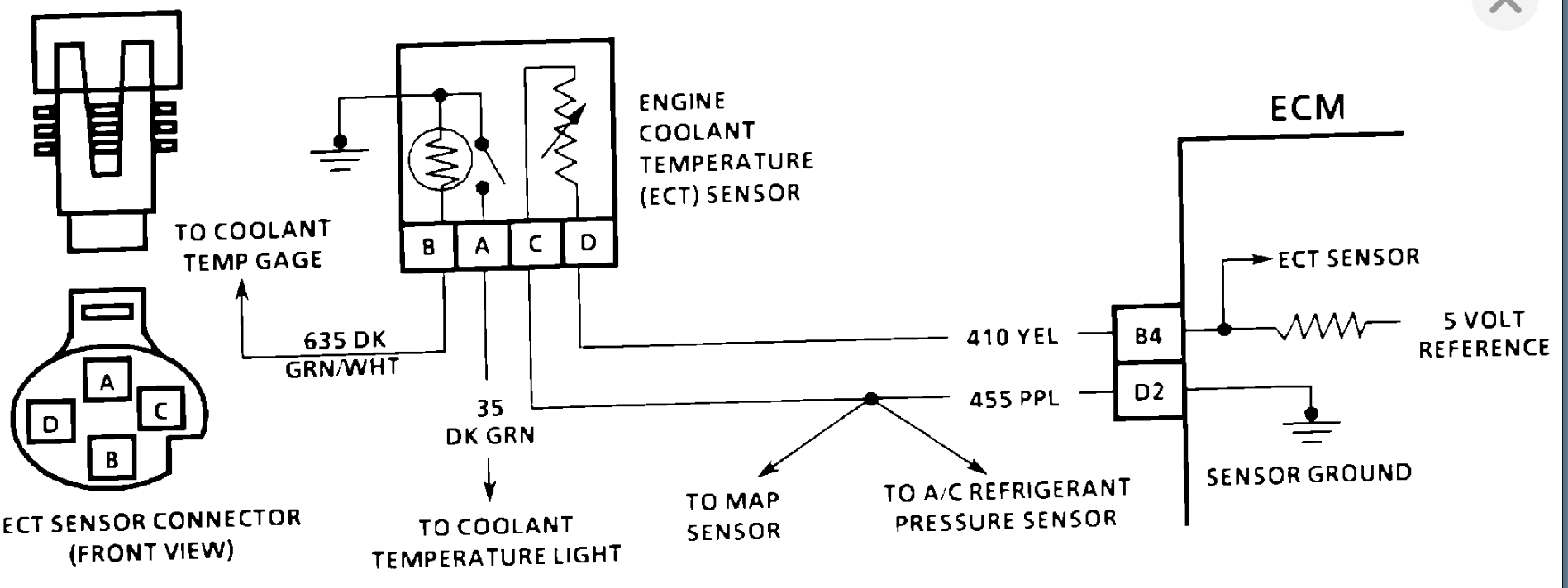

If these 4 wire sensors colors are correct, solid yellow, solid purple, green with white stripe, and solid Dark Green (2nd diagram). Let me know.

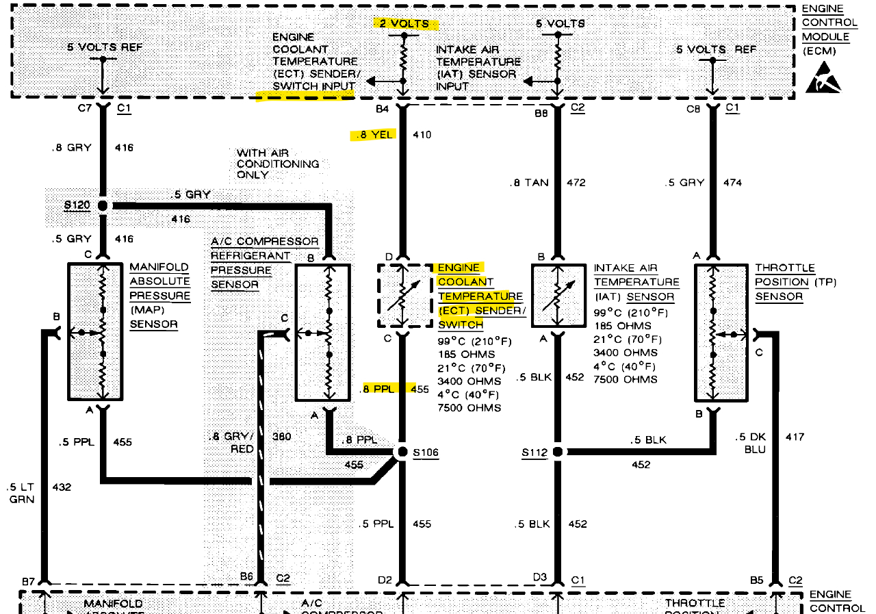

And the third diagram, is that the sensor you are trying to replace?

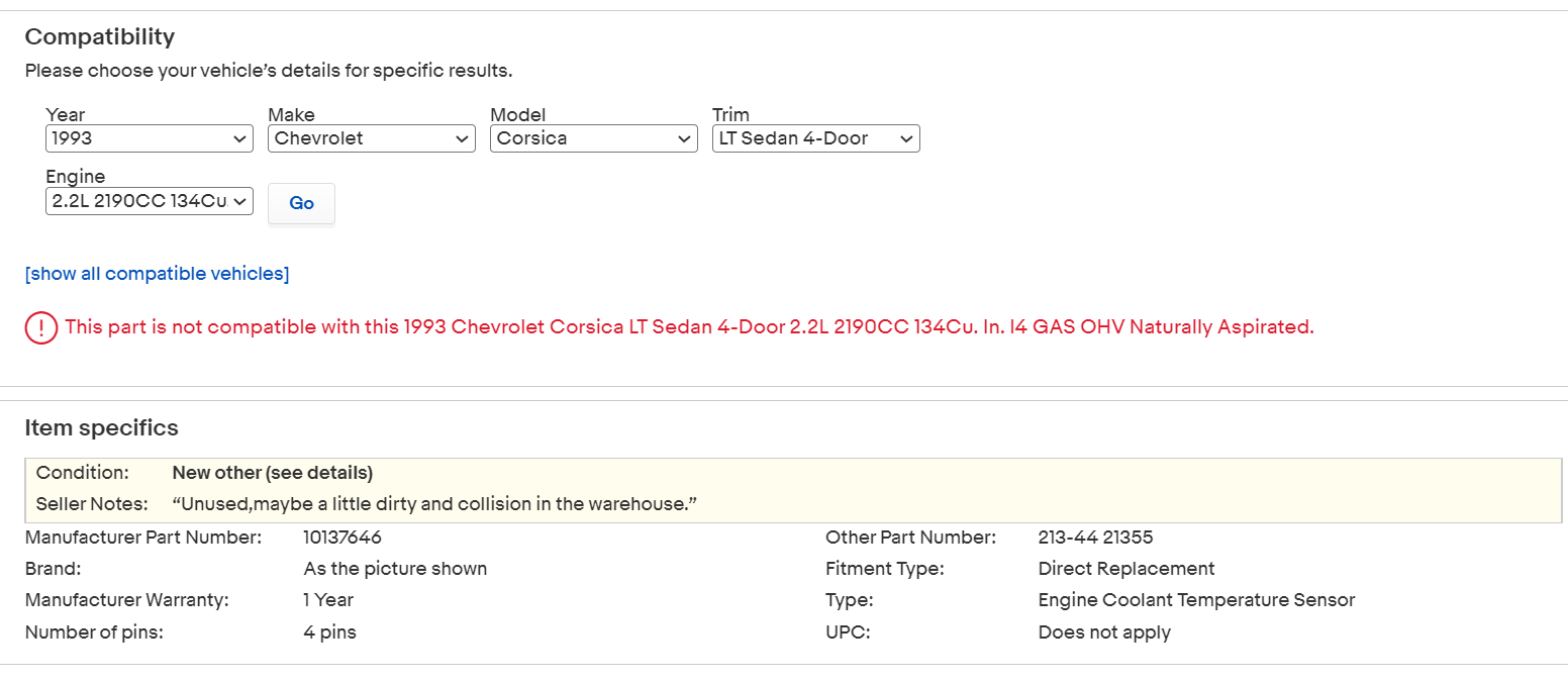

This is the OEM (Chevy) part number for the 4 wire Coolant Sensor/Switch (10137646). It might be something you could try calling a dealership and see if they carry this 4-wire sensor or if they know why there are different sensors listed. I will keep looking though.
This is a link to napa auto parts store. They have a 4-pin coolant sensor for $32.00. This looks like the correct sensor. This one has a switch for the coolant light, as well as a resistor for the gauge and another resistor for the engine computer input. Thats the difference between the 2 or 4 wire sensors. This could be a discrepancy due to where the car was built, the time of year it was built and possibly if the car is California emissions or not. But the link below will take you to the correct sensor, I don't know if you have a Napa near you, but you could order this online if needed.
