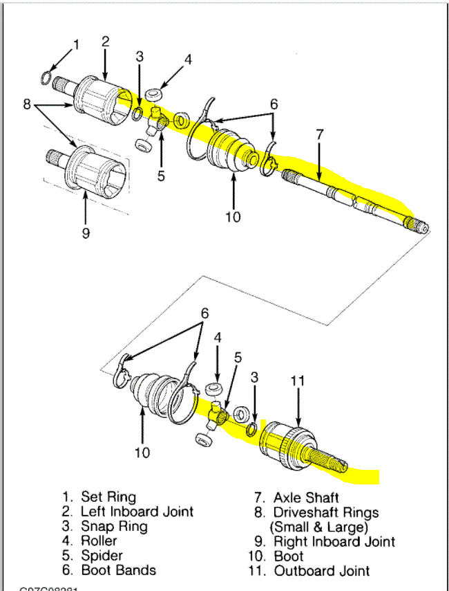

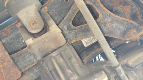

That movement is excessive. I would suspect either you have a few bad splines at one of the hub assemblies or there is an internal gear issue.
Do me a favor. I attached a pic of an axle below. Have a helper shift the gears to cause the clunk while you watch if one of the axles turns without the vehicle moving.
See pic below.
See pic below.

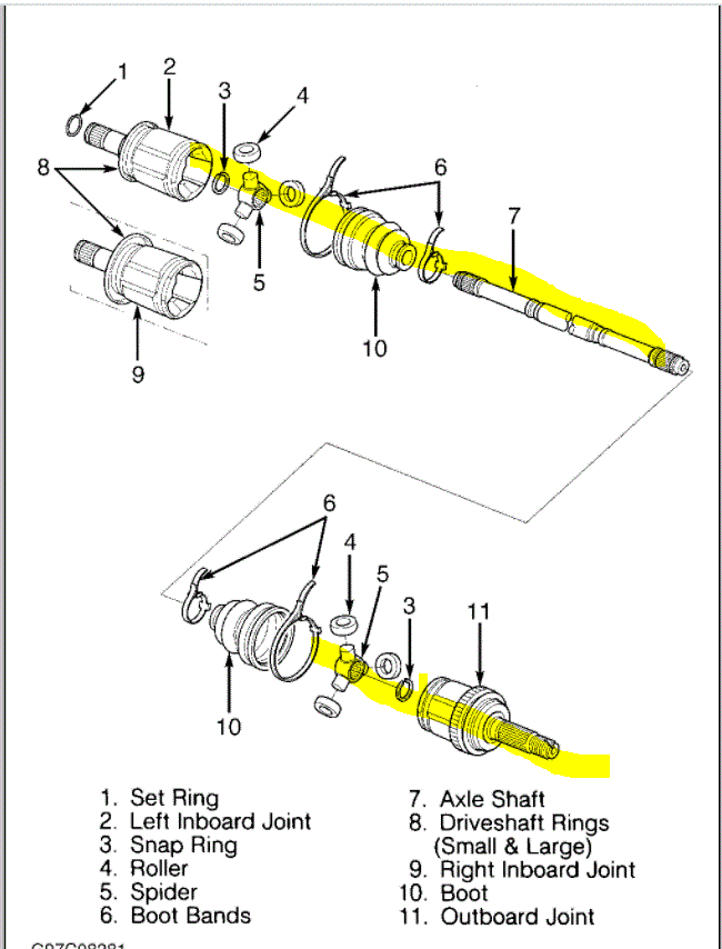

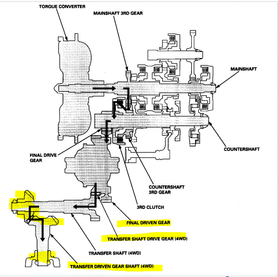

Since it is 4wd, it's likely that turning is placing enough load on it to cause the noise. What I would suggest is to remove the driveshaft and inspect the splines on the yoke and the output shaft at the transfer case.
If the splines are good and there is no evidence of damage, it is likely related to the final drive gear or one of the transfer gears. See pic 1. I highlighted the areas of concern.
Now, when I think about it more, since the video is of the front U-joint (transfer case) and it moves, that would indicate the problem is after that point. Does the same thing happen at the rear differential? I ask because the entire driveshaft is moving. So, the transfer case is causing it to turn approx 90° meaning something after that point has to be doing the same thing. Also, when you make a turn, the rear differential has to accommodate one wheel turning faster than the other. Ugh!!! I have a headache. LOL
Sorry for jumping around like that. The second thought just popped into my head and I felt it was important to ask.

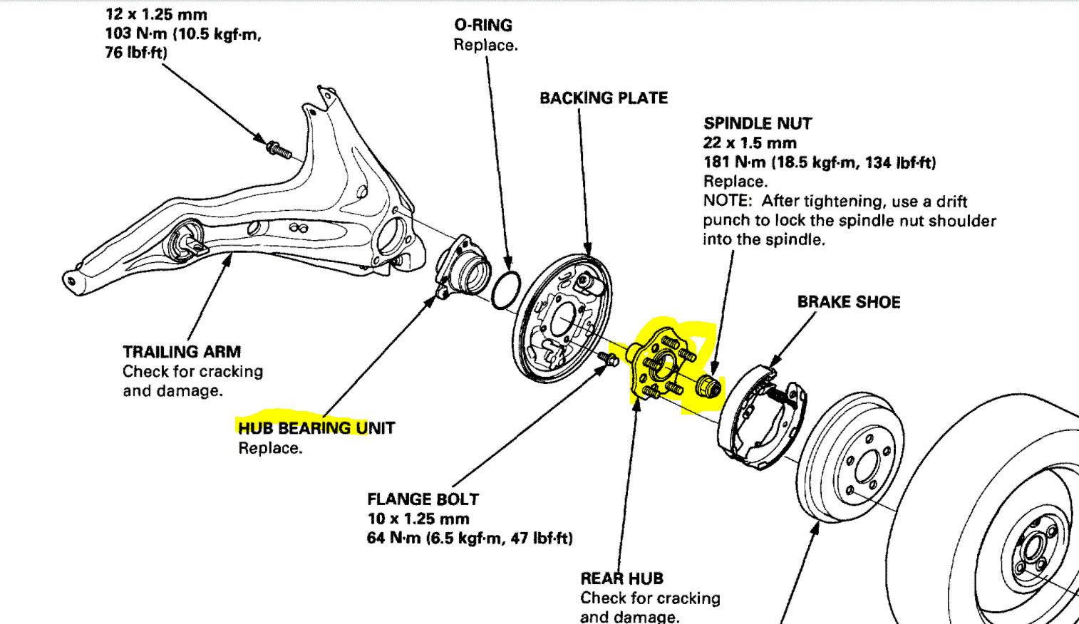

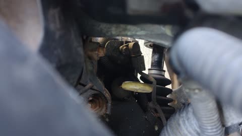

If you lift the tire off the ground, is there play in the hub bearing? If there is and it's bad enough, the splines may be slipping. I realize that's a long shot, but anything is possible. Make sure the spindle nut is tight and the hub bearing isn't moving around. See pic below.

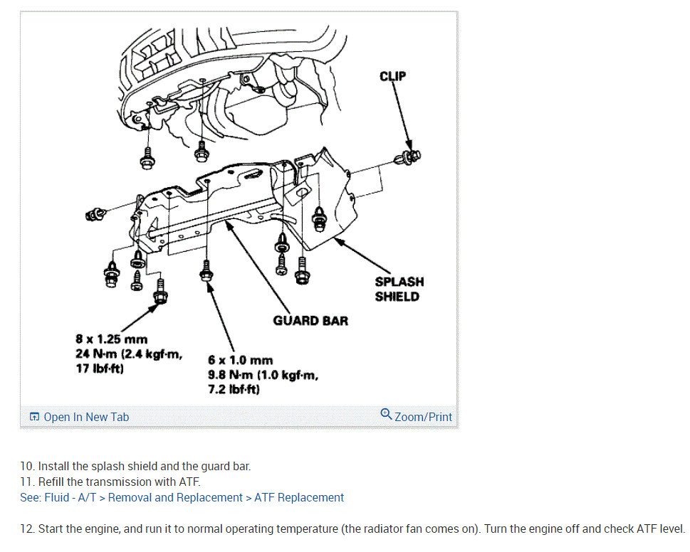

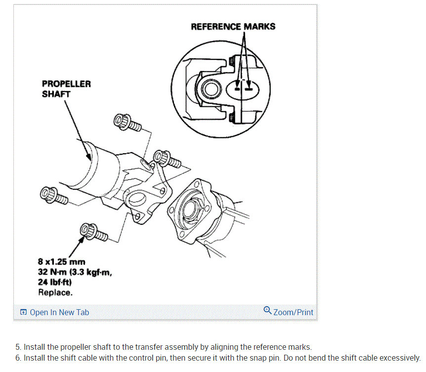

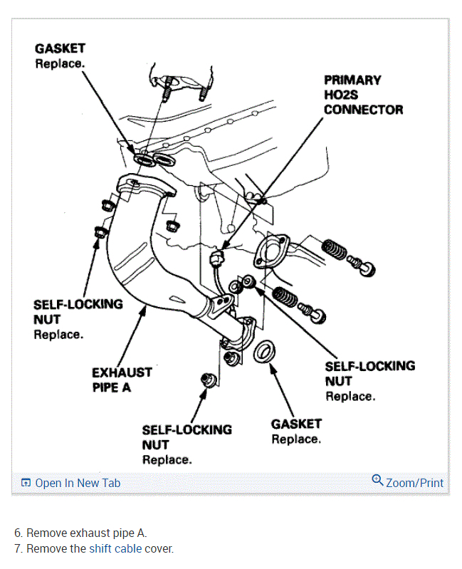

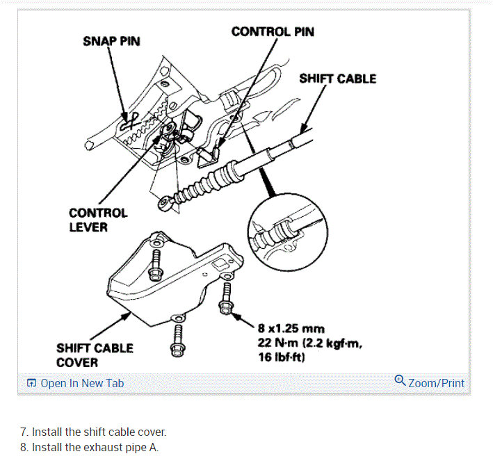

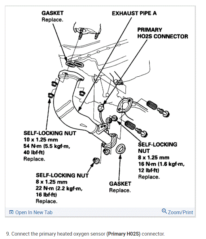

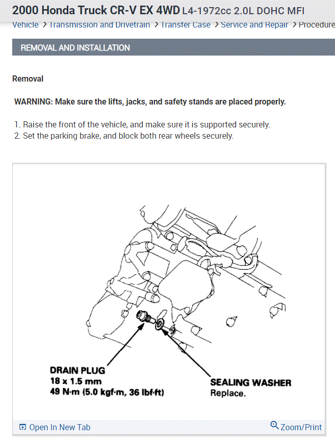

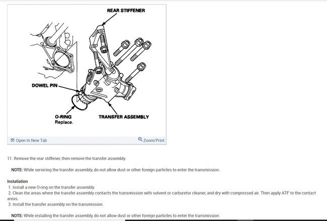

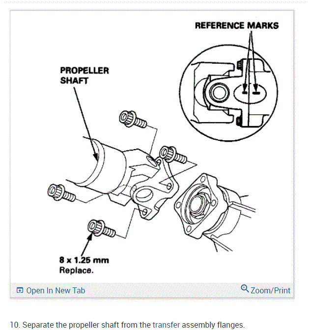

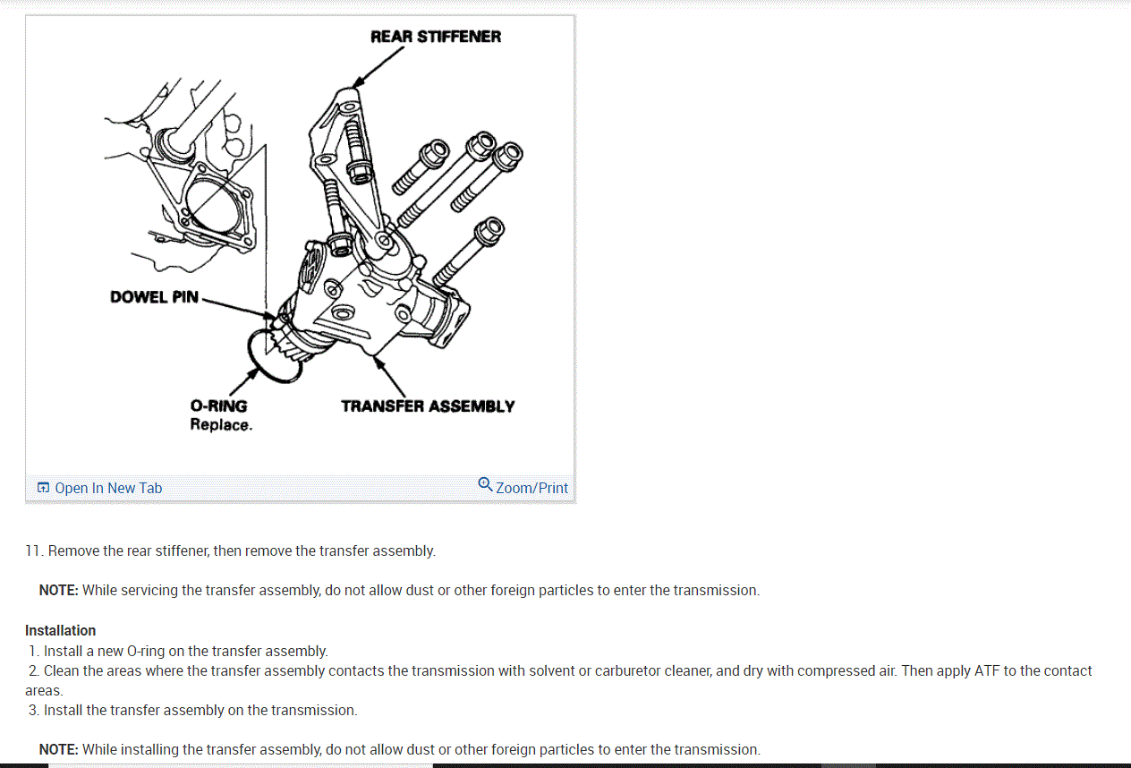

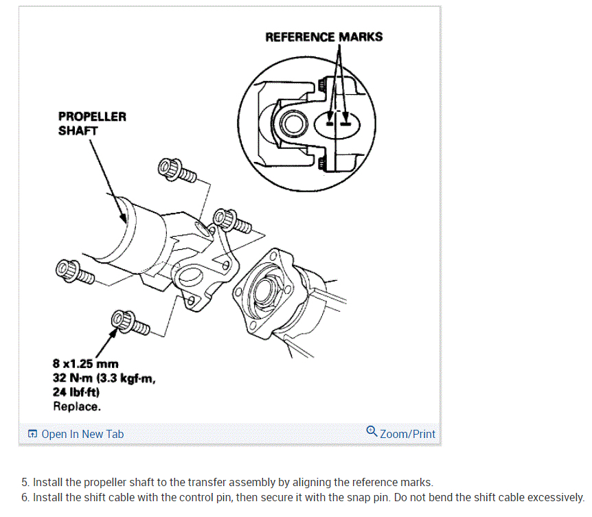

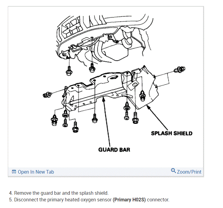

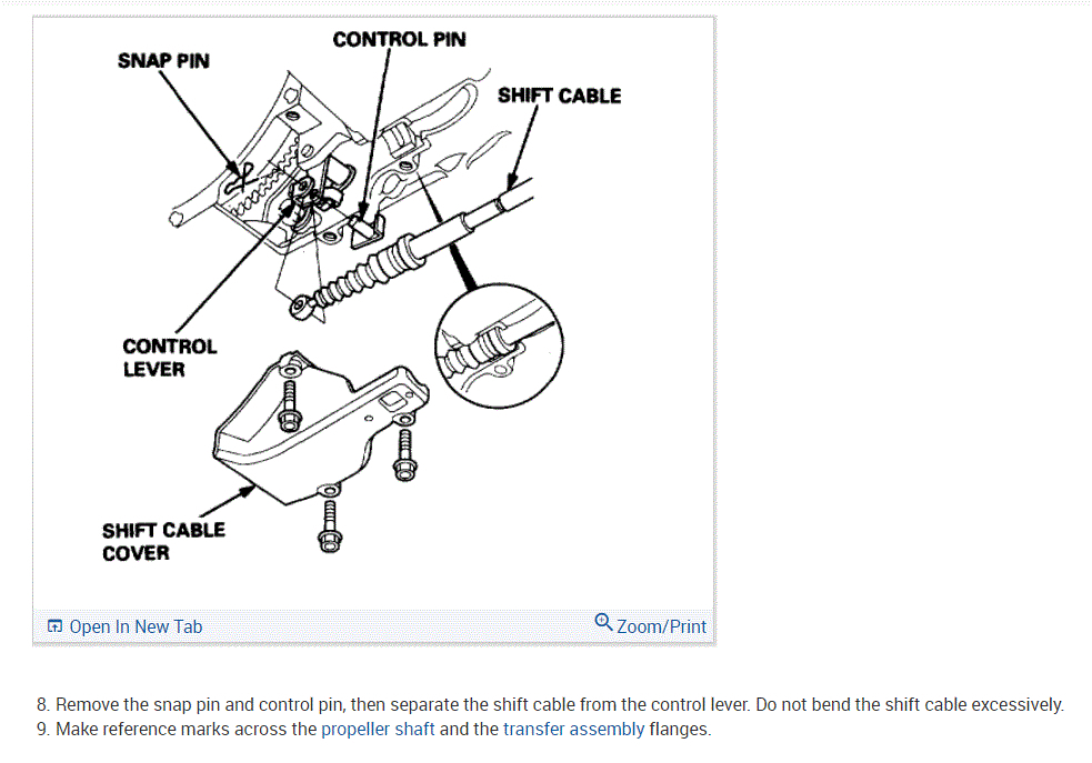

Hello, I haven't had a chance to recheck car. I'm going to check transfer case, rear differential. Questions though, can I drive car if I disconnect drive shaft and just push it to the side? I forget if I have to drain transmission fluid before pulling transfer case. Can you send me the schematics for the rear differential, transfer case and front differential? I have a feeling that that rear differential is bad but I still want to check everything else out. I think that since the back passenger tire was still had 20% tread then in a few weeks its was almost bold especially inner and outer part of tire. I want to check transfer case since the clunking sounds like it's coming from that area.
Jun 7, 2021 at 5:03 AM

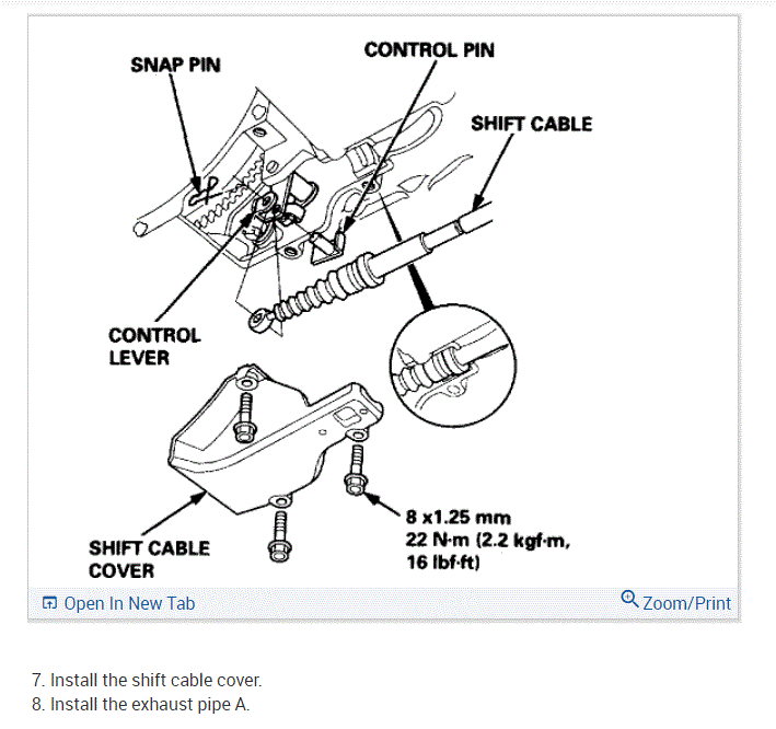

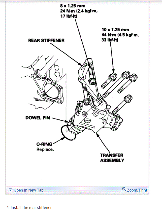

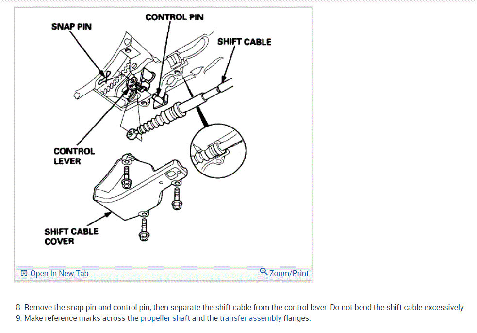

I will be happy to send it if I have it. Tell me, are you looking for an exploded view of the components? When you said schematic, I'm picturing wiring. LOL
I attached the directions below for removing the transfer case. And, yep you need to drain the transmission first.
I hope they help.
Let me know,
See pics below.
I hope they help.
Let me know,
See pics below.
