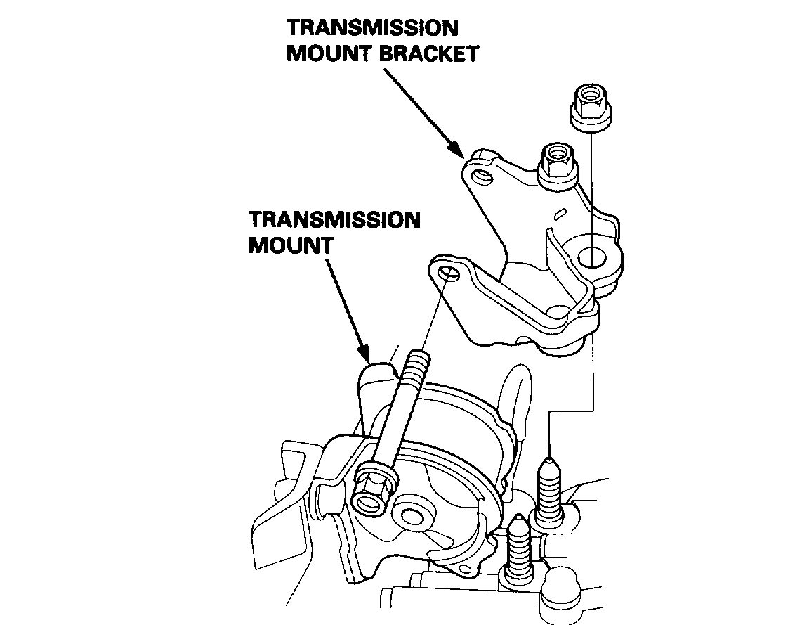

Is it loud enough for you to record and upload for me to hear? Also, have you checked the engine and trans mounts? You could have one broken.
https://www.2carpros.com/articles/how-a-motor-mount-works
https://www.2carpros.com/articles/vibration-noise
Let me know if what you are experiencing seems to mirror what is in the links above. If you can, open the hood. Have a helper shift through the gears while you watch for excessive movement in the motor when shifting.
Try that and let me know what you find.

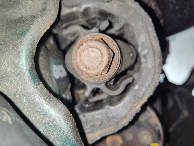

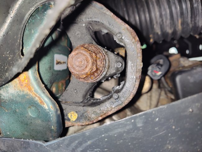

Lower Front left engine side this one has gone for years.
Apr 15, 2021 at 6:23 AM
GENESIS88
  • 140 POSTS
Sorry got it backwards facing car this photo is lower left transmission side other photo is lower right engine side.

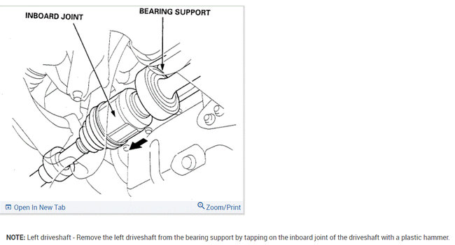

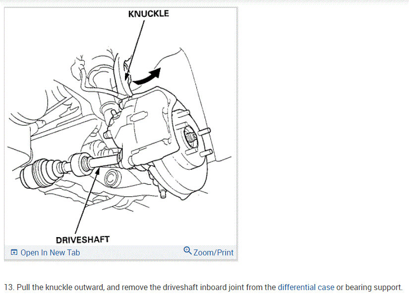

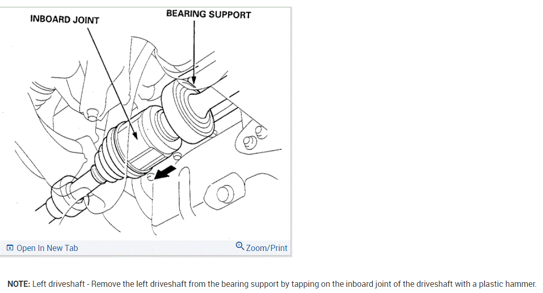

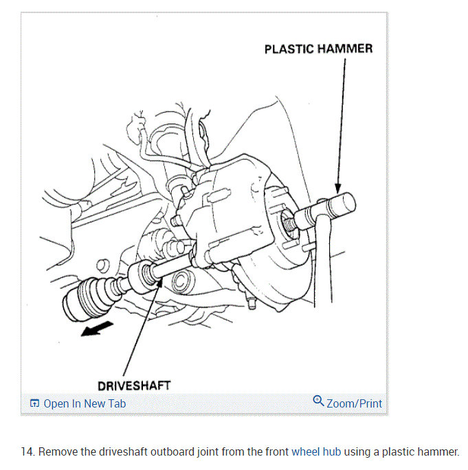

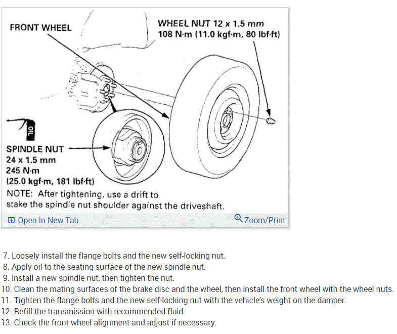

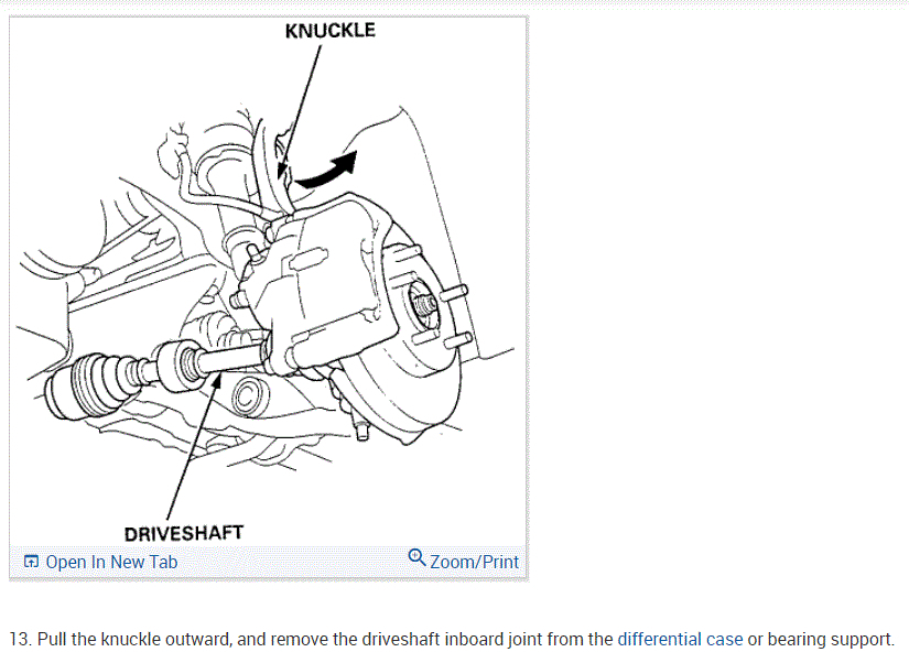

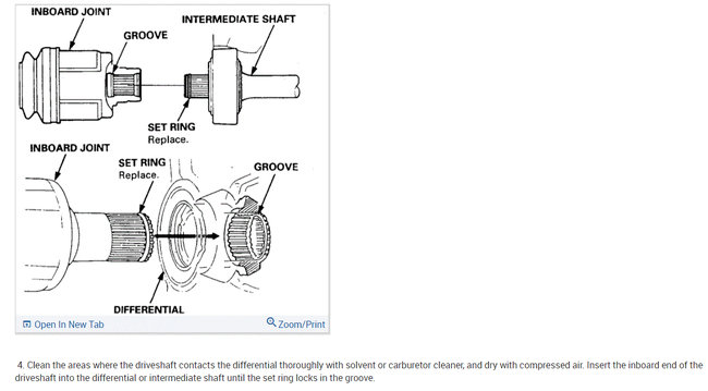

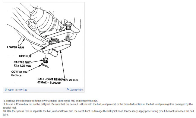

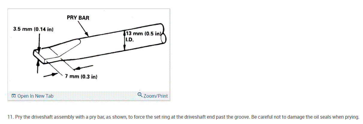

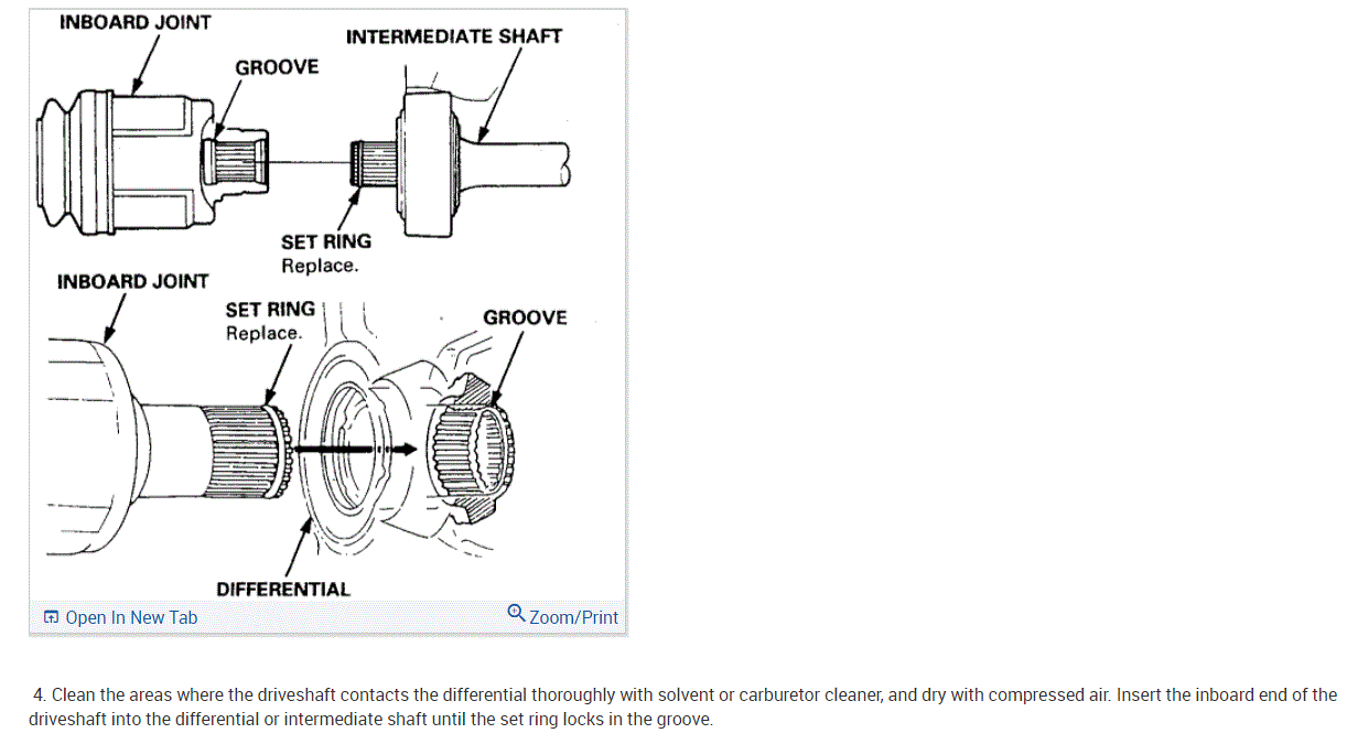

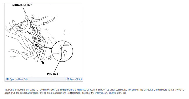

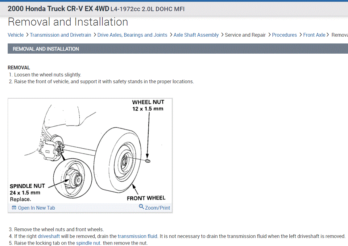

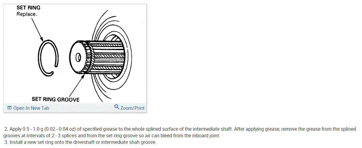

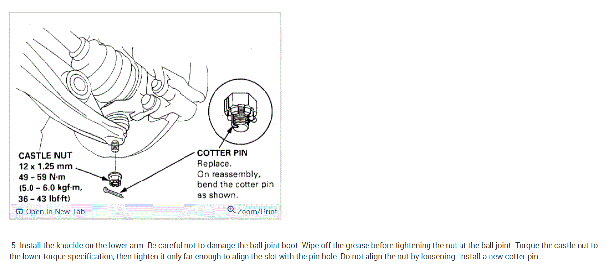

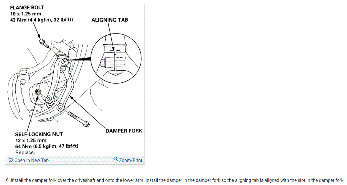

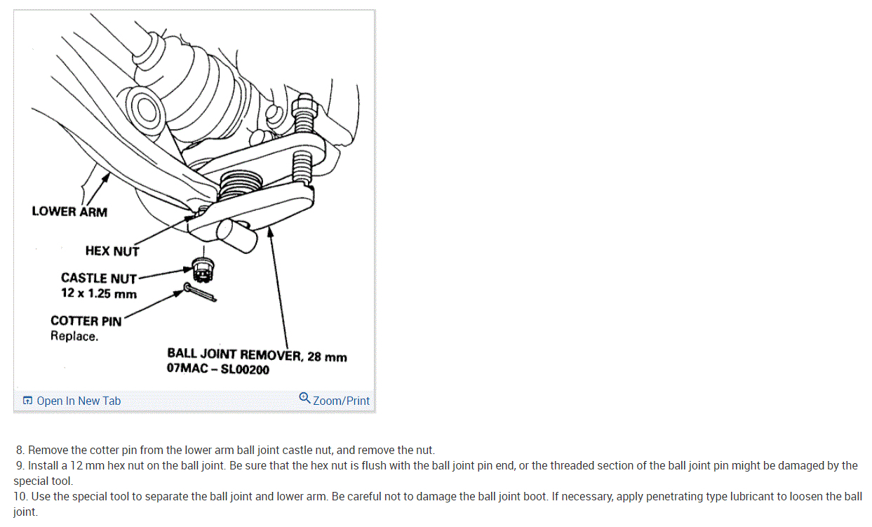

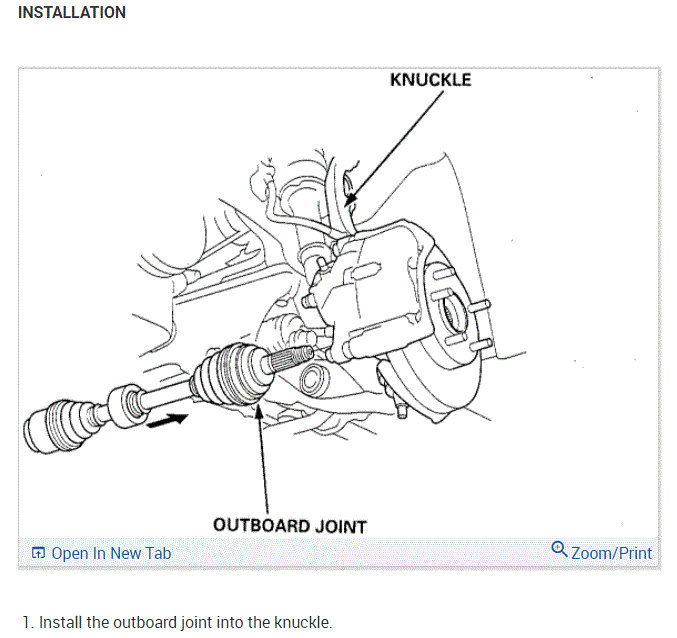

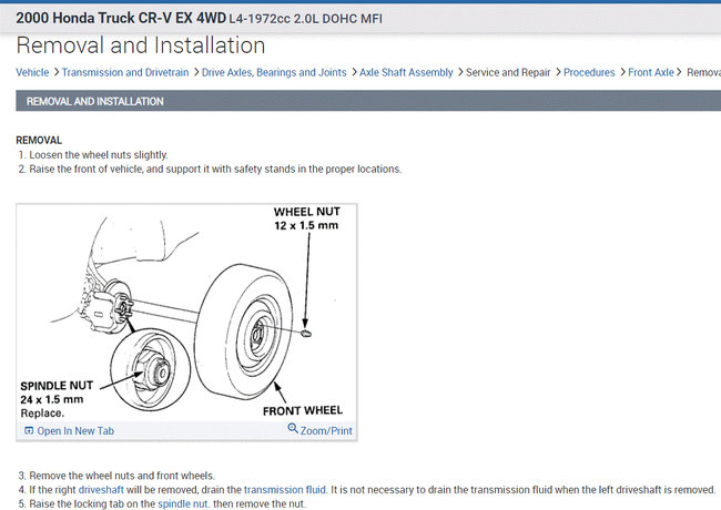

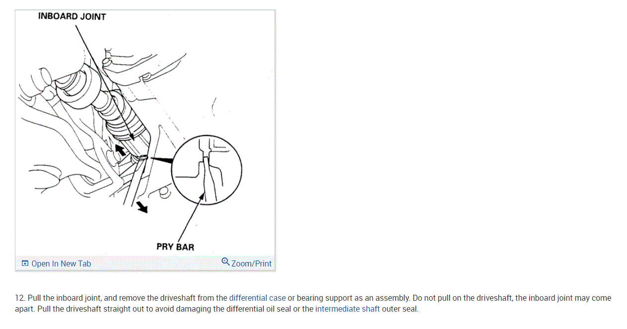

I watched the video. It really seems like you have a bad CV joint causing it to jump like that. I realize you replaced the left one, but have you inspected the right one? Also, are the splines on the axle fully seated?
That is what I would be checking. If you find the axle/CV joint is the issue, here is a link that shows in general how it is done:
https://www.2carpros.com/articles/replace-cv-axle
If you look at the attachments below, they include the directions and pics specific to your vehicle for replacement.
See pics below.

I can't find a replacement set ring for intermediate shaft. I am not sure what size or what else I can use.
Apr 16, 2021 at 6:02 AM

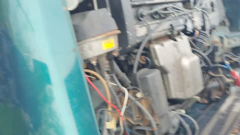

When I shift you will hear minor knock and see slight movement with engine. Right as I start to turn wheel you will see engine lift forward. Oil pan is in front of inner joint.

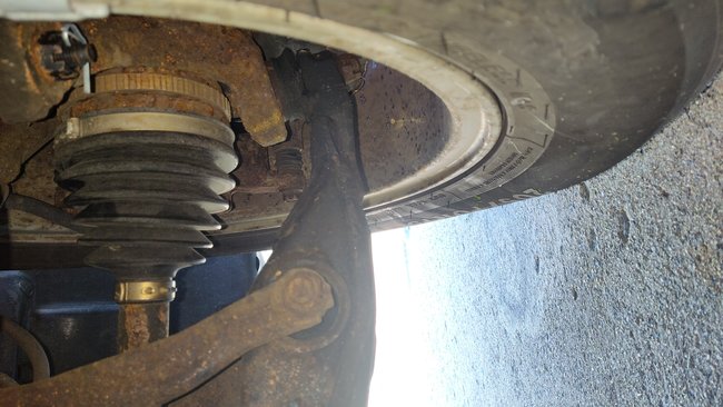

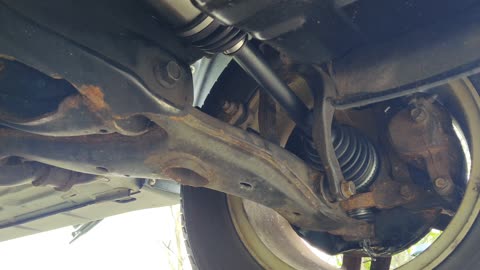

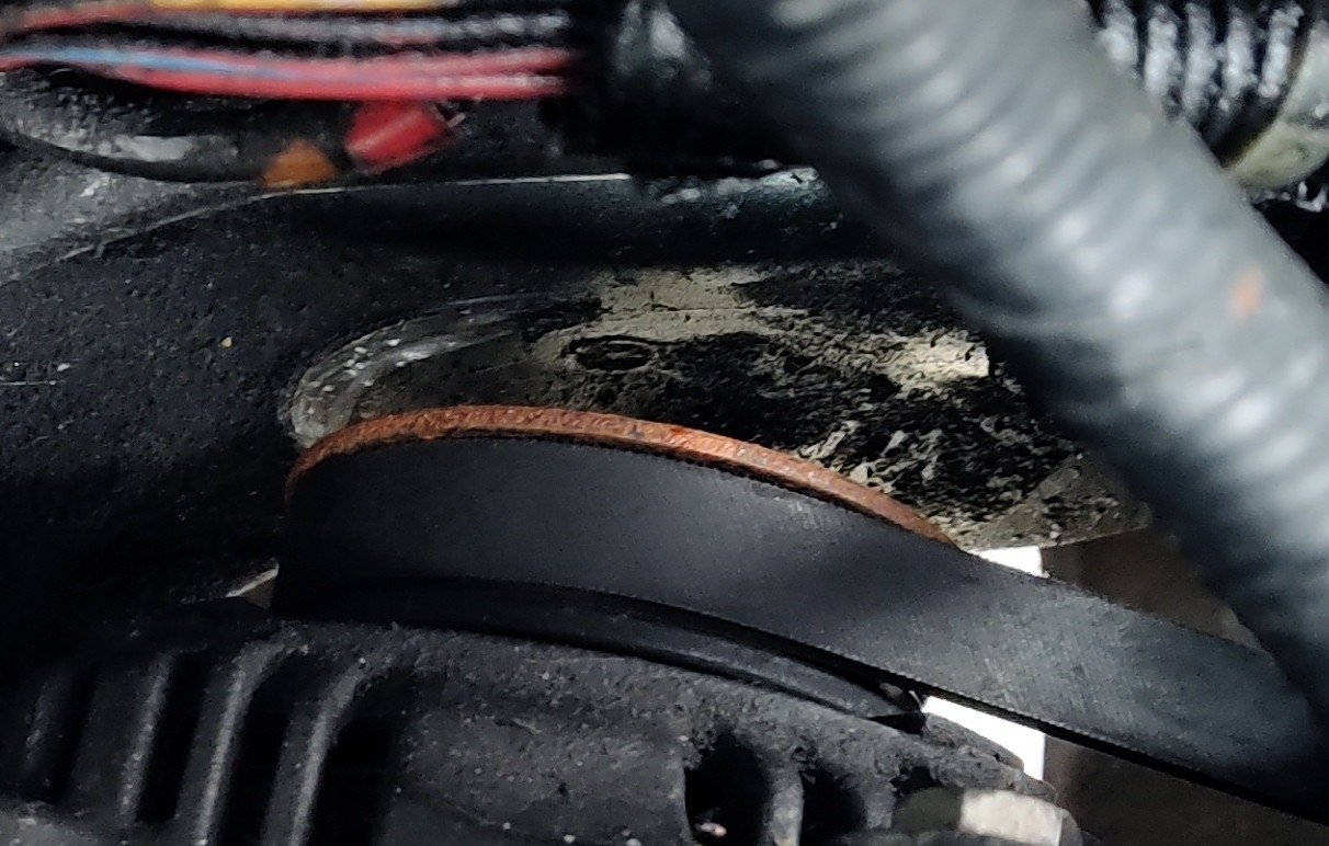

Alternator is hitting . The video I sent you see the engine lifting when turning wheel. I redid CV and it still clunks but not as loud or as much.
Apr 16, 2021 at 2:07 PM

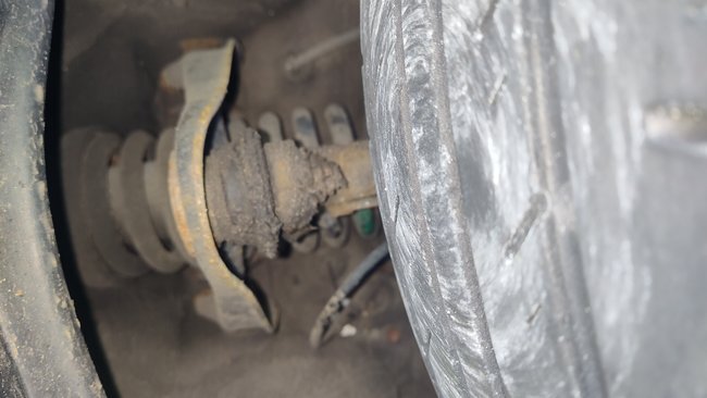

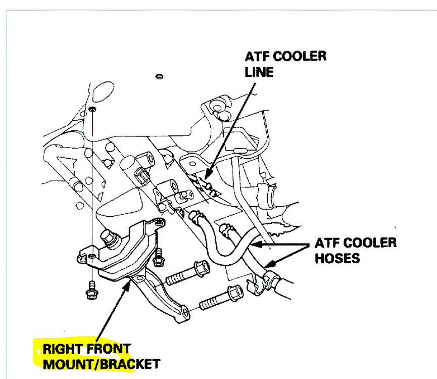

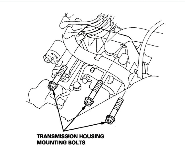

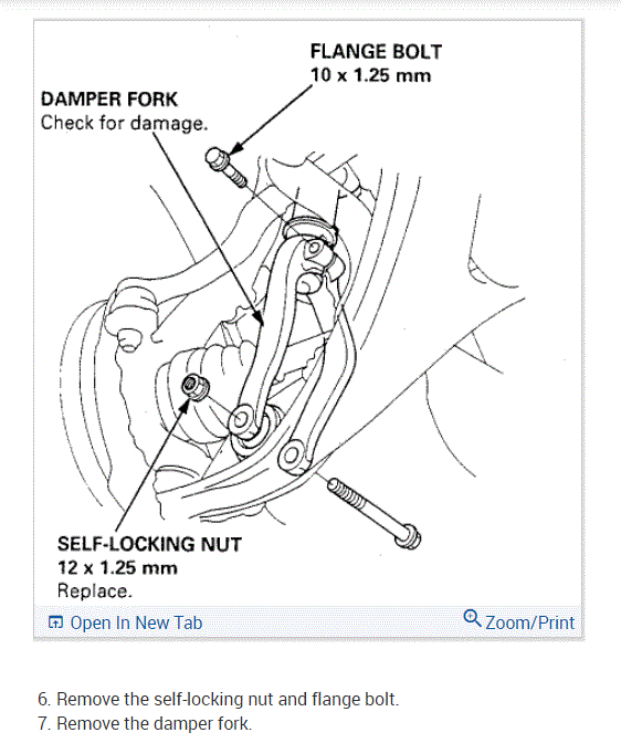

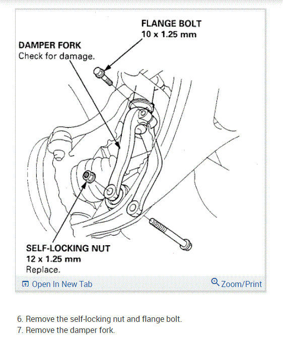

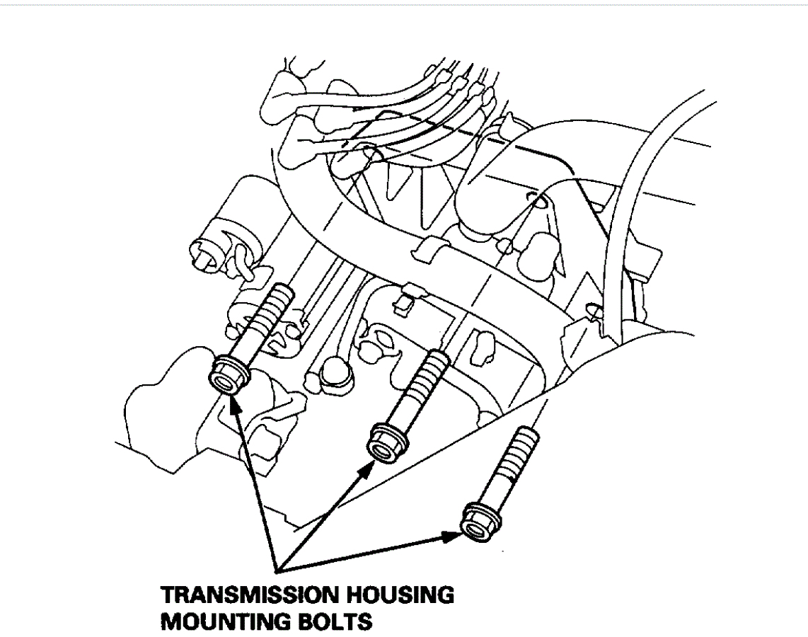

The entire engine/transmission has to be moving for the alt to hit and it looks like the axle is hitting or nearly hitting the control arm.
Take a look at the pics below. Check these things and let me know if you find anything broken, missing bolts, or loose.
As far as the set ring, that may be a hard find. Have you tried the dealership? Did you lose the original one?

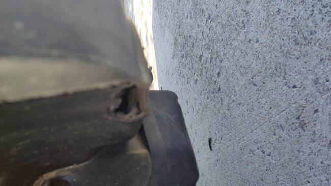

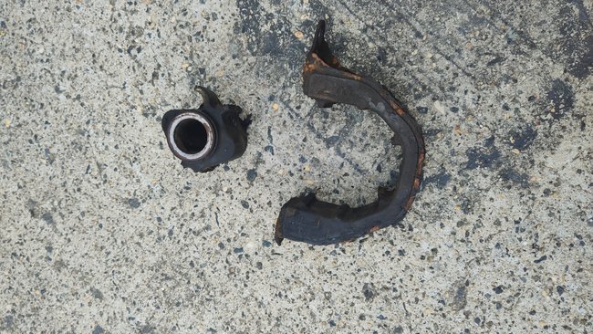

this motor mount is no good. This is how it came out. When I was taking this mount off I was able to move the engine back and forth With very very little force.
Apr 17, 2021 at 9:31 AM
GENESIS88
  • 140 POSTS
I forgot to mention I haven't look closely at the others. I do know the lower left engine side is gone. The lower right trans side is cracked through.

So I think it's fixed. I installed lower front engine mount. I also found upper mount wasn't fully tighten. I did timing belt couple months ago and forget to torque them to spec. I tested car in driveway to neighbor driveway going forward and reverse and turning wheel fully both way with no noise. Once I fix my alignment I can do a real test drive. So it looks like the lower front transmission mount cracked all the way, since the lower engine mount was gone engine dropped slightly and caused a lot of movement. In turn it caused cv to bind and make a lot of noise. The original CV axle was bad. The first 2 replacement where defective. So it looks to be a whole mess of things going wrong in a row. Also me making a mistake and not double checking my work. Now I don't know for sure, but this was the first time it make zero noise when testing in driveway to neighbor drive forward/ reverse and turning wheel both ways fully and stomping gas and then brakes.. I should know in a few days when I do a at home alignment if it's truly fixed. Also the rest of the motor mounts are in good condition. Only the 2 front lower where bad and the 2 nuts on top engine mount loose.
Apr 17, 2021 at 6:33 PM
I think you have found the problems. I don't think I've ever seen a mount as bad as the one you attached. The engine and transmission are moving all over the place.
As far as the one on the trans side, replace it and any other ones that are bad. Let me know if you need help with anything. If you have a chance, let me know the outcome.
