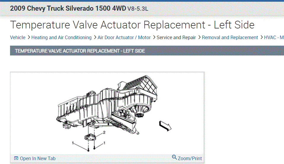

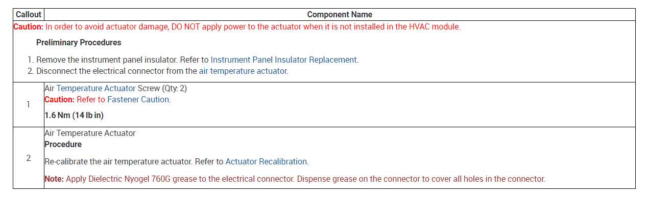

Take a look at the first two pics below. They are the directions for replacement. I'm adding them so you can confirm nothing was missed.

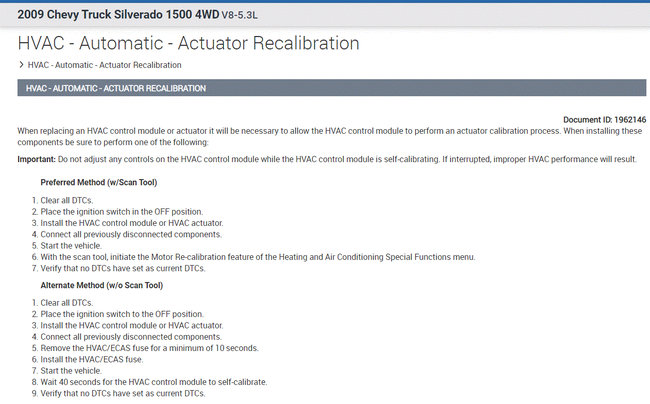

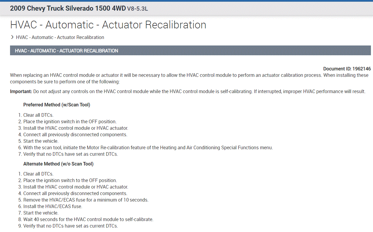

Pic 3 below is the recalibration directions.
Try that and let me know if it helps.

Yes I have recalibrated every way the internet provides and it still blows hot
