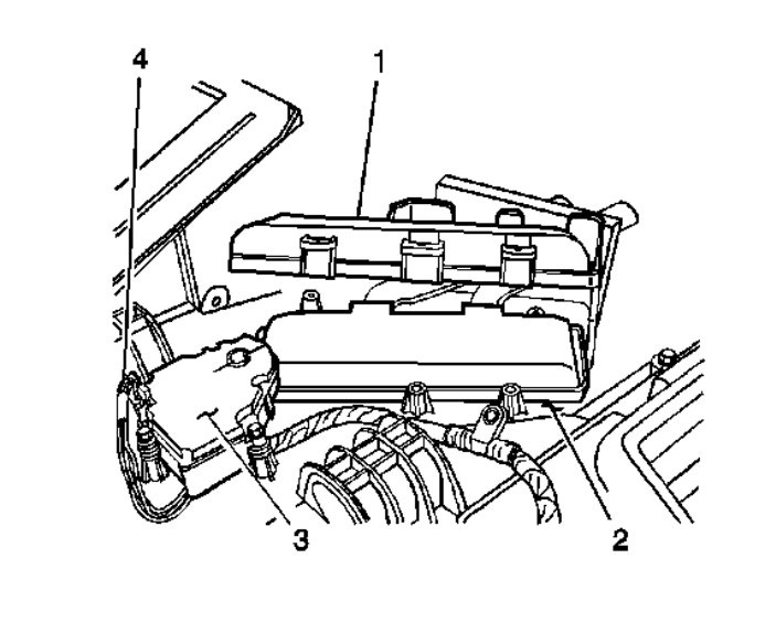

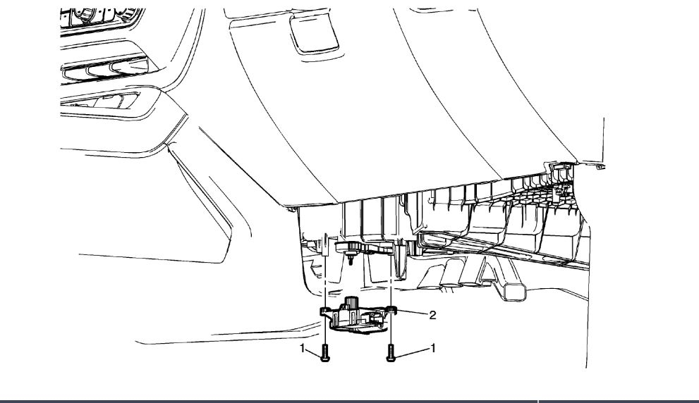

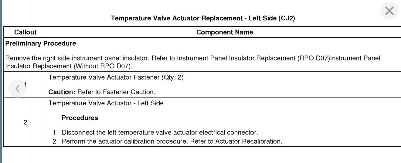

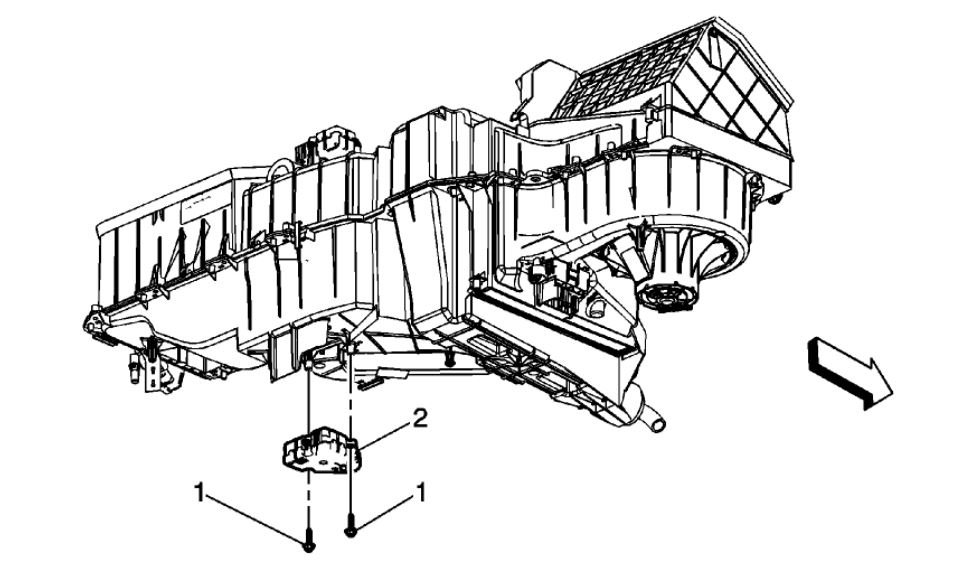

Welcome back:
According to Alldata, with automatic climate control, the left side actuator is located just to the left of the glove box. The directions provide are in pics 2 and 3. In pic 1, I highlighted what I am seeing.
________________________________

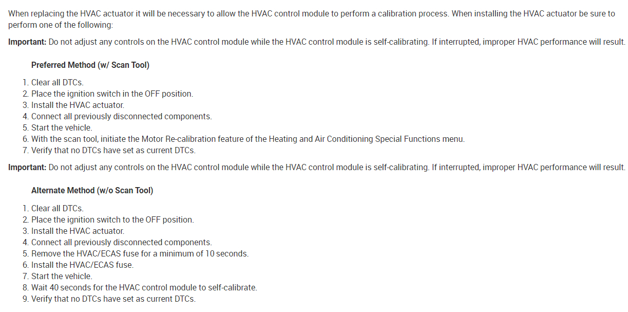

The last thing in in pic 3 indicates calibration. I looked up the process for you and found this for doing it without a scanner.
Alternate Method (without Scan Tool)
Note: Do not adjust any controls on the HVAC control module while the HVAC control module is self-calibrating. If interrupted, improper HVAC performance will result.
1. Clear all DTCs.
2. Place the ignition switch to the OFF position.
3. Install the HVAC actuator.
4. Connect all previously disconnected components.
5. Remove the HVAC control module fuse for a minimum of 10 s.
6. Install the HVAC control module fuse.
7. Start the vehicle.
8. Wait 40 s for the HVAC control module to self-calibrate.
9. Operate system and verify that no DTCs have set as current DTCs.

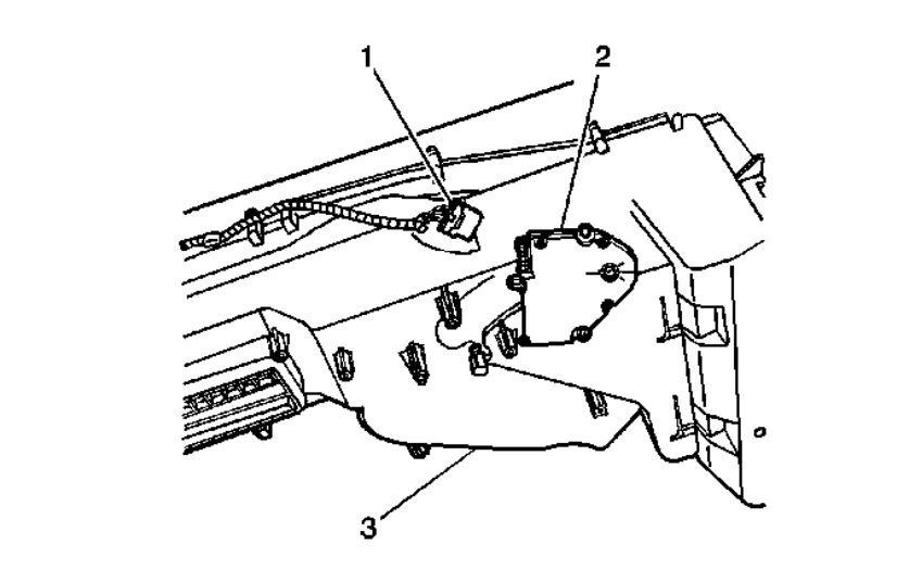

Good evening,
I attached a picture of the actuator and the procedure for you to follow with diagrams below .
Check out the diagrams (Below). Please let us know what happens.

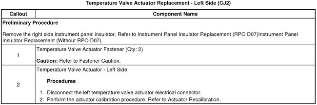

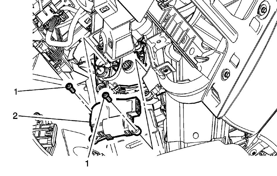

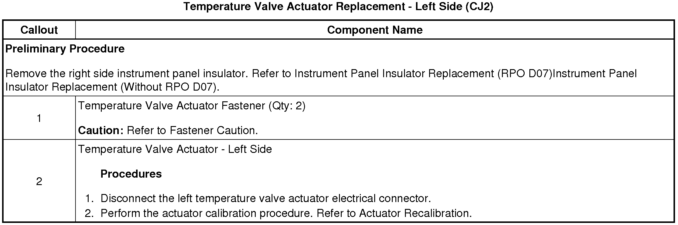

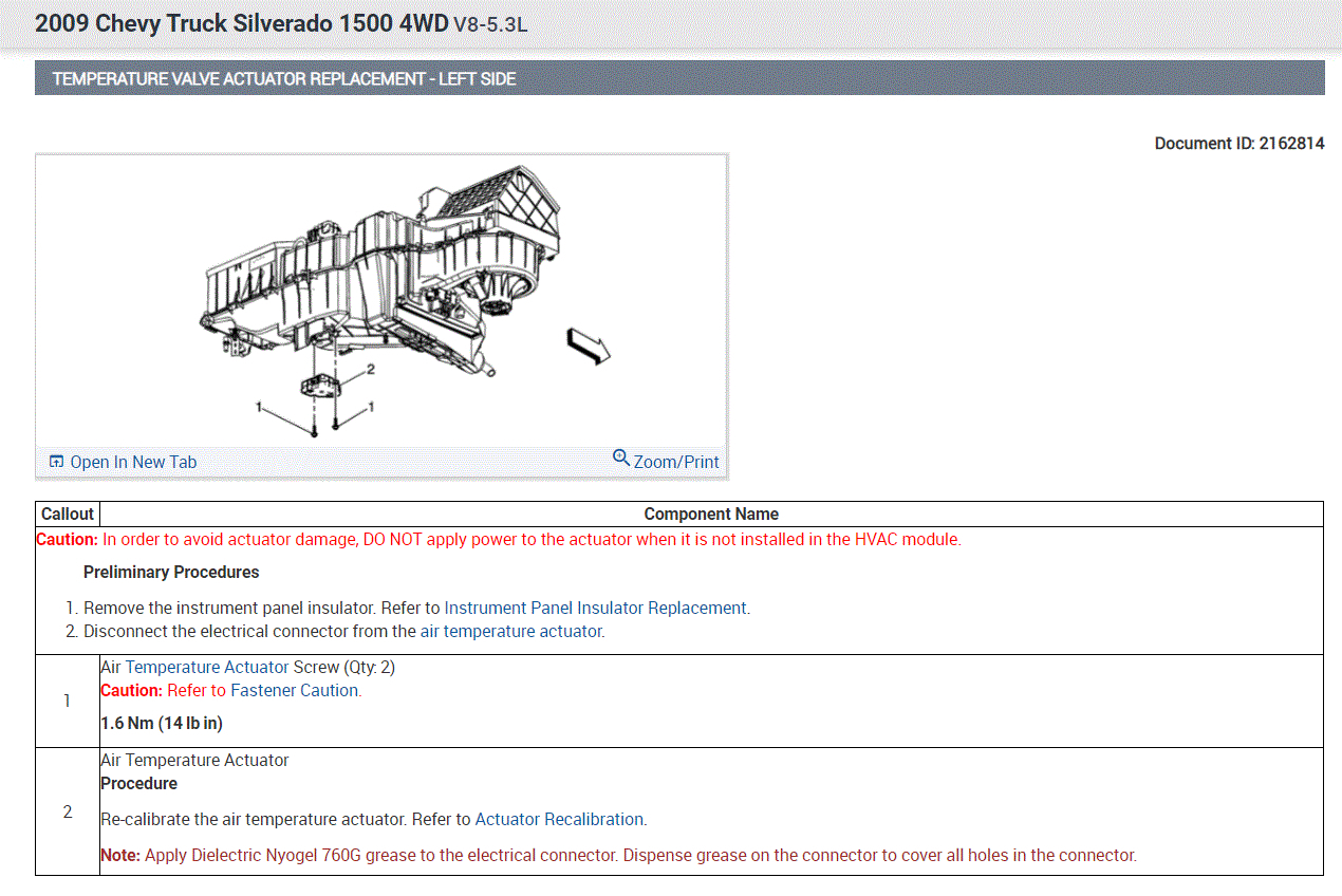

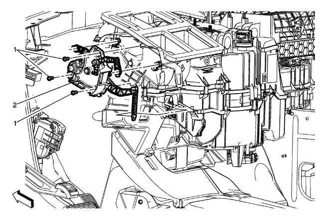

Welcome to 2CarPros.
I attached directions for replacement of the actuator specific to the left side. The attached pictures correlate with the directions. First, here is a link that explains the process in general:
Here are the specifics:
TEMPERATURE VALVE ACTUATOR REPLACEMENT - LEFT SIDE (CJ2)
Temperature Valve Actuator Replacement - Left Side (CJ2)
pic 1
pic 2
Let me know if this helps.

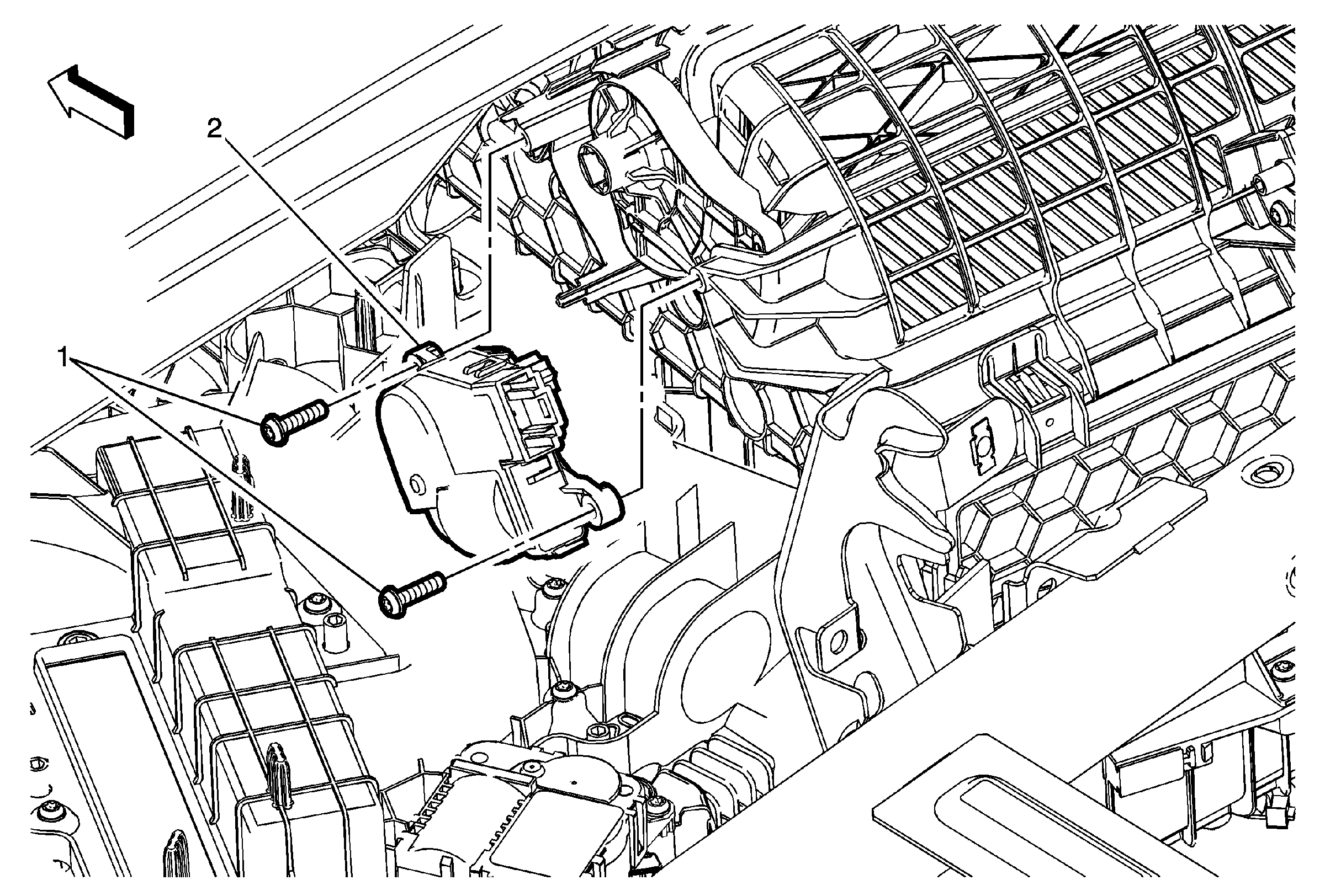

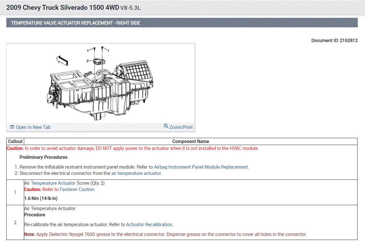

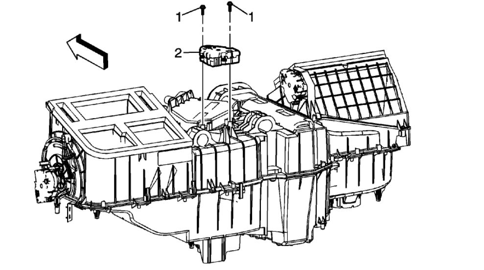

Okay, there are four actuators. the one you need is on top of the heater case. I attached a picture for you to view. To access it you need to remove the passenger side airbag. it will be visible when that is removed. Make sure you disconnect the battery before this repair.
Apr 30, 2021 at 11:46 AM (Merged)

The drivers side is an easy replacement. I sent you the procedure for the passenger side. Sorry about that.
Nothing to remove but the cover under the left side of the dash. That is held by a couple of screws. the blend door actuator is right there. the correct picture attached.

1. Does not apply to you.
2. Correct that is for the right side, not the left.

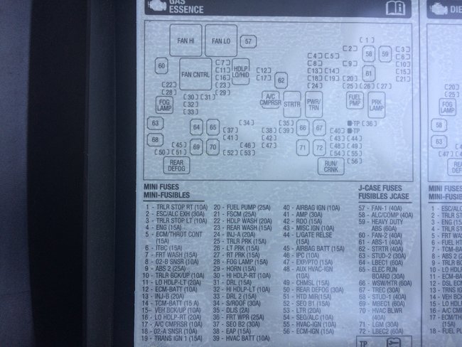

After I get it in, do I need to perform a re-calibration? If so, in the steps that you provided way up top, I do not have a HVAC/ECAS fuse. See attached.
Thanks a million again,
Gary
Yes, the calibration.
Fuse 39 as marked AC.

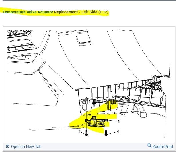

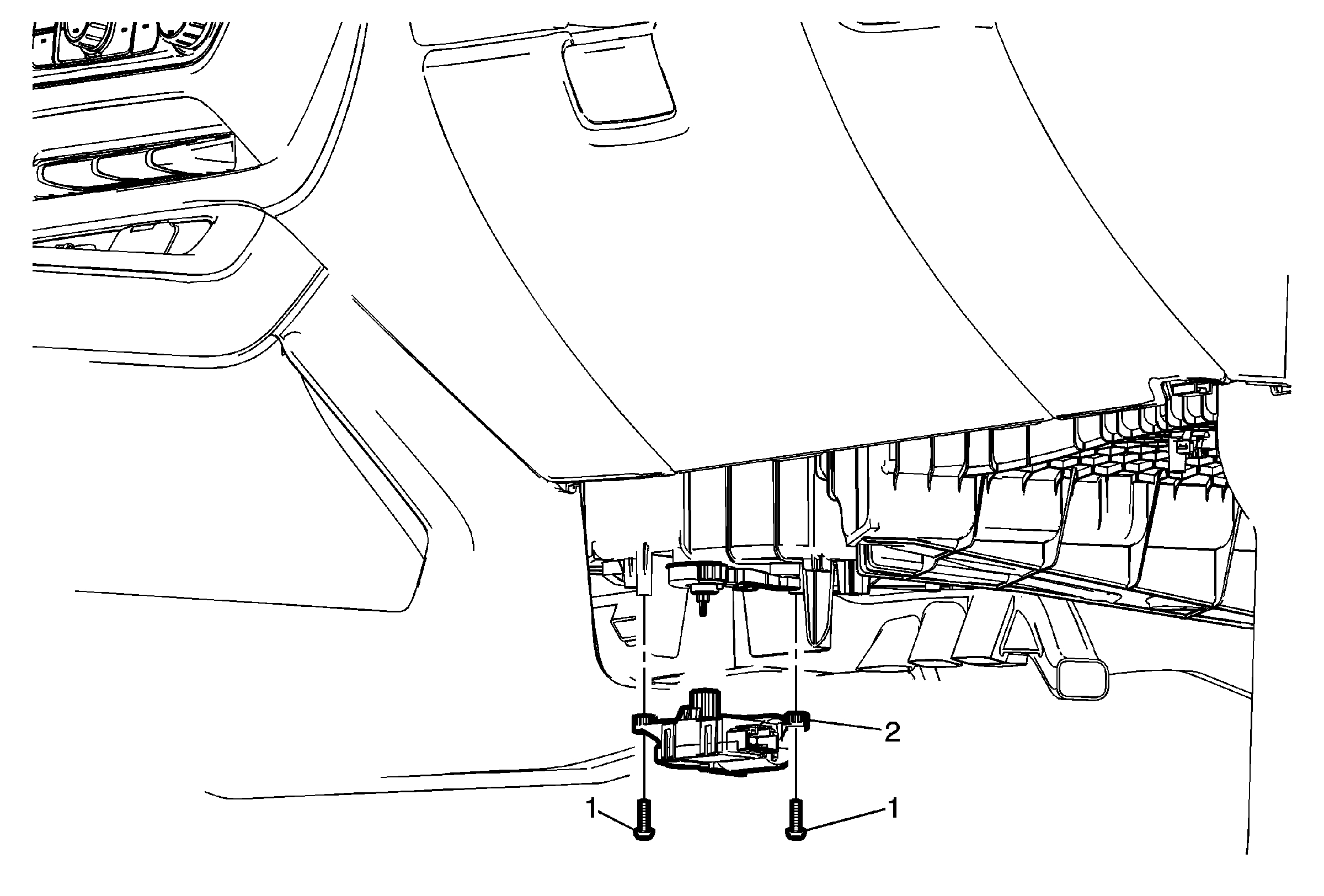

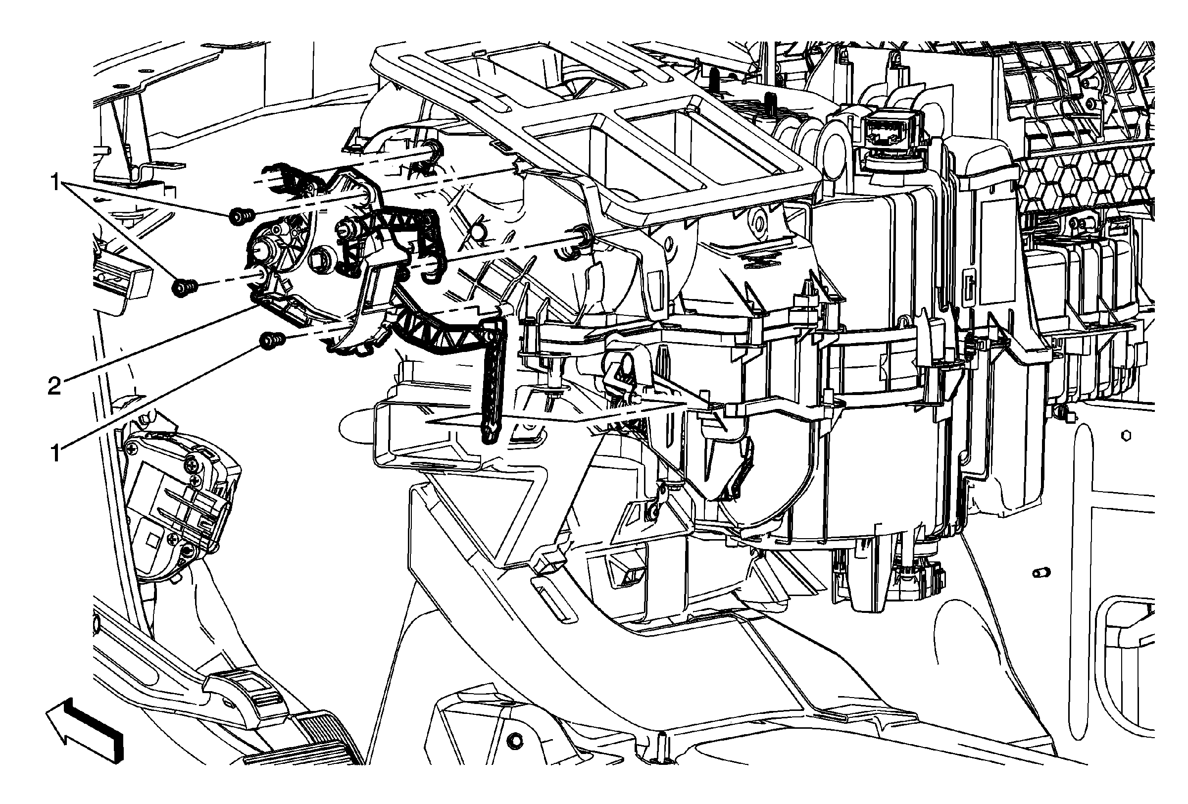

It will be located under the dash on the HVAC box. It's actually easy to replace.
To get you started, here is a link that shows in general how it is done. You can use this to help guide you.
If you look at the picture attached below, it shows the directions/picture specific to your vehicle for replacement.
I hope this helps. Let me know if you have other questions.
See pic below.
Apr 30, 2021 at 11:47 AM (Merged)

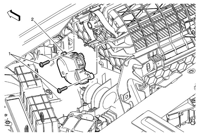

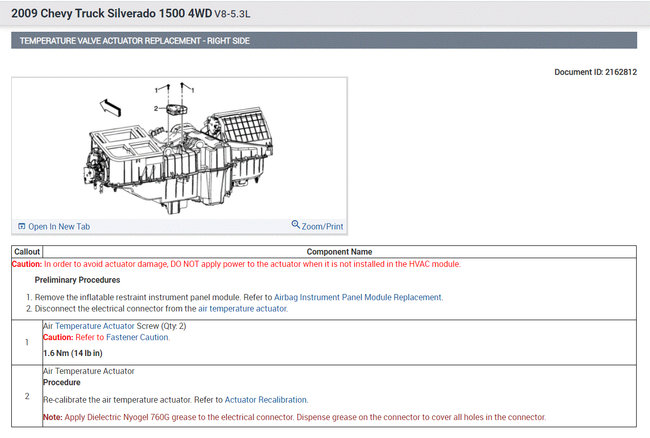

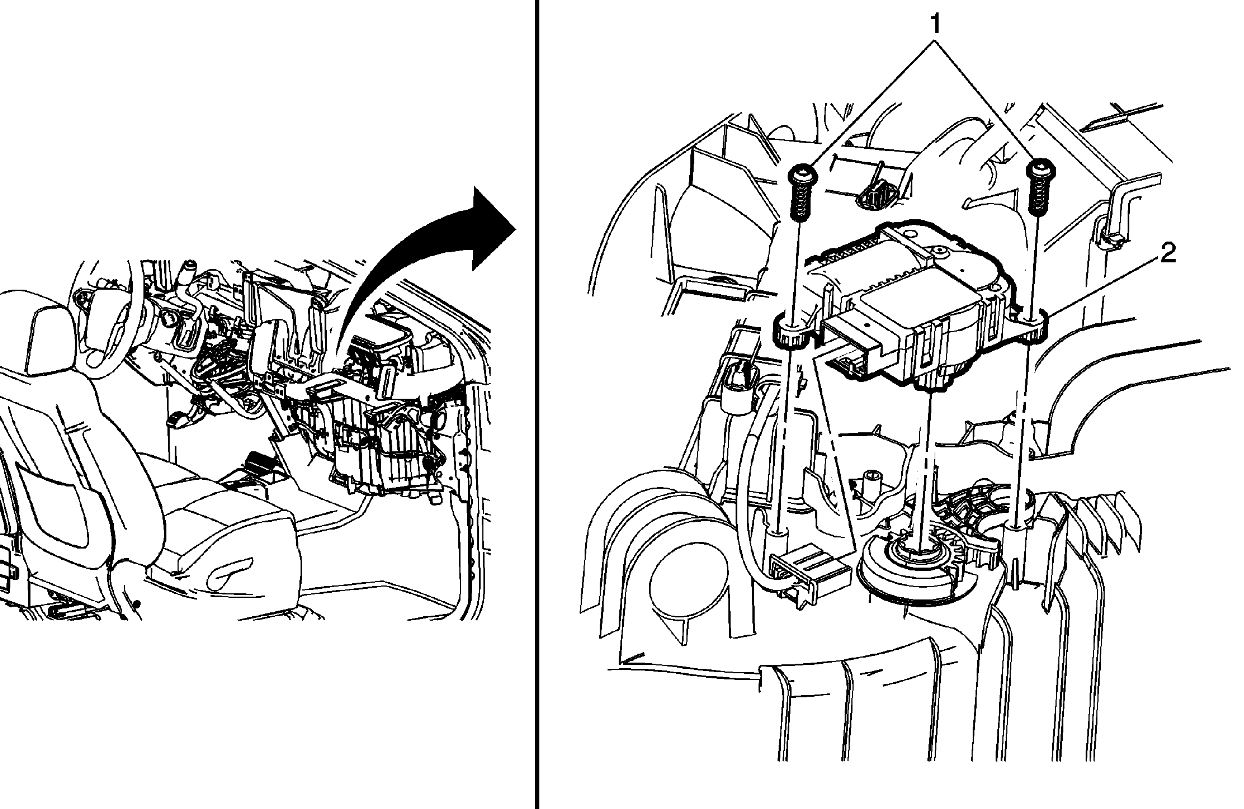

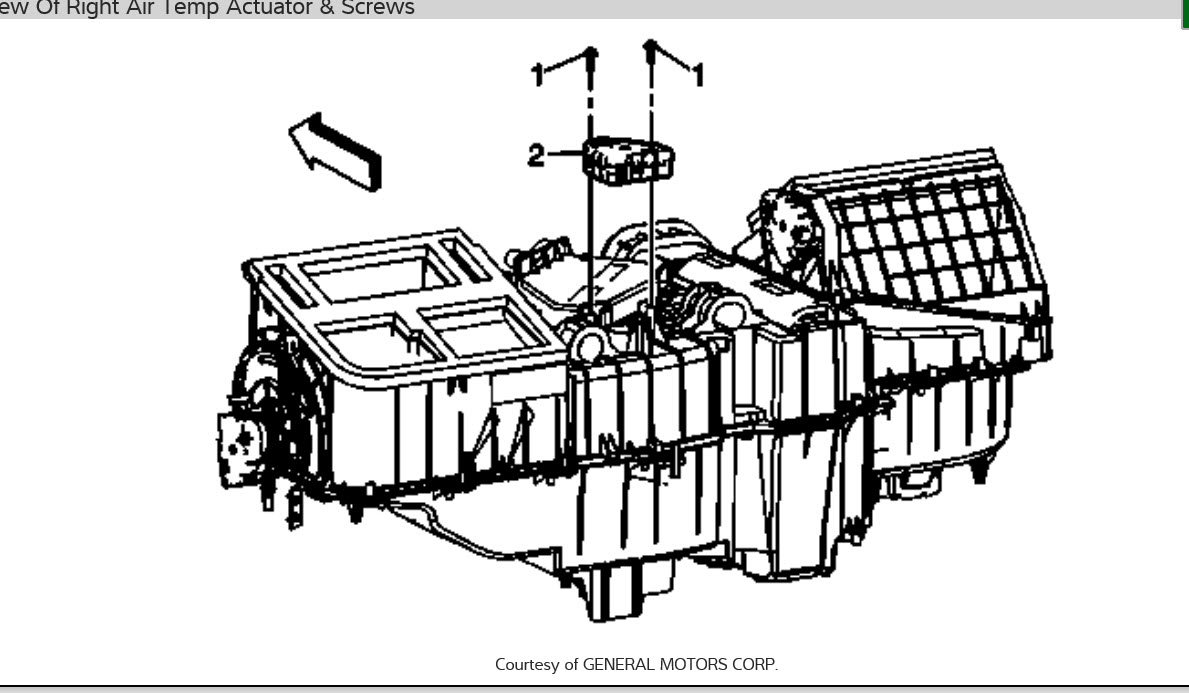

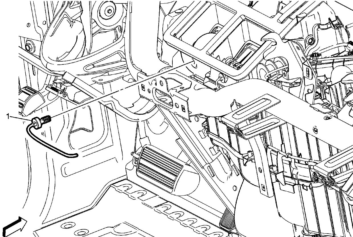

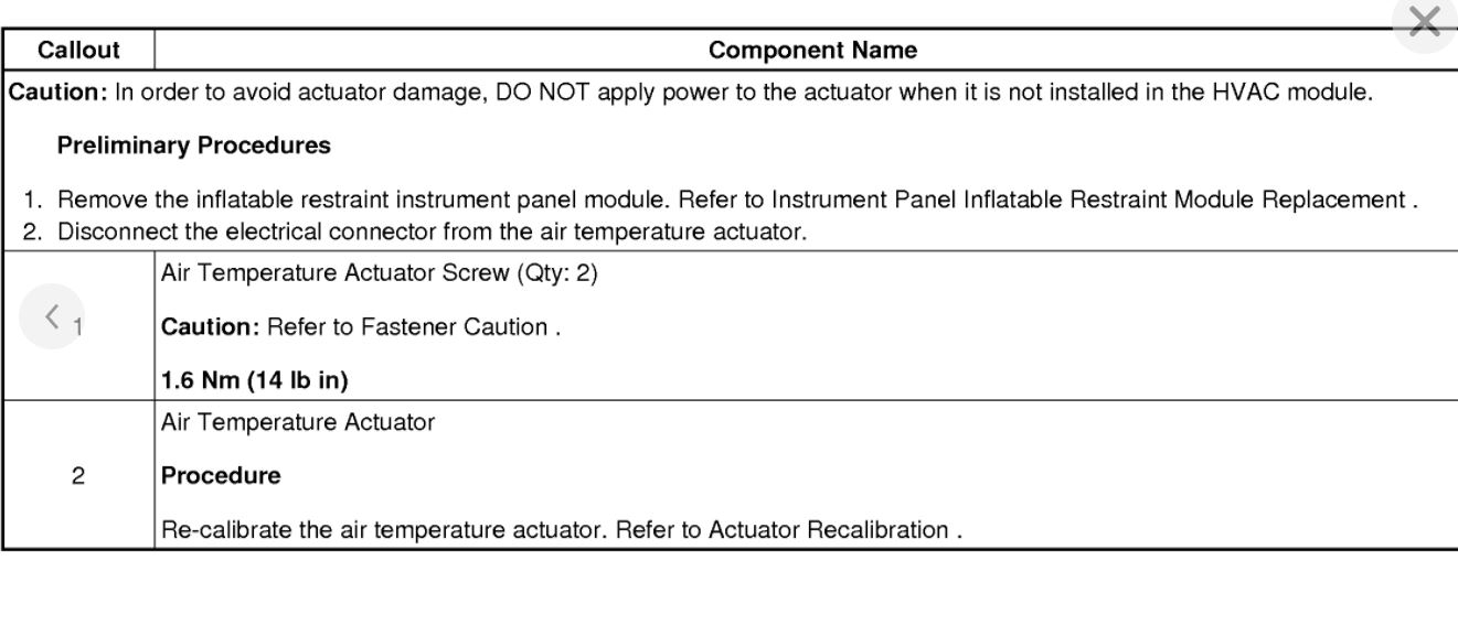

Yes, there is one for the right side as well. It is more difficult to replace. I attached the directions below for replacing it. (pic 1)
Also, pic 2 shows the recalibration procedure when you replace it. I forgot to add it the first time. Note: The recalibration shows doing it with a scan tool and without the scanner.
See pics below.
