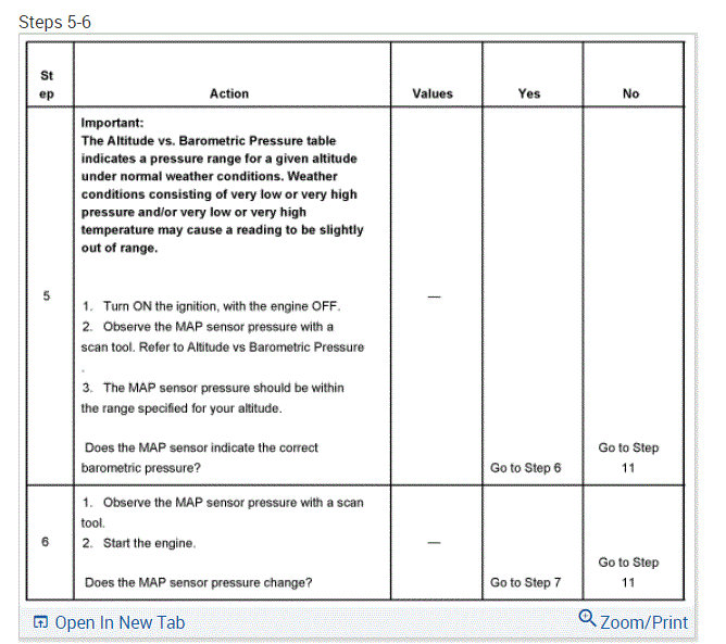

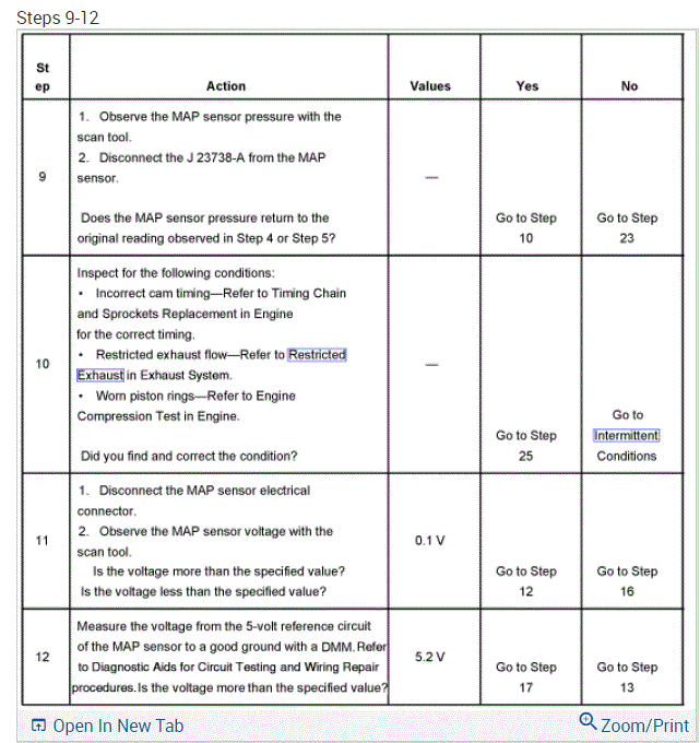

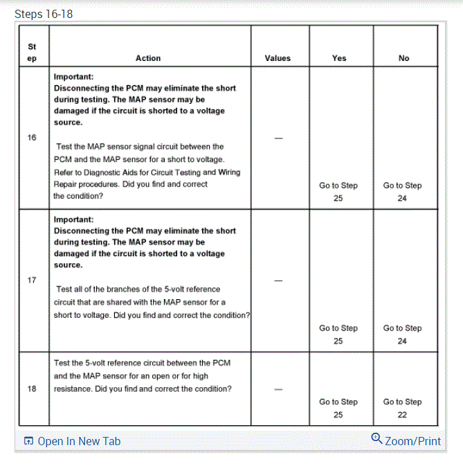

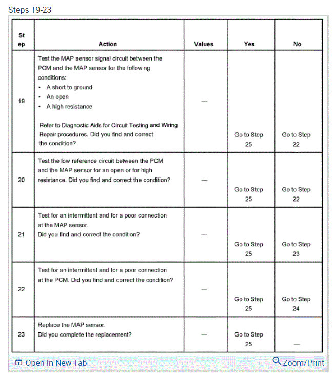

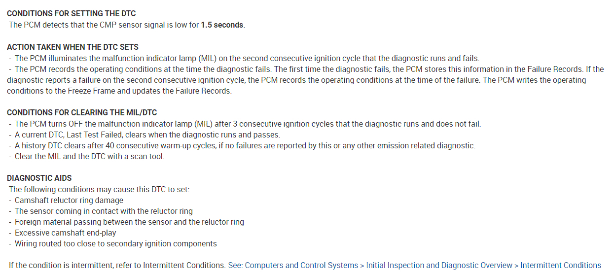

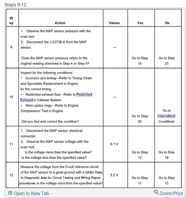

Have you checked the reference voltage to the sensor? It should be right around 5v. Also, check the low reference for continuity to ground. Also, have you done anything with the cam sensor? It too could be a ground issue or voltage problem.

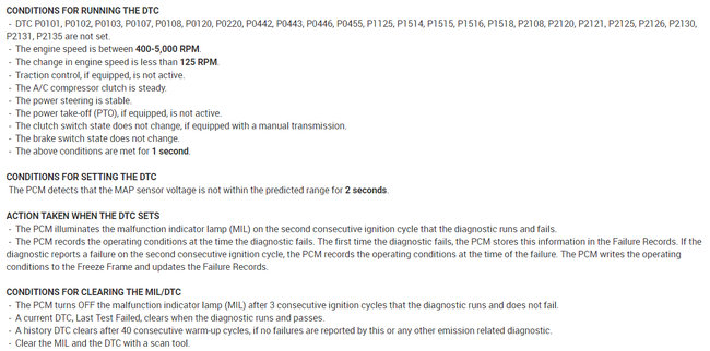

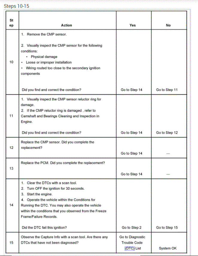

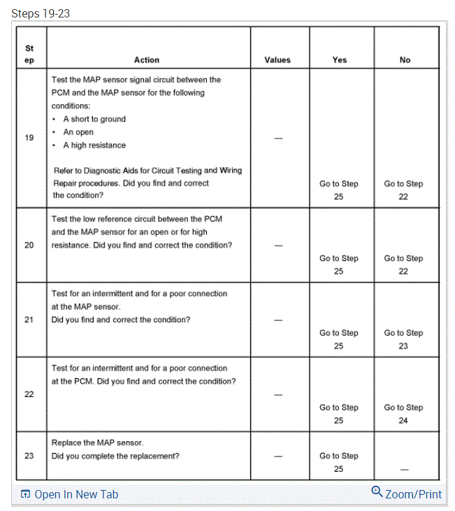

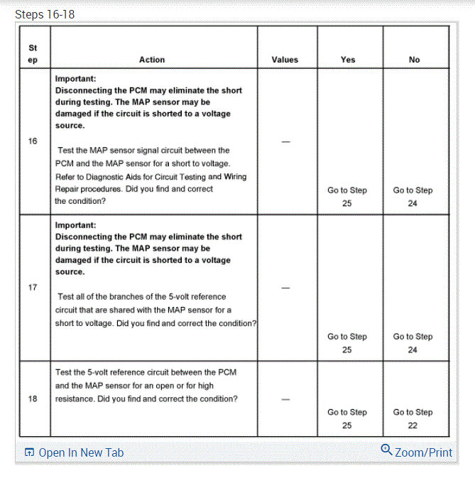

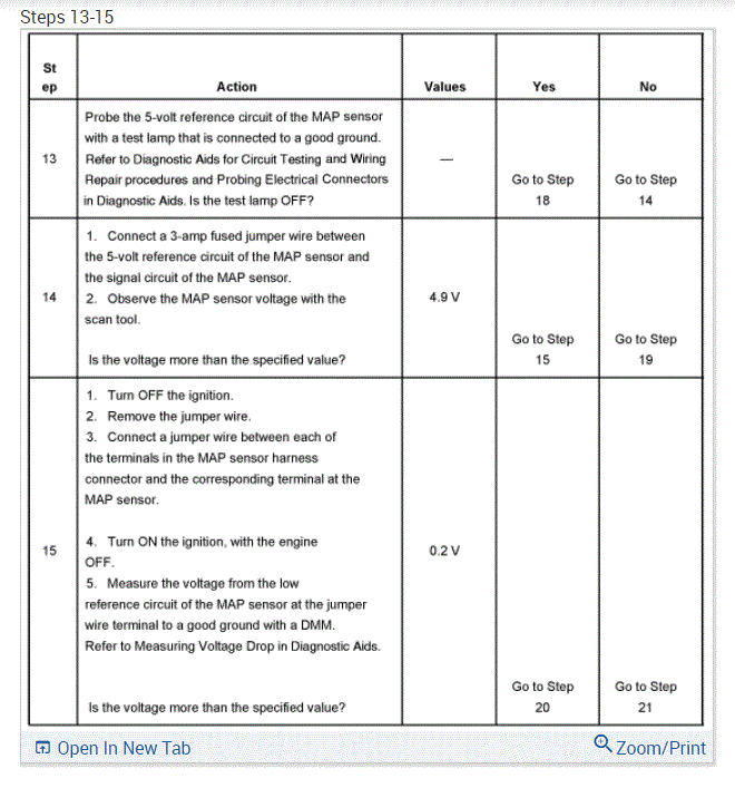

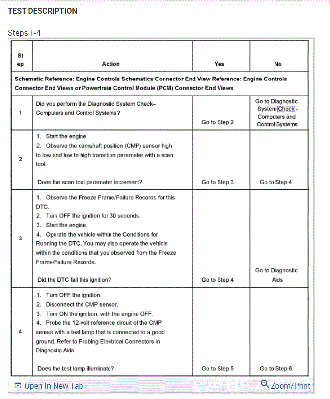

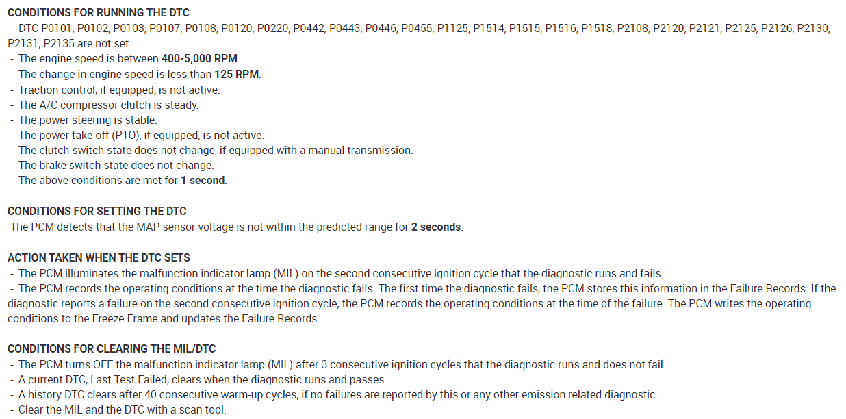

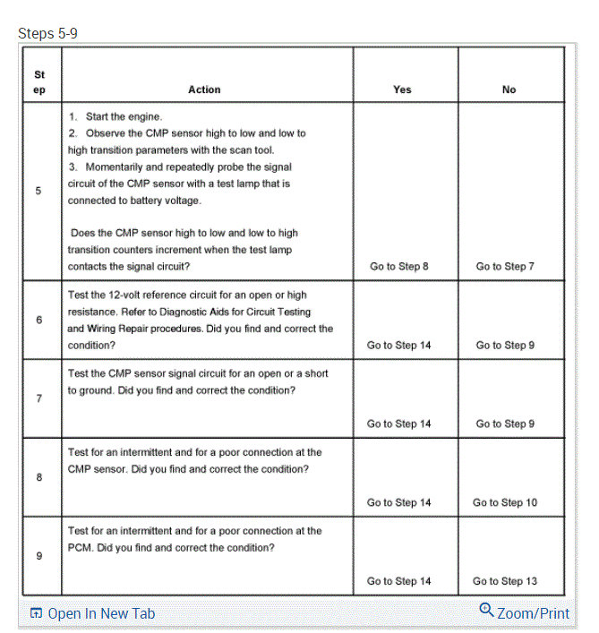

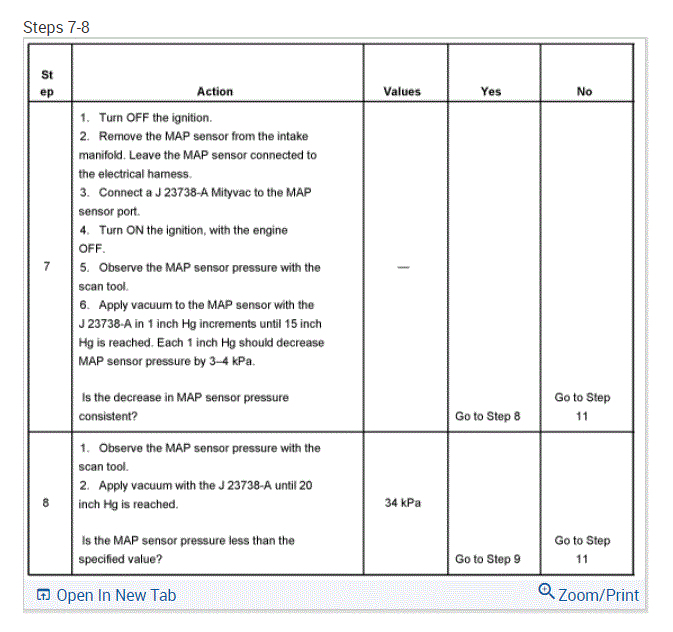

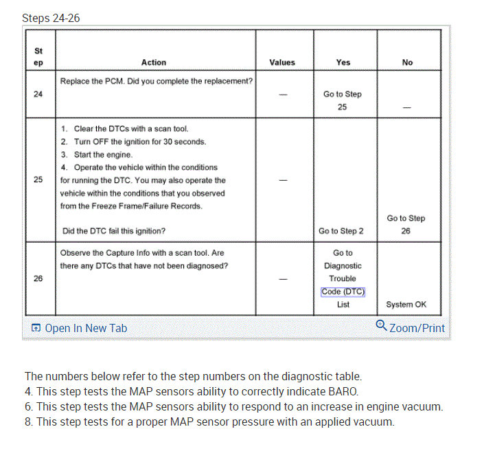

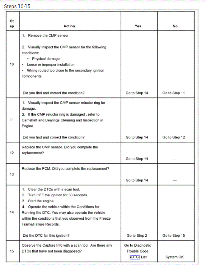

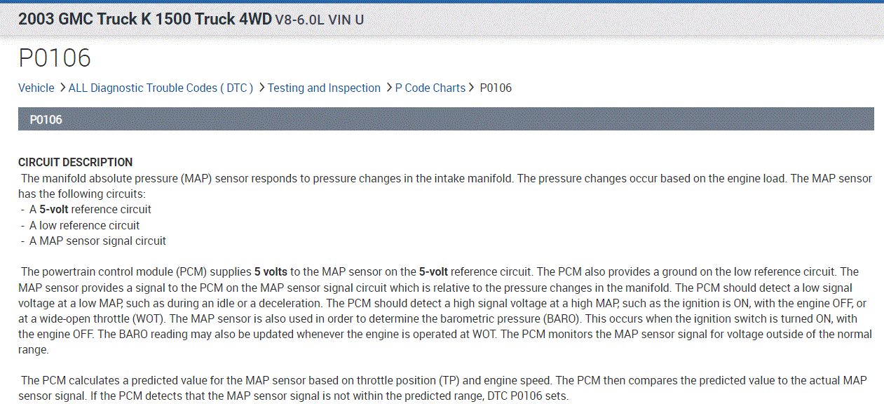

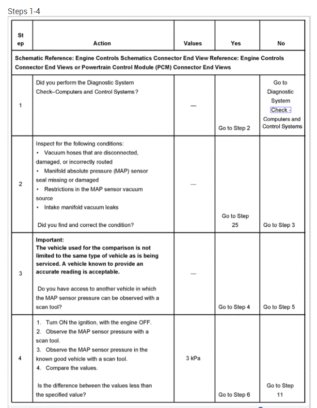

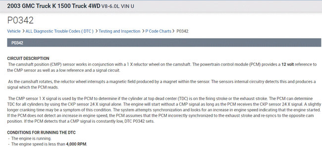

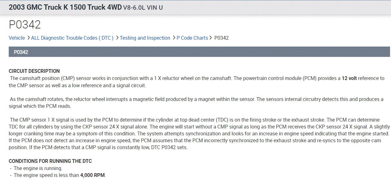

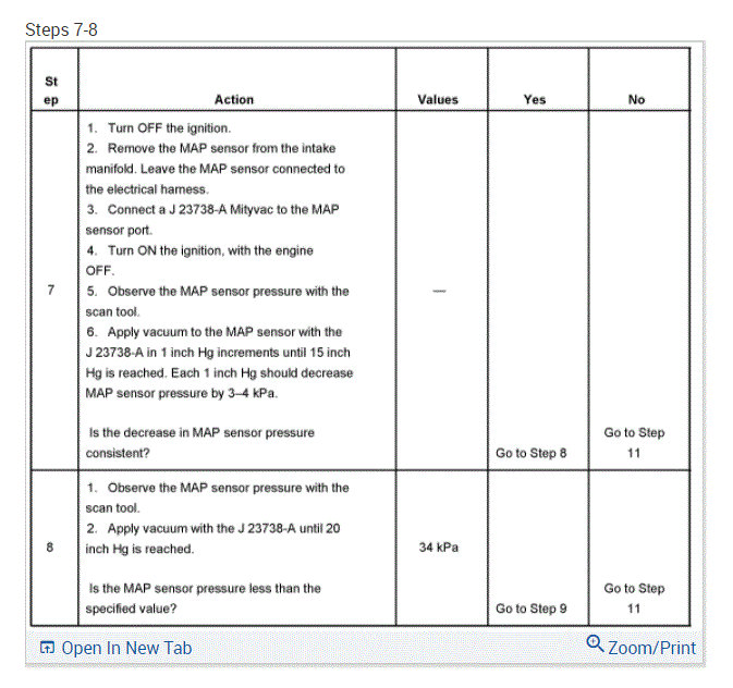

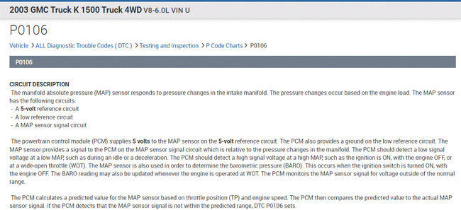

I have all the diagnostics which I'm adding below. I don't know if you will have the tooling to complete them. However, take a look through them and let me know.
If you look at the attachments below, I included the directions and pics related to both codes. The first six pics are for the P0342. The remaining pics are for the P0106.
Let me know if this helps.
See attachments below.

1st the new cam sensor that I swapped out when I changed the cup was bottoming out against the reluctor. So I put the old one back in and all was good for the moment.
