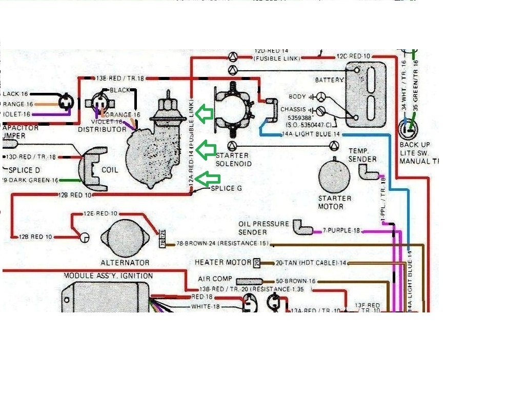

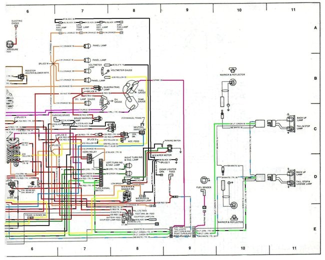

Question, my alternator doesn’t seem to be charging the battery. Do you have a wiring diagram I could reference?
May 11, 2019 at 12:56 PM
Let's check it like this first.
Okay
No gGo?
Look over my 1979 partial diagram (I'm pretty sure the alternator portion is the same on newer diagrams)
The newer diagrams I have are really blurry when I post them, so that's not any help either.
Notice where I "green arrowed" the wires.
It shows a 12 AMP RED 14 fusible link.
If it's shot, replace it with the same size fusible link, cheating and bypassing it might set your Jeep on fire, we don't want that!
Remove your positive battery cable (kills whole Jeep).
With your voltmeter, test for continuity through it.
It may be so obvious that this wire is burned into, or the insulation stretches out like a rubber band because the inner "fuse/ wire" has disintegrated.

May 11, 2019 at 10:53 PM
All makes sense. Where does the brown wire originate that plugs into the back of the alternator. That is the “excite” wire I have read. Looks like PO didn’t have any wires plugged into the back of the alternator.

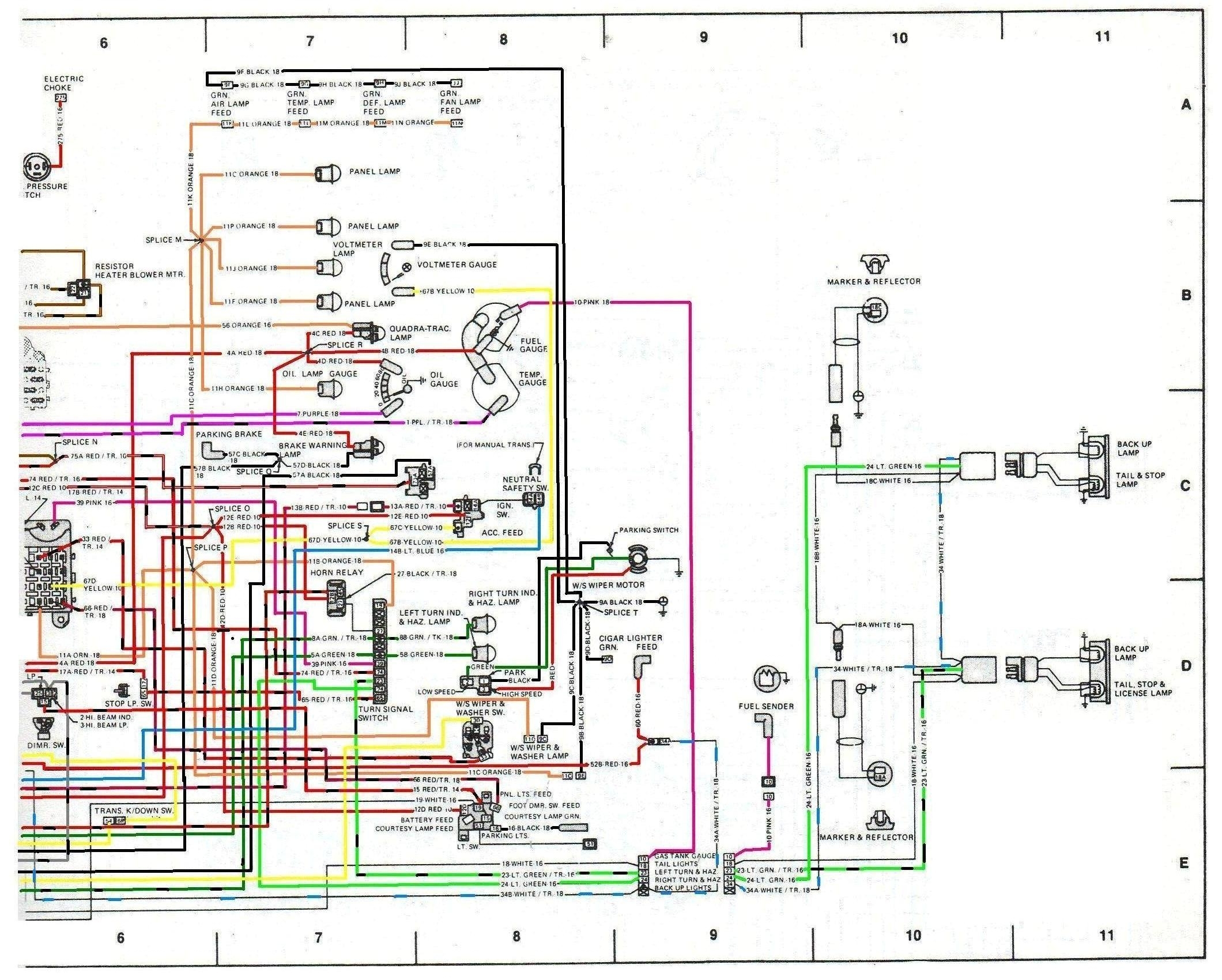

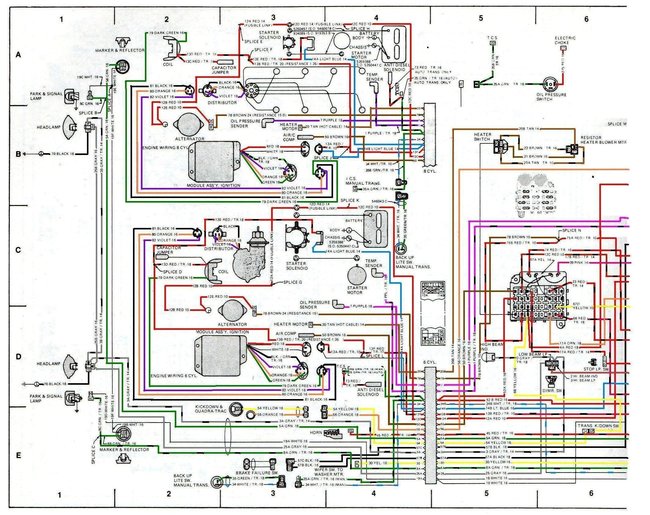

May 12, 2019 at 1:04 PM
The excite wire runs through the firewall and splices into a red wire with a tracer.
That red wire with a tracer goes into the rear of the fuse box on one end and to the ignition switch on the other.
Both halves of the '79 diagram are below.
