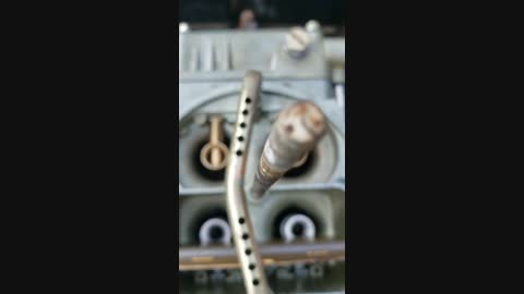

Took a little 15 second video of the stumble. Going to try to figure out what it takes to upload to YouTube. Once I do, I'll post a link to it for ya.

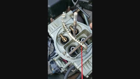

I have 2 videos. 1 with slow acceleration to stumble the other I think I accelerated a little too quickly, but it does include carburetor cleaner with an improvement. I'm hoping you're able to see the butterflies in both videos.
Let me know if you can't and need a better view or anything.

It looks like the secondaries are not adding any fuel? Cannot tell for sure but I can see the accelerator pump squirt on the primaries, and fuel spray there. The other side looks dry. Do you see fuel on the other side?

Try reaching in there with a tool and opening the secondaries as it stumbles. If it starts running better it shows a definite lack of fuel. Pressure wise I don't think you need to worry yet, The higher pressure just ensures the bowls are kept full under higher flow, at the moment you cannot get that engine to run hard enough for that to be an issue.

I've manually opened the secondaries as it stumbled and, yes, it picked up and ran/sounded great.

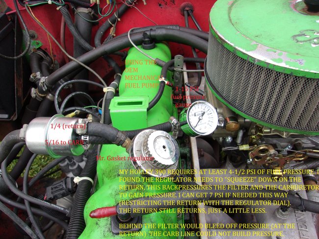

With my regulator having 2 outputs should I keep one plugged and setup like on Mr. Jeep (regulator on return line), should I install the regulator before the filter, or use the 2 port filter before the regulator with 1 output to the carb and the other to the return?
I know, too many options... I'm thinking I'll start with the setup like Mr. Jeep and regulate the pressure in the return side.
I'm all ears gentlemen
Jul 20, 2019 at 9:18 AM
CJ MEDEVAC
  • 11,004 POSTS
I think I'd stay with the latest Mr. Jeep pic I sent.
Regulator on the return line, Gauge on the carburetor feed line.
This will let you see and adjust the actual pressure to the carburetor.
(Before, the regulator was before the filter, I finally realized with the "open" return line the pressure/ volume was being bled off and could only build pressure to a certain point.
This better way, regulator on the return, still allows fuel to return to the tank, not over-powering the needle and seat. It now allows better pressure and volume to the carburetor. It's sort of like squeezing the return line with pliers to increase everything before.)

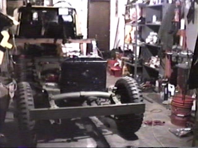

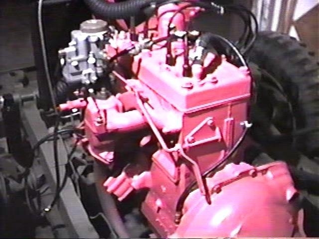

Yep, that was Willy, here's a few more.
Unfortunately, back then pictures required developing or were VHS (in this case).
I wasn't much of a picture taker, but my buddy had a cam corder and that was high tech in '91!
A while back, another friend converted my few VHS tapes to digital and I was able to make some screen shots.
This was shots from "My" day 1 with Willy till he was street legal again two years later. All within a one car garage on my side of the duplex I was renting. Next to the last pic is my four year old little girl who helped all along. Last pic, she's now 32 and Willy is 73.
No sense in yours sitting idle, you need to jump on it! For two long years I longed to drive my own Willys Jeep.

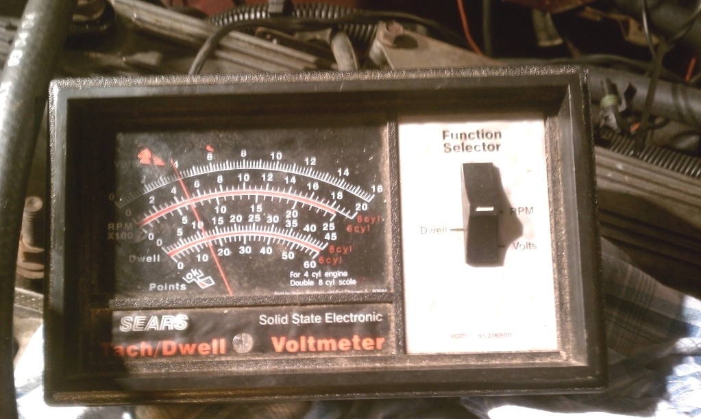

Everybody wants you to convert to something totally odd and hard to work on. On a Jeep, there's really no more betterment in changing stuff, just more confusing to hook up and use. I suggest leaving the distributor and ignition system alone. Unless you want to make a backup system to use after the ICBMs stop falling and the EMPs have destroyed all electronics. A point system could be installed fast and be usable.

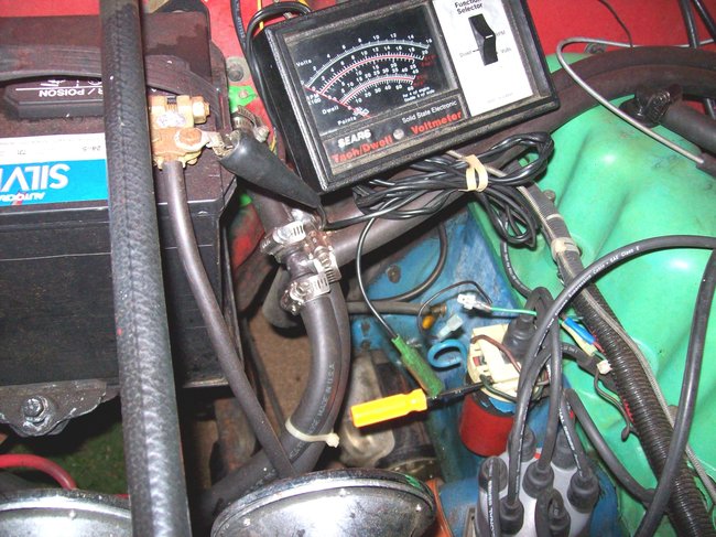

A dwell/ tach is a really good tool, I like it better than using a vacuum gauge to tune the carburetor. A plain Jane non-adjustable timing light works well too.
I see them cheap in pawn shops now days.

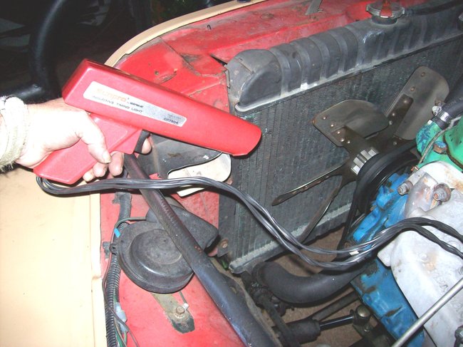

As far as tools. I have an adjustable timing light (not a fan, using my father in laws normal one). Vacuum gauge and tachometer... I mount it under hood when needed, later I'll install inside the cab, cause I tend to watch rpm's while driving.

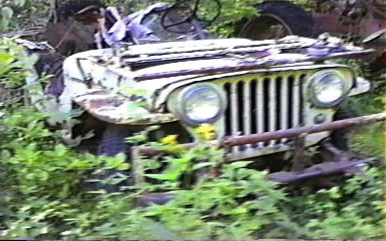

Just a thought, I've answered bunches of CJs, and a lot of other vehicles too. As far as the CJs go, you might Google search 2carpros, cj medevac, Jeep and then hit "images". You might find something that interests you. All of the stuff is not mine, but quite a bit is.
Well my pictures did not win either the front or back cover of the recent Willys parts catalog contest. :-(
These were some I did/ or was going to send in.
Send us an action shot of yours!
