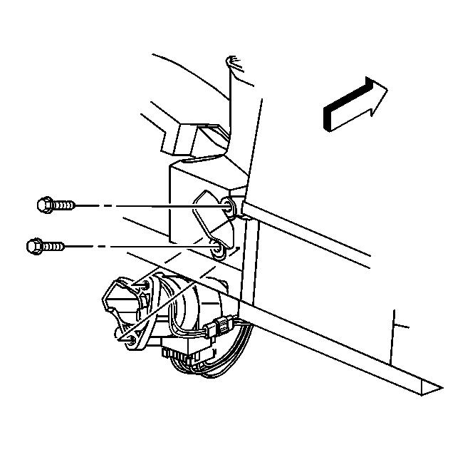

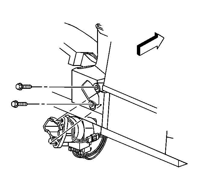

My switch is on the dashboard, not the column. Makes it a LOT easier on me.
Do you have a link to a free online electrical schematic I could use to figure out the wiring to the key plug in and driver side fuse box?
I've spent hours & hours tryin' to find one w/no result.
I'll temporarily "hard-wire" (w/an extra fuse of course) my A/C, while waiting for my new switch and cd factory repair manual. I live way out in the Mojave Desert, so theft isn't a problem, heat IS.

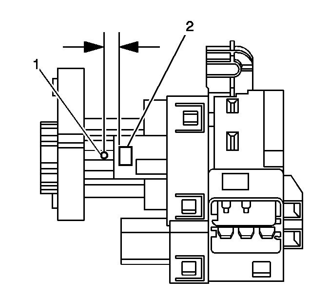

forgot chevy moved to dash get back to removing knee panl and got to key cylinder. Plug on bottom see diagram find ORANGE wire term C1 post F6 that is to AC find hot wire tap into.

Autozone wants near $100 JUST for the switch!!
Now I'm thinkin' a PERMANENT jump wire following your instructions.
I'll run the batt volt input from switch's plug, to a fuse & toggle, & back to the switch's existing A/C wire.
Will that power up the PCM (CRANK), CRUISE, A/C/CRUISE, A/C FAN, & STR COL also, or are those all different wires requiring their own jumper?
If they're different wires, can you send a link to a color coded schematic?

Hey Doc,
Saved my pennies & FINALLY bought the stock switch 'bout a week ago.
You were absolutely RIGHT-THANK YOU!
R&R was easier than I expected, due to your instructions.
AC & cruise problems went away.
