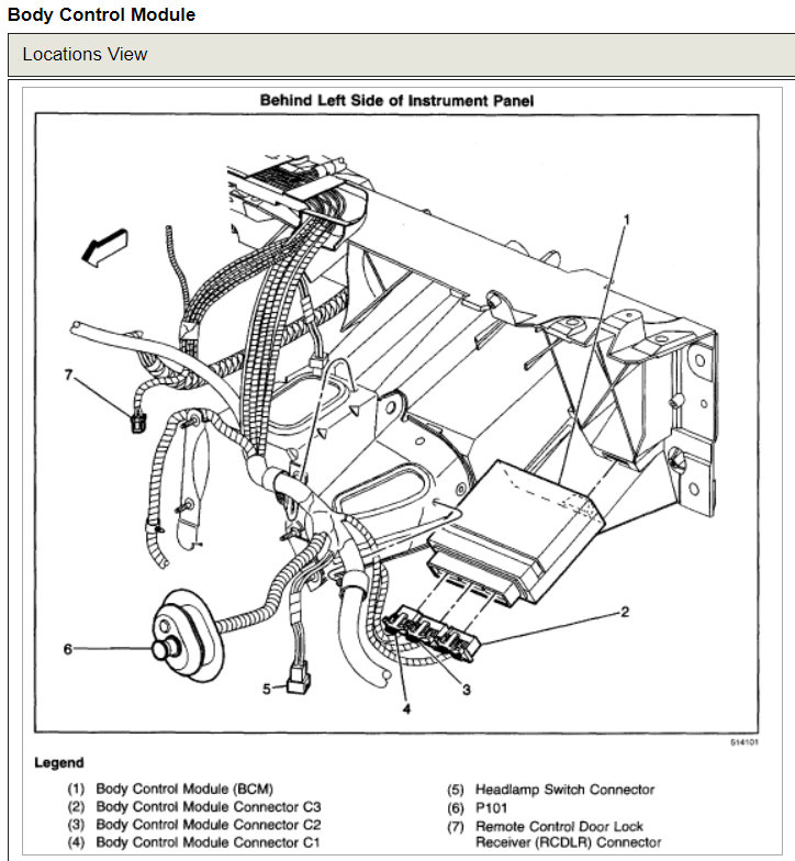

Recently my cruise control light would come on on my dash lights, and the cruise would not work. It has stayed on for days at a time. I realized that at the same time that the cruise light was on (with the switch turned off) that my heater/AC system would not work at all. I could not change the air flow buttons, when turned on no air would come out, and even the light for the rear defrost would not work when pushed, the heating/AC system was completely out.
The strangest part; when the cruise light is off, the heater/AC works, when it is on the AC will not work, and then gone. I am assuming a connection in there.
Any suggestions as to what can be causing such a stir? I have had all of my fuses checked and they are all good. Also, I have recently put in a new battery in preparation for an Arizona summer.
Please advise!
May 17, 2020 at 11:22 AM (Merged)
LEGITIMATE007
  • 5,121 POSTS
This sounds like a BCM issue. I would try to get a sued one and plug it in to see what happens. Here is the location.
Cheers
MLE_ABS
I took my car into the dealership and they told me that the problem is my ignition switch. Has anyone heard of this before? I am confused how those would tie together! Please advise.

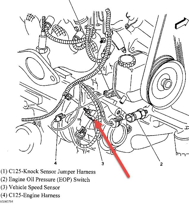

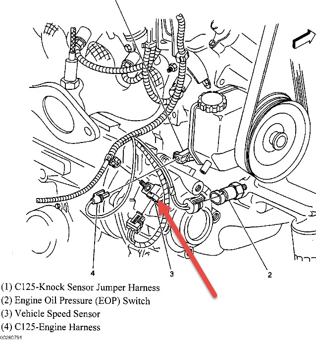

My cruise control has not work for a year and when I was coasting down a hill my speedometer started to fall until I hit the gas pedal and it straighten back up. Would the speedometre sensor cause this and where would it be located. would it be in the same place even for the super sport model.
May 17, 2020 at 11:23 AM (Merged)
HMAC300
  • 48,601 POSTS
scan for codes first and check fuses and relay under hood for cruise. see pic

I have replaced my vss and the speedometer is doing fine but now my check engine light is on and the code is P0717. What is wrong?
HMAC300
  • 48,601 POSTS
it may be that the harness was stretched when you installed the vss as this is the input speed sensor for turbine. It is inside trans. also if no vss signal makes it come on as well. so go to an auto parts and see if they will erase the code and then drive it and if it comes back on have amechanic look at it. that sensor could be bad or it's a connection problem. it is inside the trans and it may be apoor connection for large plug at trans as well.
