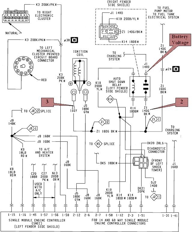

The first problem is the terminology is confusing. The automatic shutdown relay is so named because it is involved when there is a crash that ruptures a fuel line. If the electric fuel pump were to continue running, it would dump raw fuel onto the ground creating a major fire hazard. Instead, when the line is broken, there is no fuel pressure. With no fuel pressure, the engine stalls. When it stalls, there are no signal pulses from the Hall Effect switch in the distributor. With no signal pulses, the Engine Computer turns the ASD relay off. That kills the 12 volts to the fuel pump or fuel pump relay, (depending on car model and year), along with the ignition coil, injector(s), etc. That removes the fire hazard.
Under normal operation, the computer turns the ASD relay on for one second when you turn the ignition switch on. That will run the fuel pump just long enough to get the fuel pressure up for starting in case it bled down over days or weeks. You will usually hear the hum of the pump for that one second, then it must stop. That means if you jump out and check at the ignition coil, any injector, or any other place that gets 12 volts from the ASD relay, you're going to find 0 volts.
The computer has to know the engine is rotating, then it will turn the ASD relay on again to power up the ignition coil, fuel pump, and injectors. The distributor signal you're asking about is usually called the "distributor reference signal". That is the pulsing signal that comes from the Hall Effect switch as the distributor shaft is rotating.
When you have a scanner, one of the hundreds of things it will show is "ASD Request" "On" or "Off". You should see that switch to "On" during cranking. If it does not, you won't have spark, injector pulses, or fuel pump. There is likely to be residual fuel pressure, and that can be misleading. That pressure is there because the fuel pump still gets turned on for that initial one second.

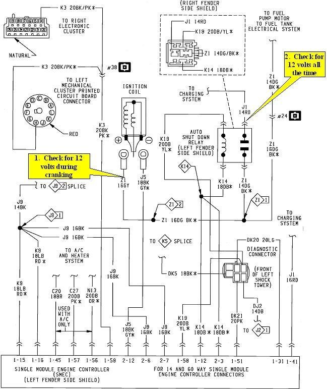

When you don't have a scanner, you can tell if the ASD relay is turning on by monitoring the voltage at the positive terminal on the ignition coil. On newer models with an injector for each cylinder, you can measure at any one of them. All these places will have the same color wire, usually dark green / orange. On your car I believe that is dark green / black.
A test light works best for this because most digital voltmeters don't respond fast enough. Connect it in such a way that you don't have to hold onto it, unless you're working with a helper. You'll want to be able to see it from inside the car too. That light will turn on for one second when you turn on the ignition switch. If it does, the ASD relay and the circuit it switches are okay, meaning there's 12 volts on one contact and it switches onto the second contact feeding the ignition coil and injectors. A bright light also shows nothing is shorted on that circuit.
Next, the test light should turn back on when you start cranking the engine. If it does, but the engine doesn't start, you have a spark-only problem, a fuel supply-only problem, or a compression / valve timing-only problem, meaning a jumped timing belt. All those systems are being powered up through the ASD relay, so they're supposed to be working.
If the test light does not turn on again during cranking, you will have no spark, no fuel pump, and no injector pulses. You know there will not be three separate problems at once, so do not waste your valuable time trying to diagnose each one of those systems. A lot of people get lost here. Most find the missing spark and get hung up in that system, then get stuck.

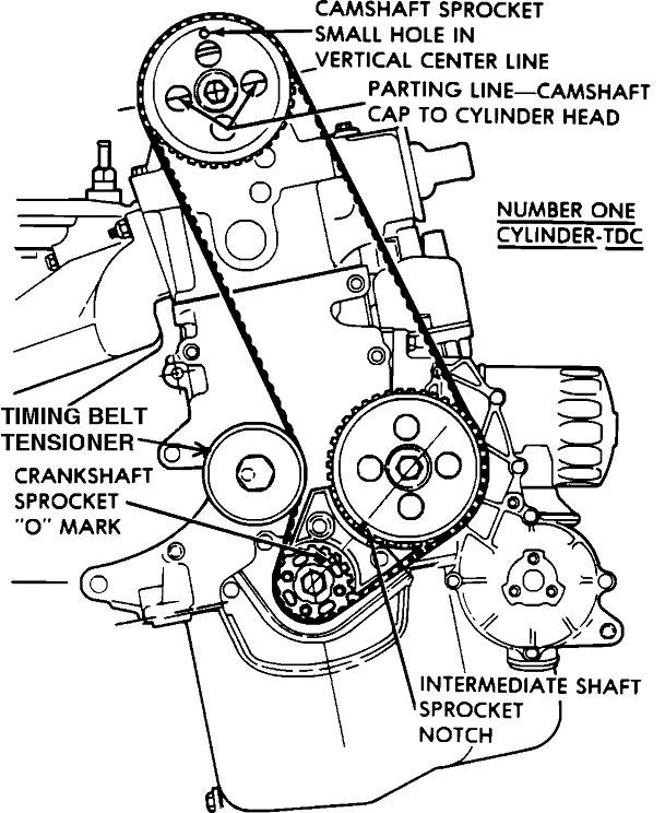

When the ASD relay does not turn on during cranking, it is always related to the Hall Effect pickup assembly. That in itself has an extremely high failure rate, but it's fairly easy to replace. A lot of people used to carry spares in the glove box. There could be wiring or connector terminal problems too, but those are less common. Least common is a defective computer. Also consider the distributor shaft is turned by an intermediate shaft that is turned by the timing belt. The 2.2L and 2.5L engines are not "interference" engines, so the valves will not be damaged if the timing belt breaks, but if it does, the distributor shaft won't be rotating either, so there will be no distributor reference pulses, and the ASD relay won't turn on during cranking. You'll hear the engine crank too fast or unevenly if the belt is broken.
