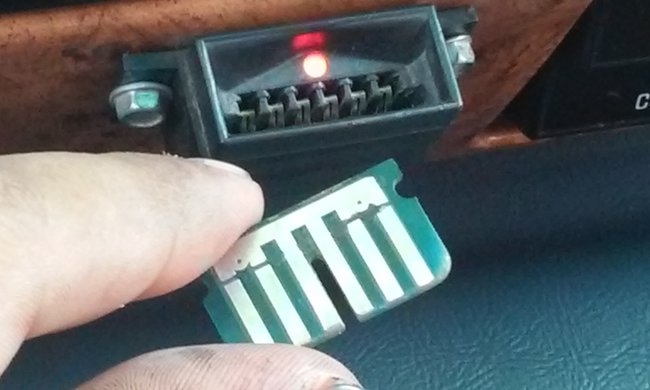

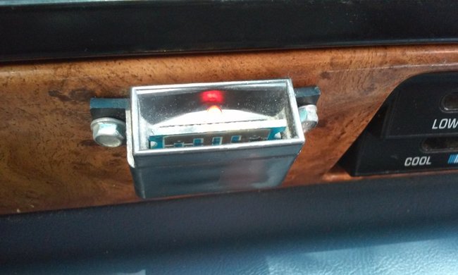

Ok one other thing i might add is that my car has a little square slot that was installed before i bought the car, which contains a little metal looking memory card which when you take it out, the car doesn't start or crank, the same thing its doing right now. And i did notice that even though its inserted, its kind of loose. Before it would go in kind of tight, but now it kinda goes in without any effort. Could this have something to do with it?
May 21, 2016 at 10:10 AM
Can you post a picture of what you are talking about?

Its not letting me upload it. Can i send to you to an email address?
May 21, 2016 at 10:39 AM
JUANEMMANUEL
  • 63 POSTS
Here it is.
May 21, 2016 at 10:44 AM
That is an old fashion alarm thing, I would take the out first thing, follow the wires back and just connect the wires the way they were originally made.

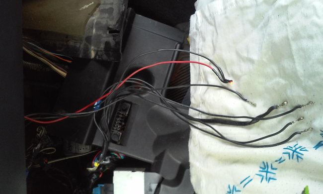

Ok i have a dilema. I disconnected the six little wires going into the slot box you saw in the picture, and they come down under the dash. But i have no idea how they were originally connected. This is what it looks like right now. Any ideas?

Here
May 23, 2016 at 12:59 PM
You must follow the black wires back to where they connect to the harness and look for the same colors, connect the same color wires together, the car should start. I cant remember if they go to a box or not, the idea is to just remove the whole thing and put the harness back to the way it was.
