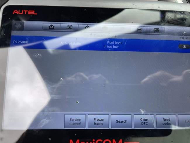

I just had a feeling it may be low gas, or the pump isn't picking up low level of gas of maybe there is eater. Put three gallons in and she kept running. Drove it in driveway and it drives strong, am waiting on plugs so i can change them. Just weird. It was not throwing any gas and i tried again and it was. So far, no stalling or check engine light, but the first time i started i checked for codes and there was p125.
Jan 6, 2022 at 5:02 PM
The code is for low fuel. LOL
Listen, I'm really glad to hear it's running, and this was the likely problem all along. However, if you can, let me know if it continues to run properly after a couple of days. Also, stop and put fuel in it. LOL
