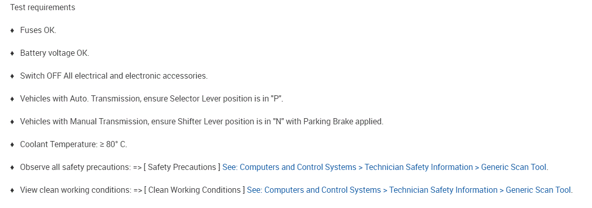

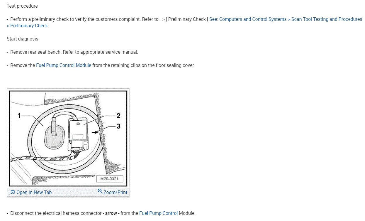

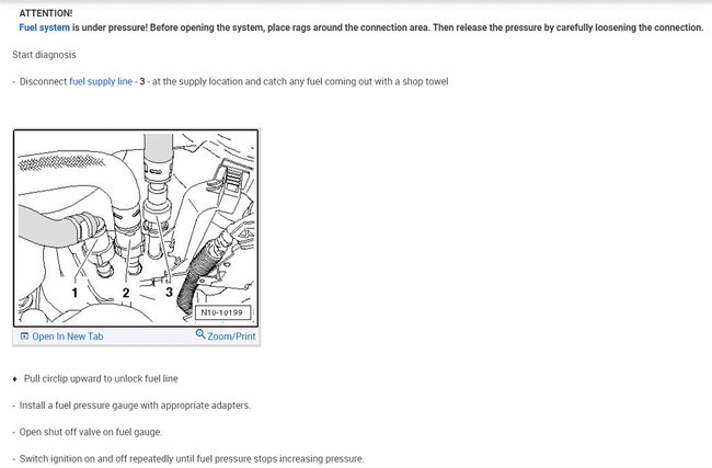

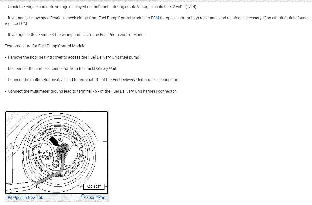

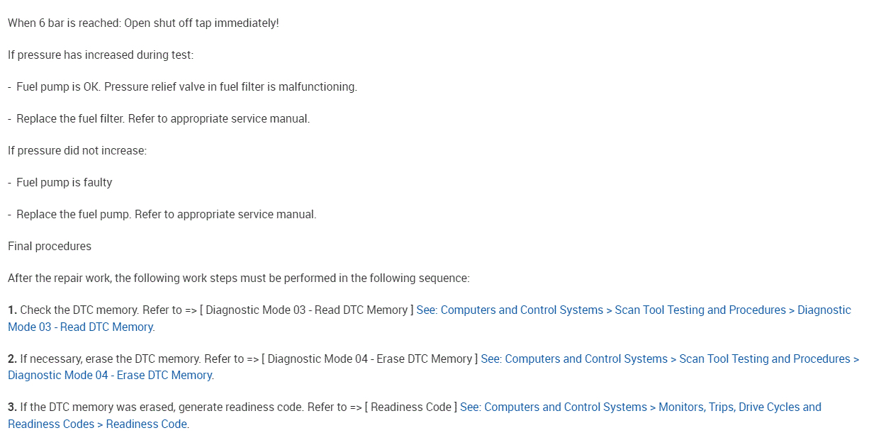

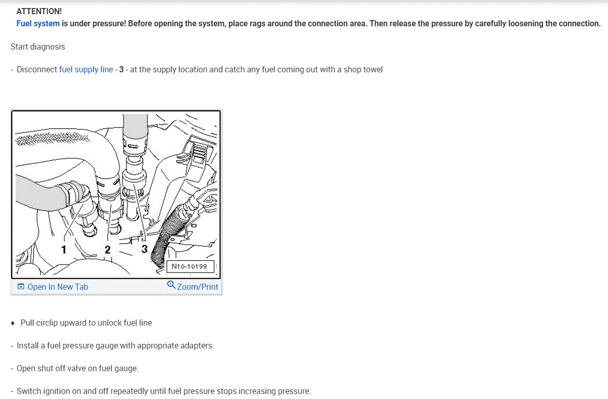

If you are questioning if it is a fuel issue, try this. See if the engine starts for a couple of seconds when using starting fluid. If it starts and then stalls, you'll know it's a fuel-related issue. Also, you could check fuel pressure. Here is a link that explains how it's done:

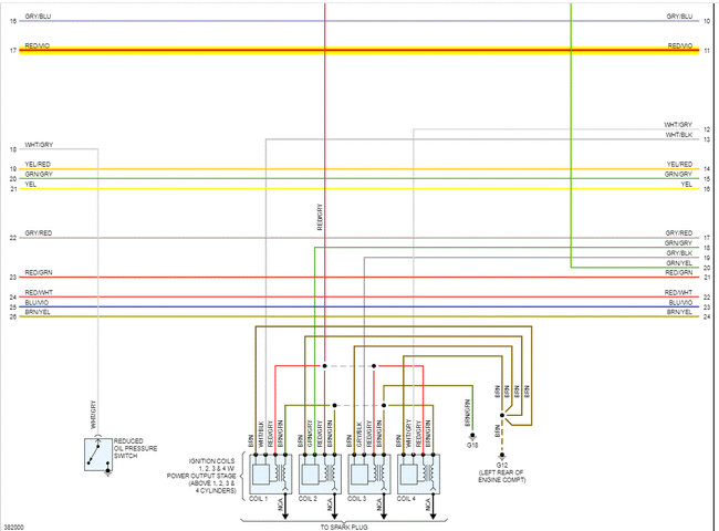

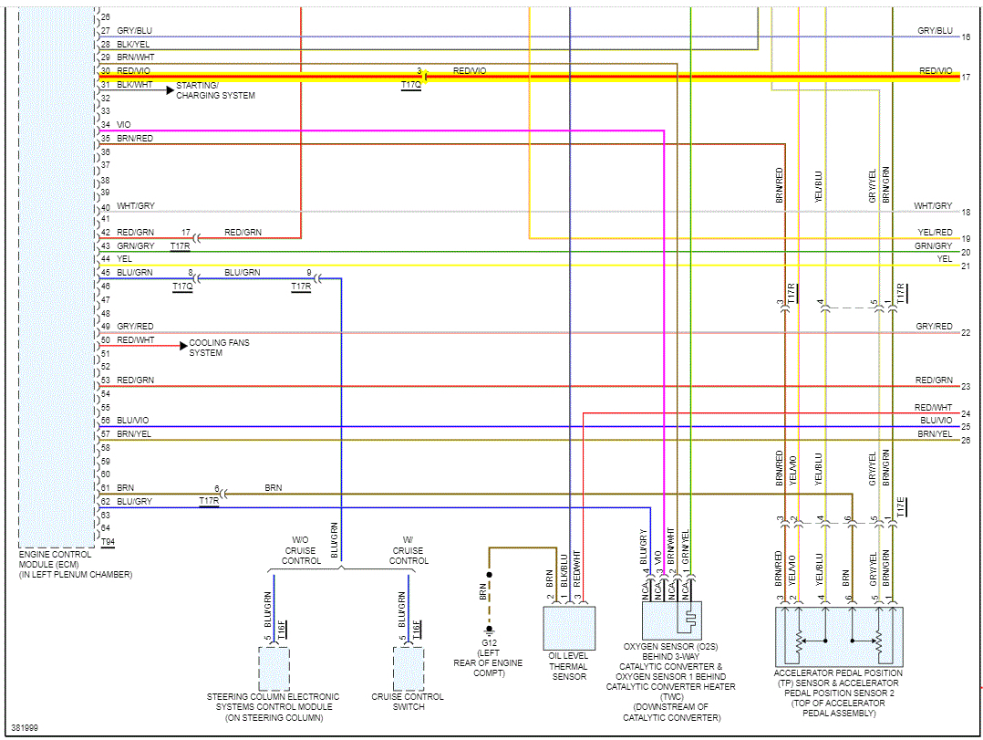

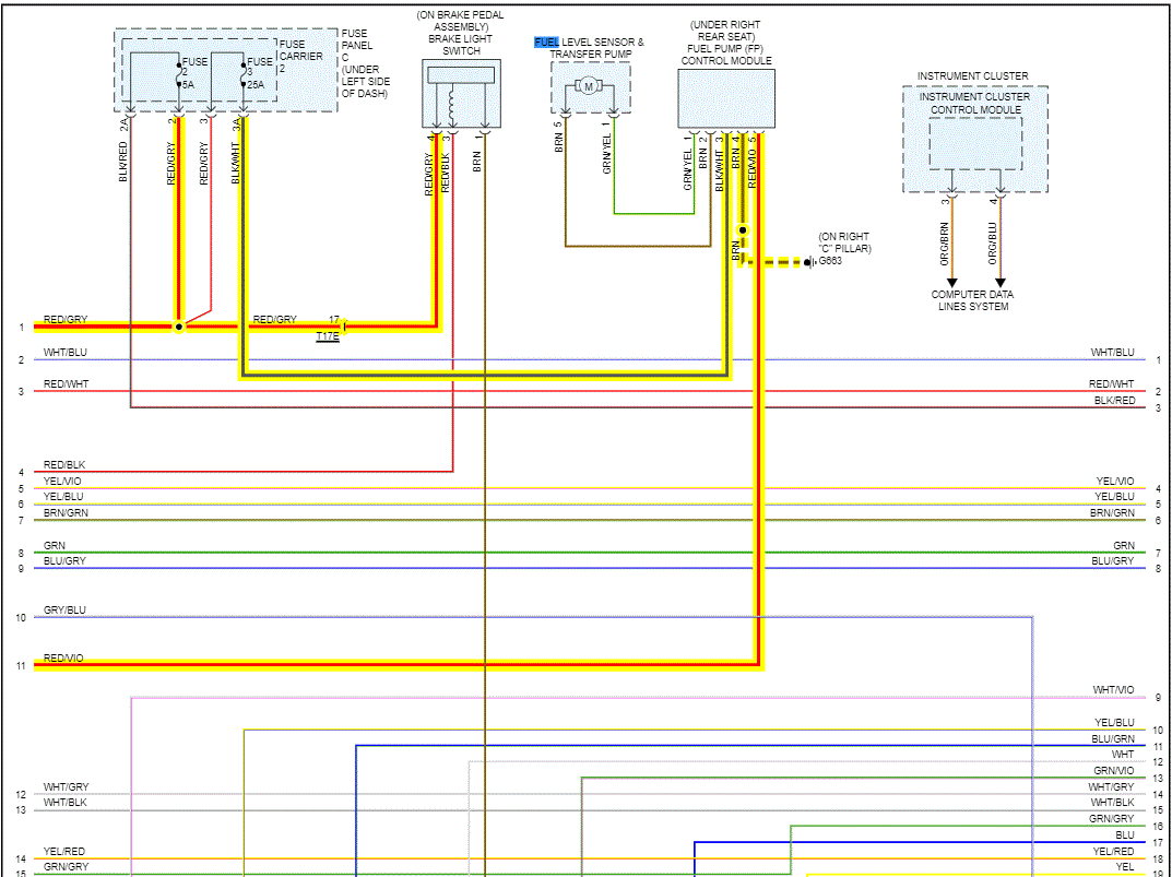

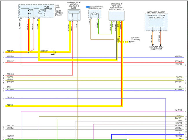

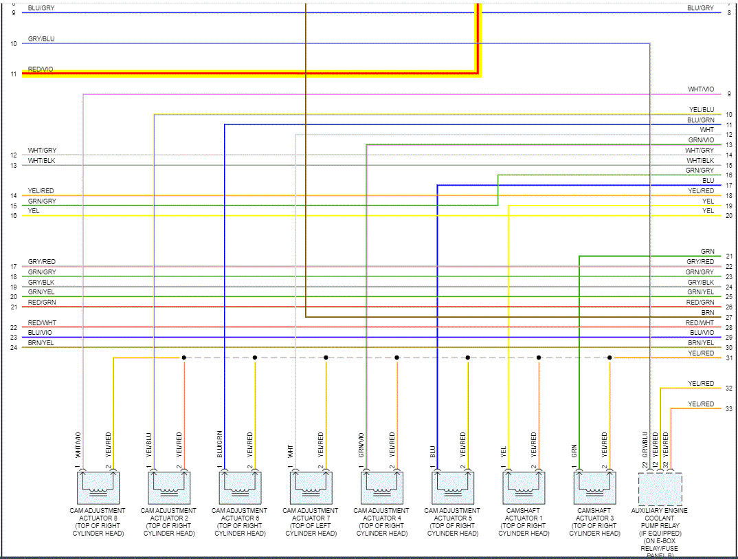

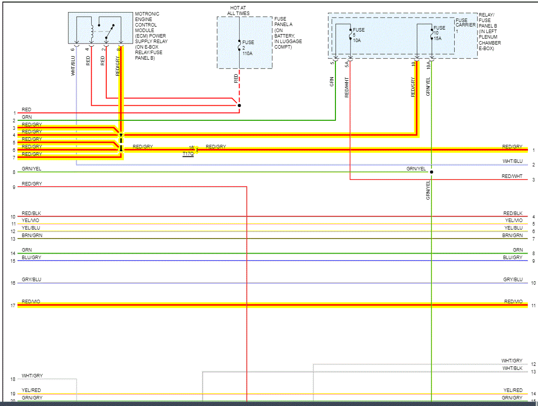

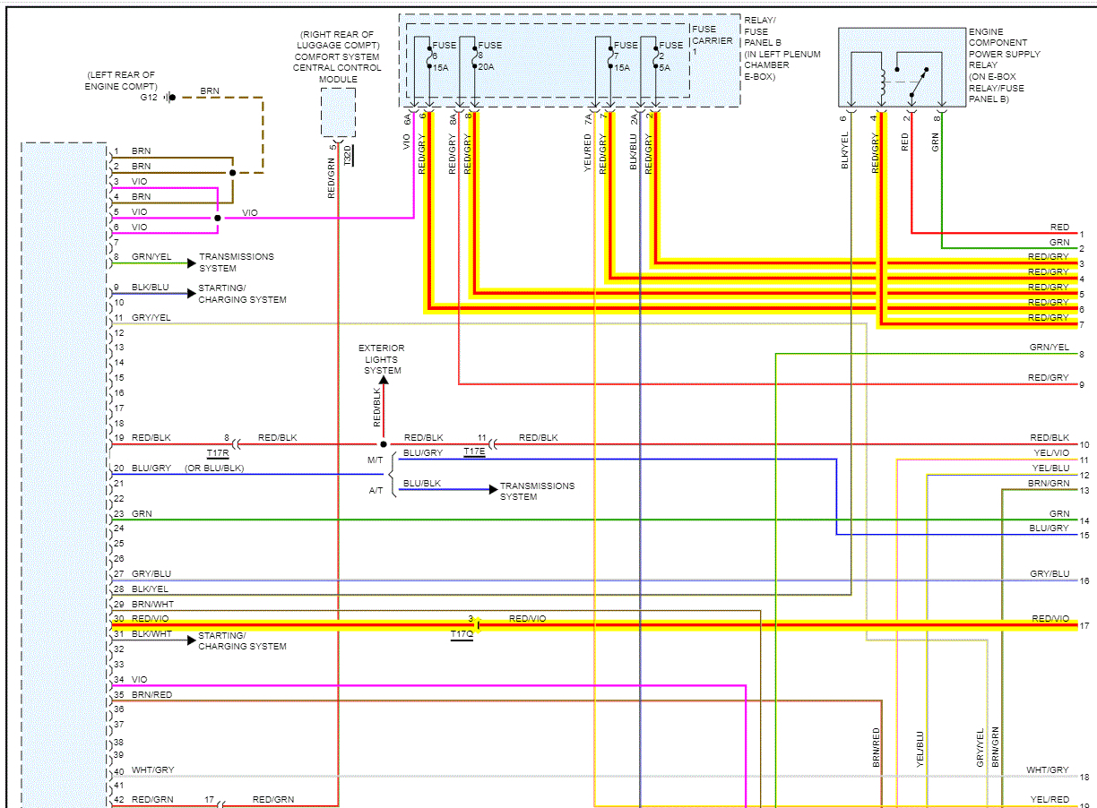

Also, I attached the wiring schematic below for the pump. There are a couple of relays to check and fuses.

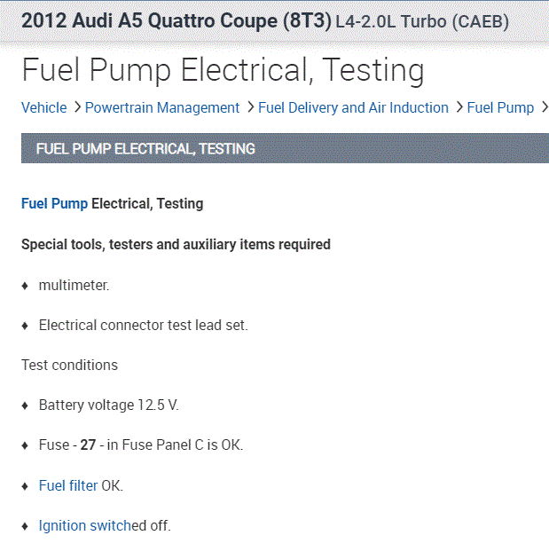

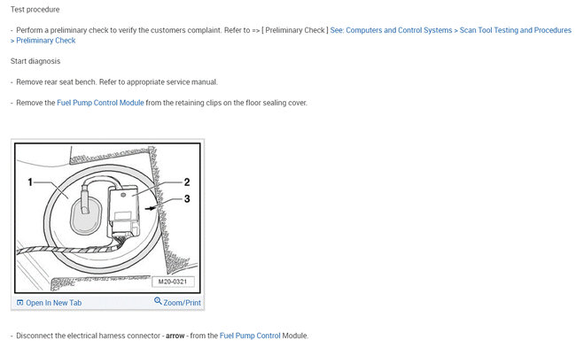

If you look at the schematic, note that I highlighted several of the wires that are all tied together via a relay and fuses. I need you to check the fuse. Under the left side of the dash, locate fuse number 3 (25 amp). Inspect the fuse to make sure it is good and also confirm there is power to and from it when the key is first turned on.
Next, check the engine component power relay in fuse panel B.
If there is another relay that has the same part number, switch them. If there isn't, here is a link that explains how to test a relay:

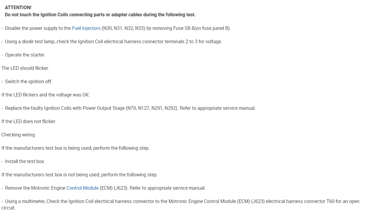

Let me know what you find. Also, you can perform the aforementioned things in any order. However, I do suggest trying with starting fluid first. If it doesn't start, then the fuel system, at least at this point, should be bypassed and focus placed on the ignition system.

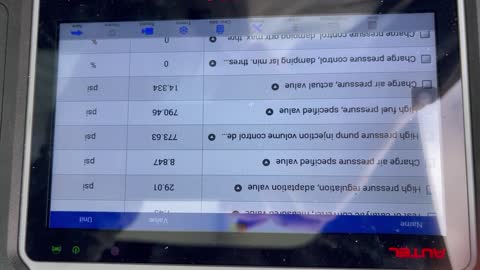

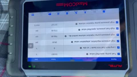

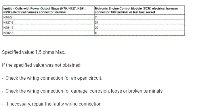

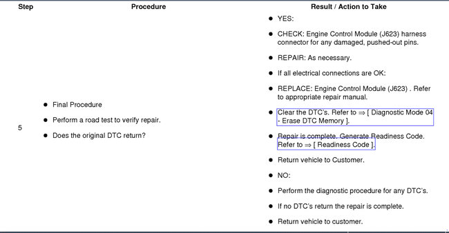

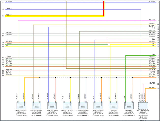

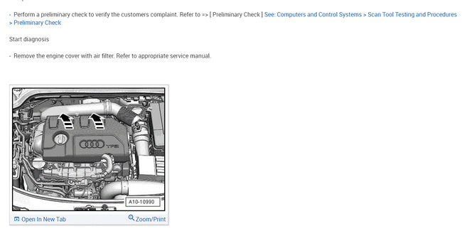

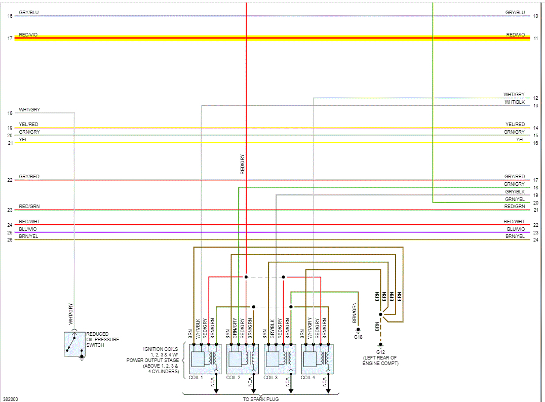

See pics below. Note: There were three pages of schematics. I had to cut each one in half to make them readable. So, every two pics are from one page. I did overlap them so you can follow from one to the next.
