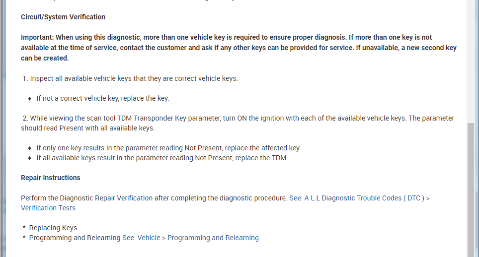

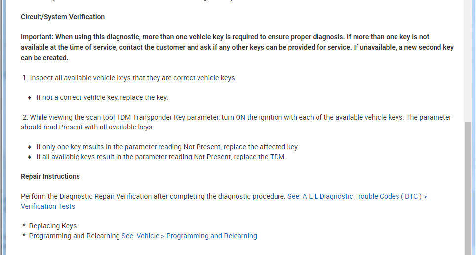

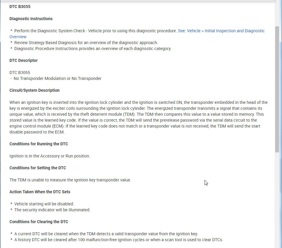

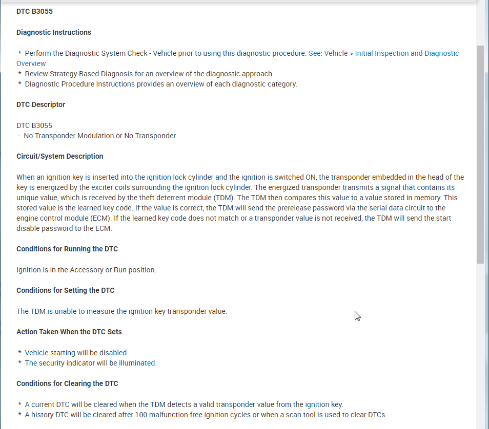

I am attaching the testing needed for the B3055 which does appear to be the issue.
This means a key was used that is not programmed to this vehicle or the key is no longer programmed. However, when you add in the other codes, you most likely have an issue with the ECM or transponder itself.
Let's run through this testing and see what turns up and we can go from there. Thanks.

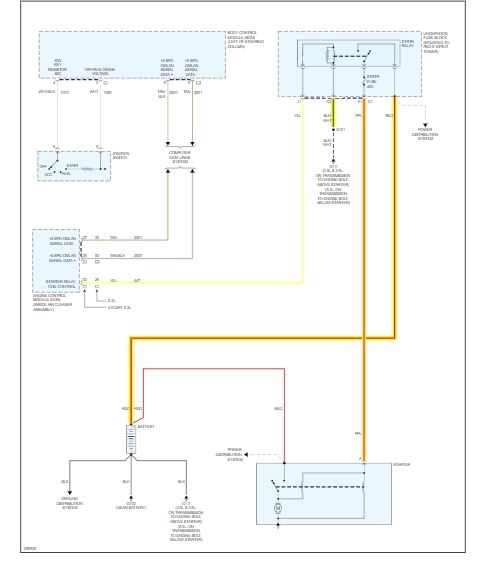

I've replaced starter two times and all my lights and everything coming on but it's still not cranking or even trying to crank. Battery is good, radio, lights are all on and strong but car not cranking or even making any noise to crank.
Mar 6, 2021 at 5:55 PM (Merged)
Good evening,
Did you verify power to the small wire on the starter with the key in the start position to see if you have power?
TINA S
  • 4 POSTS
Yes I did. It's just not doing anything.
Okay, what was the result? Do you have power at the small wire in the start position?
TINA S
  • 4 POSTS
Yes.
If you have power, then the only thing left is the starter motor itself.
