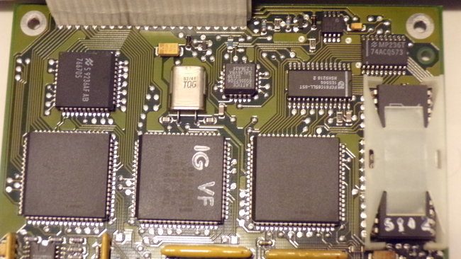

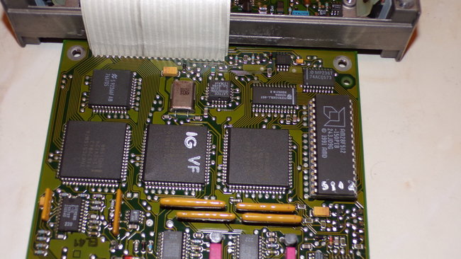

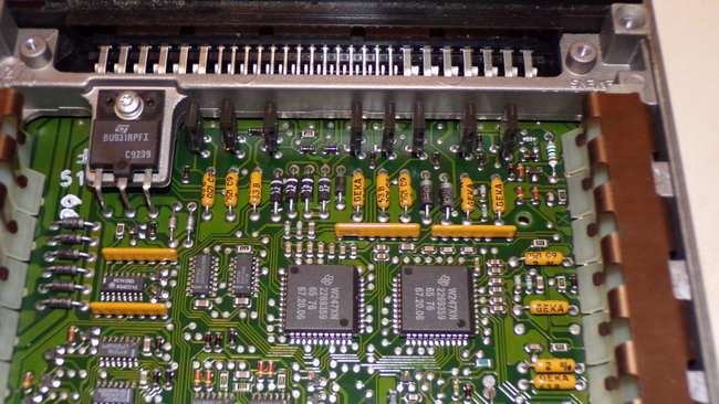

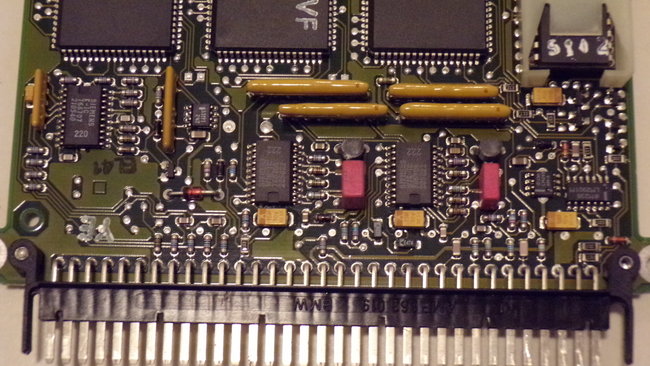

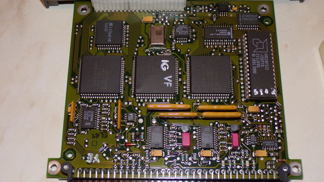

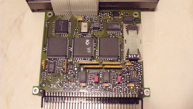

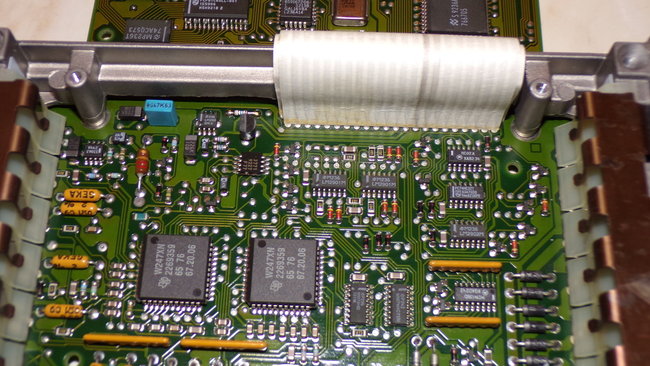

I was able to remove the top circuit board after I looked online as to how to do it. Pictures are attached and one can see that there doesn't seem to be anything that one can point to and say that that is the culprit.
Sep 17, 2022 at 2:28 PM
I went through each pic and zoomed in. I see nothing either. Is this the original one or the one from the salvage yard? Also, does the one from the salvage yard have the exact same part number?
Sep 17, 2022 at 9:51 PM
CHRISTOPHER SA
  • 253 POSTS

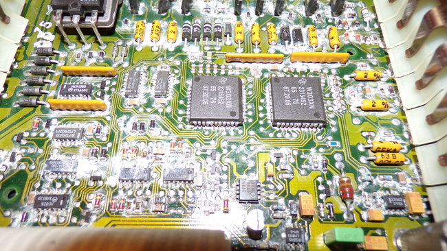

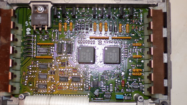

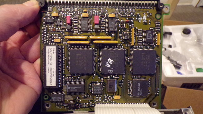

The one I am talking about is the one I purchased from Europe to replace my original broken (flooded) DME that came with the car from new. It's the one that 'has been' working until I did the test and found that spark plug not firing (with your help). I have just checked with the original and all the part numbers for the 'new' one matches the numbers with the original one that came with the car (apart from the VIN number).
Sep 17, 2022 at 11:21 PM

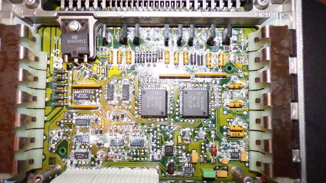

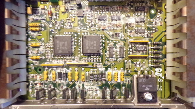

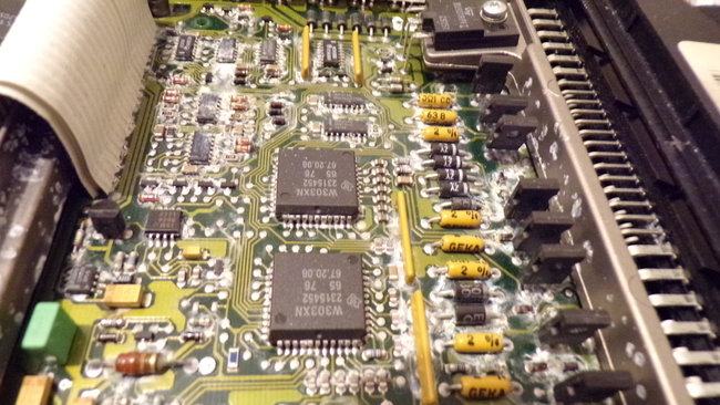

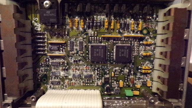

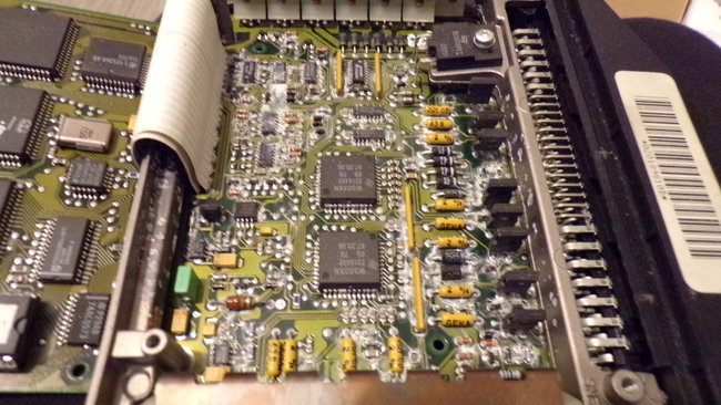

Out of curiosity I opened up my original unit that got soaked back in 2017(?). It is very easy to see the damage. See pictures. I am wondering if I can just swap out the flash chip (the long one with a white label on it) from the old one and put it into the 'new(er)' one and see if that would work. Would it?
Sep 17, 2022 at 11:39 PM
Anything is possible. I wonder, however, if it was damaged in some way by the water issue.
Sep 17, 2022 at 11:41 PM
CHRISTOPHER SA
  • 253 POSTS
It doesn't look like any water touched it. Mind you, there must have been a mini lake in that compartment as there is white stuff (water marks) on the inner walls of the casing, front and back, nearly to the top!! I might try it just for the hell of it! In the meantime I have found someone who will diagnose the 'newer' one for me for a low fee (CDN$60) and then fix it (CDN$180), if there is nothing else wrong with it (apart from the spark coil issue).

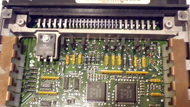

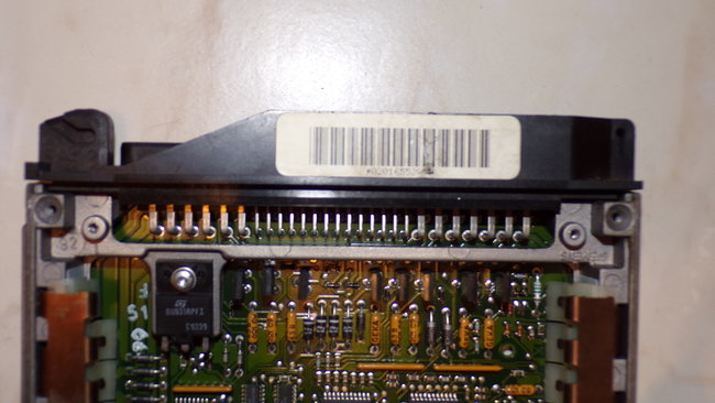

An update: I found someone in Toronto, who seems to work around the clock. He just gave me a call, at12:30am!!!, to let me know about the issues with both the original unit (that came with the car) and the second-hand unit I purchased that is giving me issues with 'cylinder 4' (I sent him both DME units in case he could use the EPROM chip from my original DME). My original unit is beyond repairable, as the bottom circuit board is totally fried, but the EPROM chip looks like it's fine. He will be putting that one into the second-hand unit.
The second-hand unit needs just 2 resistors replaced for new ones as these two were broken/not working. Everything else seems to be ok on it. He should have them ready by the morning and they will be sent back to me after I pay for them. I will let you know how much the cost is as many of your readers from Canada might like to use this chap as he seems very, very good.

Well, today was an interesting day. I installed the returned DME and proceeded to test the wires at the plug and forgot that it was meant to be Green/Black. I tested Green/Brown!! Haha. I went through all the plugs thinking that everything was worse than before. So, I came back here and reread the thread as to which wires, I should be using for the plug test. Green/Black was what I should be testing so I went and did that, and all cylinders are pulsing!! I even have the original EPROM chip installed in the unit that was purchased to replace the original DME unit and that works too. So, I now have a working DME unit with an original chip in it and a spare chip that also works! Yay! Tomorrow I will be putting everything back and starting the car to see that everything is working properly. After that, if there is still blue smoke coming out the back, the head is the next thing to remove and check to see what has happened to the head and cylinders.
As to what was wrong with the secondhand unit from Europe, some MOSFETs were cracked (the items on the both sides of the bottom DME circuit board that are under some sort of enclosures) and two resistors were burnt (or the other way around) so those were replaced.

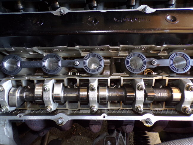

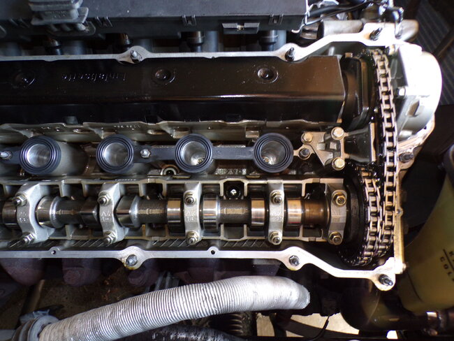

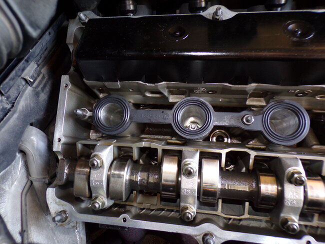

One of the steps that we discussed to do was to change the valve cover gasket. I did this today and boy was it clean inside where the cam was. Here are three images to show you. The old gasket was pretty hard and stiff. I also changed the gasket material where the spark plugs go. The clean lines is probably due to me using Auto-RX, a fluid patented by an American and designed to clean the varnish off of the metal within the engine.
Oct 11, 2022 at 6:20 PM
Wow! Everything looks new. I never heard of the product that you mentioned. I am going to look for it.
