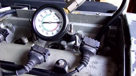

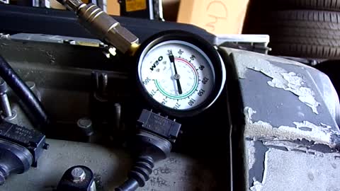

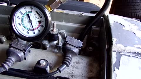

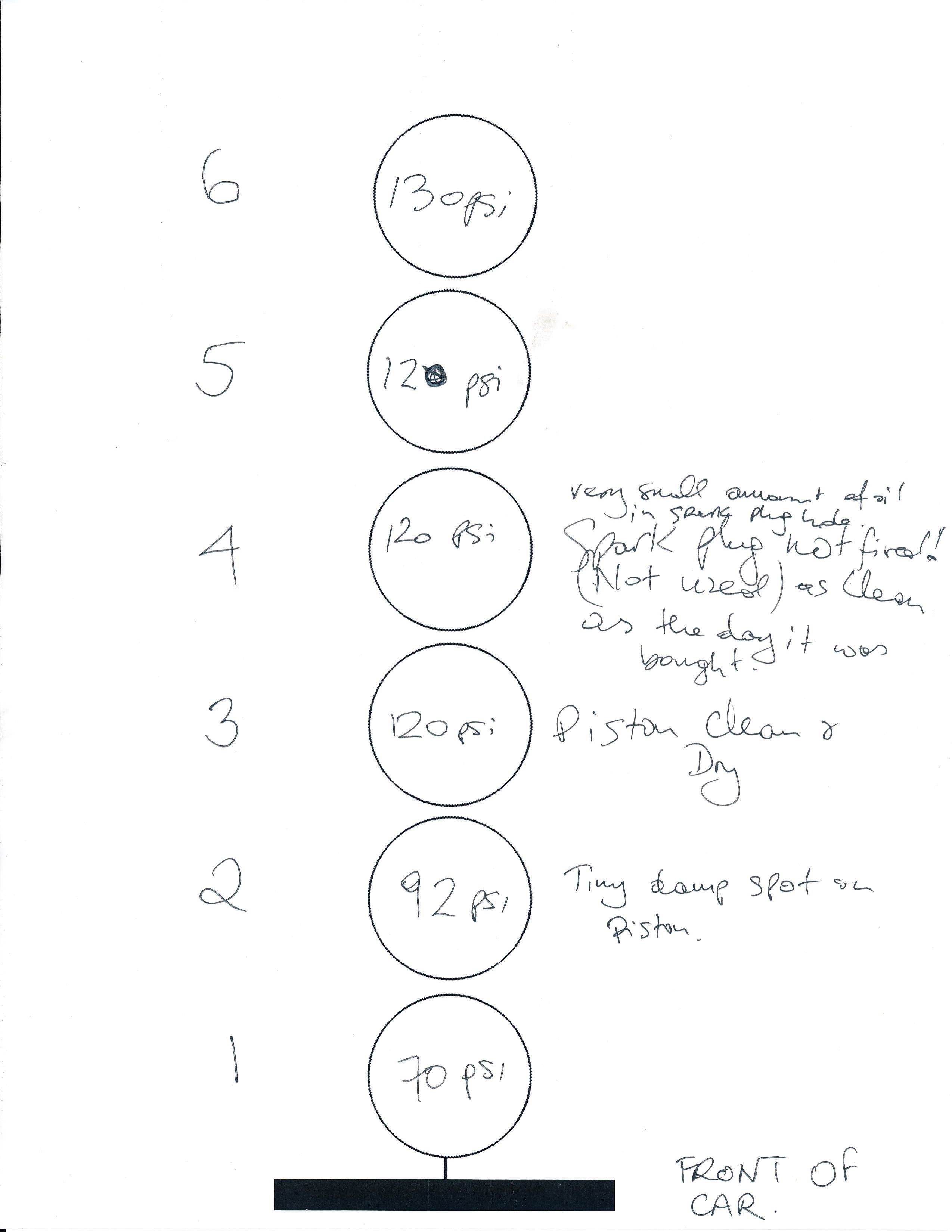

I did the compression test on the cylinders and here is the result of a dry compression test.
You will notice that the front two cylinders are the worst with 70 PSI in cylinder #1 and 92 PSI in cylinder #2.

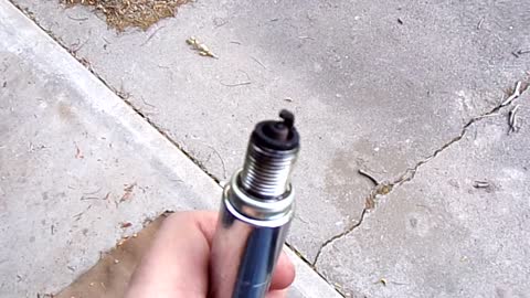

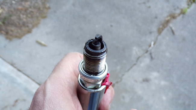

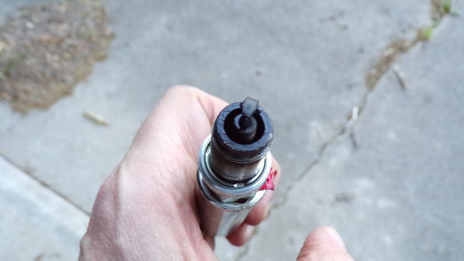

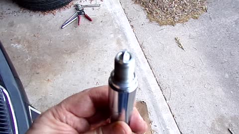

Here are some of the spark plugs starting with cylinder 2 (near front of engine) as somehow I forgot to do spark plug #1.
Jul 23, 2022 at 4:37 PM
CHRISTOPHER SA
  • 253 POSTS

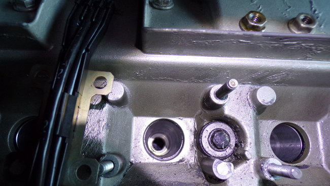

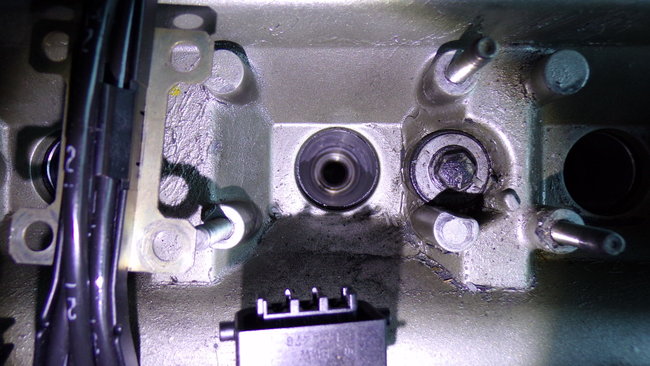

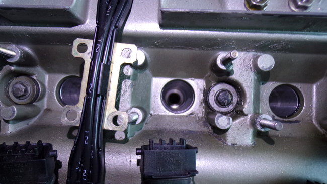

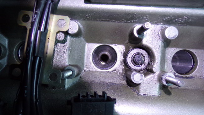

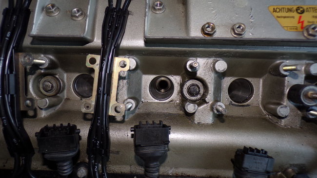

Hole for spark plug from cylinder three as it had some oil in the tower. Very difficult to see though.

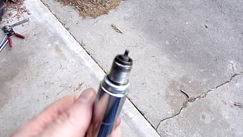

Cylinder 4 - the spark plug from this was totally clean, and looked brand new in fact. It looked like it had never been used. Very surprising. There is also a short video of the spark plug hole.
Jul 23, 2022 at 4:45 PM

I was then asked by Joe to do a wet test which I did. All the cylinders increased their PSI by a fair bit especially cylinders 1 and 2, which both registered over 150 PSI but dropped from that rapidly to hold for a few seconds around 90 PSI before slowly dropping. The videos show the wet test for cylinder 1 (2 videos) then 2.

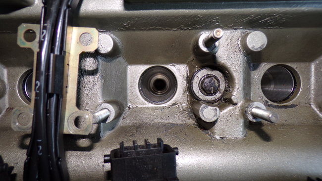

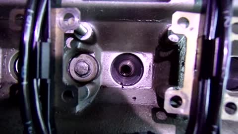

When doing these tests, I noticed that the valve cover gasket was protruding a tiny bit into the tower of spark plug holes 1, 2 and 6 and after having cleaned them out the first time when doing the inspections and tests noticed that tower 2 had filled slightly with oil again. The gasket was showing, and one could see it was wet from oil. You can see the gasket showing near the top of some of the holes in this video. That ends the mystery of where the oil comes from. So, I purchased a new valve cover gasket. It is waiting to be put on.

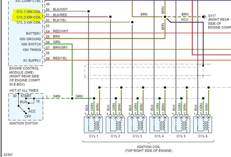

This particular model has three wires going to the plug - green, black and brown.
I'll have to go and purchase a testing light.
Jul 25, 2022 at 9:37 PM
Looking at the schematic for a 325, the black should be the trigger ground. The brown is a ground as well, but not for the purpose of firing the coil.

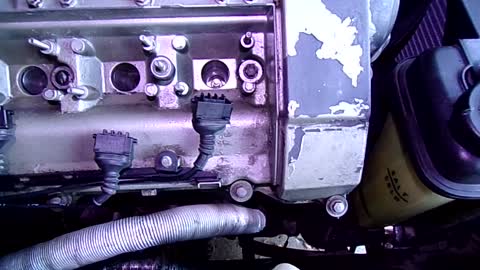

Hi Joe, sorry about not getting the next step done sooner but I have just done the step you requested this evening. Not good news. I will let the videos do the talking.
First up is a test cylinder (cyl 3 from the front counting back). I purchased some extra wire and alligator clips and rigged the test probe so that the metal probe itself had an alligator clip with a wire going from the probe to the brown wire with the alligator clip at the other end of the wire stuffed down into the area where the brown wire from the ECU went in the back of the plug. The wire embedded within the probe went to the green ECU wire going into the plug with the alligator clip stuffed down that hole. That resulted in the light in the probe being constantly on as long as the key was turned on in the ignition (engine turning over and in the on position). See video attached.
Sep 9, 2022 at 5:05 PM
CHRISTOPHER SA
  • 253 POSTS
Next, I put the alligator clip from the brown wire to the black wire. This time the result was a pulsing light as the engine turned over. See video attached.
Sep 9, 2022 at 5:06 PM
CHRISTOPHER SA
  • 253 POSTS
Moving to the problem cylinder (#4 from the front of the engine) I attached all the wires as before, but this time put the alligator clip from the wire on the metal tip of the probe into the black wire receptacle at the back of the plug. The light was constantly on as the key was turned into the on position and also when the engine was turning over. See video attached. This means that the ECU is faulty. :(
Sep 9, 2022 at 5:10 PM
CHRISTOPHER SA
  • 253 POSTS
The same result happened with the brown wire on this cylinder. See video attached. This post is a bit redundant but I put it up anyway for continuity.
Sep 9, 2022 at 5:13 PM

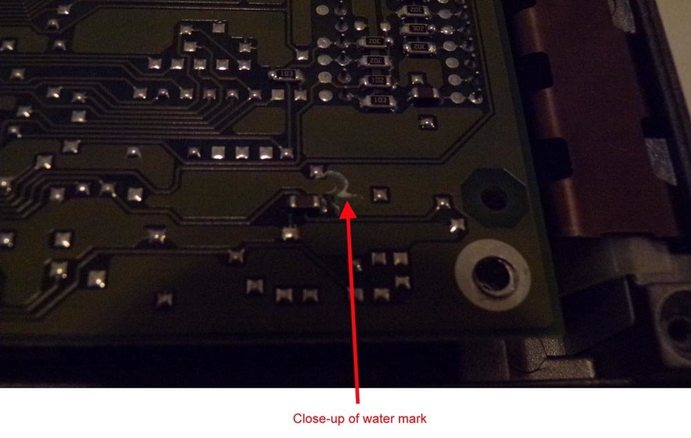

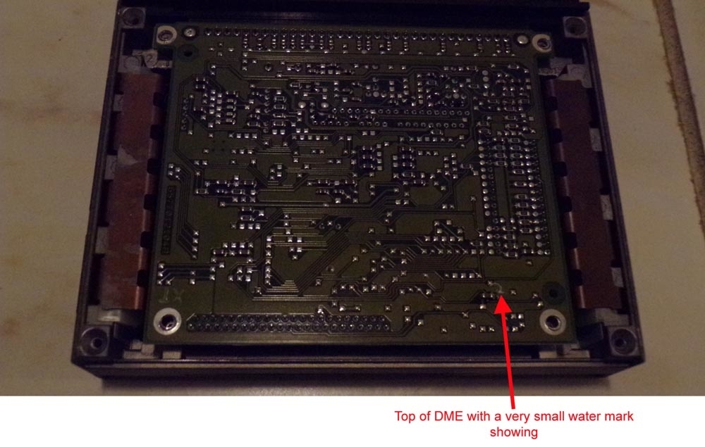

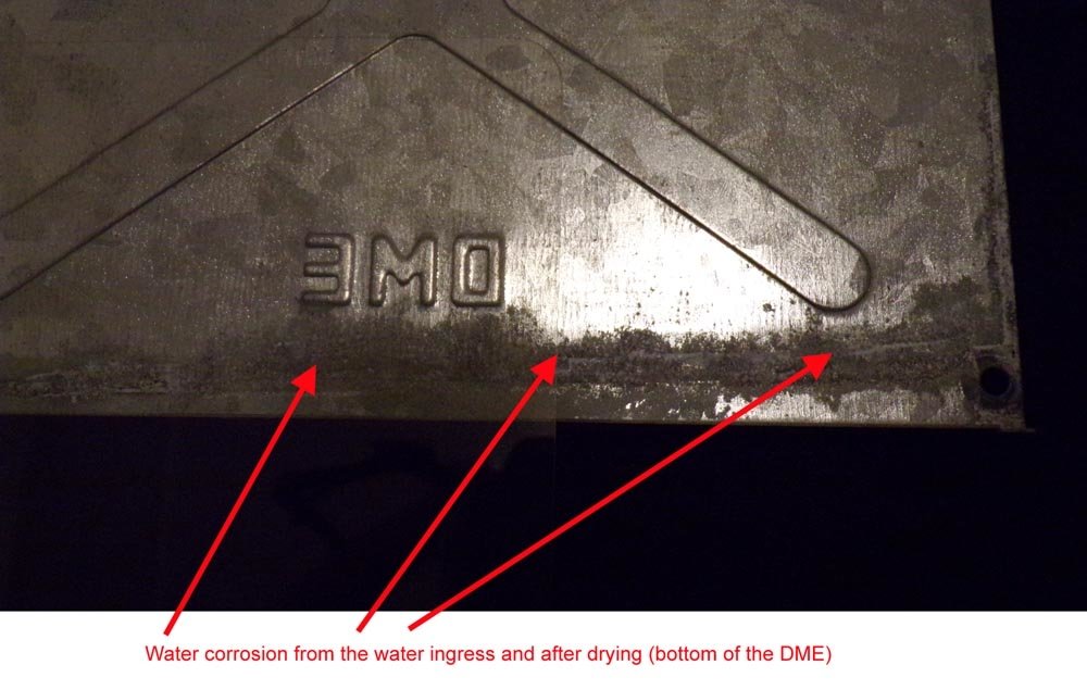

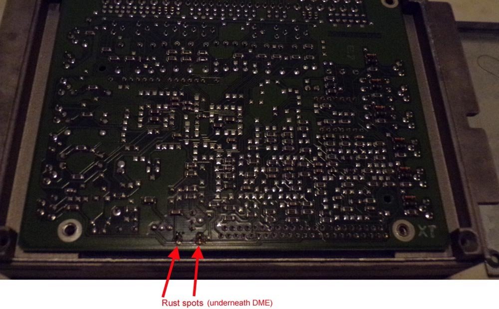

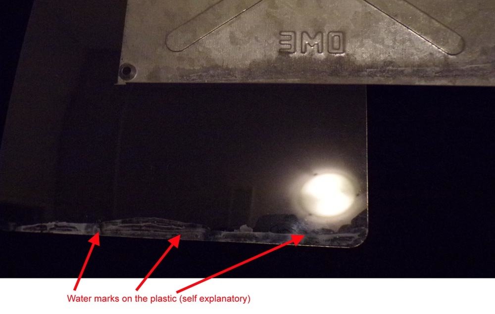

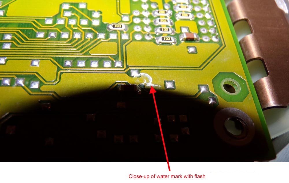

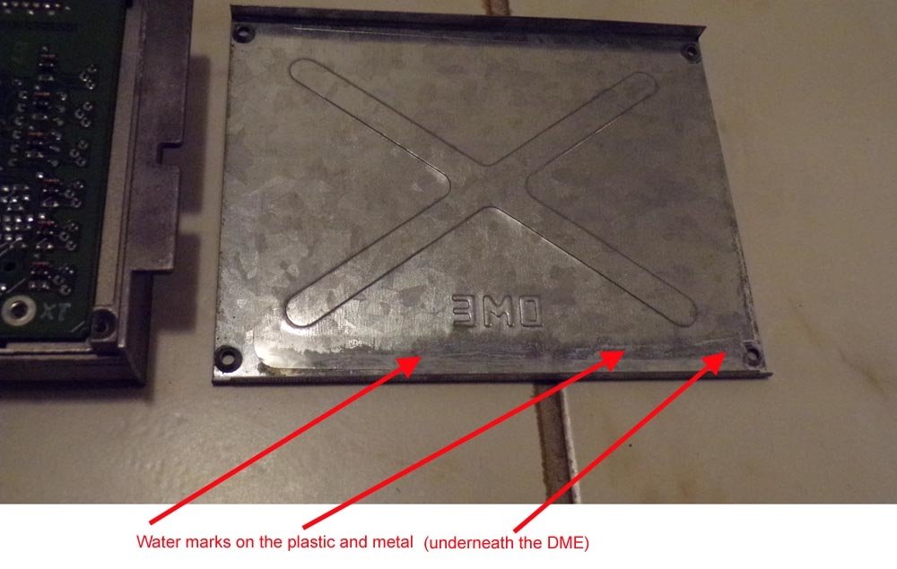

I finally got around to opening up the DME today (Friday, 16th September 2022). Not great news. I have been sold a unit that has had water ingress. I have posted the images of what I found (just before my batteries failed) with text explanations of what one is looking at. Now it's a question of whether I send it off to get repaired or get another refurbished unit entirely (very expensive!). Considering that my original unit quit working of the same causes I am surprised that it worked at all.
As a side note I am always puzzled why manufacturers assume that water will not get into one of these units and don't encapsulate them in resin. It would save customers lots of money.
Sep 16, 2022 at 3:57 PM
Wow. That will do it. Have you tried finding someone online that has refurbished ones that are plug and play?
Sep 16, 2022 at 8:37 PM
