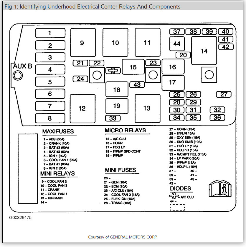

To me it sounds like the engine main relay is overheating and shutting off. Here is a guide and the location of the relay so you can run a test and replace the relay:
