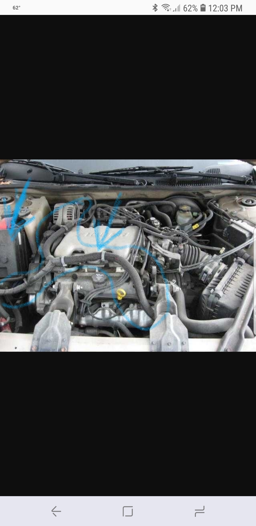

The big wire in this picture, but the car cuts off even when it is not touched or moved.

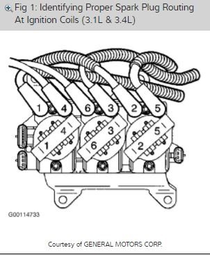

Here are the instructions:
IGNITION CONTROL MODULE > REMOVAL & INSTALLATION (3.1L)
Disconnect all the electrical connectors at the Ignition Control Module (ICM). Note the position of the spark plug wires for installation and disconnect the spark plug wires from the ignition coils. Remove the screws securing the coil assemblies to the ignition control module.
Disconnect the coils from the ignition control module. Remove the fasteners securing the ignition control module assembly to the engine. Remove the coils and the ignition control module from the bracket.
To install, reverse removal procedure. Tighten the ignition coil screws to specification. See TORQUE SPECIFICATIONS . Connect the spark plug wires to the ignition coils. See Figure

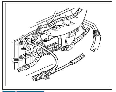

It cannot hurt to check the ground G111 located at lower left front of engine on trans-axle stud, left of starter.

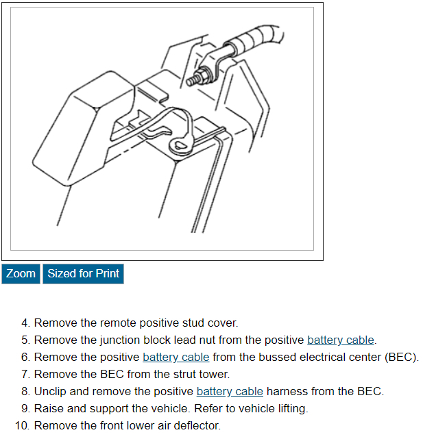

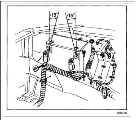

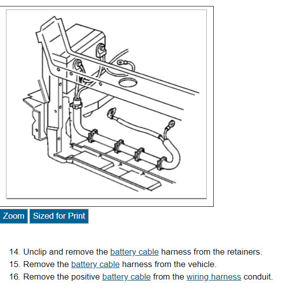

Any exposed wires should be repaired for sure. Are all problems fixed except for the stalling? Is the check engine light on? Also, I have seen on these cars the the positive battery cable shorts out causing the problem you are having.
Here is a guide to help you replace it.
Check out the diagrams (below). Please run this test and get back to us.
