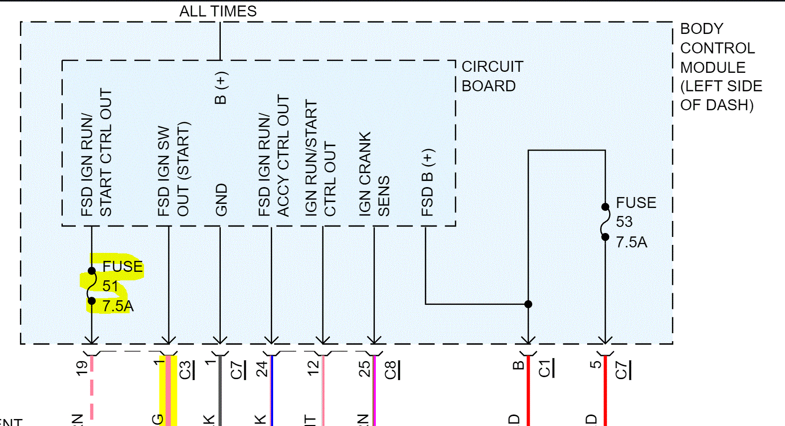

If the yellow wire has power now, does the pink/orange wire have power to the relay? That power comes from the ignition switch and is what causes the relay to actuate and send power from the yellow wire.
Jan 23, 2022 at 8:20 PM
MECODY
  • 27 POSTS
It was late when I got it wired up and tried it and when it didn’t work, I just gave up. It was clicking at the BCM at my feet when I would hit the start button.
Jan 24, 2022 at 3:54 AM
If you feel the BCM clicking, check to make sure the 7.5-amp fuse (fuse 51) is good at the BCM (fuse panel in vehicle).
See pic below.
