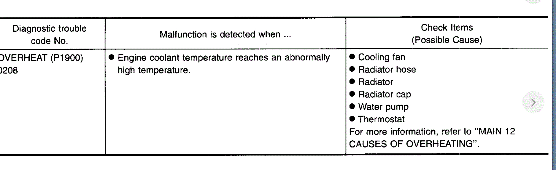

On page EC 300 in the Nissan service manual it talks about overheating maybe I understood it wrong in my memory, I tried to copy ( EC 300 ) and send to you but it wouldn't allow me to.
Feb 12, 2020 at 8:31 PM
UHSNOEBIRD
  • 342 POSTS
DTC 1900 is the code.
Feb 12, 2020 at 8:55 PM
That code is related to the ECT. See the attached.
Feb 12, 2020 at 9:21 PM

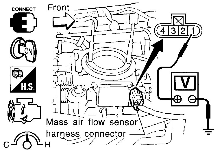

1997 Nissan-Datsun Truck D21 Hardbody SE King Cab 2WD L4-2389cc 2.4L SOHC MFI (KA24E)
Component Testing Procedure
Vehicle Powertrain Management Fuel Delivery and Air Induction Sensors and Switches - Fuel Delivery and Air Induction Air Flow Meter/Sensor Testing and Inspection Component Tests and General Diagnostics Component Testing Procedure
COMPONENT TESTING PROCEDURE
COMPONENT INSPECTION
Mass Air Flow Sensor
1. Turn ignition switch "ON".
2. Start engine and warm it up sufficiently.
pic 1
3. Check voltage between terminal 1 and ground.
Conditions / Voltage, V
Ignition switch "ON" (Engine stopped.) / Less than 1.0
Idle (Engine is warmed-up sufficiently.) / 1.3 - 1.7
2,500 rpm / 1.7 - 2.3
Idle to about 4,000 rpm / 1.3 - 1.7 to Approx. 4.0
*: Check for linear voltage rise in response to increases to about 4,000 rpm in engine speed.
pic 2
4. If NG, remove mass air flow sensor from air duct. Check hot wire for damage or dust.
Let me know if that helps.
