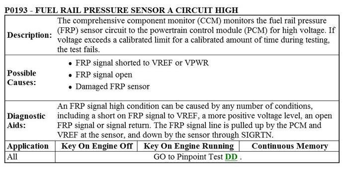

Long time my good friend.My problem still persist with the codes p2104,p2112 and po193 even after i bought a new fuel pump.I also see that it is a returnless fuel line.Again,each time we tried to use our hand to open the throttle plate,the engine tries to accelerate but goes off again maybe because of uncleaned air.To me but not too sure i think the problem lies between the throttle body,TPS and the fuel pressure regulator.Please give me your expert view as this problem has taken long now but i still believe we can still make it work.Again the idling is perfect,no fluctuation even with A/C on.Thanks for your time
Aug 27, 2011 at 3:53 PM
P0193 is not a fault with the fuel pump and replacing it is not going to help.
You do not seem to be doing things the correct way and unless you go through everything accordingly, it is not going to work.
I have aleady outlined all the test in previous posts. Print those related to the existing codes and go through them to see of you have missed out anything. Check for damaged wires, especially those brushing against any metal parts etc.

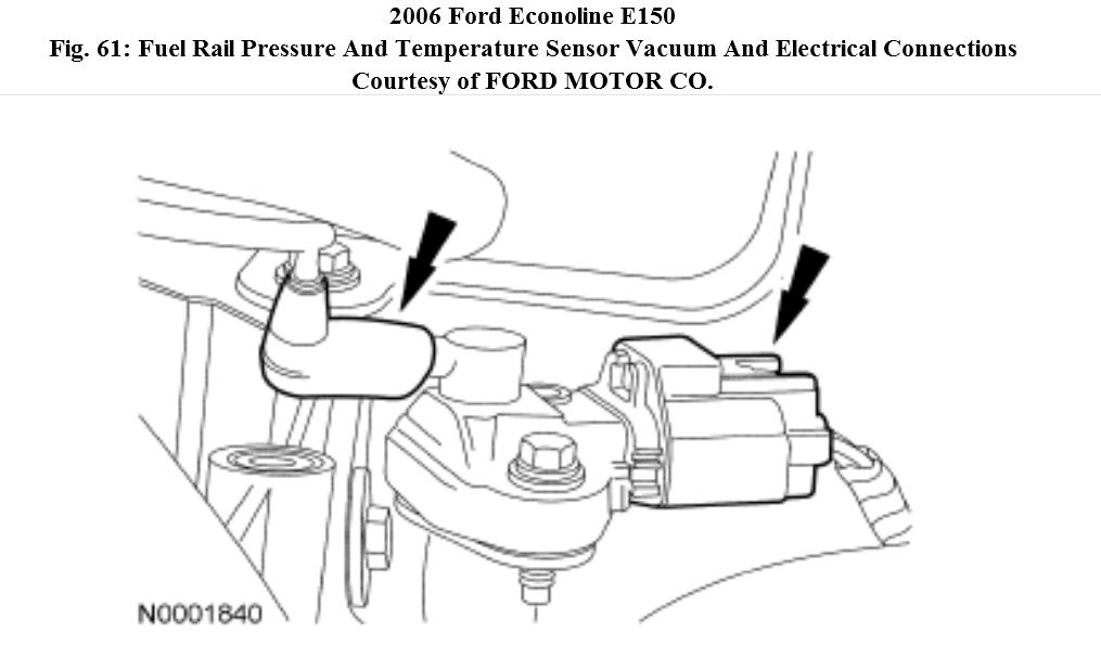

Thanks a lot.But what about the problem of p2104 and p2112.Where can i find the FRP sensor so that i can replace it if need be.Again what about the throttle plate or i should not look that way first.Finally,what about the TPS.

Long time my brotrher.Concerning the 2006 E 150.There is a new codes after scaning again which comes sometimes P1200.Please what does it mean.Although others p2104 and po193 are still there.What else do you think i can do again because all wires to the PCM are good.Thanks
Nov 25, 2011 at 4:28 PM
P1200 is not listed in our database. Can you reconfirm the code?
As to the other codes, let go over them again and start with one code at a time.
Lets start with P0193.
I would try to get a simplifid version for you to perform tests.
