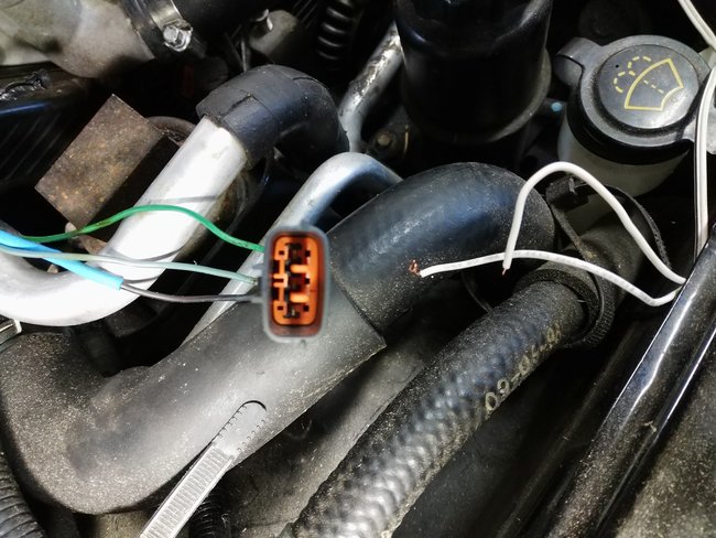

Attached is a picture of the crankshaft position sensor connector (the side that leads to the PCM). You can see the blue and green wires. To test for a short between the two wires (blue and green) I set my voltage meter to continuity and touched one of the probes to the green wire pin in the connector and the other probe to the blue wire pin.
Was that correct?

Yes it was.
