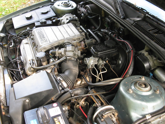

Is the TCC inside the valve body?
Here is a photo; can you arrow where to look for the TCC.
Sep 24, 2012 at 9:49 PM
KHLOW2008
  • 41,814 POSTS
It it INSIDE the transmisson together with the valve body. You can't see it from outside and the picture you provide does not even show the wires. Refer to the diagram you posted about the Park and Neutral position switch, it is somewhere near there.
