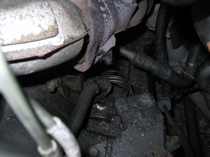

Found a leak by the left (driver's side) rear tire.; not sure if it's the hose or brake line. Are there any videos that show how to repair it?

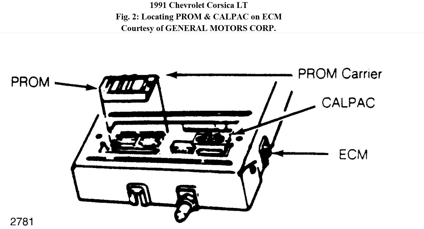

Someone mention that the ECU might be the cause to the stalling. The 91 3.1 Corsica has a documented record with ECU and fuel injector problems.
What do you think?

If you do not have any trouble codes, it is possible for the ECU to be the cause.

What is the procedure (step-by-step)for replacing the ECU?
Sep 21, 2012 at 6:45 AM
What are the steps after I connect the new ECU and start the car again?
Sep 21, 2012 at 4:43 PM
Let it run for a while and go for a test drive to allow the PCM relearn .
